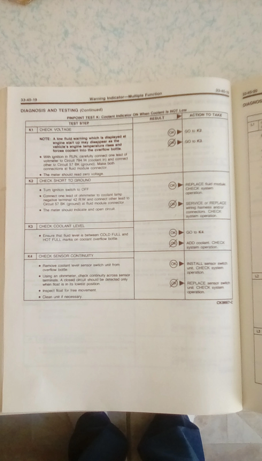

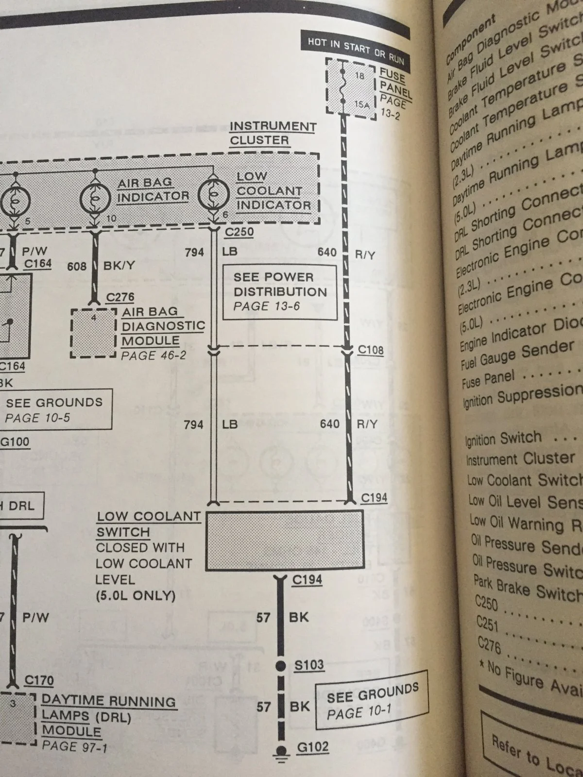

I'm the same way so I understand your plight. Usually it is the sensors but as a check you can check the wiring to make sure it's in good shape. Red will be your power and black is the ground. With engine on make sure you have a consistent 12v here. The blue wire is your return to cluster. Closing the sensor (low coolant) will trip the light which is why unplugging it will keep light permanently off
This for an 89 and may be hard to read, it shows how to test the circuit, wire colors ma be different but it will give you an idea of what to look for, hope this helps

I will test that and see what happens, Thanks for the help and the pics!

Yes and no. I found the ground wire coming off the connector plug and grounded it to the frame. The light stayed on for about two or three days after that and then I haven't seen it since. Don't actually know if that fixed it or if it's just went out. Either way it's gone.

Thanks for this post! I followed the ground route and wal lah fixed as well!!
