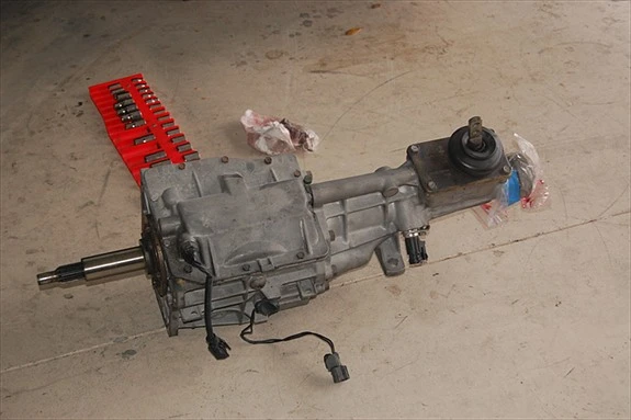

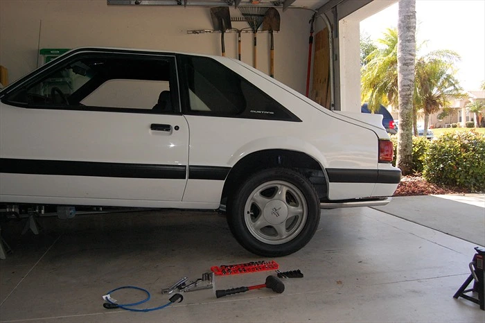

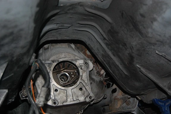

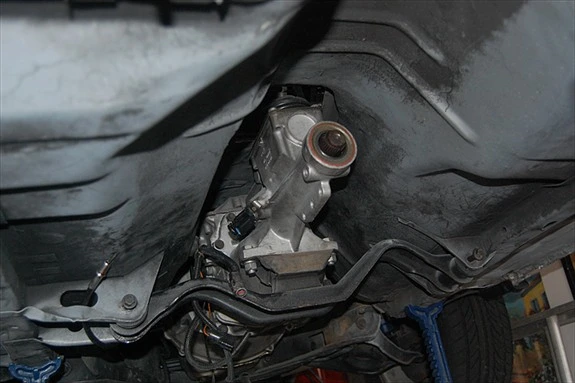

Finally started to make some progress. I got the car up on jackstands Monday, got the driveshaft out and h-pipe off. Today I got the interior center console removed, tranny fluid drained, crossmember off and transmission removed. I've got a couple days of travel for work tomorrow and Thursday, hopefully I can make some more progress on Friday. I figure since this is a project car, half the fun is having it on jackstands. Plus, if I keep waiting for a day where I have hours and hours to work on it that day will never come; so I stuck it on jackstands and figured I'll work on it when I can, even if it's only 30 minutes at a time.

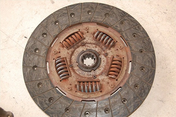

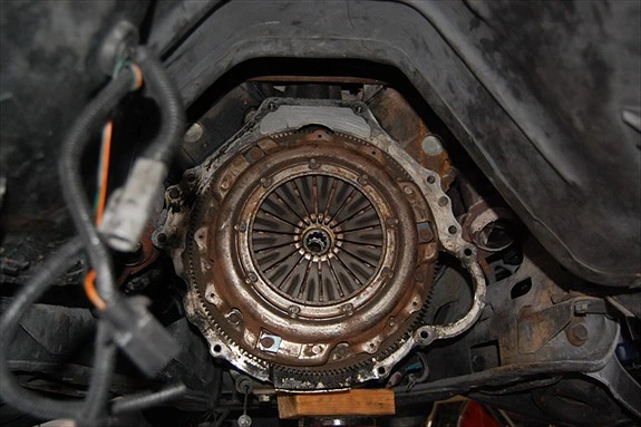

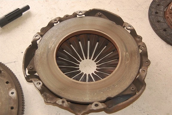

I got the bellhousing, clutch and flywheel pulled off. Couple of hot spots perhaps on the flywheel and pressure plate. I also got my existing electric fan removed so I can get ready to drop the new fan setup in.

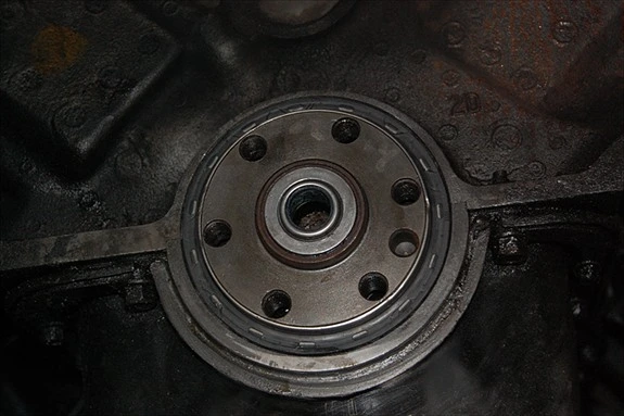

Thinking I might as well change the rear main seal while I'm in here. It's wet at the bottom.
Lookin' good. Please post up your solution to plugging the AIR holes on the back of the heads. I have the original tube turned backward on my '95 and would like something a little cleaner looking than that.

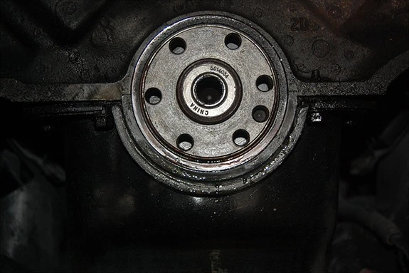

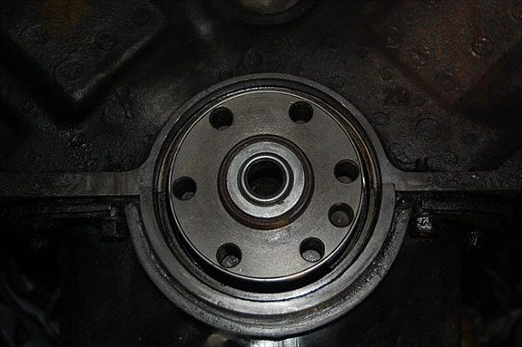

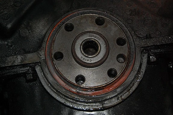

Made more progress over the past couple days. I got the old rear main seal removed (what a bitch to be that careful) and got the new one pressed in.
Seal is out:

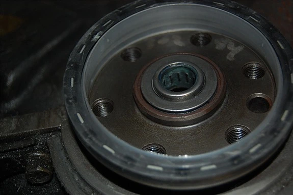

I bought a PTFE Fel-Pro seal from Napa. It came with this neat little plastic installation tool to help you start getting the seal installed over the crankshaft.
Seal installed

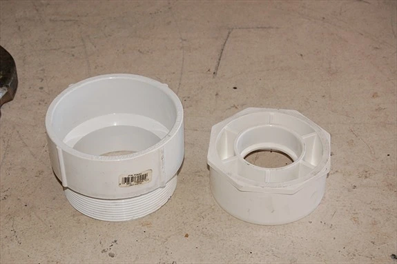

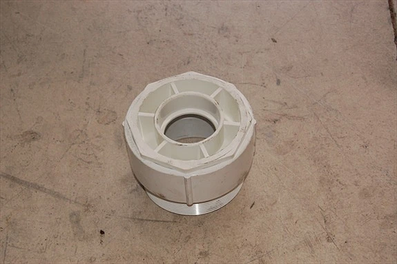

This was my seal driver. It's a 4" PVC male fitting with a 4" --> 3" bushing stuffed in one end to give a flat surface for my rubber mallet. Worked like a champ.

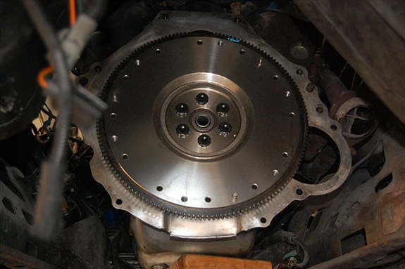

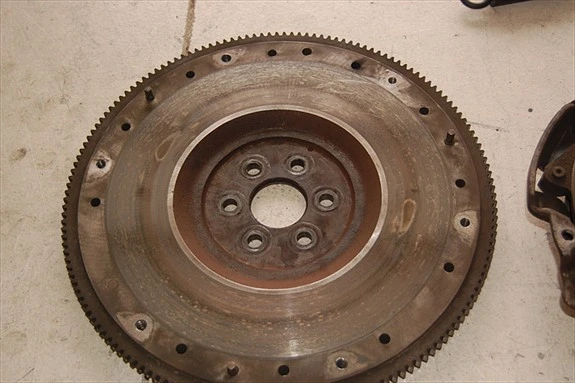

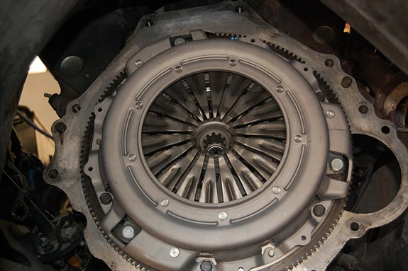

I got the flywheel and clutch installed today (pilot bearing was done earlier in the week). I used ARP flywheel bolts and then bought the FRPP clutch bolt/dowel pin kit from LMR.
Flexplate cleaned up, got all the oil off
Flywheel installed
Clutch installed

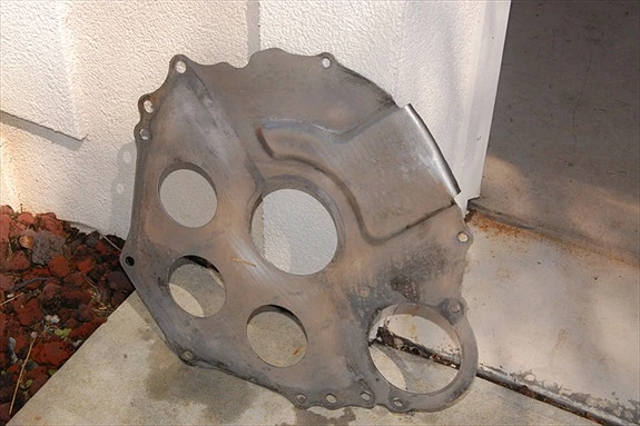

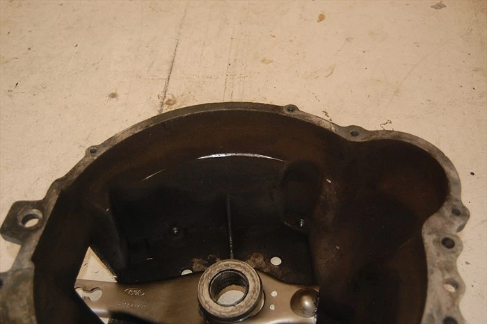

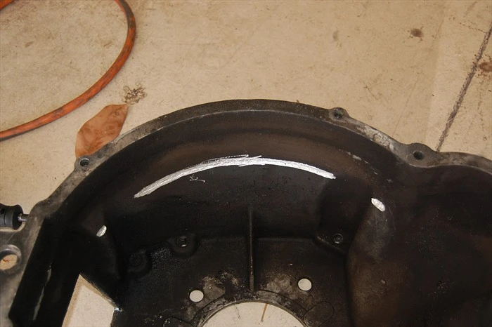

So I got the MGW STS ordered on March 11th, got the headers installed and got everything else back together towards the end of the week of March 11th. Went to start it up and there was a loud cyclic scraping sound from the bellhousing area. Turns out I didn't pay close enough attention to the fine print on the King Cobra clutches and the pressure plate was rubbing against the bellhousing.
The car sat all last week as I had family in town, and then yesterday I pulled the exhaust back down, removed the h-pipe, and dropped the transmission again (58 minutes start to finish). Got the bellhousing off and sure enough I had some contact at the bottom of the housing. Wasn't very deep at all. I used a Dremel and grinded away a small channel that I'm hoping will be enough to allow clearance for the pressure plate. I was able to install the bellhousing and turn the engine by hand. It didn't have the same resistance as before so I think it's clearanced enough, but it's hard to tell what resistance is from the engine itself and what may be from the bellhousing/PP interference. Certainly didn't hear any scraping/rubbing though, so I'm keeping my fingers crossed that I'm OK.
Before
After

Got everything put back together this morning, got the exhaust bolted back up and fired it up. NO SCRAPING! Guess I dremeled enough material away for the pressure plate to clear. When I get back on Thursday I'll fill up the transmission with new fluid, bolt up the driveshaft and get the car back on the ground finally. Then all I have to do is install the new fan and shroud, clean up the engine bay, re-tighten the header bolts...:crazy:

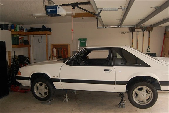

Made some decent progress on Thursday.

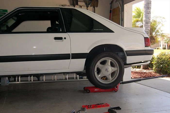

I got the car started, crawled under and checked for exhaust leaks, driveshaft bolted up and got the car back on all 4 tires. I thought I heard a leak from the driver's side header, but I wasn't able to feel any air. I can't tell if it just sounds different because of aftermarket headers or what. Guess I'll keep a close eye on it.
Car ready to come down...

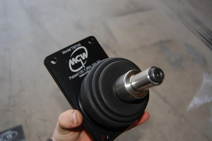

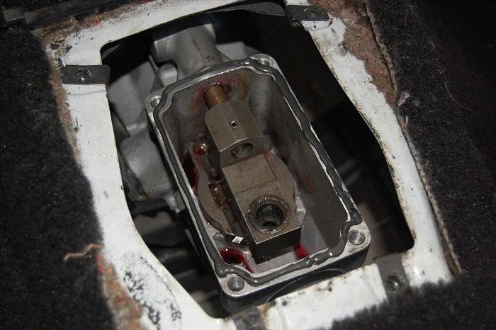

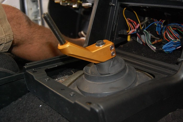

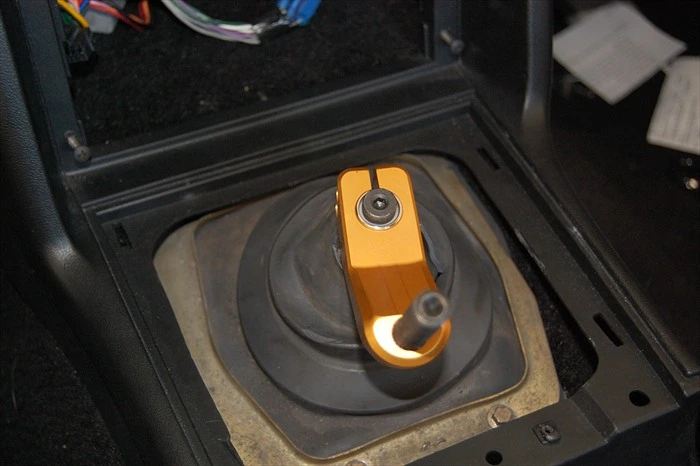

My MGW shifter came in while I was out of town so that was ready to go in. Once I get the electric fan installed and can actually drive the car I'll post up a complete review thread on this shifter, but for now I'll just throw out some highlight pictures. So far, I really like the quality of the MGW STS.

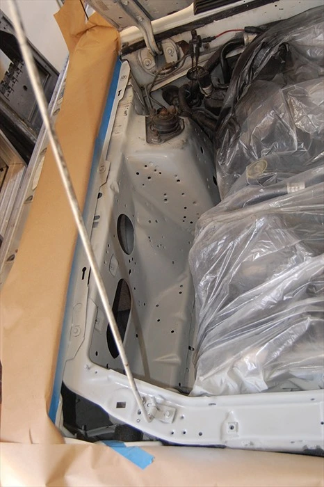

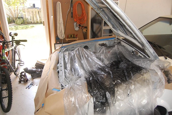

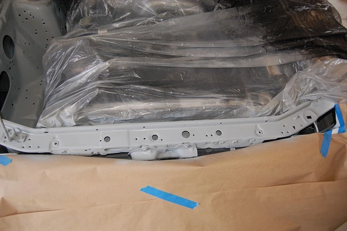

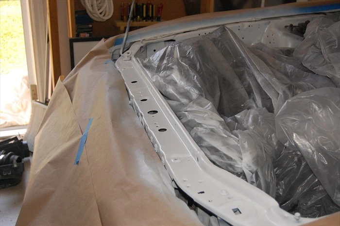

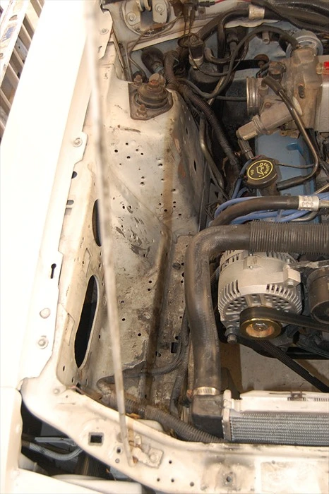

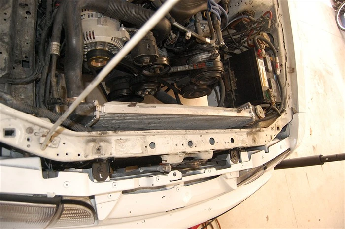

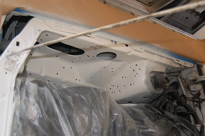

Today I started on a project that has been bugging me since I got my car painted. The outside of the car is a bright white, clean, etc. and the engine bay looks like crap. The paint is yellowed, scratched off in many places, dirty, etc. I don't have any near plans to drop the engine where painting the entire bay would be extremely easy, so before I install the electric fan and shroud I wanted to make sure I got the core support area painted while I could move the radiator. This turned into removing all the wiring for the lights, the air intake tube and filter housing, battery and starter solenoid and painting everything from the shock towers forward. I plan to finish the rest when I swap out the intake manifold in the near future. I covered the fenders with paper and tape, did the same with the bumper, and then wrapped drop cloth plastic over the engine to avoid as much overspray as possible.
My goal was to freshen up the engine bay enough to make it look presentable. This isn't a show car so I wasn't going to remove the engine, fill all the holes, etc. I used a wire brush and red Scotchbrite pad to clean everything up, then used some wax and grease remover since I have 98% of a can left from when I painted the interior pieces. Then I shot it with some light grey primer and then semi-gloss white. Yep, I rattle canned it.
Before:
During:
Next I'll work on getting everything put back together in the engine bay, then install the electric fan, stock shroud and overflow. Once that's done I'll take a finished picture, although it won't be completely finished since the back half of the bay isn't painted.
