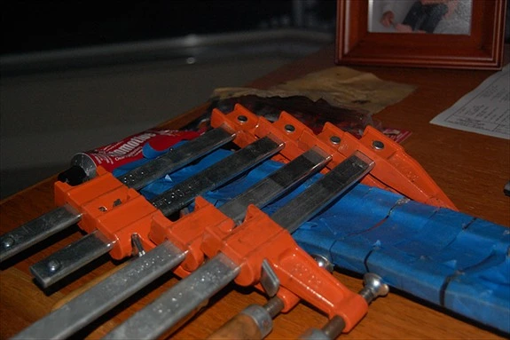

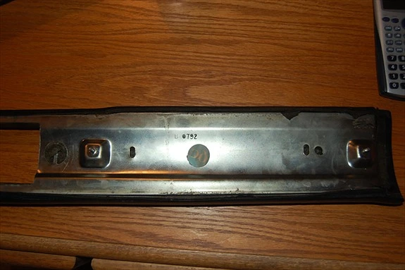

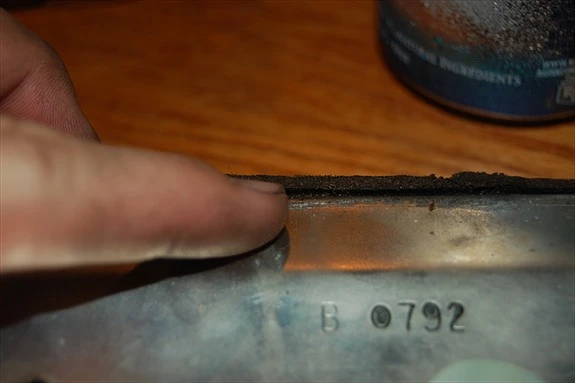

I also had the edges peeling up around the top and bottom of my dash pad. The top was the worst. While I had it off I figured I'd try and glue it back down, but this proved more difficult for me than I expected.
You can kind of see where the vinyl isn't attached to the metal plate anymore. I used some glue, some squeezing and pushing, a lot of tape and numerous clamps to hold it together.
It's a little better than it was, but it's not perfect. I would like to just buy a new dash pad but at the moment, it's not bad enough for me to justfiy the $100 for a new one from LMR.

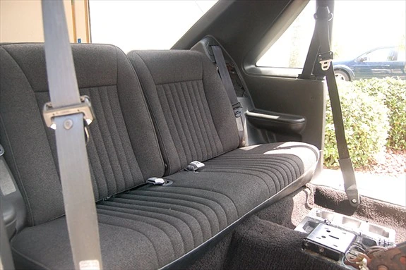

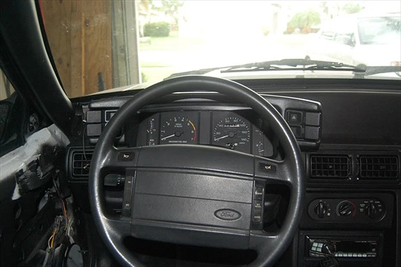

Last update for now. All of the interior trim plastics are back in, dash is back together and rear seats are back in.
I spent awhile fabbing up a plastic piece for the big trim housing/bezel that goes around the gauge cluster. At the back of this bezel there are 2 screws which hold the bezel down to the dash. One of these tabs was broken/missing so the left screw did nothing. As a result the bezel was loose and rattled. Annoying. I took a couple pieces of ABS plastic from a leftover center console and fabbed up an 'L' shaped piece that I could cement in place. I drilled a hole through the top of this piece and used a u-shaped speed nut to give the screw something to fasten in to.
I didn't get any pictures of this, but it worked great. The bezel is tight and doesn't rattle at all.

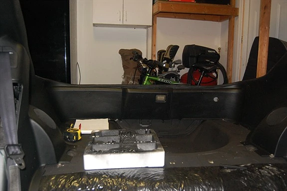

I'm hoping to work some more on it today. I'd like to get the center console, radio, and front seats in. This will make the trunk the next step. I've got to figure out a way to transition from the bottom of the trunk to the seat backs, preferably without using the stock carpet. See this thread for more details. http://www.stangnet.com/mustang-forums/threads/what-to-do-with-carpet-for-hatch.859697/#post-8645058

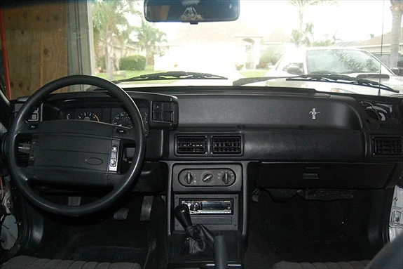

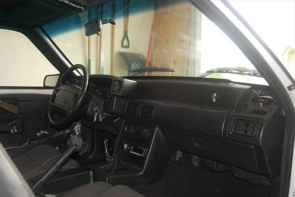

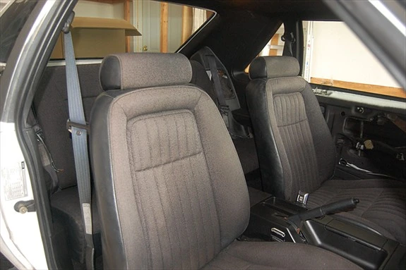

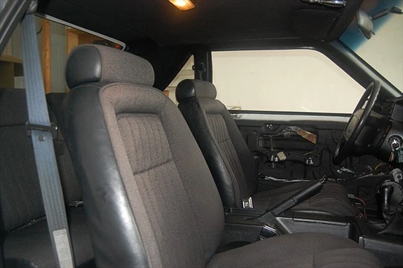

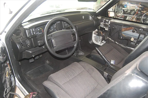

Got the majority of the interior put back together. All seats are in, console is in, all trim pieces back together, and new power window motors are in (although still having issues with the passenger one only working intermittently). I also got the pony symbol glued back on the dash.

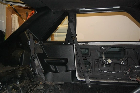

Next up is figure out the passenger window issue and try to find one of those brackets for the passenger side door lock actuator. The PO not only removed the actuator, but also the bracket so I can't even install a new actuator. It's like sabotage!
A lot of progress but I still have quite a long way to go. Doesn't look very sexy with missing door panels...all in good time. It could use a good wipe down too with a wet rag.

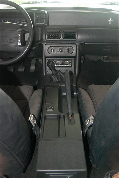

the console delete looks really smooth, more like a classic mustang, but I'm not sure how I personally feel about the loss of it. Then again it isn't too useful with the little space it provides.:p
Very claen minus the door panels of course, and the missing speakers on the upper dash. Can't wait to see the rest of your restoration
I figured the console armrest was just a bunch of more pieces to rattle around on the interior, not to mention the one I had needed a new pad and was very beat up as well.
I think the console delete flows pretty nice. It gives a clean smooth look from front to back.
