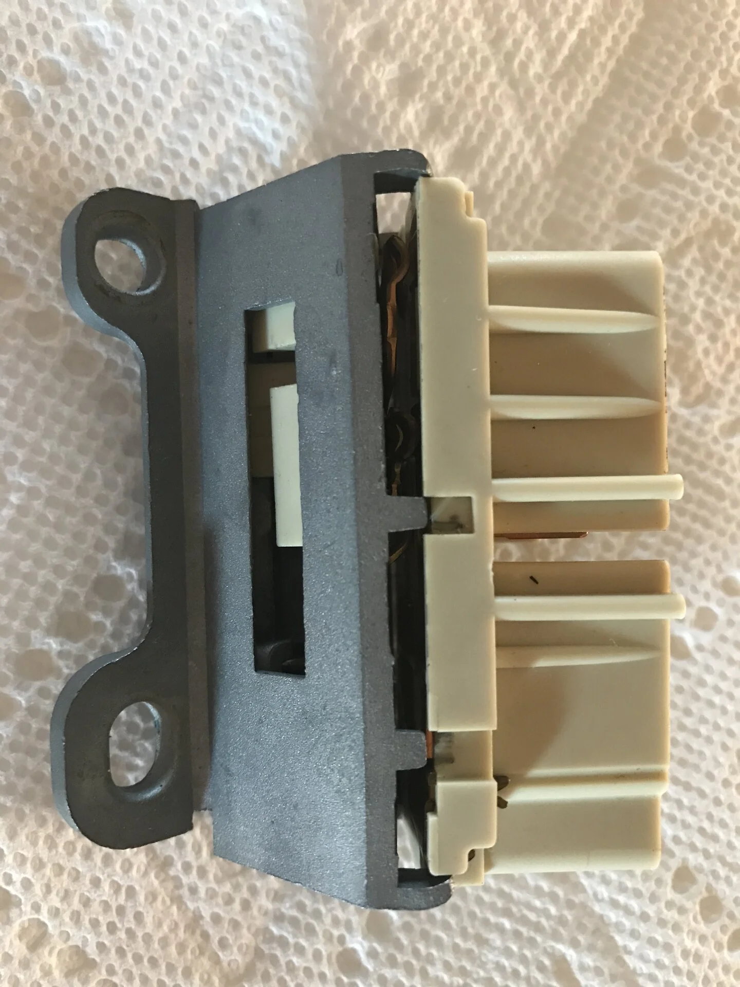

Did you check the ignition switch in the column? They have a tendency to separate due to faulty construction. The metal tabs that hold it together were not crimped properly. The picture shows mine
