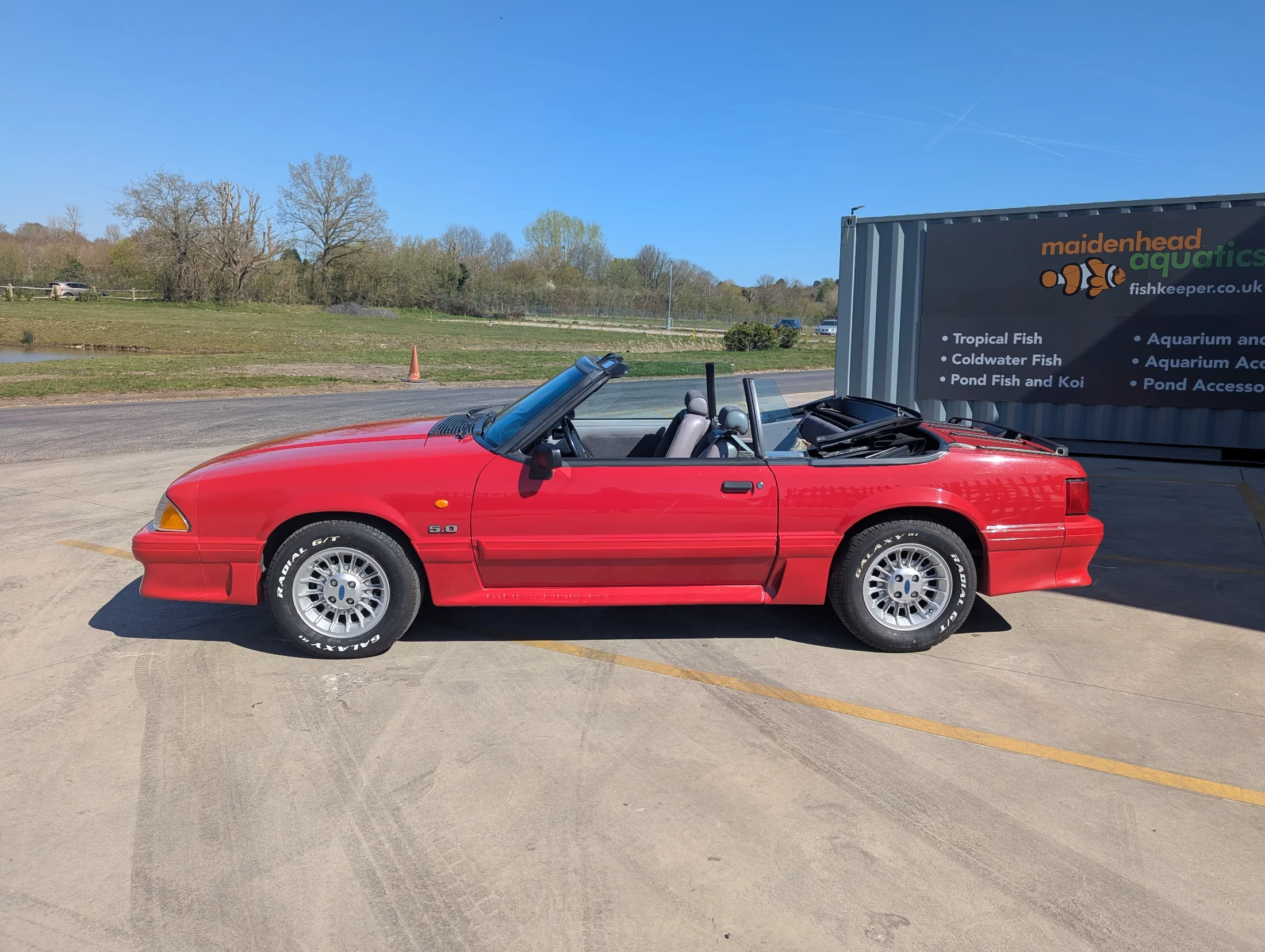

Hi there, I have a 1900 GT Vert. Intermittently the starter wasn't cranking at all when turning the key. I bought a replacement started Solenoid but now after 2 successful starts since it was fitted the starter continually turns even without the key in the ignition and I've had to disconnect the battery. Other than re-installing the old solenoid any advice please folks? Could the original fault be with the ignition itself perhaps?
