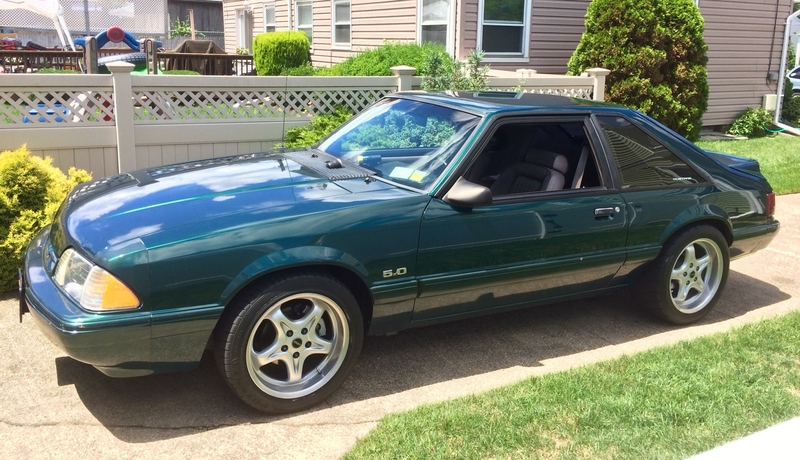

All 03-04 Cobra Braking gear! Status quo cookie cutter combo though!
Reactions: a.o.a
Wow looks really nice, what size tires font and back and rim size do u have on it?

Tires 255/40/18 in front 275/35/18 in back
Wheels 24MM front 22MM back
17x9 255 f 17x10.5 275 r

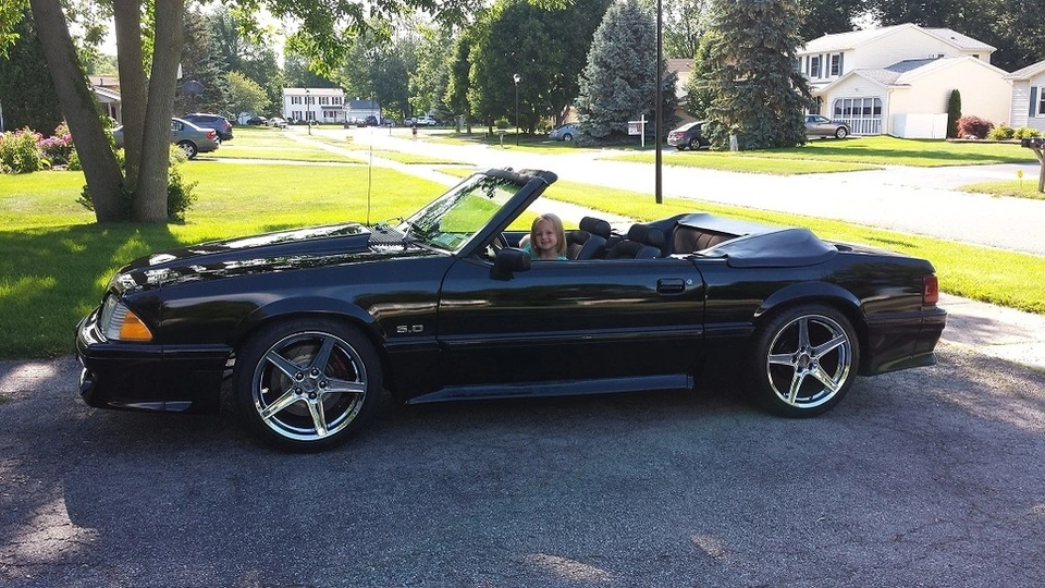

17x9" 275

Agreed 17x9 w/ a 275 series tire looks/fits best IMO

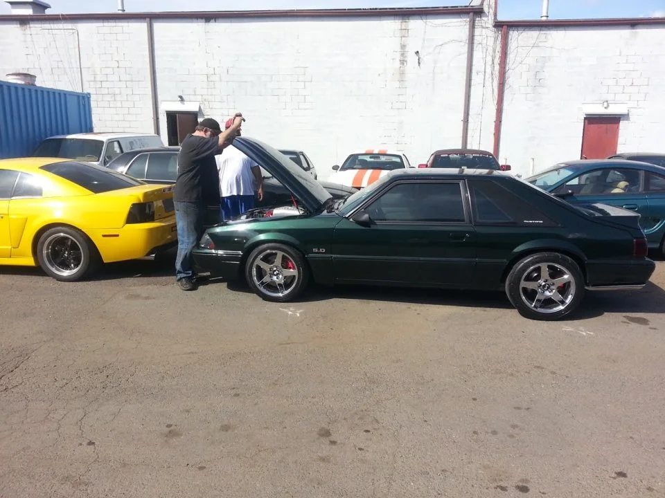

99+ pbr fronts, 94+ gt/v6 rears with ROH ZS wheels 17x8.5 front, 17x9.5 rear with 275's. Fox length 31 spline moser rear axles with north rc caliper brackets, maximum motrosports ss hoses and rear conversion lines.
