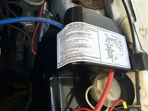

The motorcraft decal goes on the air box as shown in the pic. Orange warning label goes on the coil cover, as shown. That leaves three decals on the radiator support. The large one to the far left is the airbag decal. The one next to it is the A/C charge decal. The one to the far right is the belt routing decal, linked below
Also, not shown in the above pic is the emissions decal on the coil cover.
It goes here
