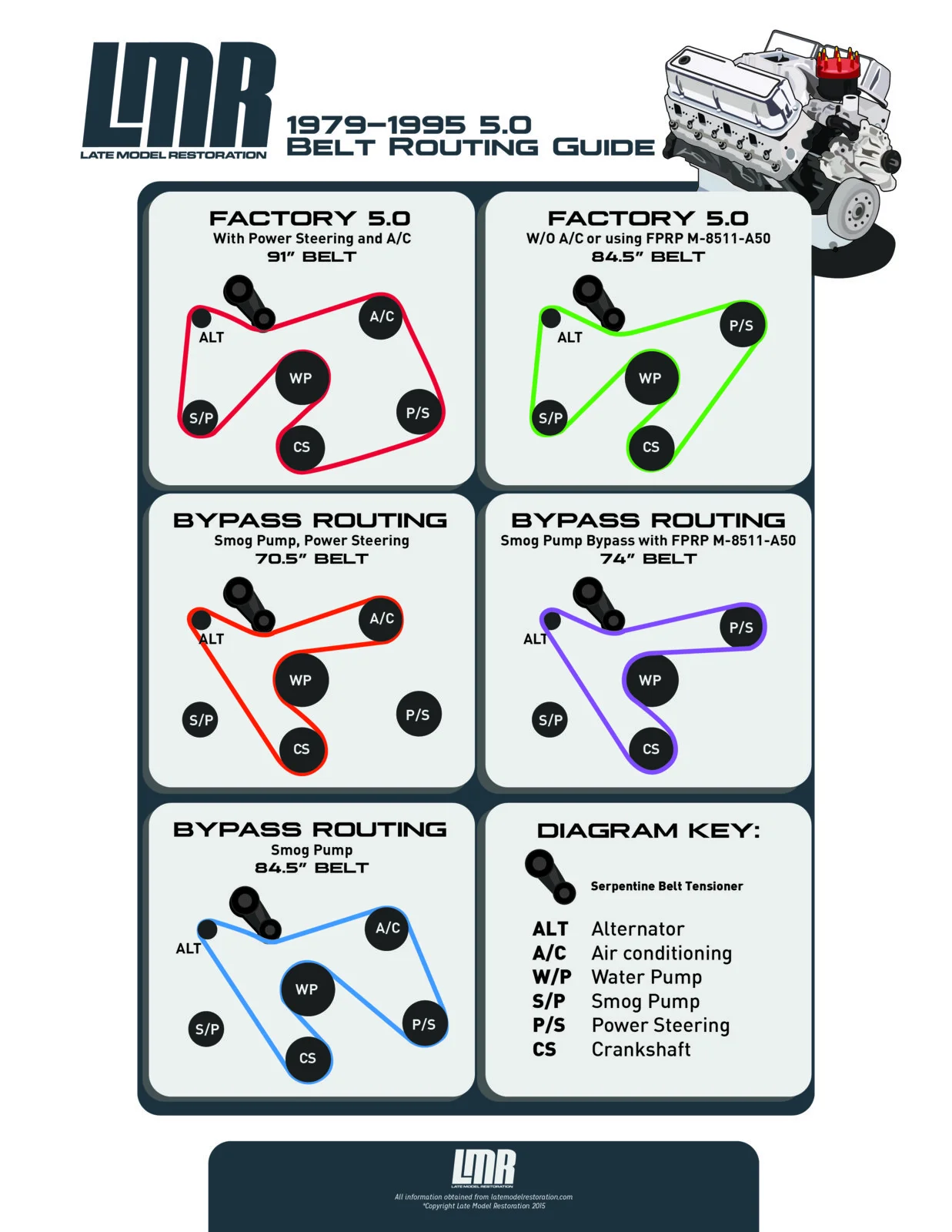

I have a 2002 FFR Cobra replica with a stock 1991 5.0L Mustang engine. One of the FFR supplied cats has broken and is not made anymore. The car is smog exempt so I plan on replacing the cats with j-pipes. These pipes do not have ports for smog pump air. If I don’t want to remove the pump can I either plug the hoses to the cats or leave them open to the atmosphere without adversely affecting the engine?

Can you reroute the belt?
You can't really block the hose (will build some pressure) and leaving it open will make noise that will be annoying

Thanks so much. Good suggestion. I have talked myself into removing the pump and all it’s hoses.
