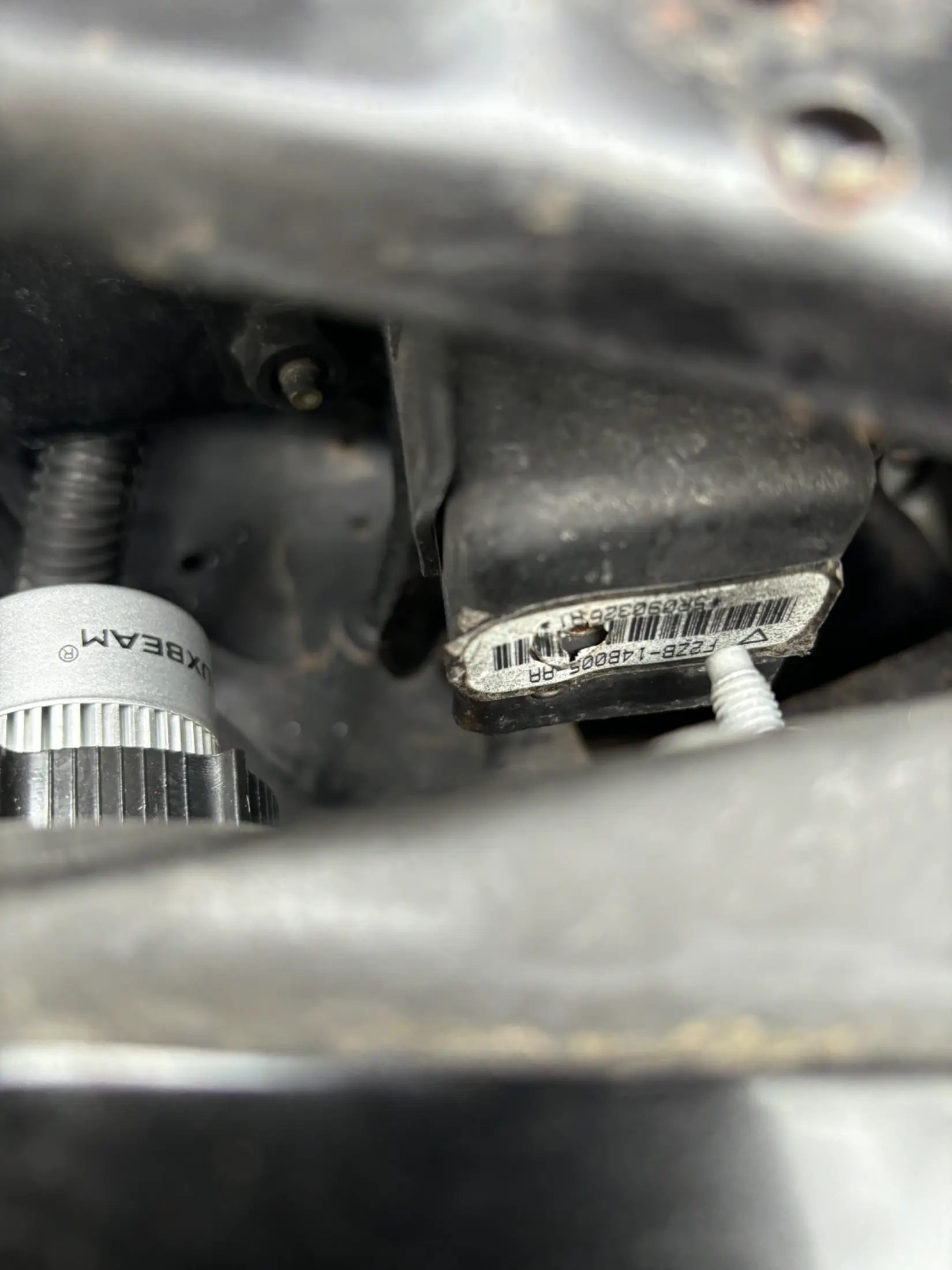

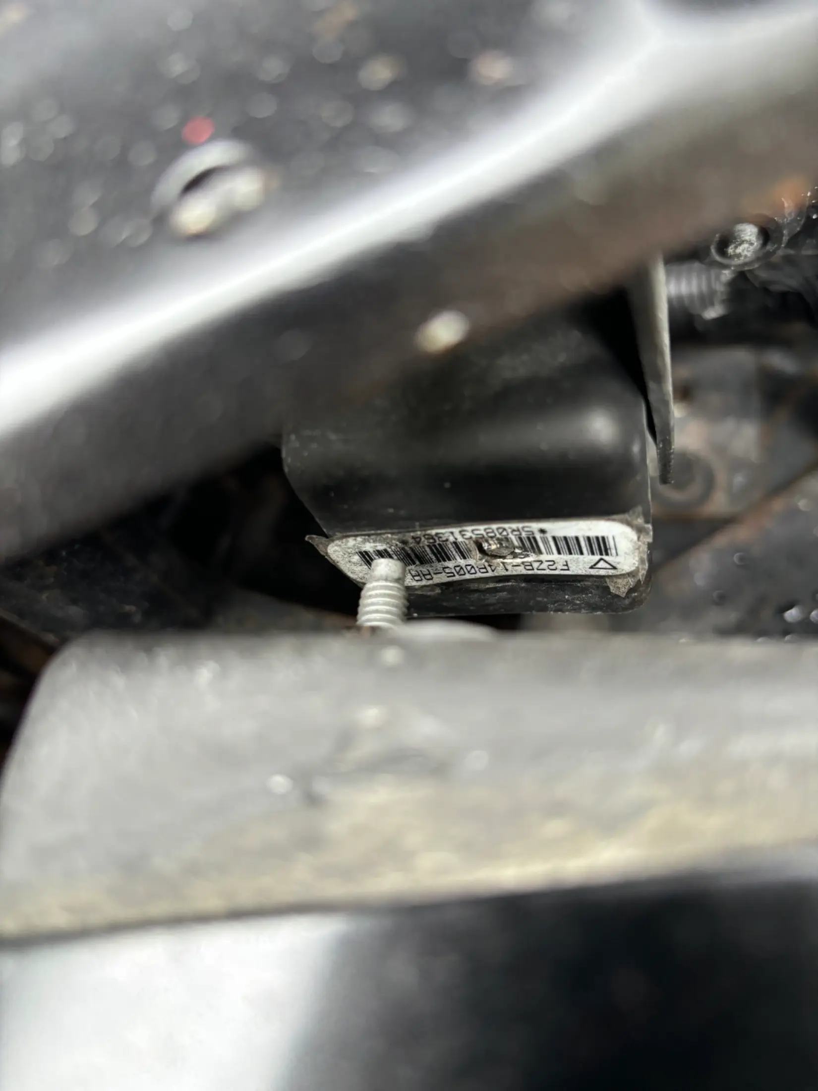

I just bought a 1993 Cobra. The airbag light flashes 4 times, pauses, then flashes 4 times again. The code shows RH crash sensor. When I looked at both the LH and RH, they both have same number on sticker, F2ZB-14B005-AA. Is this correct or should they be different numbers? If they are the same, does that mean the front left and front right crash sensors are interchangeable? Need help to pass inspection to get it registered.
Thank you. I took a picture of them

As for the crash sensors…swap them. See if the code goes to the other sensor. If it’s does you know it’s faulty. If it doesn’t, it could be a wiring issue.

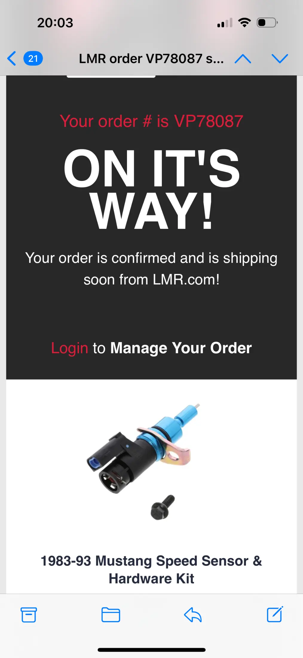

So I checked the tires and they are the standard size that came on them 245/45 R 17 and the rear end is 3.08. I see that they came with a standard 20 tooth gear. I did order a speed sensor but it does not come with the 20 tooth gear. I’ll have to pull mine and see what kinda shape it’s in. Attached is what I ordered for the speed sensor.

Unfortunately that speed sensor will not affect the speedometer at all. The speedo in the dash is mechanically connected to the trans output shaft. So the gear turns the shaft which turns the speedo cable and so on. A new VSS would be needed if you have a code 29 in which case you would have drivability issues as well...mainly stalling at red lights. The VSS is also used for cruise control but a 1993 cobra doesn't have cruise.
I'd likely return the VSS and instead check your current speedo gear and verify it is in fact a 20 tooth. Also, when you remove the current VSS, shine a flashlight into the trans and look at the speedo drive gear color. Yellow would be a 7 tooth and green/white would be 8 tooth.
A 93 cobra would have an 8 tooth drive gear on the trans (if original). Often times when a trans is rebuilt, folks put in a 7 tooth gear. It's also possible the original trans blew up and someone replaced it with a pre-90 T5 that has a 7-tooth drive gear.
