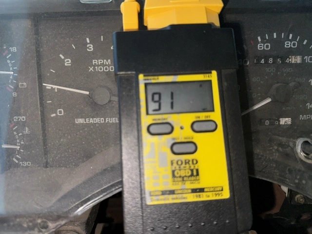

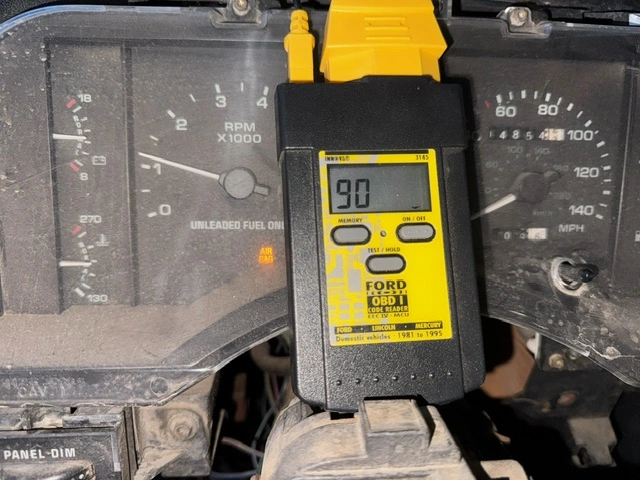

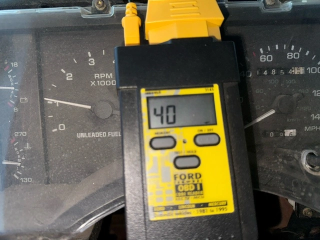

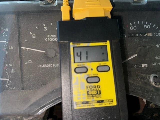

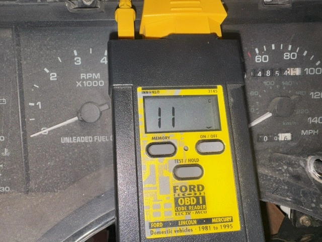

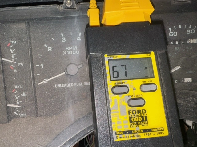

Howdy there folks;
Here is an update to this post from last week. As suggested to swapped the wire I dis so for cylinders 2 & 3 at the spark plug and distributor cap as well.
AND IT WORKED!!!
The amount of power was awesome!! It sure feels like a V8. The second reason I bought the car. The first is of course, it's a fox body.
I pulled codes after a trip to the car wash, Denny's and Costco in that order. I got pics below to show you folks.
KOEO
There is a code 10 but pic was not good
KOER
I am still running lean and once again I am asking for your suggestions.
A big thanks to "General karthief" for his suggestion of swapping the wire. It certainly that was the fix.
