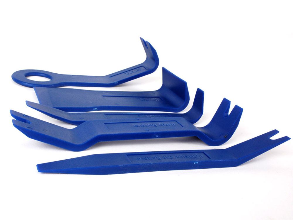

aar0s Founding Member Dec 20, 1998 1,015 55 69 Jan 15, 2012 #9 Jan 15, 2012 #9 The title and what the OP are asking about are different things. I thought that they were asking about the trim around the windshield from the title but they are asking about the belt trim that runs under the side windows. If you were removing the trim at the bottom of the windshield on either side of the cowl then it would be real easy to scratch the paint (and break the tabs on the trim) unless you were using these http://s.shld.net/is/image/Sears/sp...n=1&qlt=90,0&resMode=sharp&op_usm=0.9,0.5,0,0 http://www.sears.com/shc/s/p_10153_...o=1&blockType=G1&prdNo=1&i_cntr=1326690251978 I bought mine off the tool truck and got bent on them, sears or Harbor Freight will have them cheep enough, buy the right tool and save the headache.
