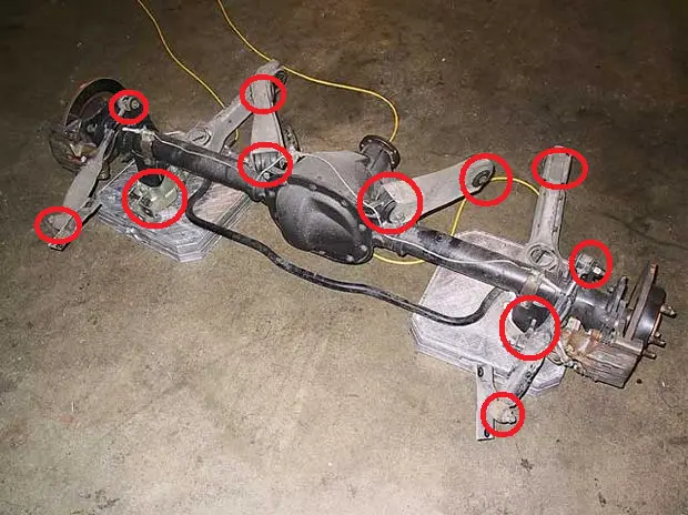

i also am having a suspension prob. i think. when i hit a bump whil turning the tail end hops sideways. i know i have bump steer probs up front but what can cause the rear to jump around. also it dose the same on freeway so i try not to go over 55
all stock far as i know. just bought it. it does have a set of wide 17s on it running 225/50 rear and 225/45 front. i get a clunk from front when i turn but i know that is a different problem
Yeah, you need to get a look at the rear end: Control arms, bushings, and torque boxes.
The circles are all the bushing locations.
The two small actuators furthest outward are the quad shocks (4 outermost circles). Those don't locate your axle laterally but they may still be worn and can cause other issues.
All the rest are what locate your axle beneath the car. If the bushings are original equipment then they are more than likely shot to hell. Inspect them or have them inspected.
If they're all toast, it's probably time for some new control arms.
I just saw that this is a 2.3? I'm sure that your torque boxes are fine.
