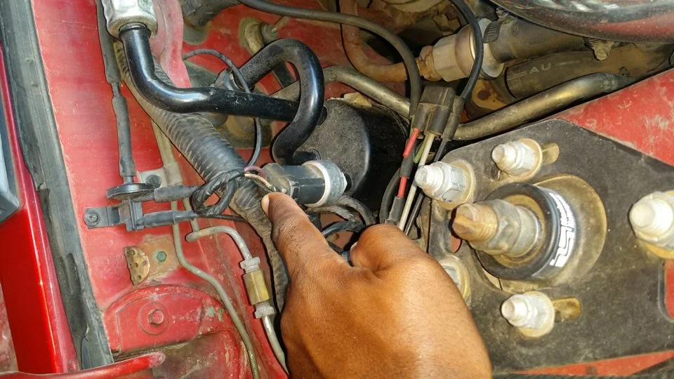

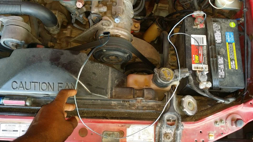

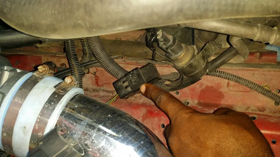

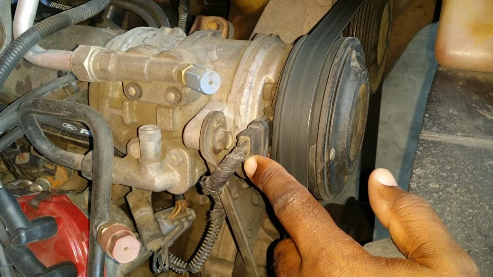

I have a 1993 mustang that I cant seem to get the ac to work. I have checked the fuses, and they are all good, also i have changed the relays as well, but still no go. I have pointed out in my pics the areas under the hood that I have either checked or put a test light on. Also there is a pic that I hot wired the ac to see if the clutch was burned out, and the ac worked perfectly when I rigged a wire from the battery to the compressor. Can someone please help me I'm running out of ideas. Also im wondering if all of this ties in with the maf sensor because I bought a new one thinking it was bad, and everytime I plug it in my car stalls. Please help
Your first picture is the low pressure switch. If their is no enough refrigerant in the system in will not turn on. Pull that plug off and jump it. If the compressor turns on you need refrigerant. Has it been converted to 134a?

If it doesn't not turn on without jumpering the low pressure safety switch it is probably low on refrigerant.
It has the R134 conversion ports on it, so it is probably converted to R134 or Freeze12,(R134 with additives). That means you can get more refrigerant at Wal-Mart (usually best price) or the local auto parts store.
