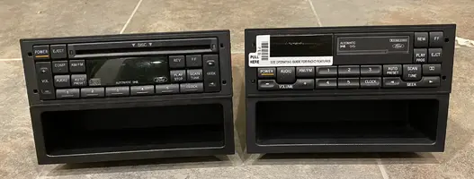

The two PREMIUM radio option for 1993 look like below. There was a non-premium cassette player in 1993 that looks similar, but has manual
FF/REV buttons. It is not compatible with the 1993 premium amp setup

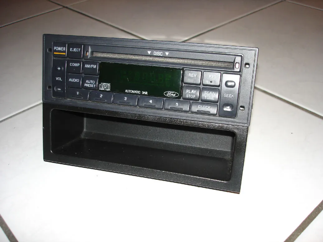

Here you can see the bottom plate in which the storage tray attached. These interchange between the CD players, so it was an easy swap. Some of the bottom plates clip on, while others are held on by small torx screws. Remove, and swap. Very easy. Now the bottom storage cubby fits on.

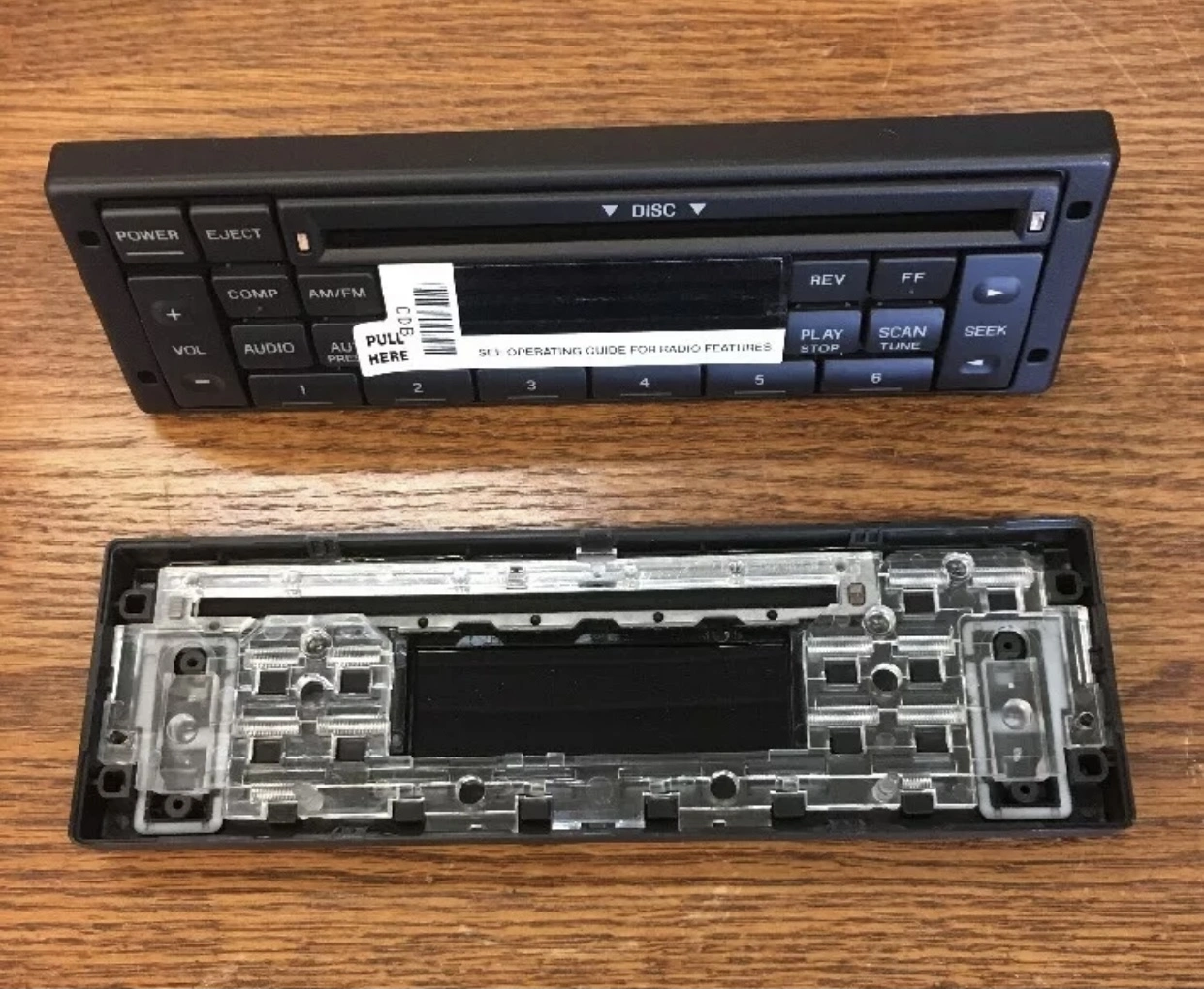

You can see the subtle differences between the faceplates below. Top one with the square edges is the Mustang. The contour radio has rounded edges. The faceplates come off very easily, but you need to be careful. Simply pry the faceplate off VERY carefully. I had already begun disassembling the faceplates to swap the good buttons over to the cd player face with square edges

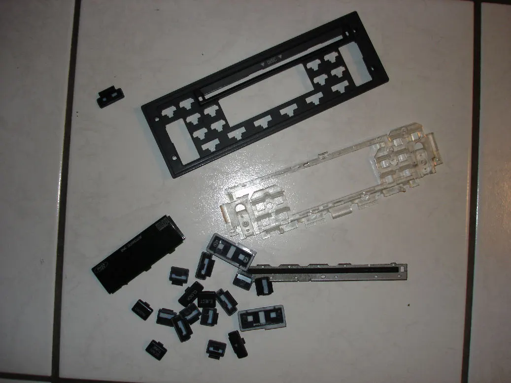

The faceplates come apart very easily. All you need to do is remove the clear insert from behind by unclipping the tabs on the 4 edges. Then the buttons pretty much come out after that.
If you are using a 1993 CD player as a donor, the only button you really need to worry about is the 6th preset/CLOCK button. If your new radio has the 6th preset, you'll need to swap this over to your original 1993 faceplate. Pretty easy to do. Yes, you will lose some originality, but you are probably swapping in a Contour CD player so originality is out the window anyway.

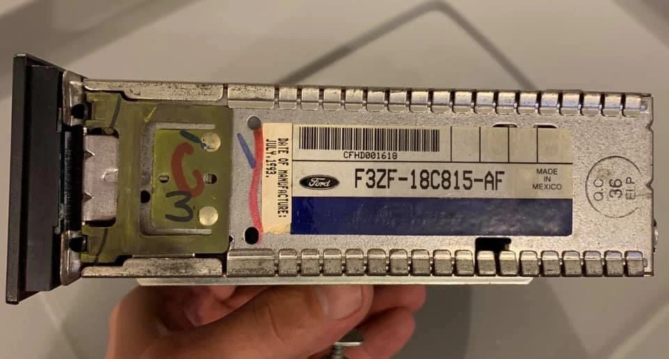

Here are the part numbers for various units if you want and try to locate some to use as Donors. The revision codes at the end (-AA, -AD) do vary so there may be more than what is listed below. I'm just listing actual part numbers I've seen
F3ZF-18C815-AC, -AD , -AE, -AF : OEM 1993 Premium radio Green Face, clock button, square face plate, bottom tray accepts storage cubby

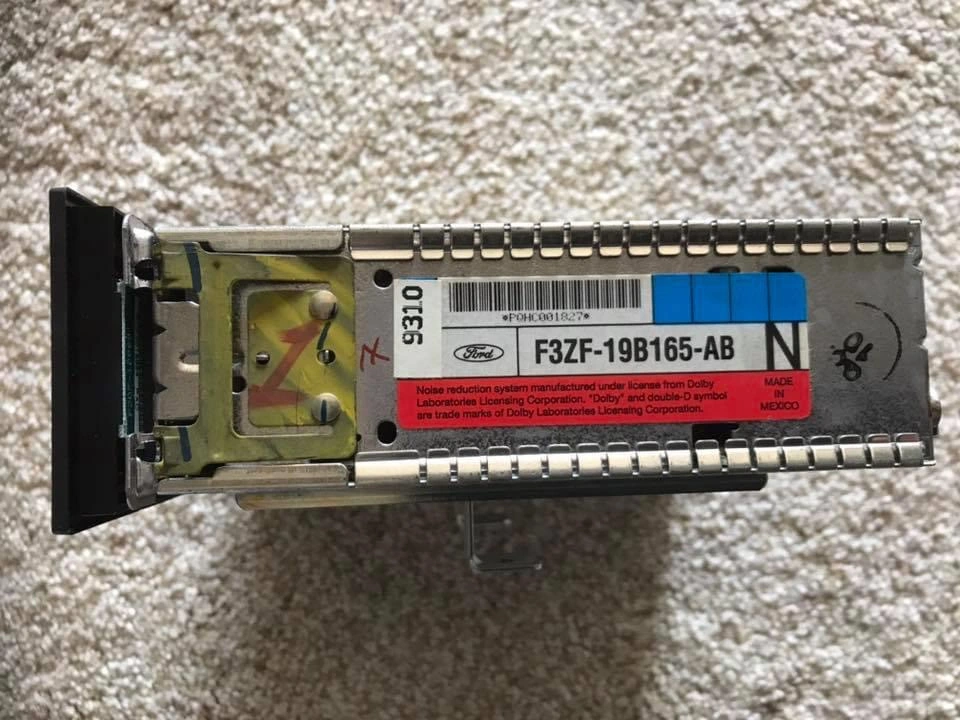

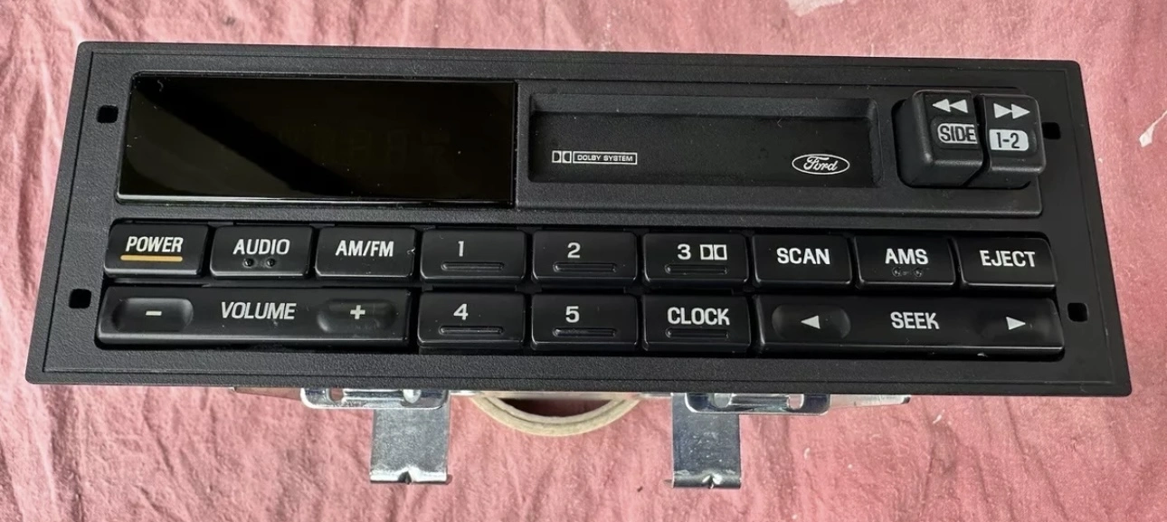

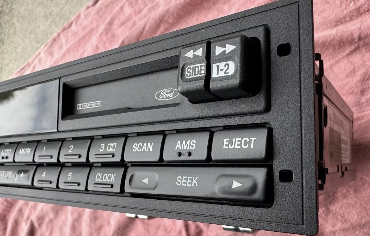

Premium Cassette players
F3ZF-19B165-AB OEM 1993 Premium Mustang Cobra cassette deck - electronic eject

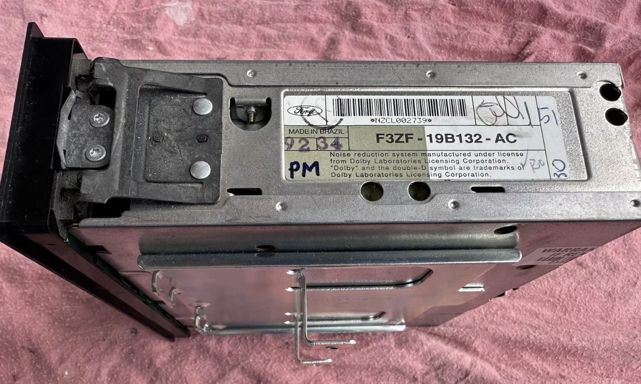

F3ZF-19B132-AC, -AD, -AE :
OEM 1993 Premium non-Cobra Mustang cassette deck - Manual eject

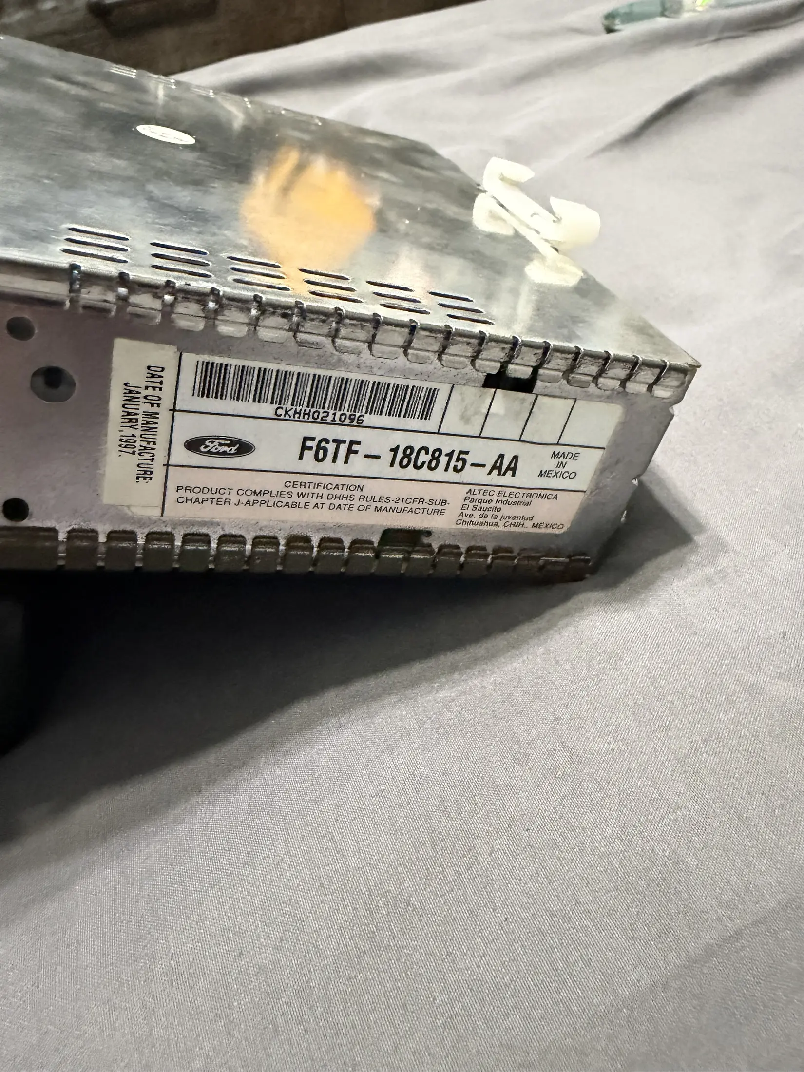

Sorry for digging up an old thread, but I recently bought a CD radio (F6TF-18C815-AA) with the flat faceplate and clock button. It works perfectly, but the faceplate has a chip in the top right corner. Mustang 5L5, do you happen to have a flat Fox-style faceplate that snaps on you’d be willing to sell? Button condition doesn’t matter since I can swap them—I’m just looking for one without cracks or chips.
Sorry, I do not have any more at this time. Kinda stopped putting these together once prices on them and parts got a little crazy

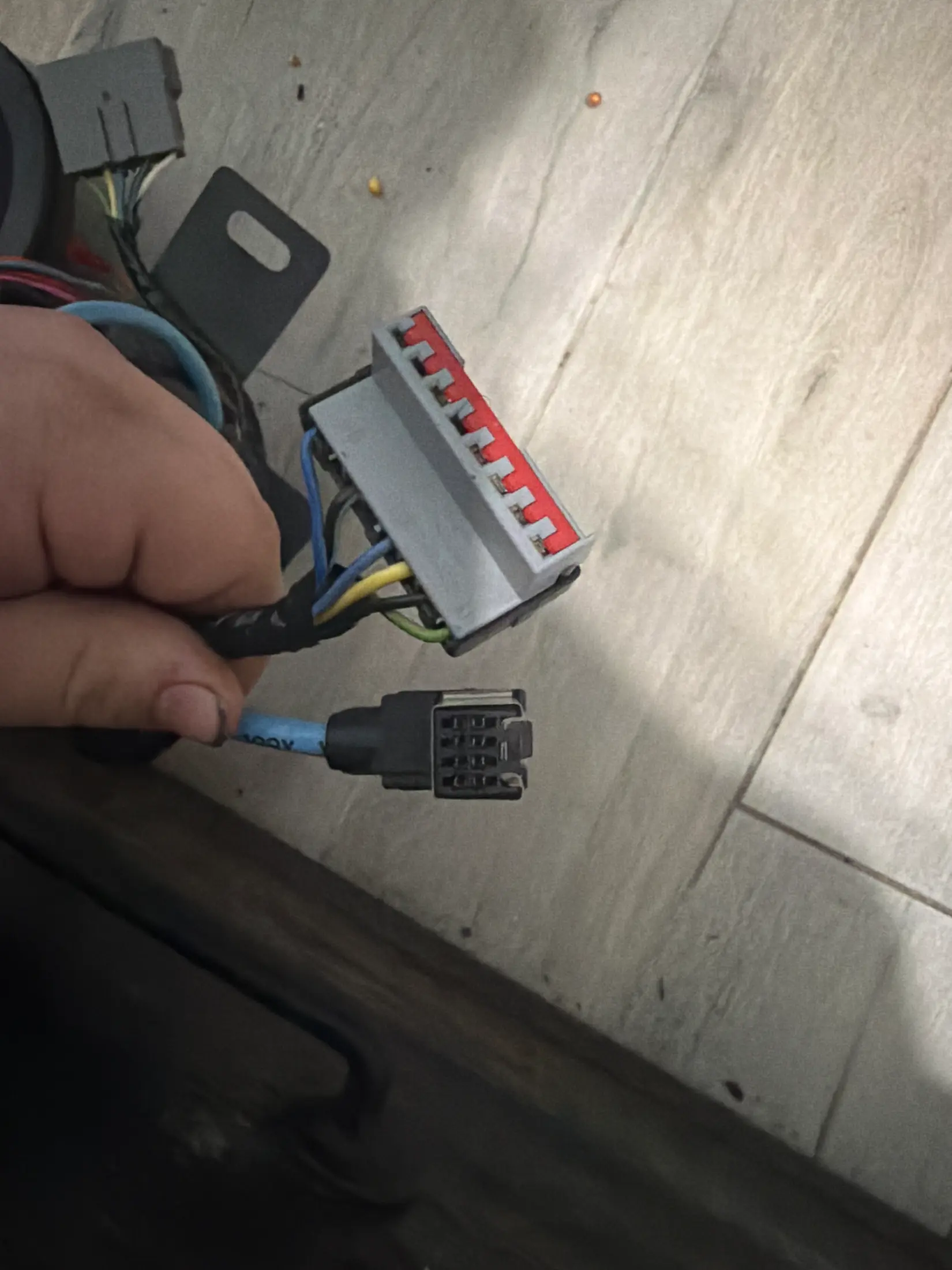

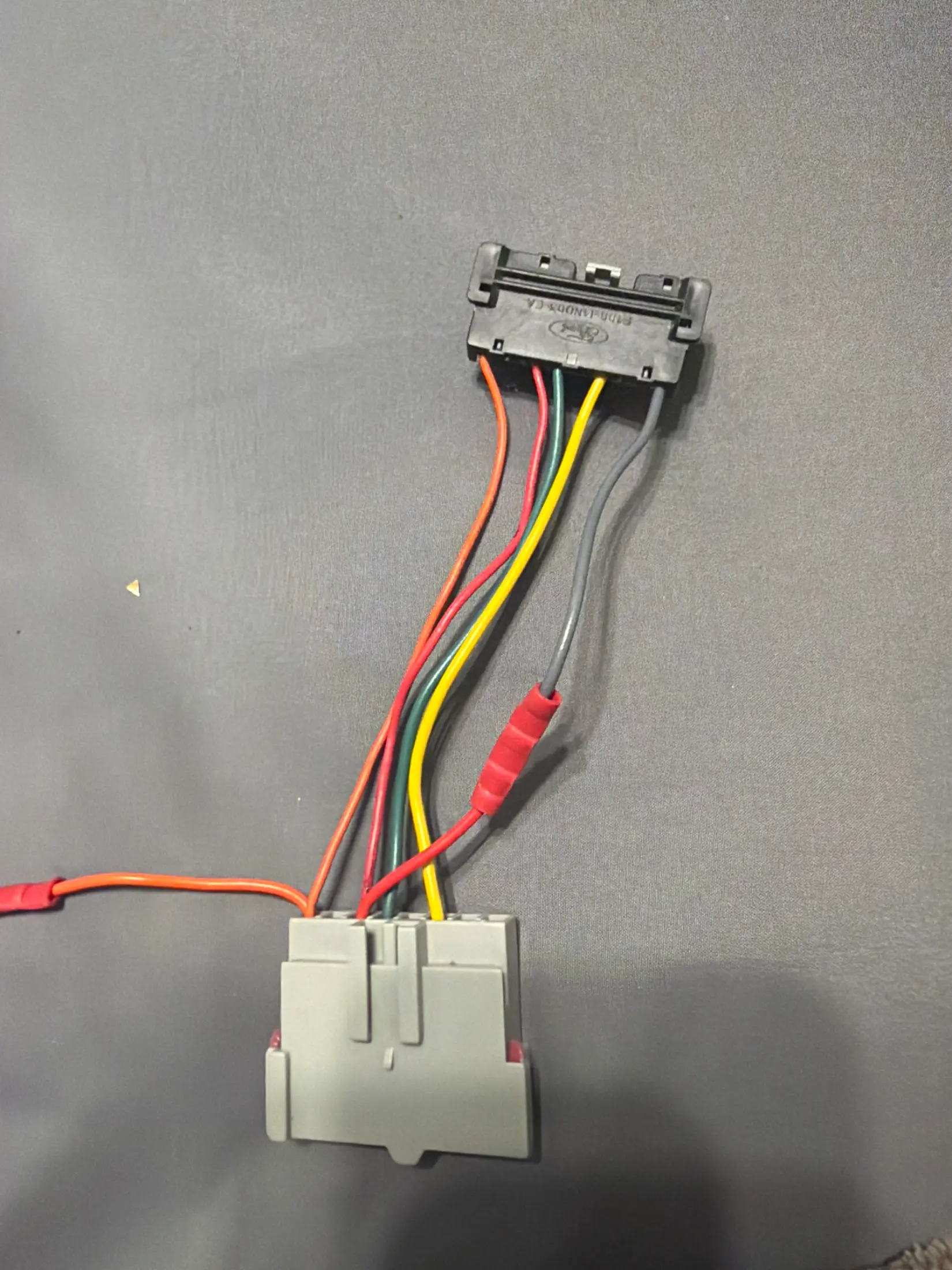

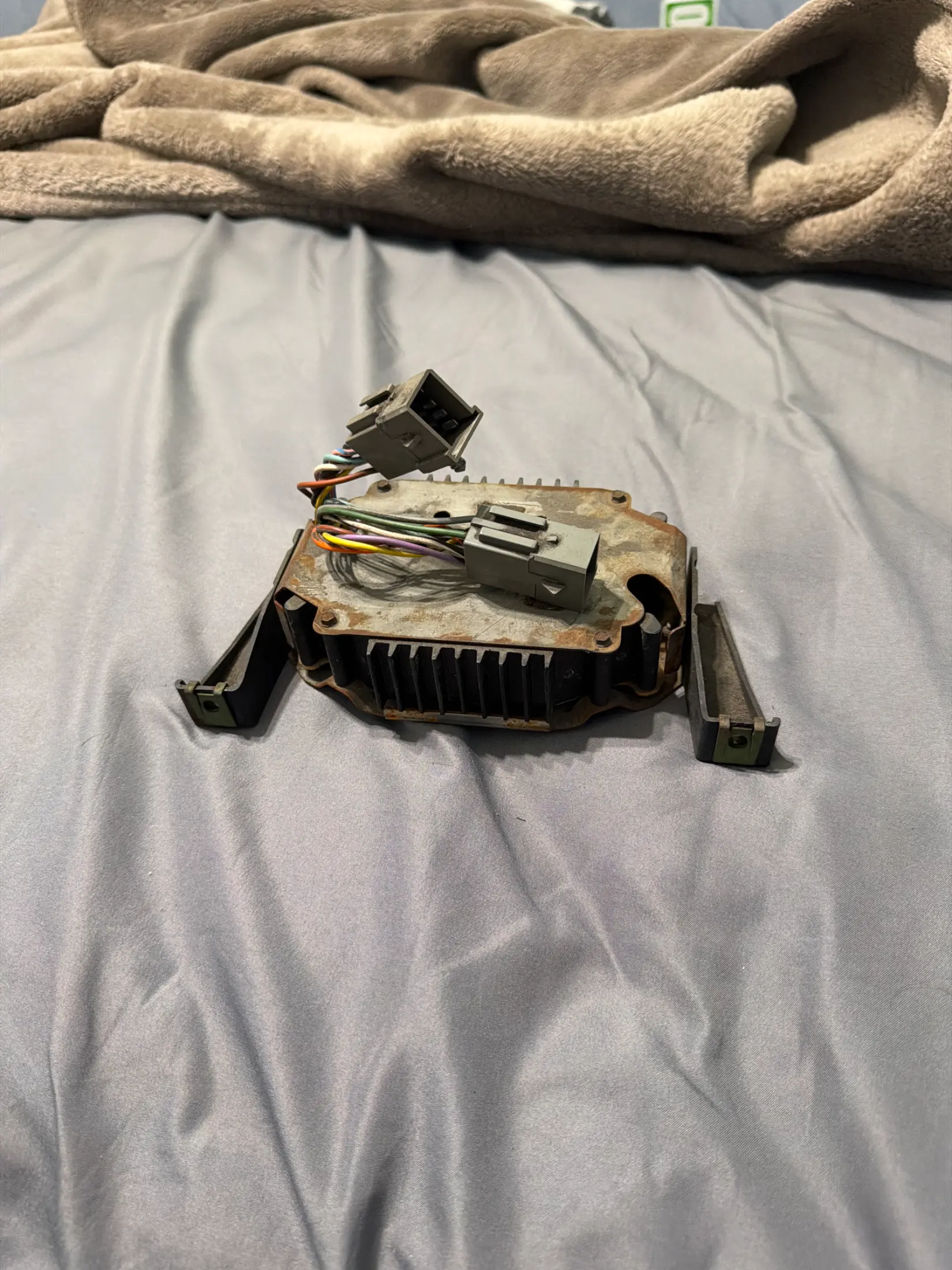

For the Cd player and all electric cassette player you need the 93 Mustang amp and harness that has one flat plug for power and one square plug for sound as seen in this photo
the 93 amp harness will plug into the 92-87 harness but you will need to make either an adapter harness or to adapt your factory wiring
this is the adapter harness I made out of a few aftermarket adapter harnesses for aftermarket radio installs the adaptation that needs to be made is to power the amplifier from that far right pin in this case grey needs to be tapped into one of the 12+ voltage wires in this case red if you have any other questions feel free to send them to me
Reactions: 91GTstroked
Thank you! I believe I have a factory amp, if it's under the passenger seat?

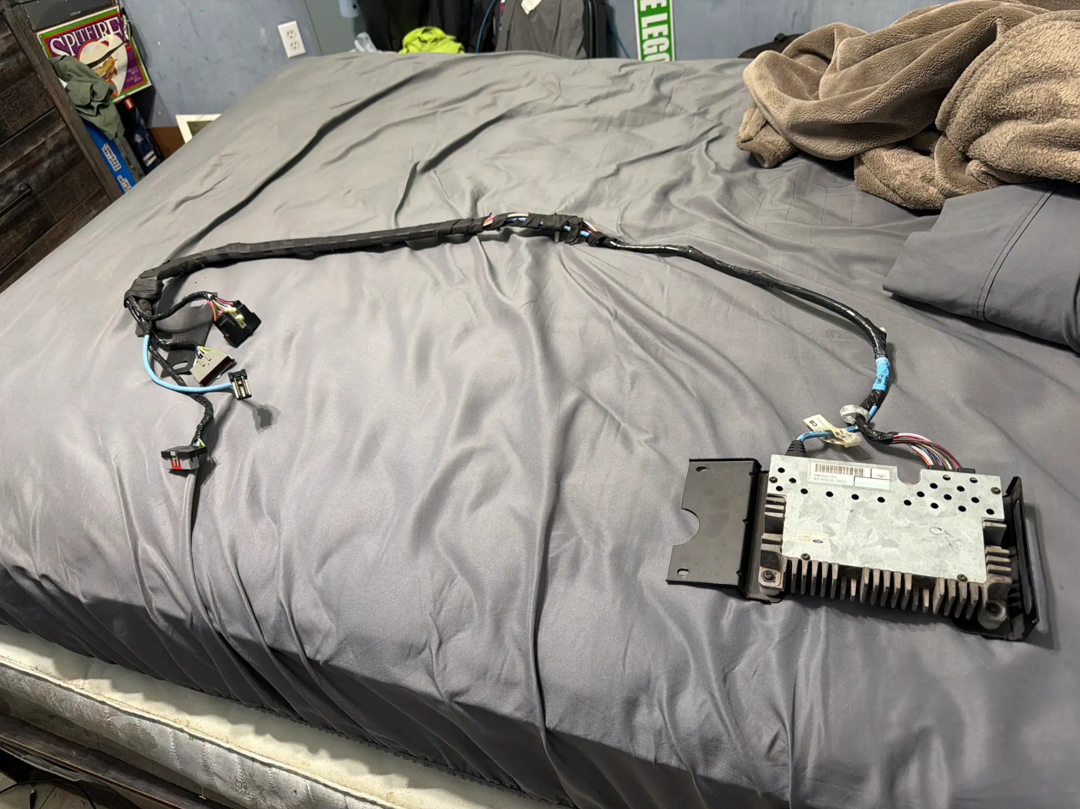

Assuming you have a 93 it should be under the passenger seat and the plugs will be behind the radio if you have a 87-92 they didn’t come with this specific amp it’s a premium sound amp and the harness runs beneath the carpet instead they came with the football amp that is located behind the factory radio and has two square plugs
this is my football amp from my ‘91
this is the ‘93 premium sound amp I will be installing into my car to support my cd player install
