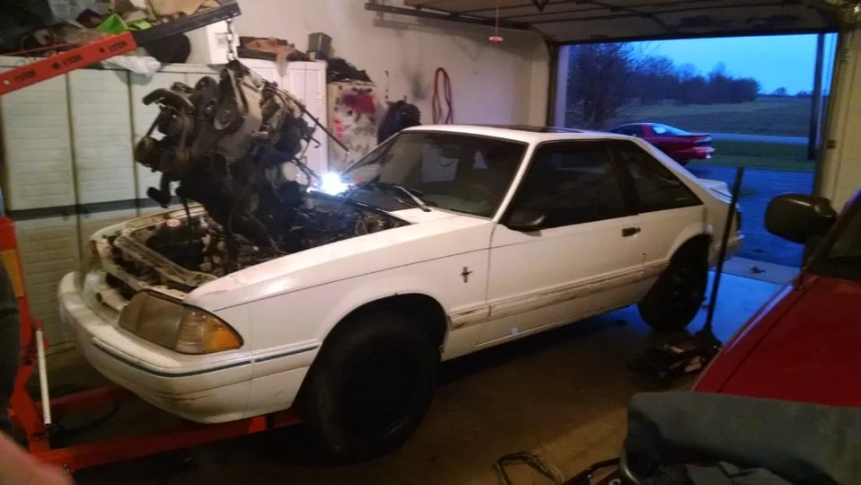

I am new to fords I am a Chevy guy but I've always liked fox mustangs and I have a 93 4cyl but I pulled the engine and tranny (automatic) now I pretty much have 10000 questions on what to do next. I know I want to run a 302 or 351w and stay automatic but I need help on what all I need and have to do to make this all happen within budget

I'm doing the same thing right now. Either way you go...you need sub frame connectors that have the seat supports on them. Knowing which trans you'll use has a lot to do with trans cross member choices. First thong ....clean the engine bay.lol
