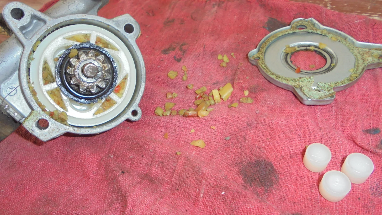

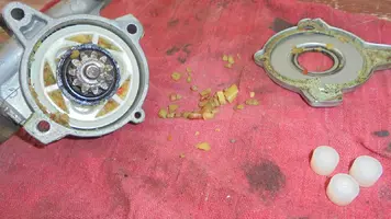

I just did my drivers rear on my 95 vert and my drivers door one. Had the same symptoms. When I took the motor out and reconnected the power wire, it spun and spun but when installed it needed "help", so I took it apart and sure enough found this..also from not using the rear window, it was still having a hard time going up all the way but some grease on the regulator slides fixed that issue, now they work great..
