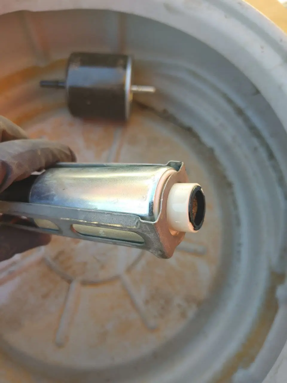

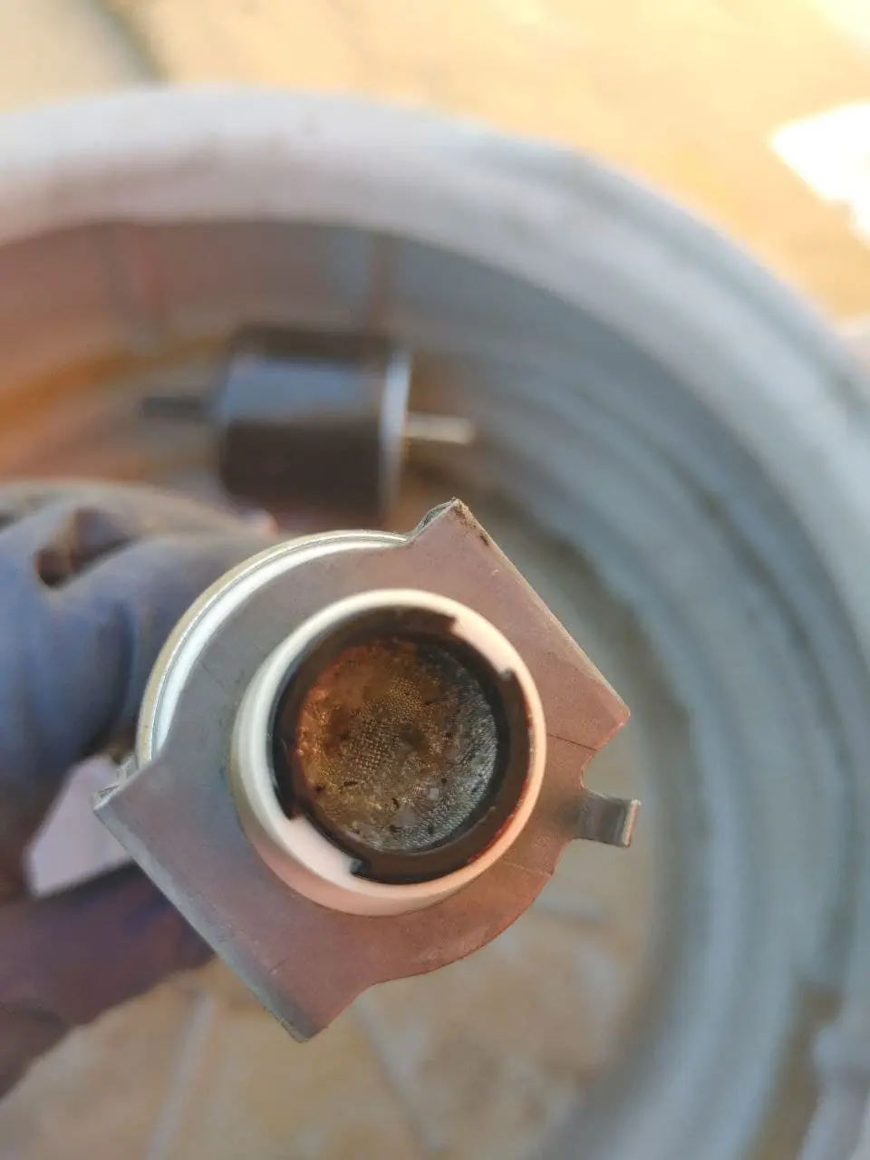

Dropped the tank today, and found a couple things. Turns out the P.O. put in a Walbro 340, not a 255; more importantly, that 340 didn't have a fuel sock on it. I couldn't find one in the tank with my boroscope, thinking it might've come lose and floated around, so I assume it was never put on.
New fuel pump came in today as well. Put about 75 or so miles on it just running errands around town, hasn't skipped a beat so far! That Aeromotive is whisper quiet, too; can't even hardly hear it prime.
