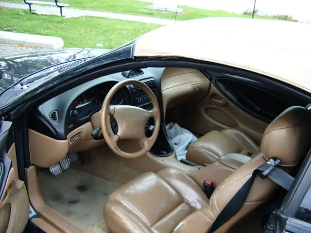

I had a factory installed alarm/keyless entry on my '94, it had a valet switch/led light right above the headlight switch, you can see it in this pic, its the little red dot:
(old pic, those floormats have since been replaced)
Mine would arm itself 30 seconds after the ignition was turned off and as far as I know, there is nothing you can do about it but put it in valet mode, but I didn't have any luck with this on mine. IIRC you have to turn the ignition to "on", then press the red button on the dash for a few seconds till it starts to flash quickly. The car should be in valet mode and should not arm itself. I could be wrong though. This never seemed to do anything for me :bang:
