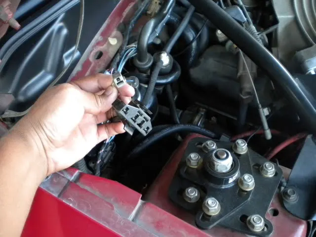

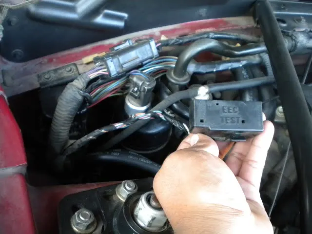

Well I guess I am blind. The only port I see is the ABS port with a red cover on the drivers side tower by the battery junction box. There is nothing that resembles a port on the passenger side of the engine bay. Any more hints please??
There are two connectors plugged into a cover and the cover is clipped to the back of the strut tower. You can either pull the connectors down out of the cover or pull the cover off of the tower and the remove the cover from the connectors.
