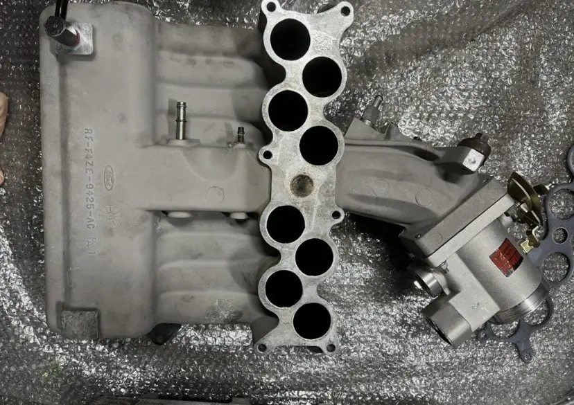

Hi all,
I have a 1995 Mustang GT (AODE) and I bought a lower intake RF-F4ZE-9K461-BC and an upper intake RF-F4ZE-9425-AC. Are Fel-Pro 1250 and Fel-Pro 1415 the correct gaskets for these intakes?
I understand that the 1995 GT and 1995 Cobra different sizes (57 mm vs. 65 mm). Do I need to buy new sensors (TPS and IAC sensors have) or is it okay to use the GT sensors? Is the throttle body gasket the same for Cobra and Professional Products throttle bodies?
Sorry for the beginner questions, but American muscle car parts are very expensive in Europe, and I just want to make sure I buy the correct gaskets.
The Cobra intake's stock throttle opening is right at 70mm. Usually the aftermarket TB gaskets support 75 mm throttle bodies, so I think any aftermarket TB gasket should work fine. Also, the stock TPS and IAC should work fine. There's no difference for the Cobra intake.
