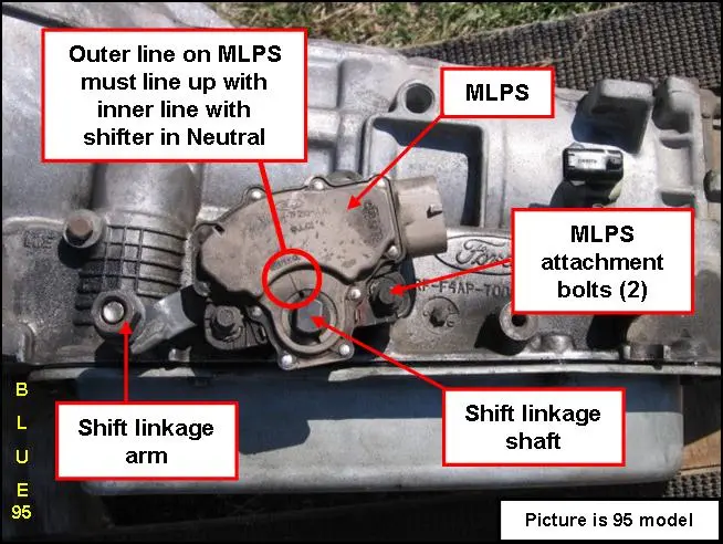

I won't 100% guarantee all that is related to the MLP Switch. But that is where I would start.
Here's a pic on how to line up the new switch.
Ok got new switch installed car now starts and RAN

As for the nutral safety switch it fixed the no start issue and the reverse light issue
