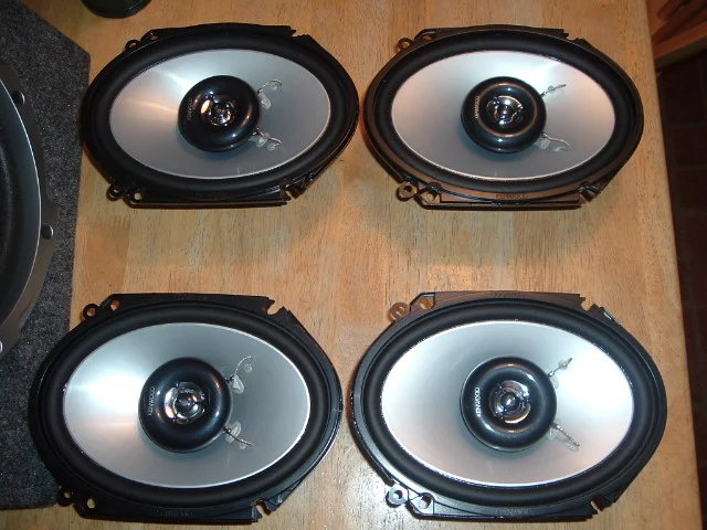

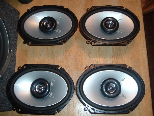

mine are 6x8 ... all 4 the same size ... Kenwood KFC-C6879ie (2 way)

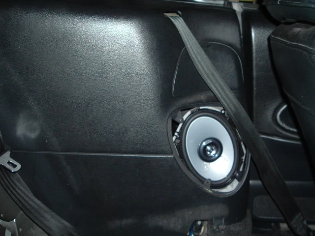

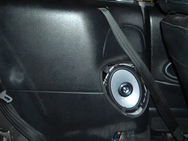

i broke my cover trying to get it off. i did not know that you have to remove the whole big panel to change the speaker. it is a pain to get to. you have to take the back seat out and all that.

Do you guys have the Mach 460? The Mach speakers are round. Obviously the 6X8's fit cause your pic, but I have only had Mach systems in my verts.
The back seat is simple to remove, simply push the pins inward on the butt seat, and there are two 10mm bolts holding the back part of the back seat in. Then lift up and remove. The quarter trims are push pins.
