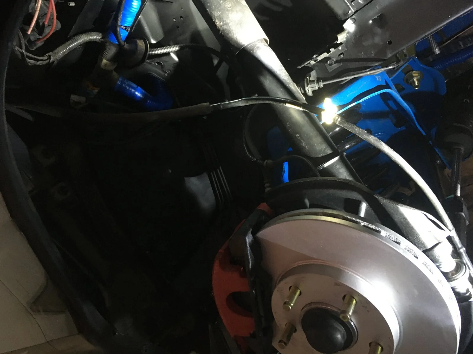

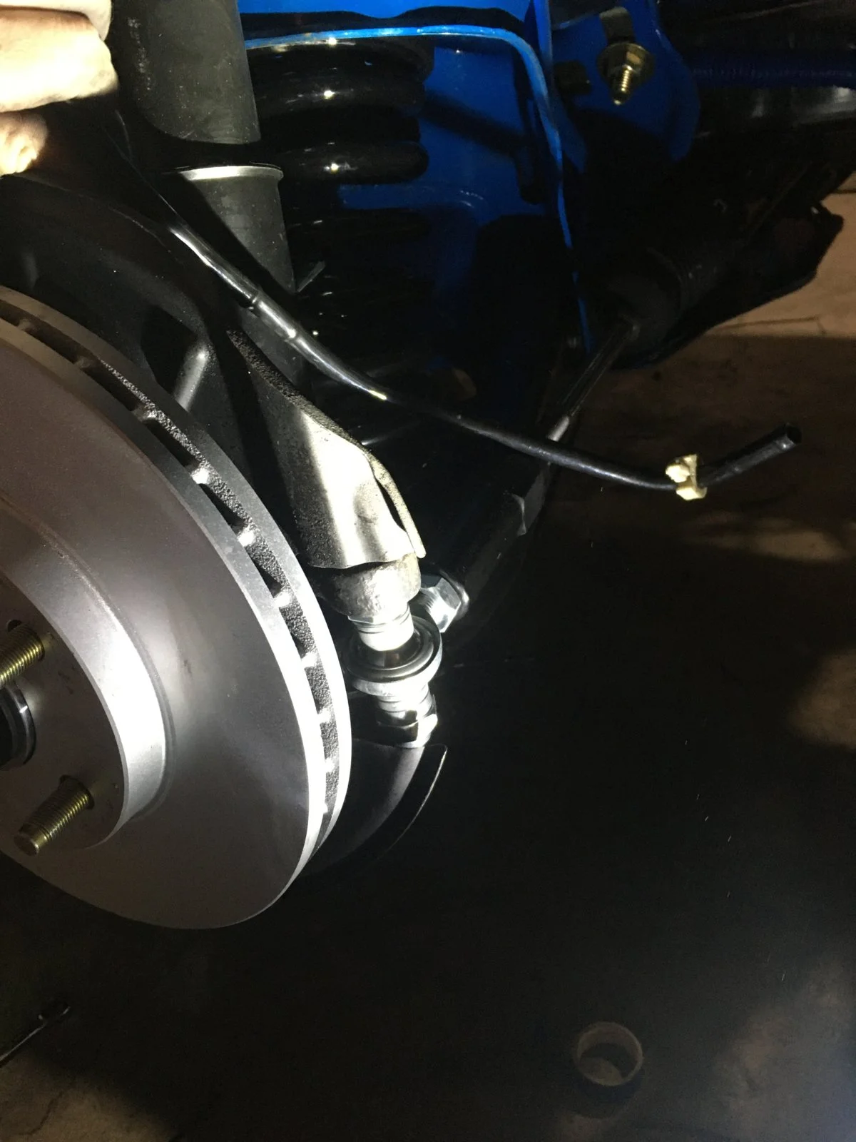

Hope everyone is doing well and staying healthy.
I wanted to say thanks for the help from everyone that chimed and helped me with this car. I’ve almost got it put back together. I installed all the wiring harnesses today which were in the trunk when I bought it. I have this one line I can’t find it’s destination. It looks like it comes from the charcoal canister and runs somewhere obviously. I have attached pics to see if anyone who has a SN95 car could pin point me in the right direction. Thank you

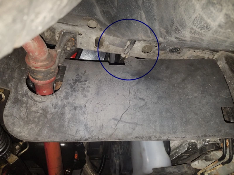

That's just a vent hose. It clips into the bottom of the frame rail right above that area.
EDIT: Took a photo from in front of my passenger front tire, and circled the end of the vent hose. Yes, it's dirty down there.
So it really doesn’t plug into anything, just clips there? Well that’s why I couldn’t find a spot for the end of that line.
Thank you for climbing under you car and doing that for me. I spend probably a good 45 minutes trying to find where that went.
Glad I could help. I remember thinking the same thing years ago, 'What does this connect to? Did something fall off?' I honestly recognized it from the white clip.
