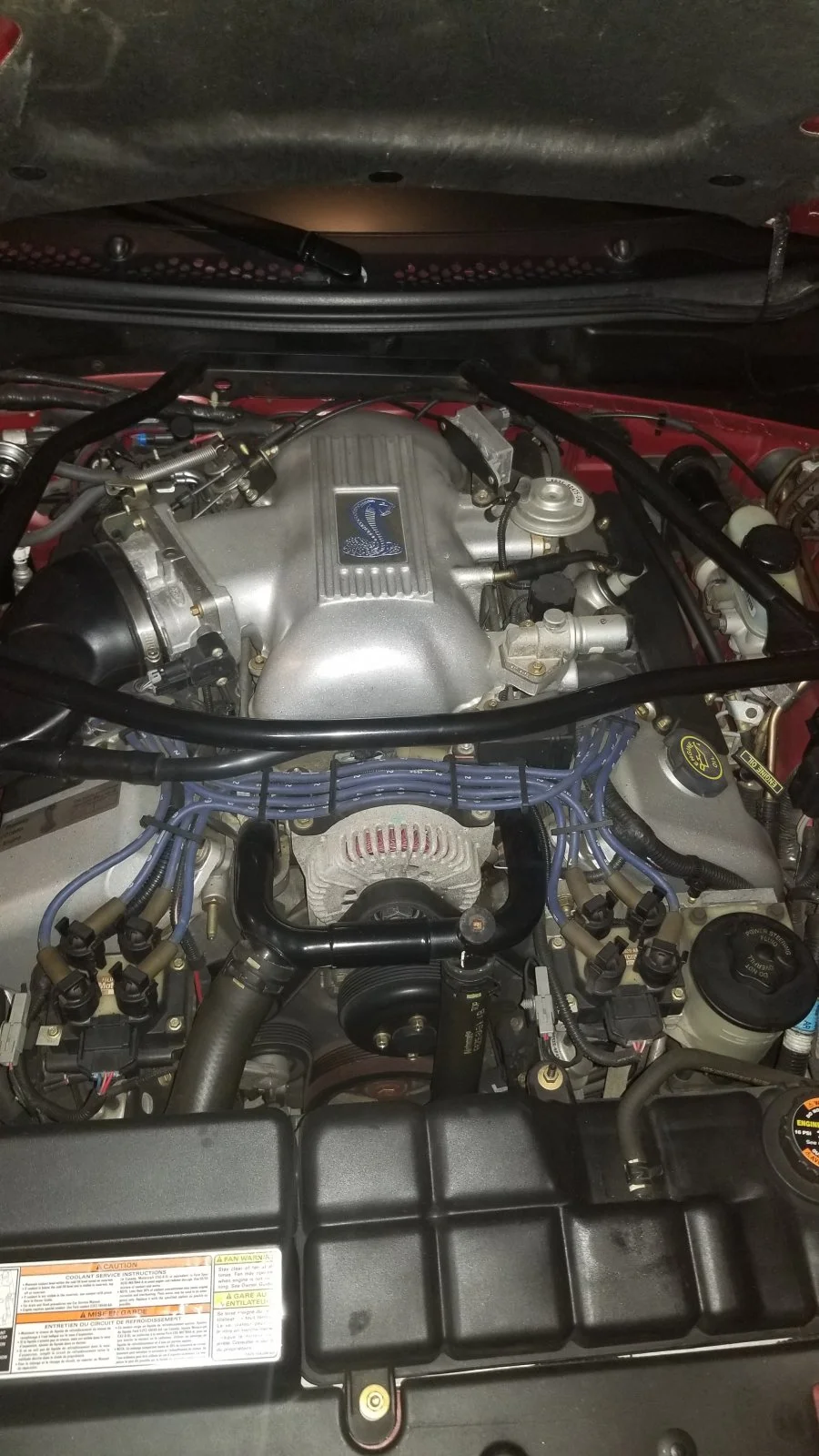

Hi, Depending on how low it is, if there’s a leak it can only be from the Pump, Steering Rack or the lines between. If there’s no Oil under where the Car was parked, nor a greasy feeling in the Engine bay, no loss after tipping the Fluid off, I’d not be concerned with it. Maybe a new Pump was installed and Fluid not topped off afterwards.
Good luck!
John
