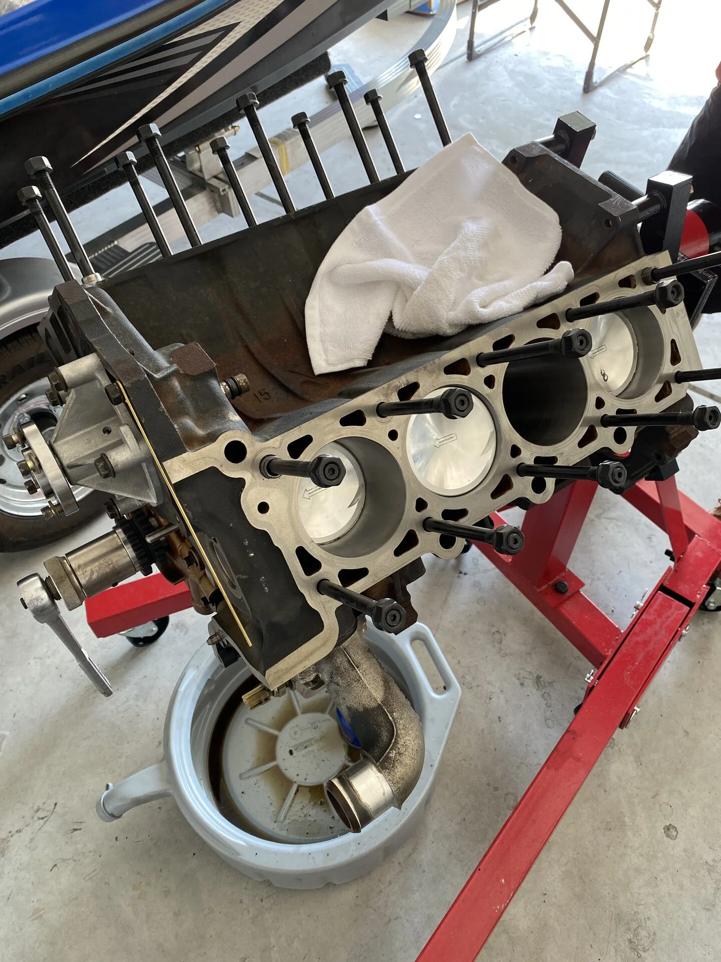

So I finally got the engine (2003 4.6) back from the machine shop. I had the shop do the following;
Bore 20 over
Install TFS stage 2 cams
Install the MMR head rebuild kit and new valves
Clean and polish the crank
Balance the crank (with the forged pistons and rods)
Deck the block
Line honed the mains
I have a question for you guys. Is it worth putting the high volume oil pump in while I have it apart?
I have heard about pickup tube to crank interference issues.
No. There is no true "high volume" pumps for these cars. Manufacturers love using that pretense. The only true oil pump upgrade is having billit gears. You wont be make nearly enough power to warrant billit gears

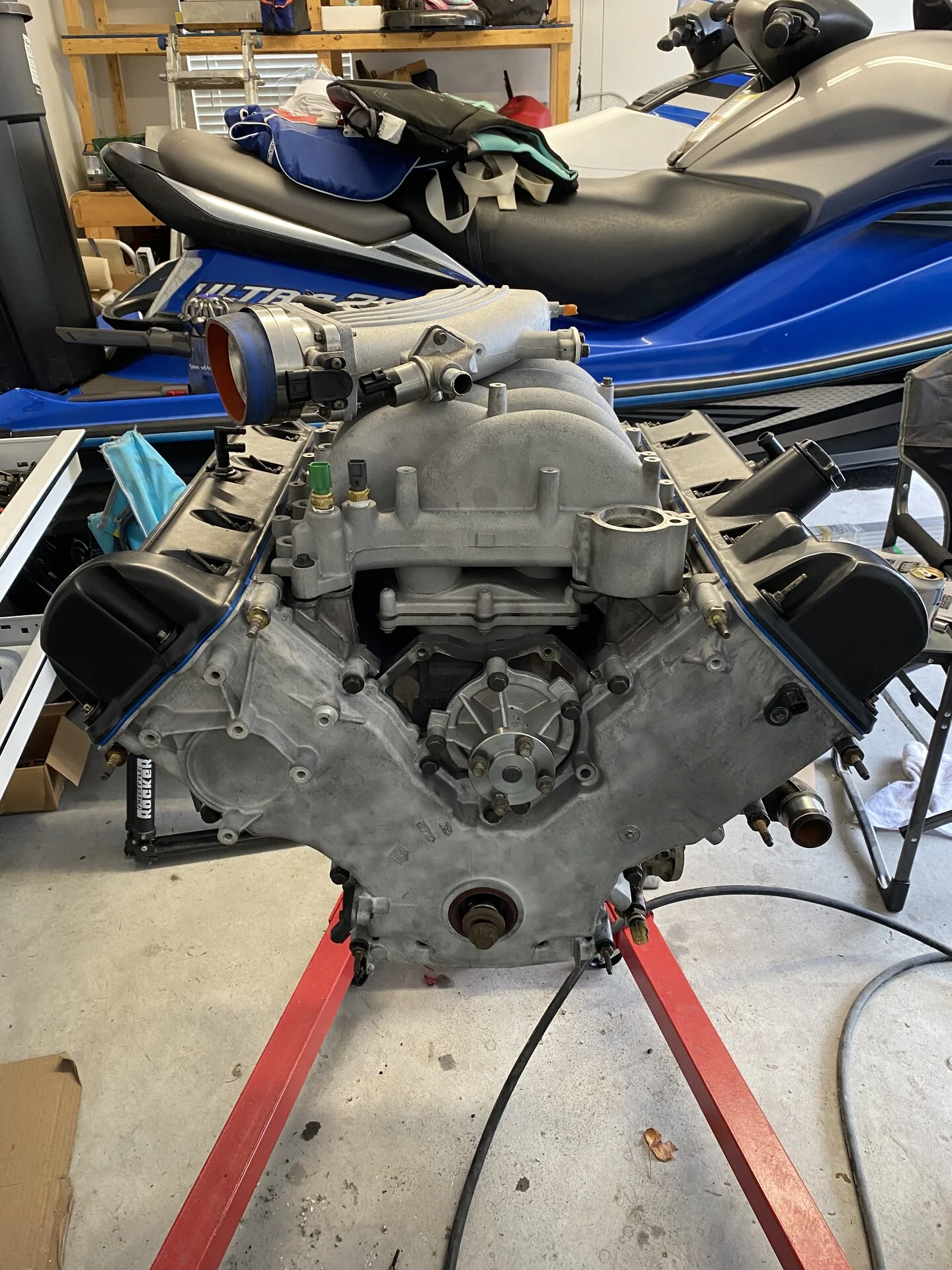

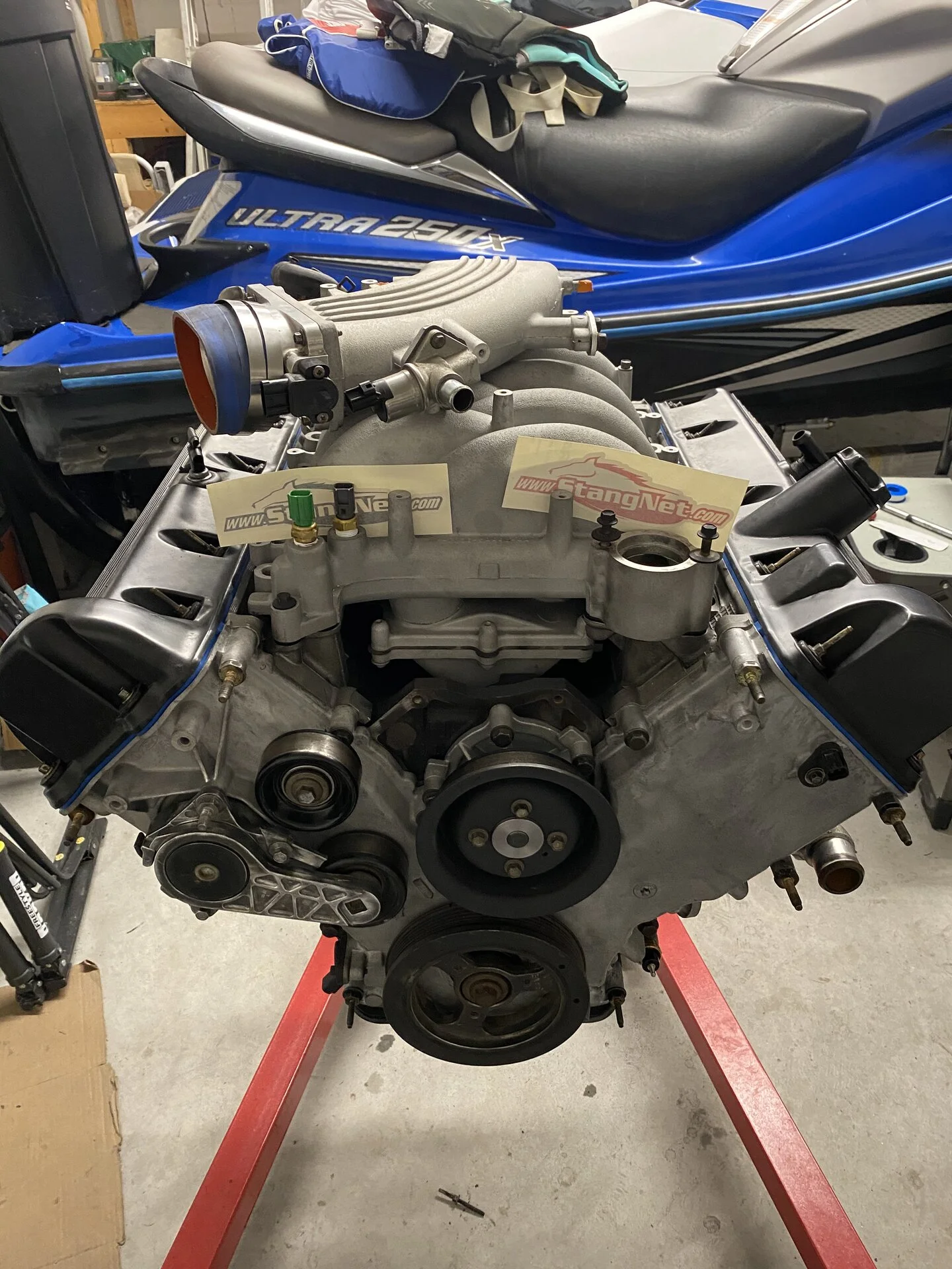

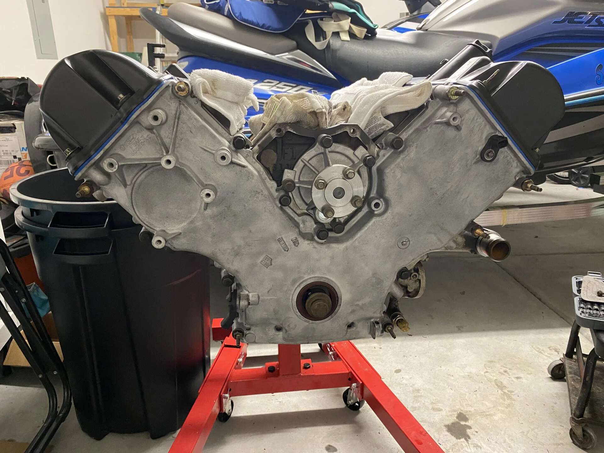

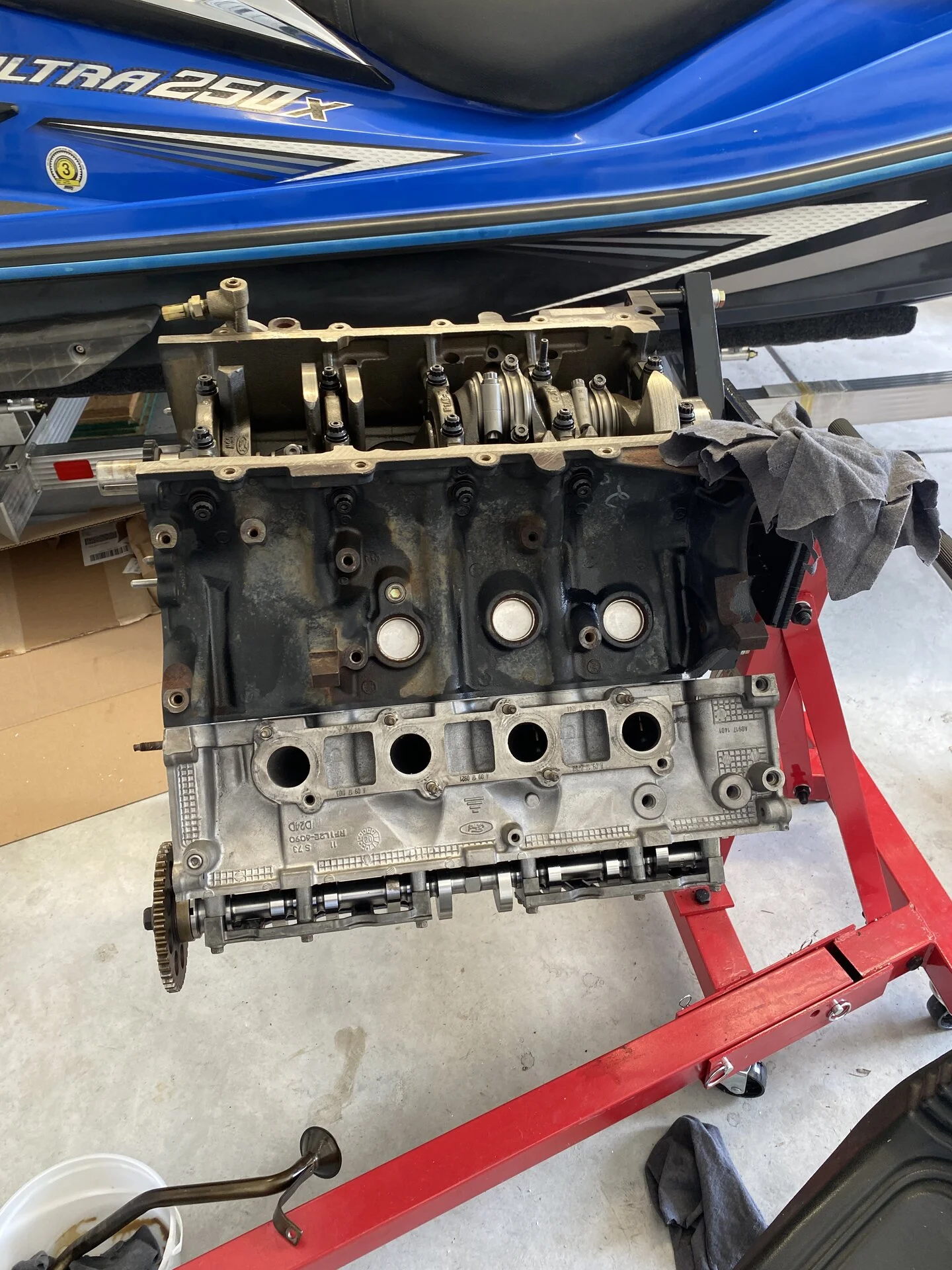

Gentlemen and Ladies, it now once again looks like an engine. I have it all assembled waiting for the car to get back from paint. Then it will be the tubular K member kit install, aluminum flywheel, clutch (still undecided on which one), aluminum drive shaft and 3.73 gears.
I have most of the parts here to finish it up. I can’t wait to have some space in the garage again!

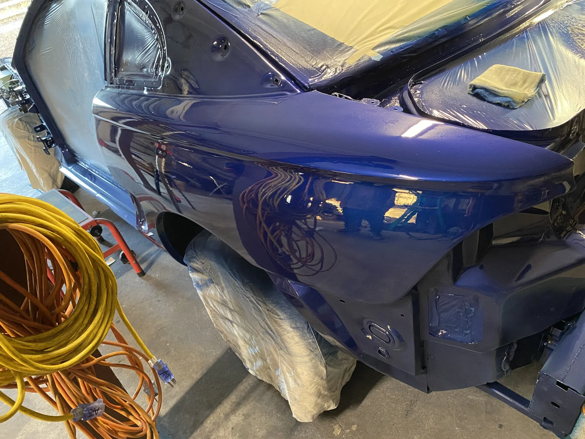

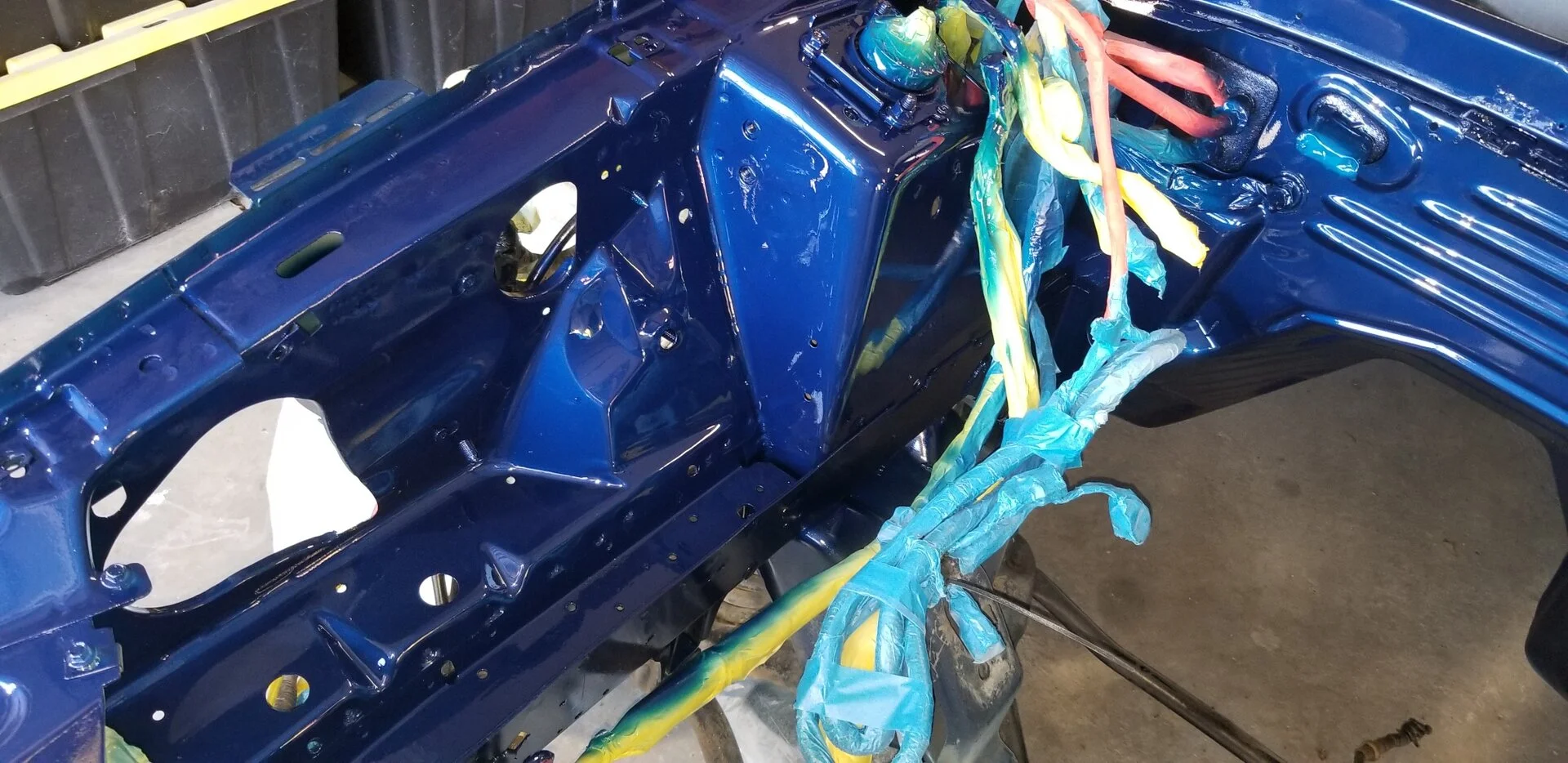

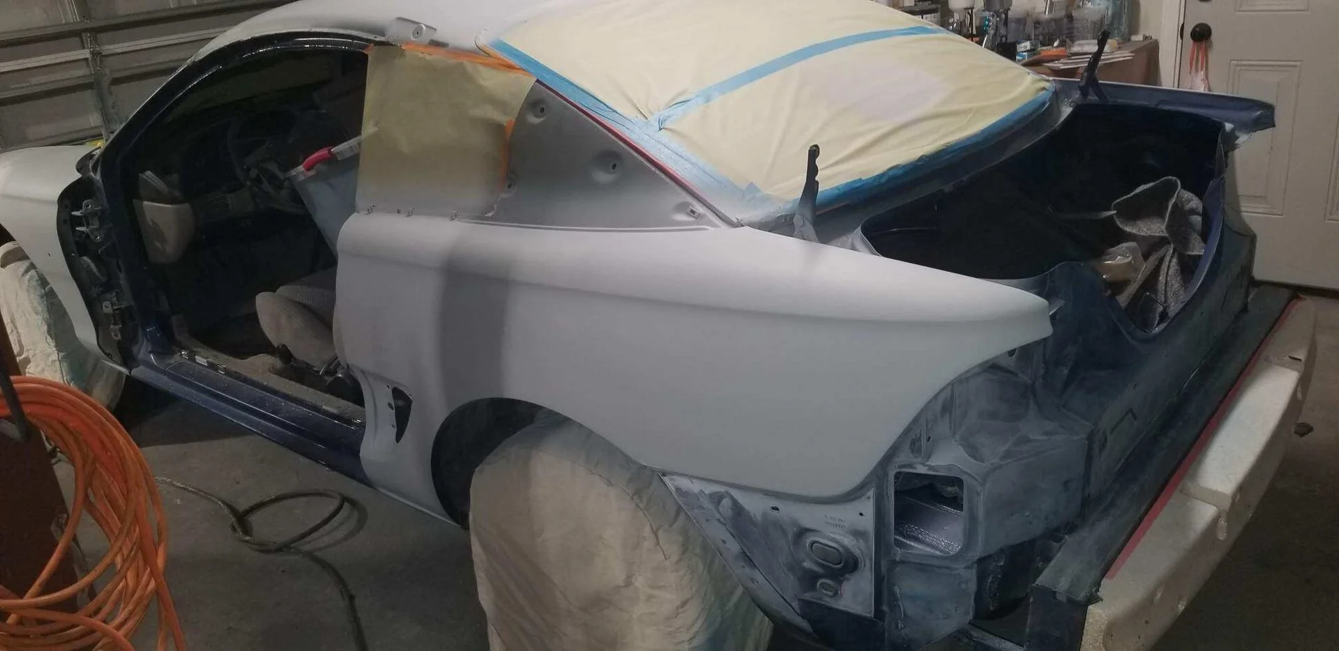

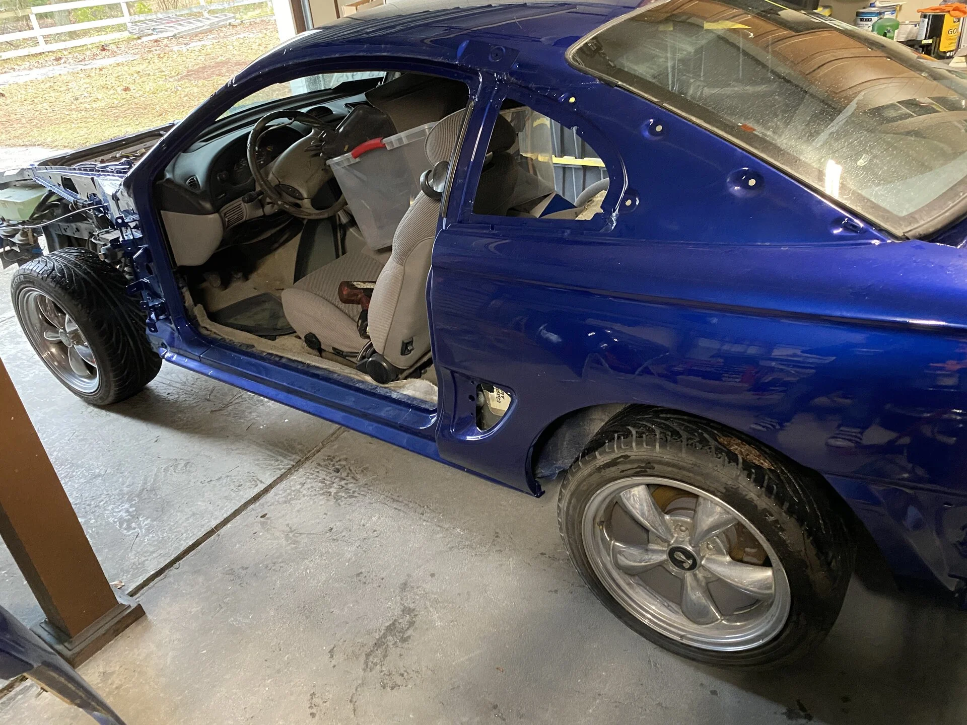

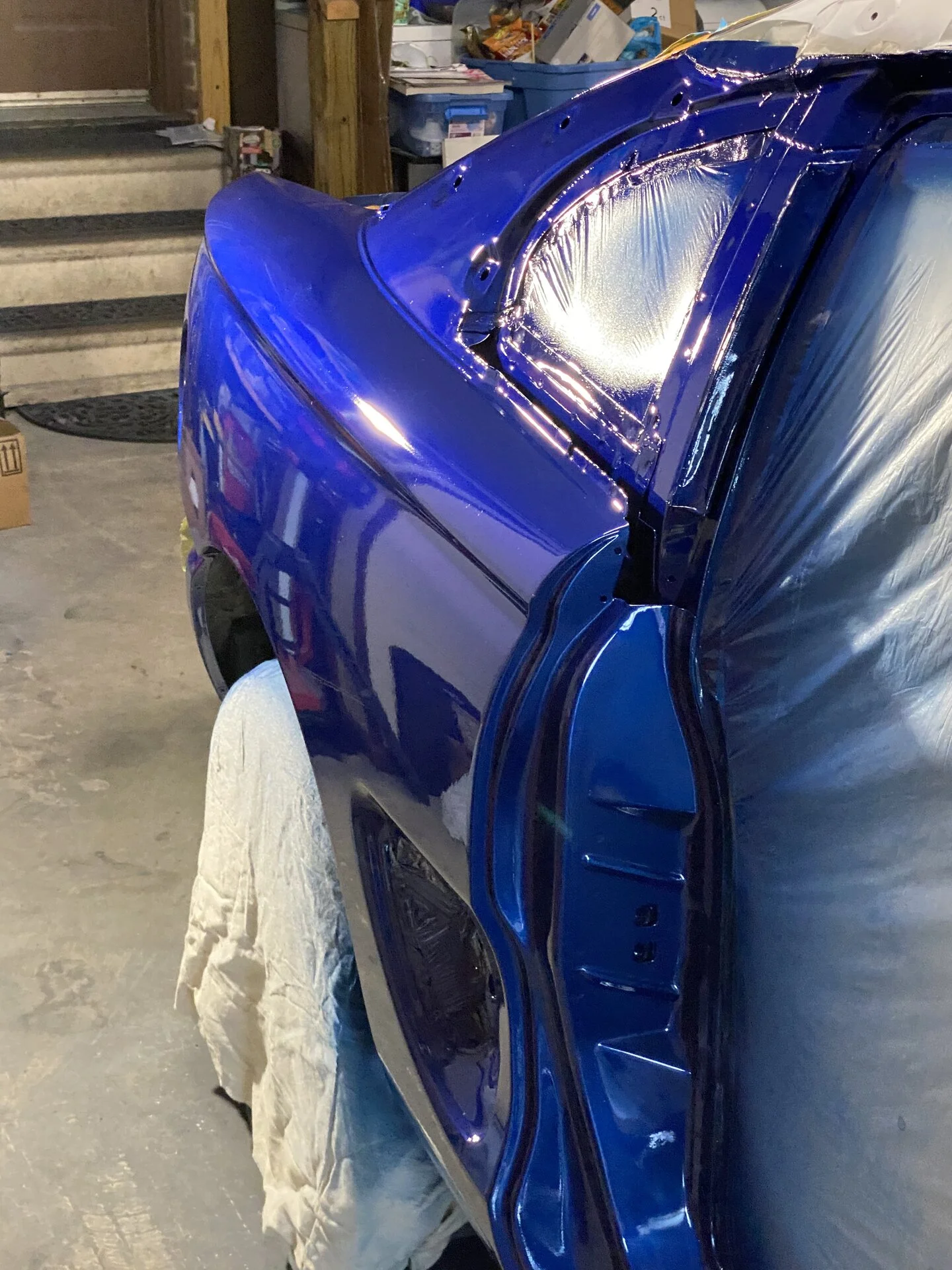

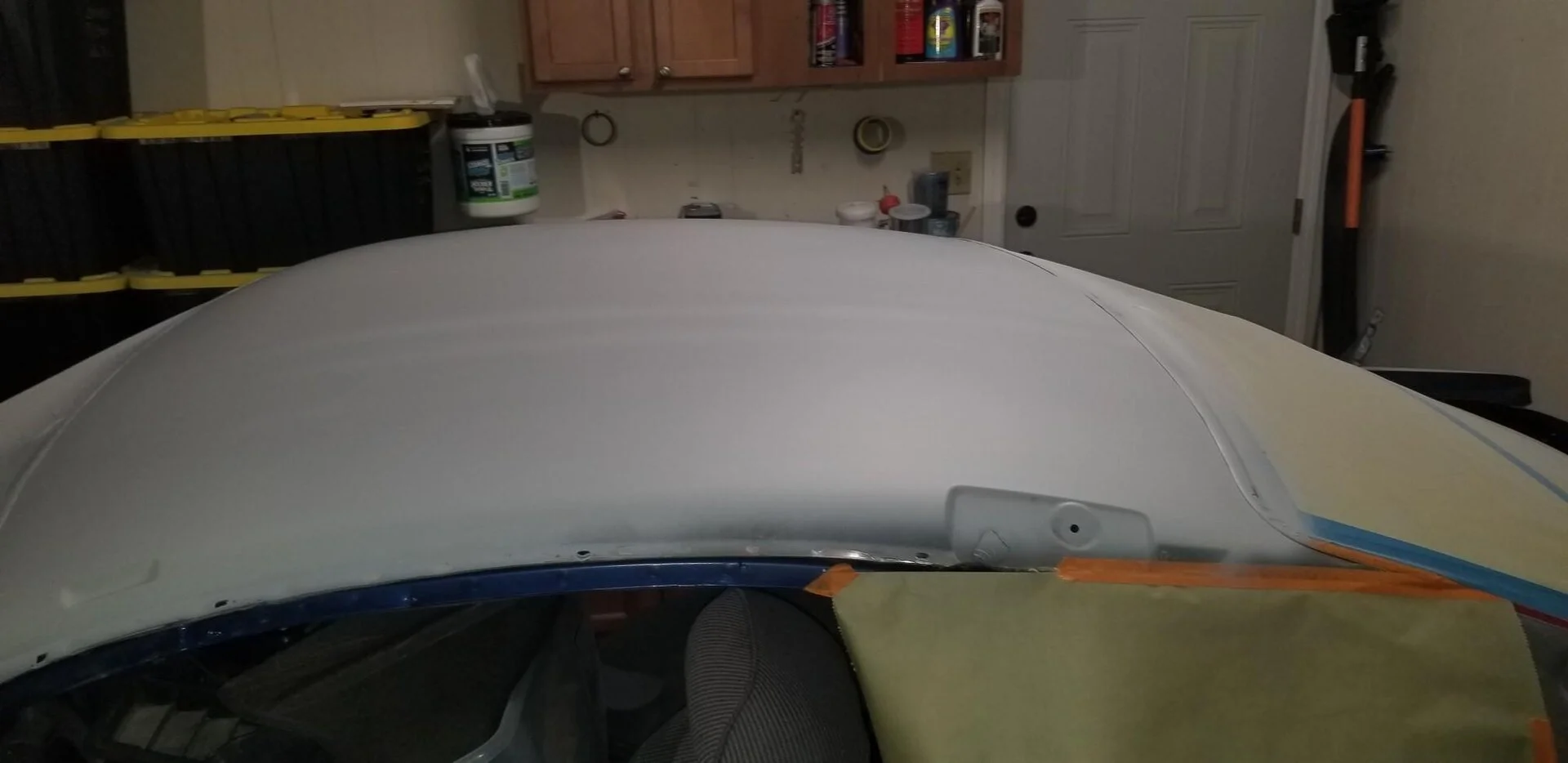

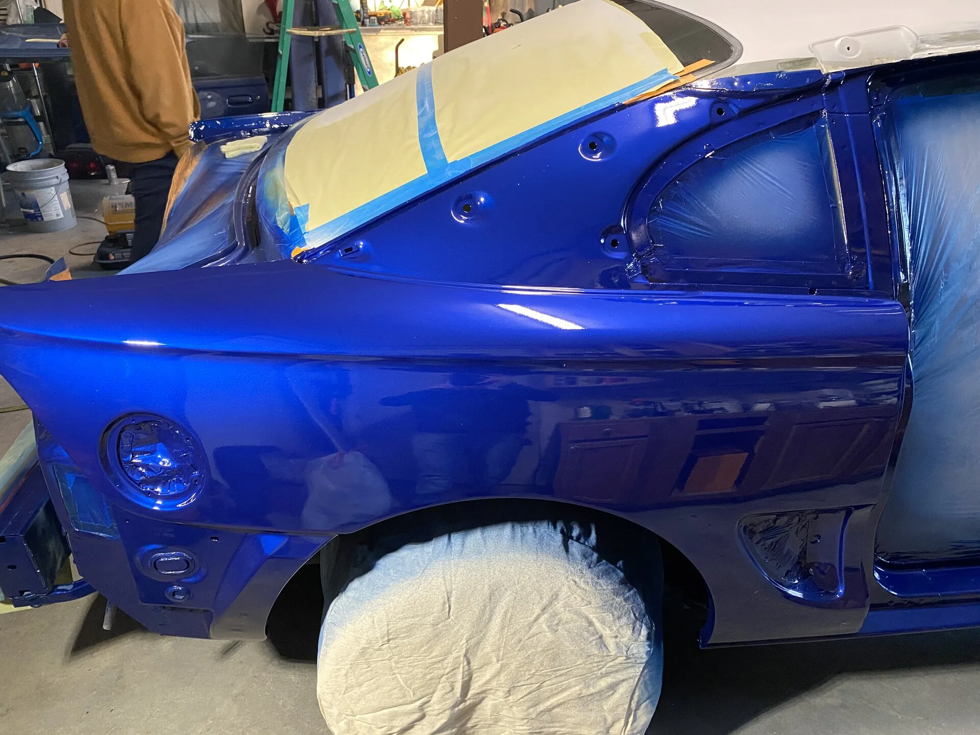

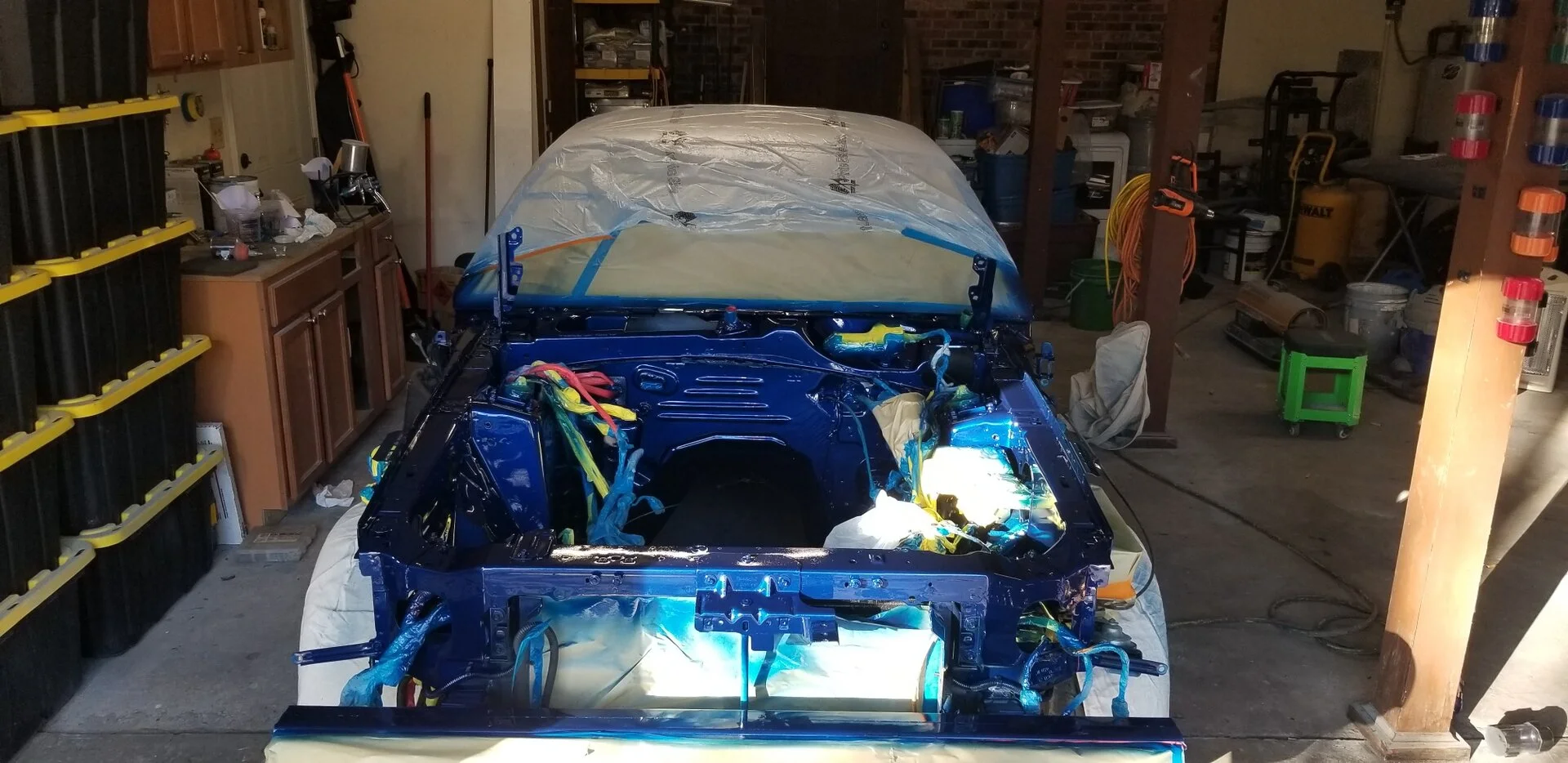

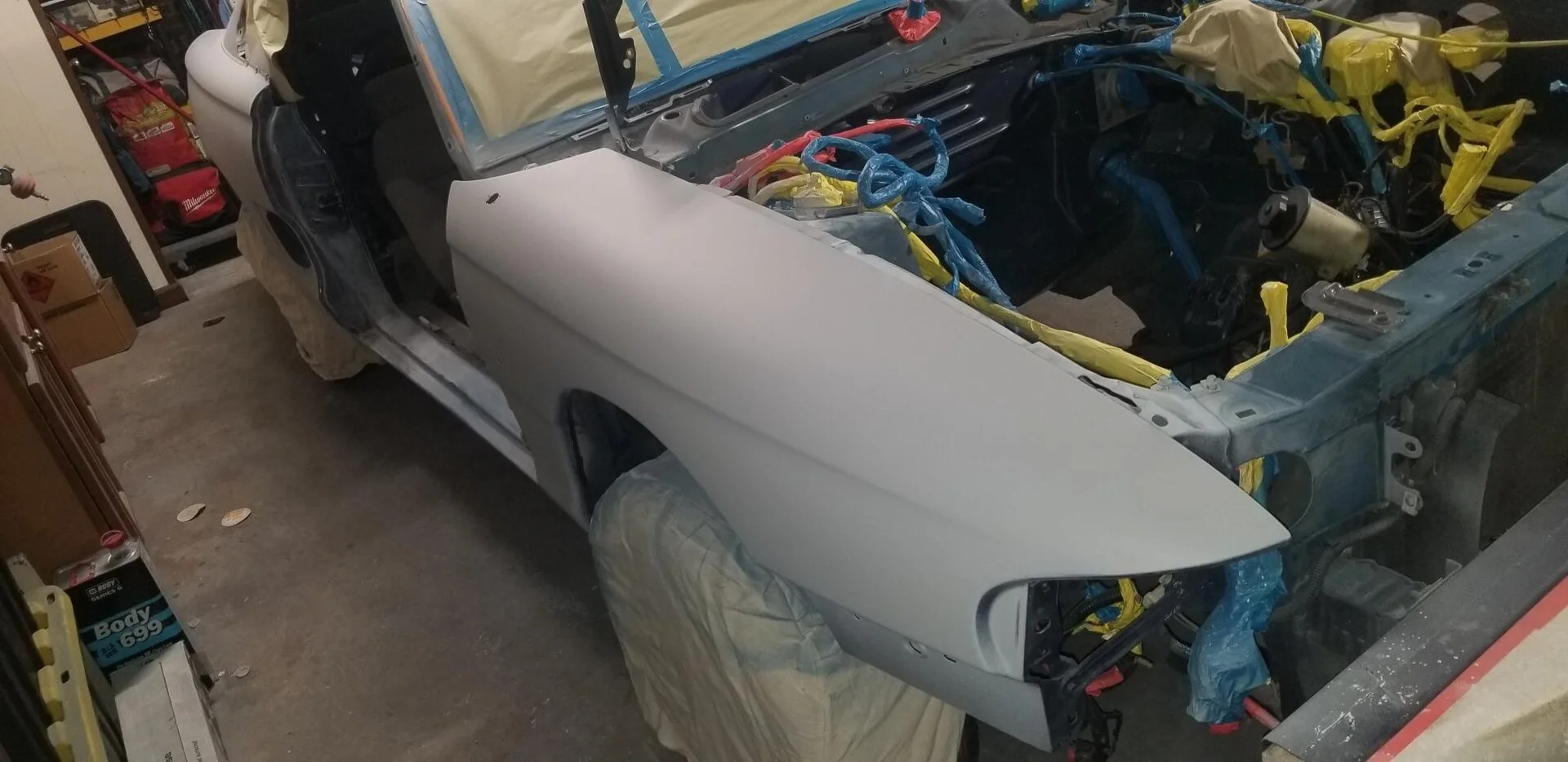

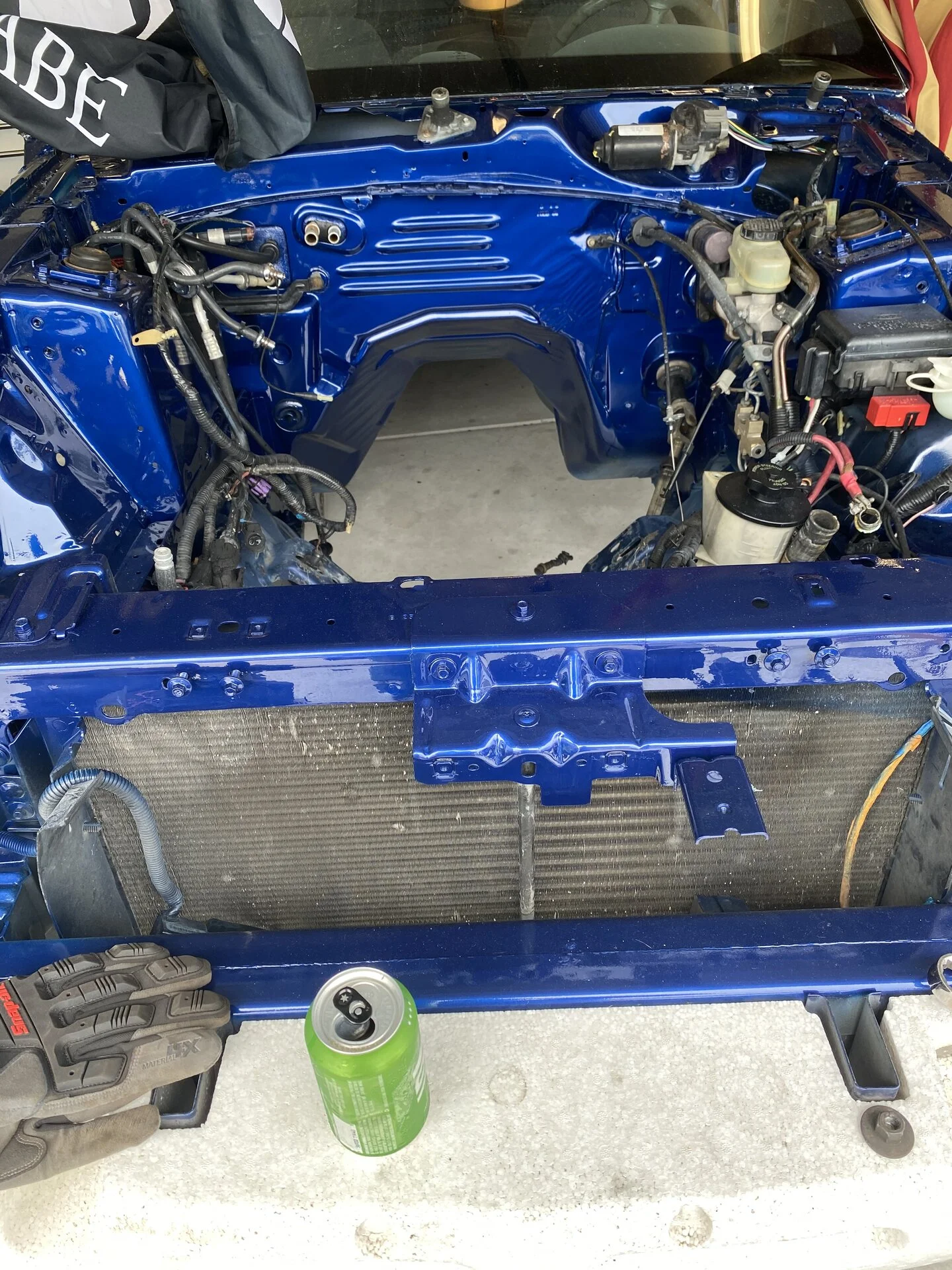

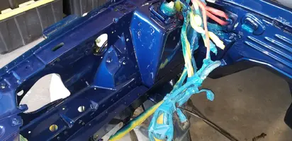

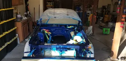

Time for an update. After the COVID delay, the car is getting close to being done at paint. These pics don’t do the color justice, but it’s going to look awesome when its done.

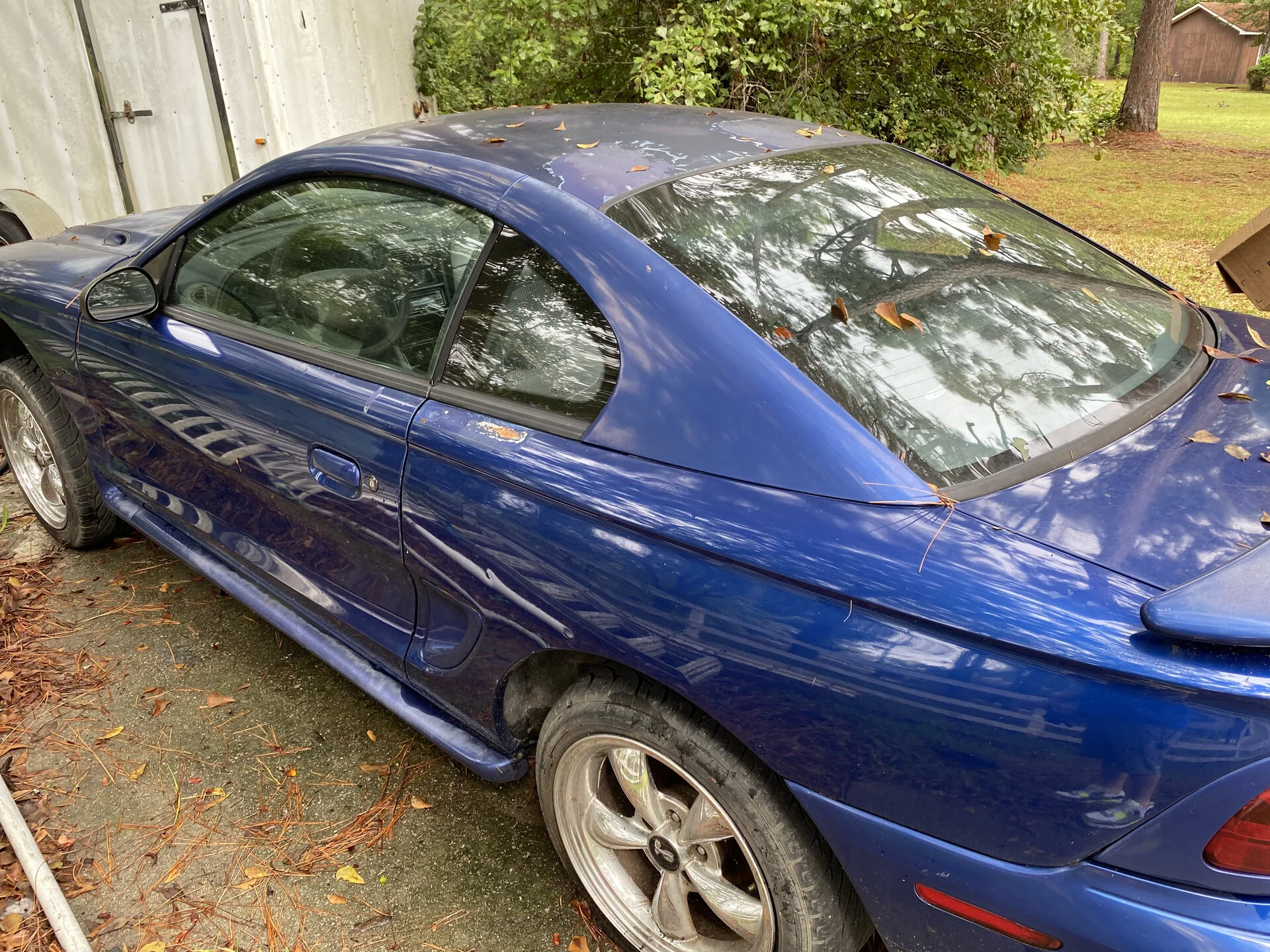

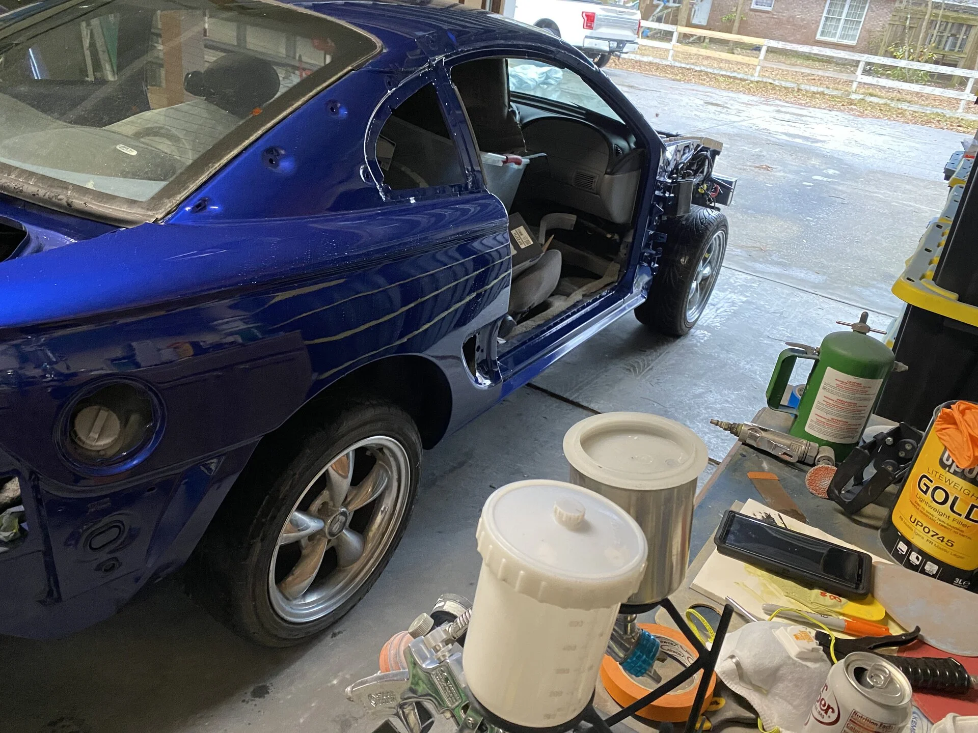

Yes sir, it’s turning out better than what I thought it would. I also like the color more than I thought, because the blue that was on it before this wasn’t the same color.
It had 7 different paint jobs on it when it got sanded down.

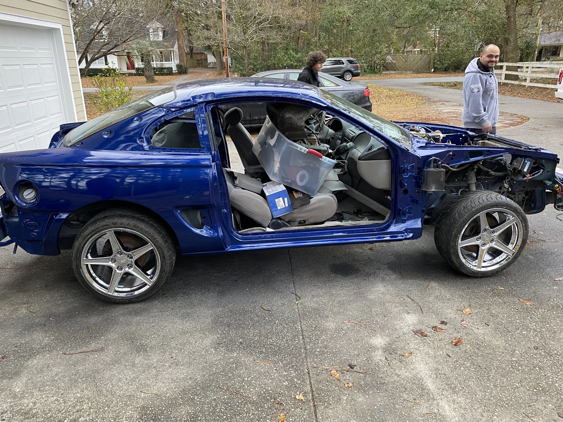

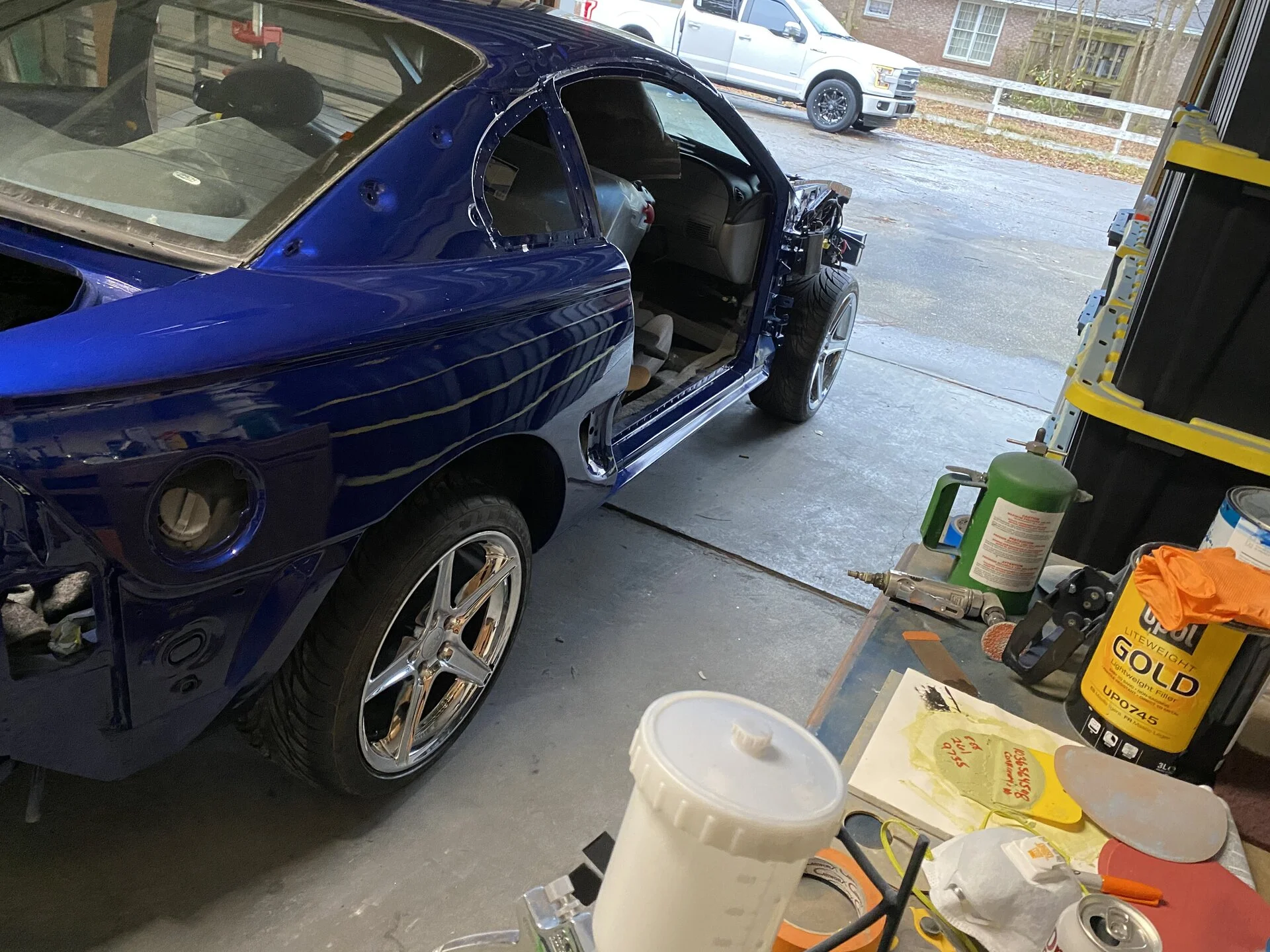

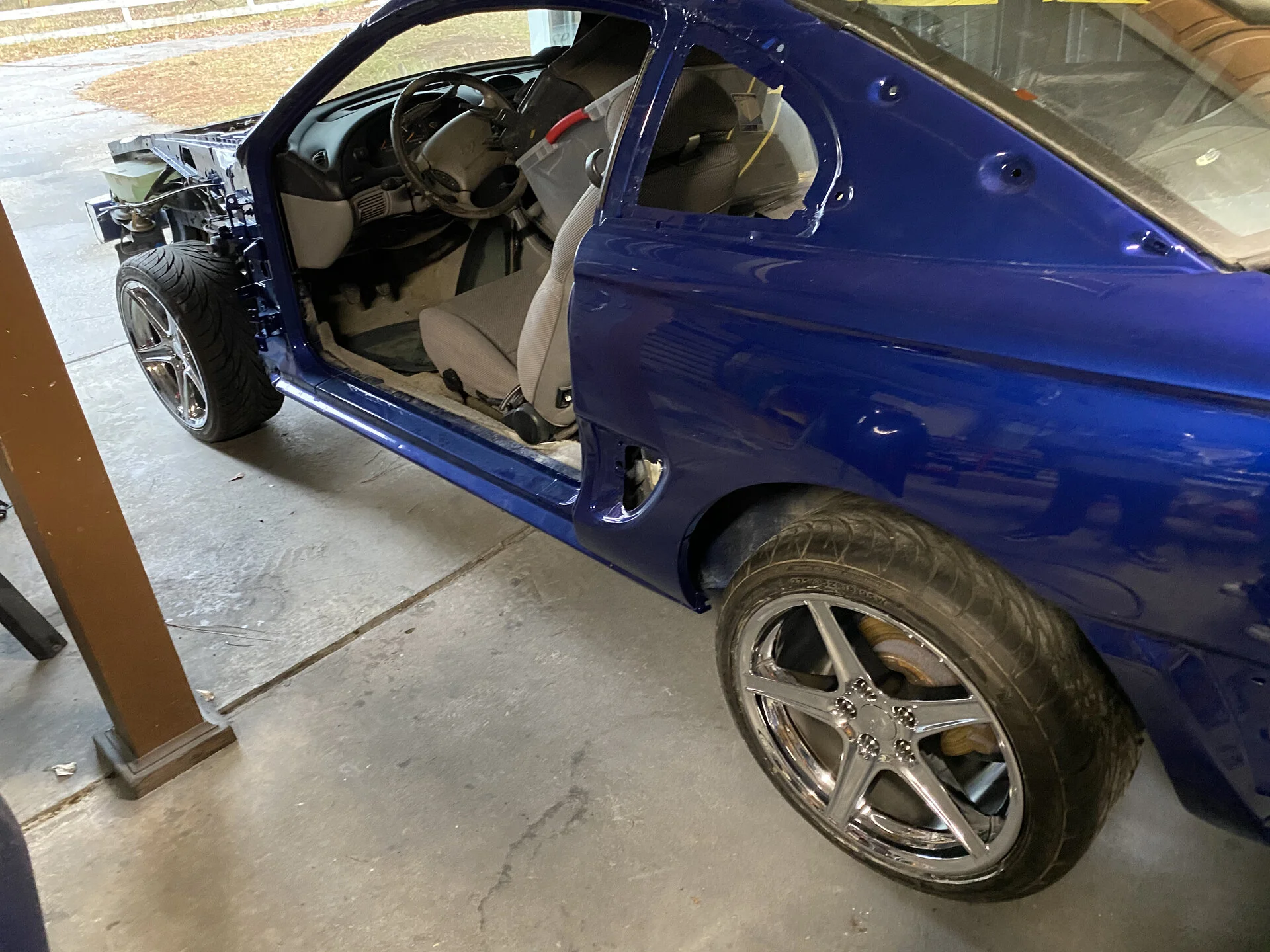

Put some new wheels on the car today, going to put the new k member and coil overs in next weekend.
Some before and afters that are out of order. It had cheap ass bullitt wheels that had a ton of corrosion, to the point the bead wouldn’t seat so they were always flat.

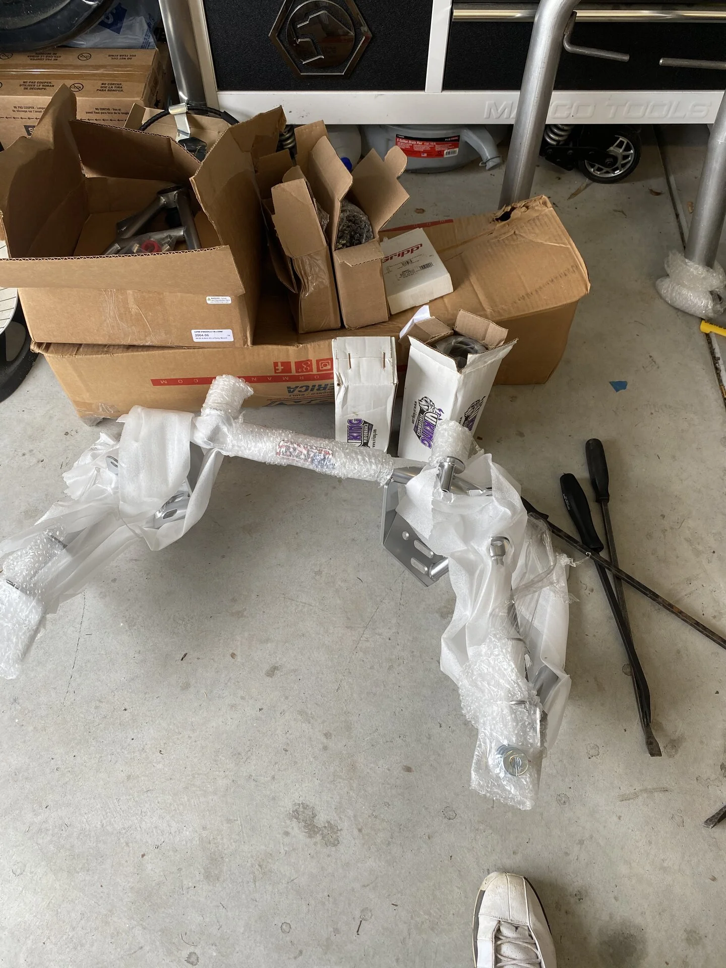

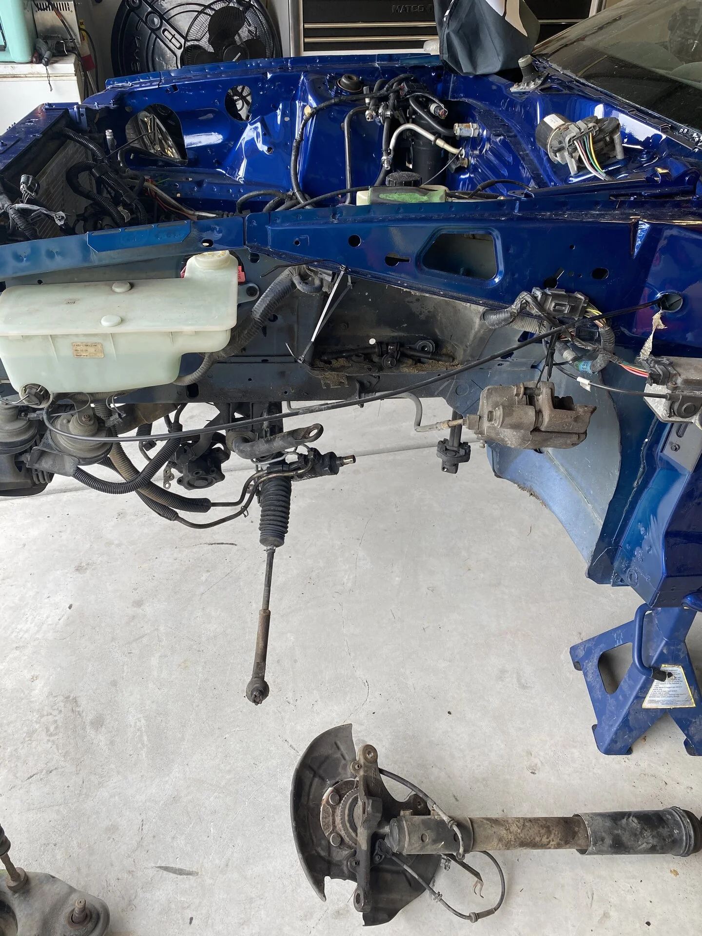

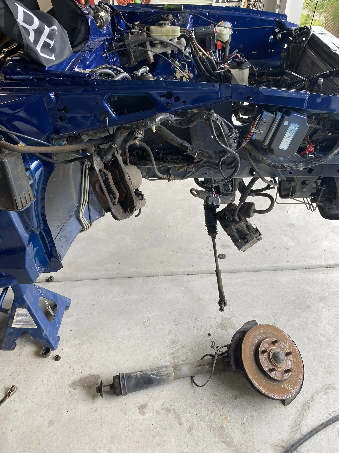

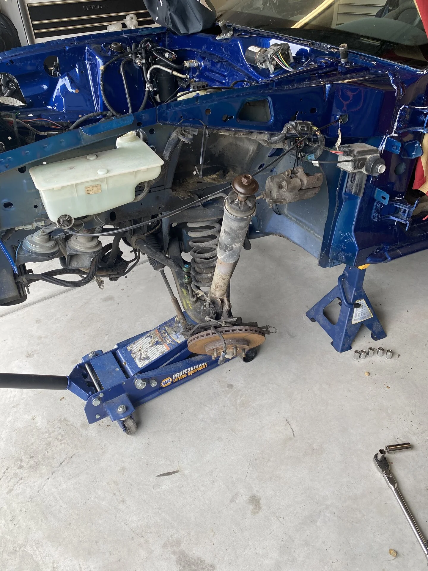

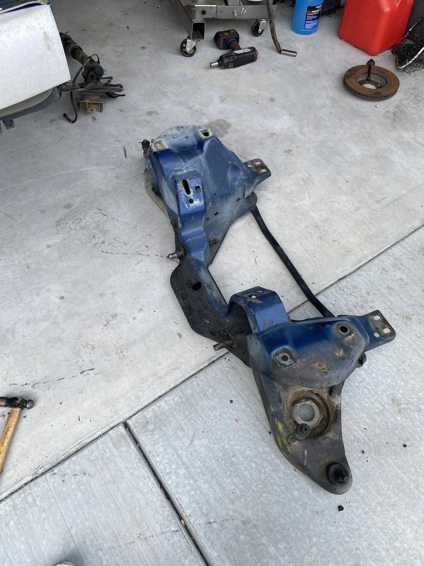

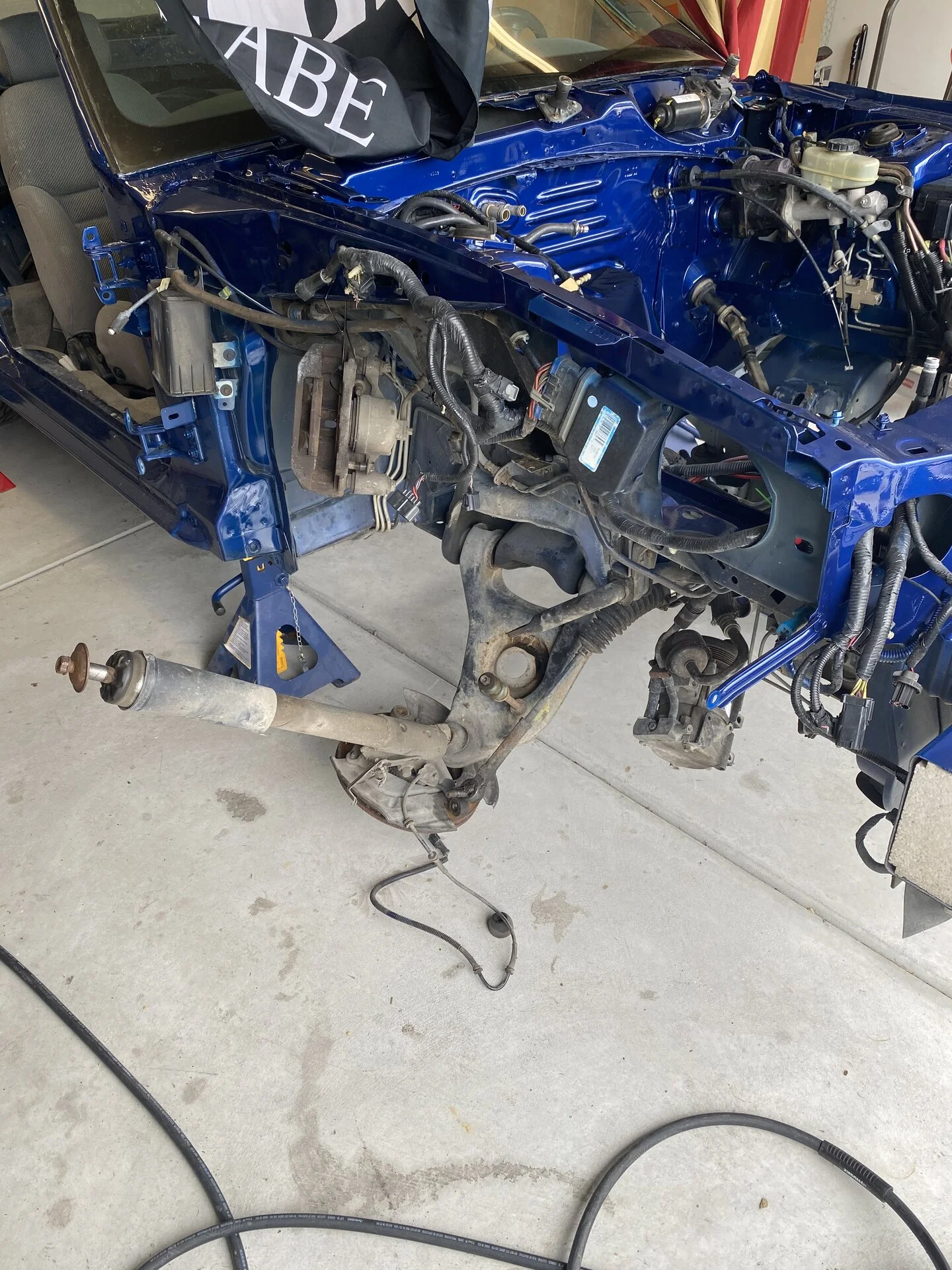

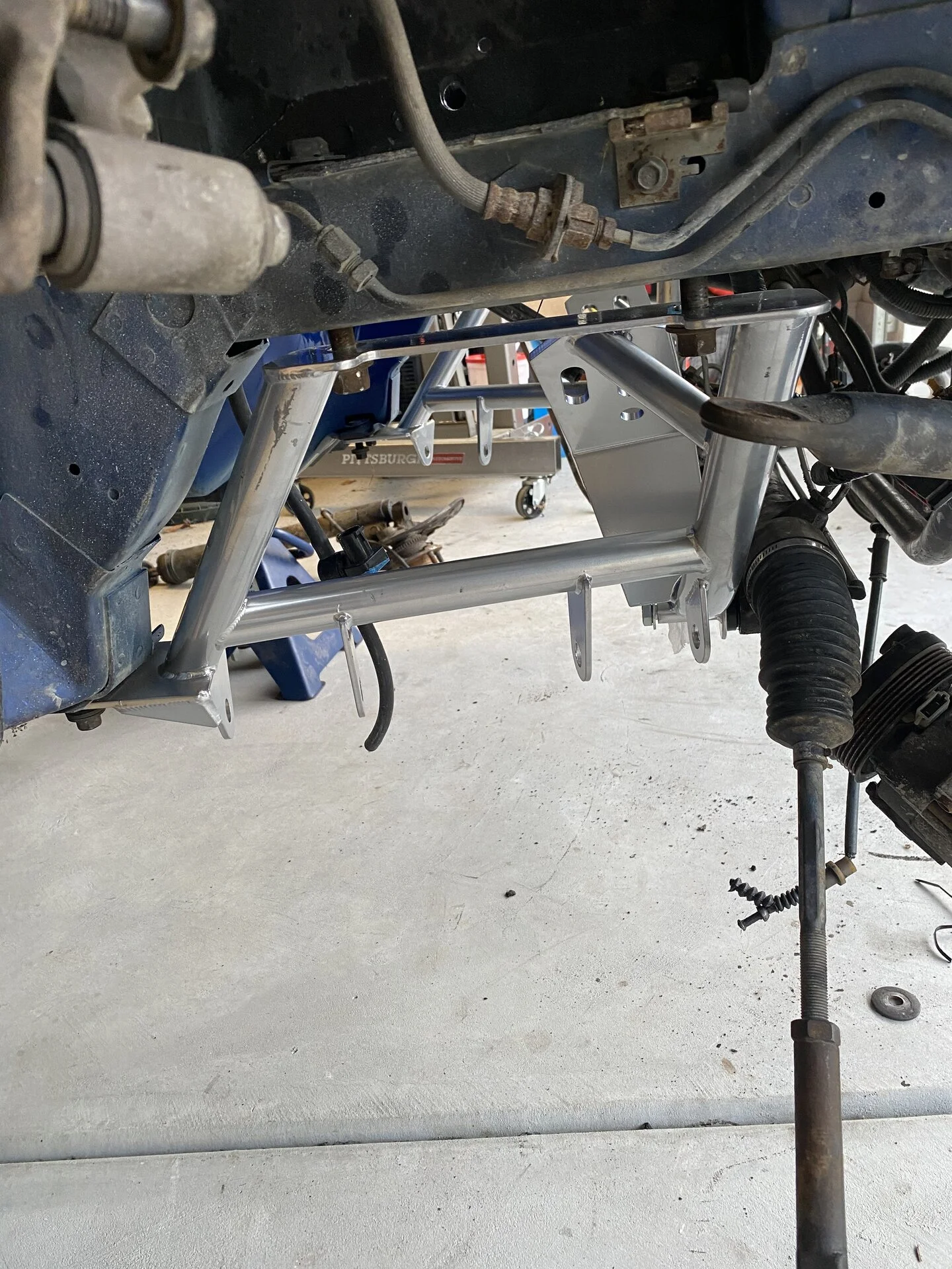

Ok, so it has been a while since I have posted, or worked on the car. Aviation is back in full swing. So since my last post I put in a UPR chromoly k member and control arms. Also today I put in mm caster camber plates. I have the coil overs and strange struts for it. I’m currently trying to figure out what to do about brakes. I can’t put the single piston factory calipers back in. Any suggestions?? Anyways, here are some pics…

I put 99-04 PBR calipers on my wife’s 96 GT vert and I am perfectly happy with the way it stops. For being a cheap swap and stock I think it stops pretty damn good in my opinion. I have a second tangerine 96 GT now that I am going to put PBR calipers on in a couple weeks when I am on vacation.

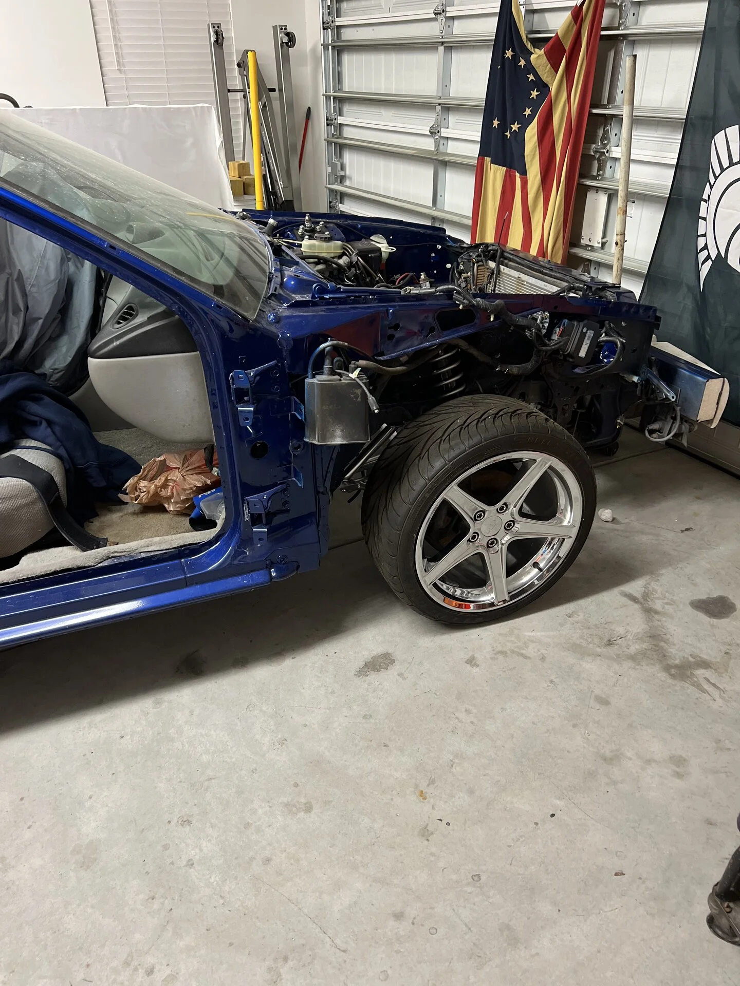

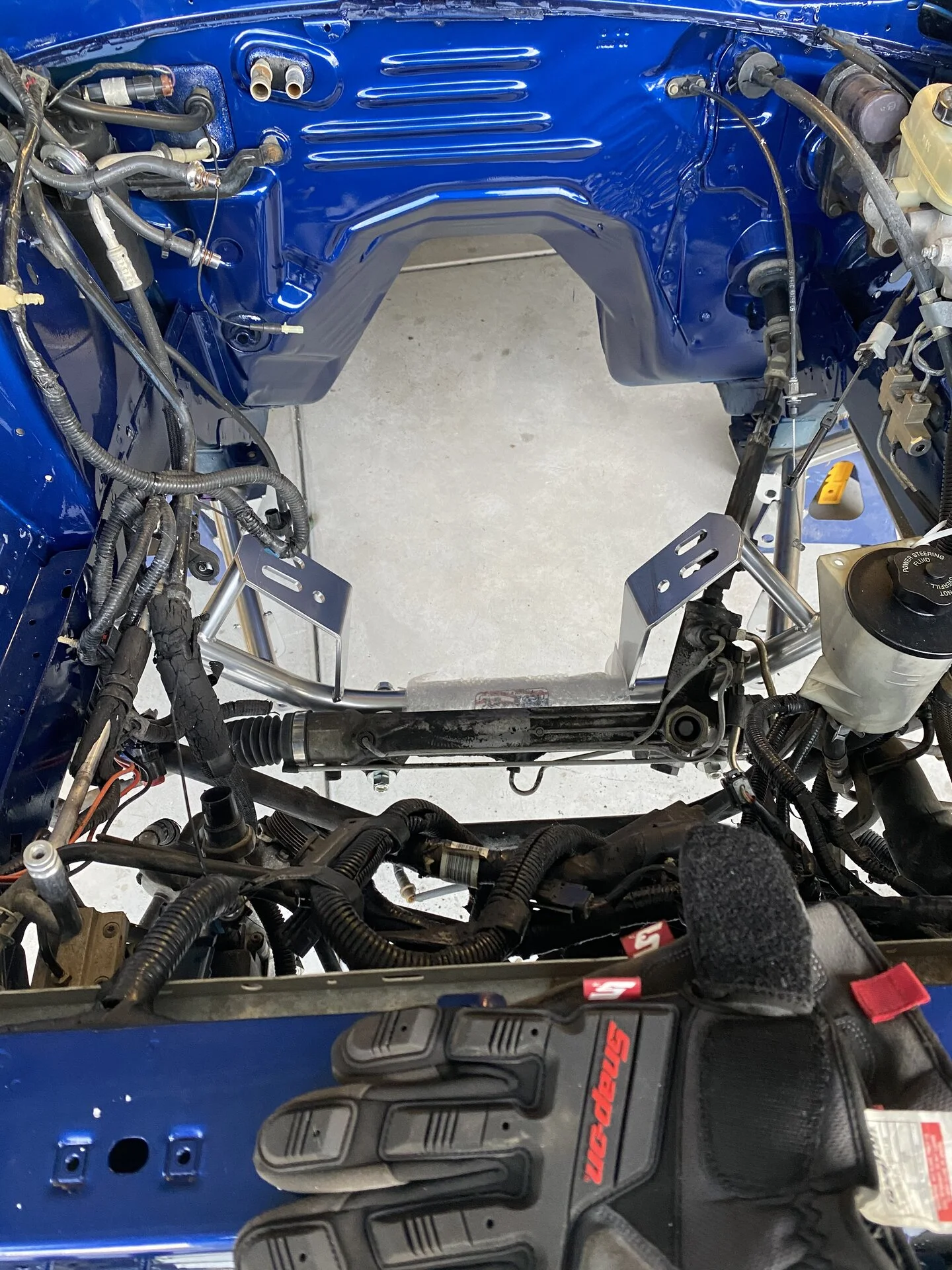

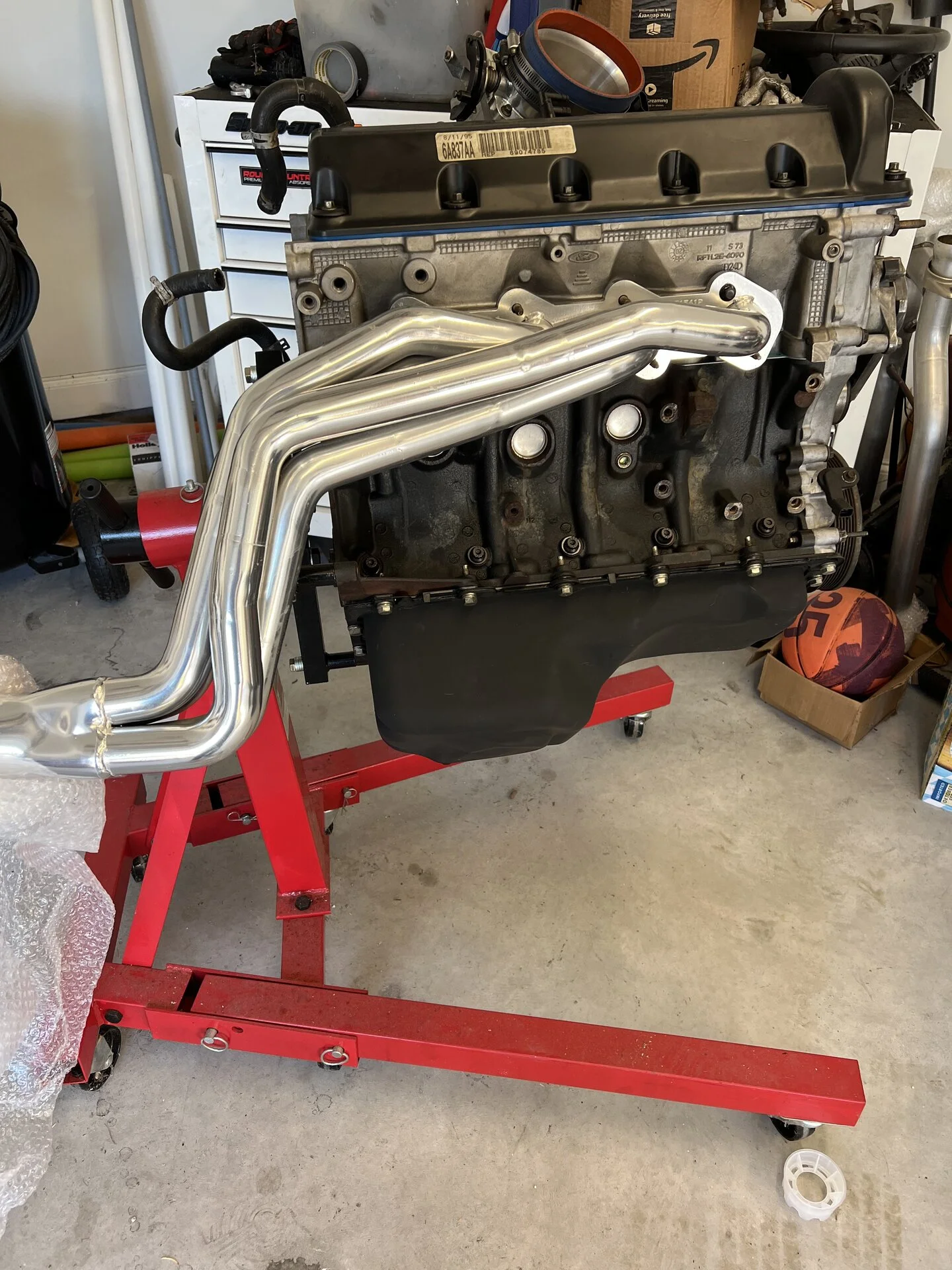

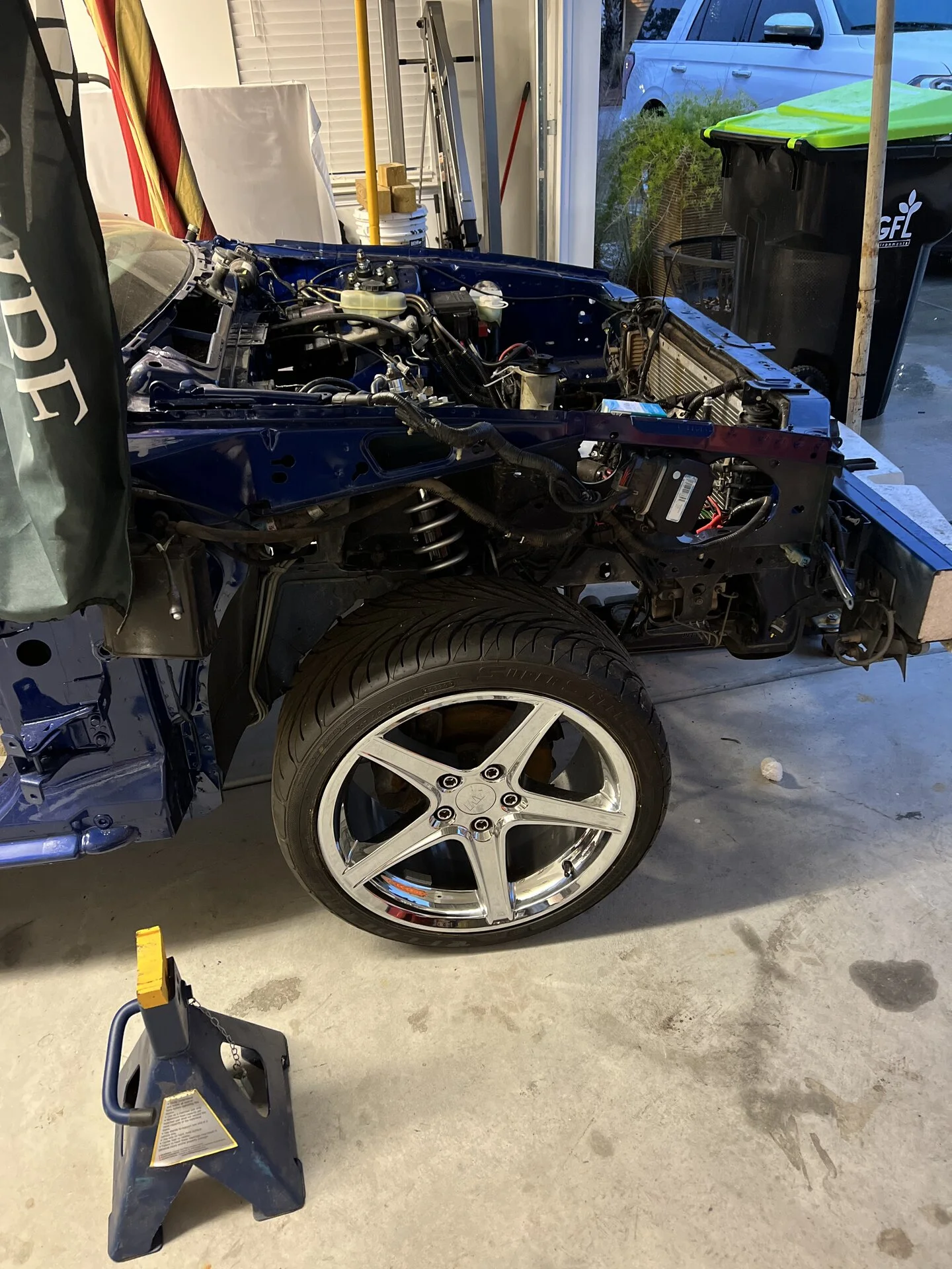

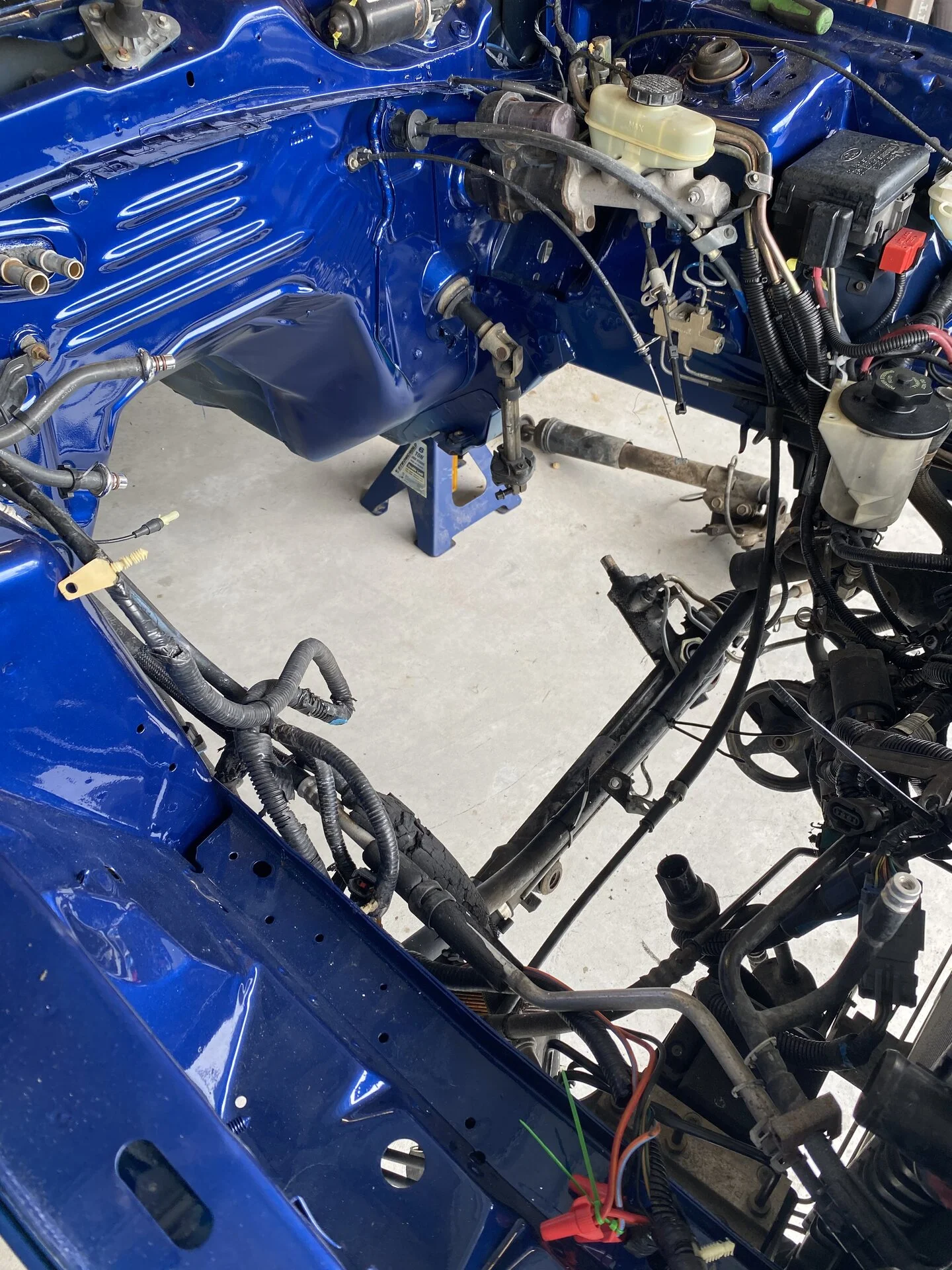

So, it’s been a while since I have had 2 seconds to look at my car. I finally got some free time. I finished putting the K member, coil overs, bump steer and caster camber plates in. Fitting the headers and mounts so I can FINALLY put the engine in this weekend.
