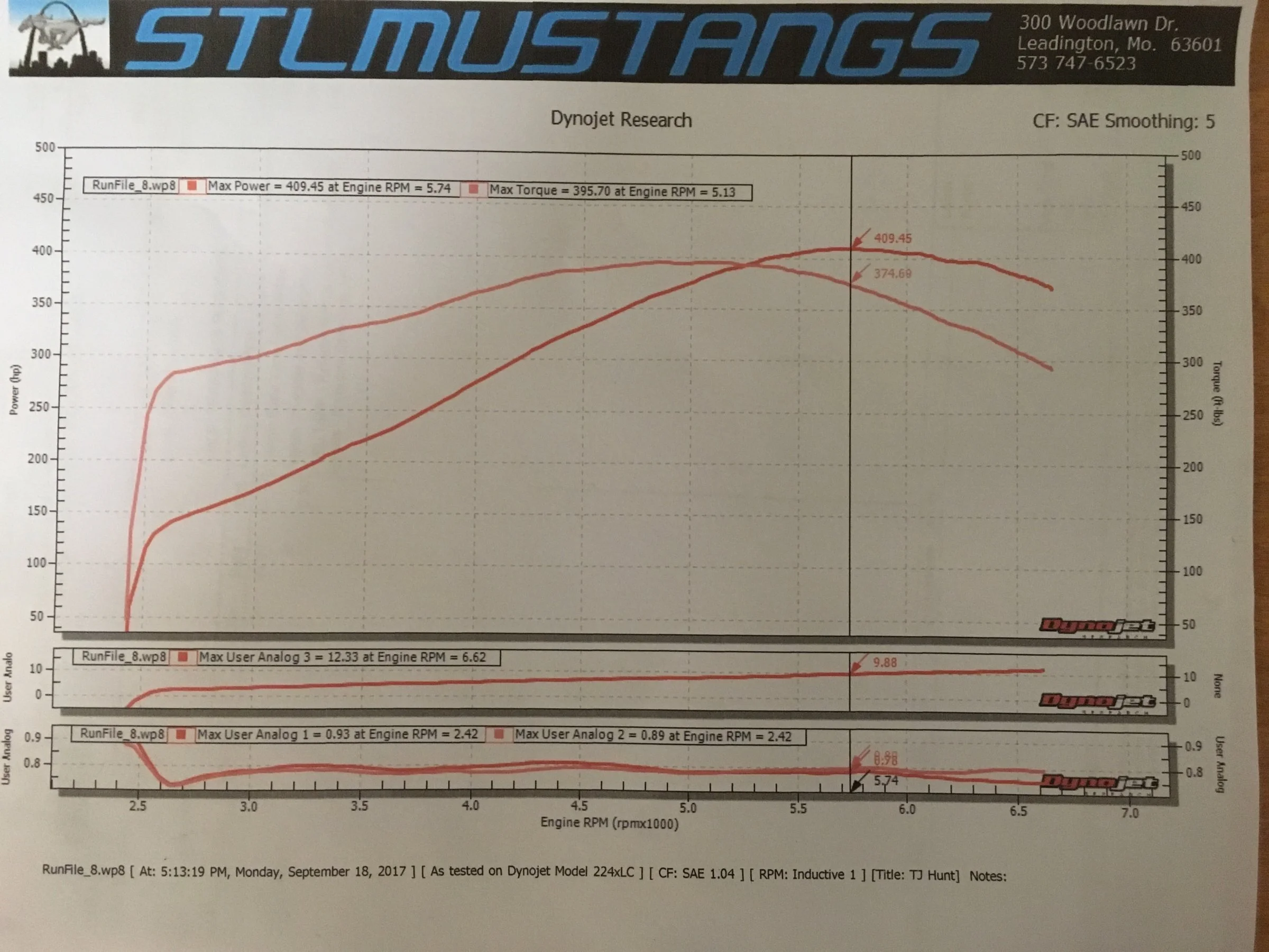

Time to make another dyno appt since I can't sell the dang thing with out giving it away.

We are supposed to Go see Monks next Monday. I'm not hopeful at this point. All it does is disappoint.

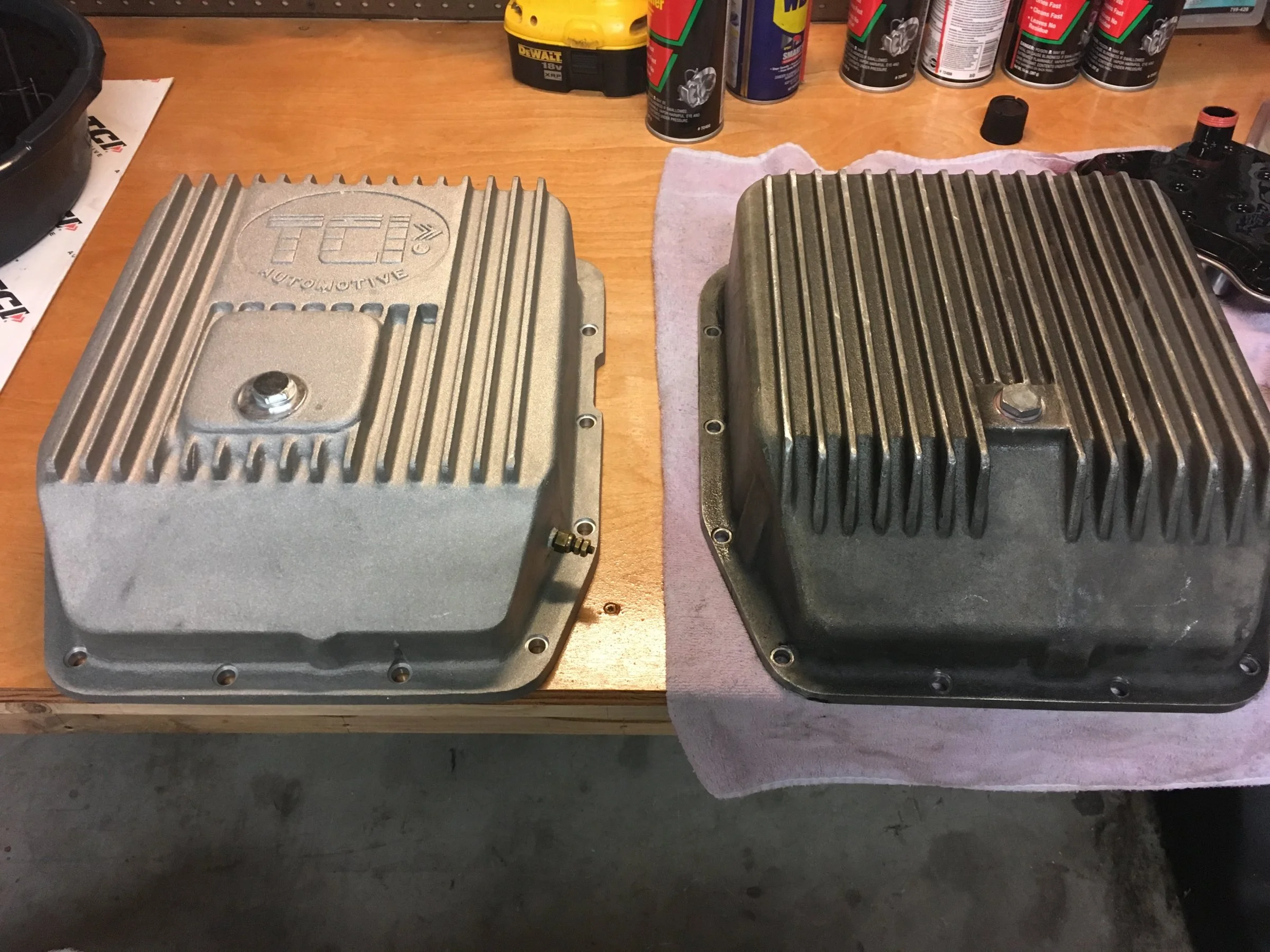

A tale of two pans. The darkness is just from the soap in the parts washer at the trans shop. If you spray the acid back on it to make it bright it comes right back to the same as the left.
We installed the new pan and wrapped the headers by the pan so we can get through the dyno day and the permanent heat shields arrive.

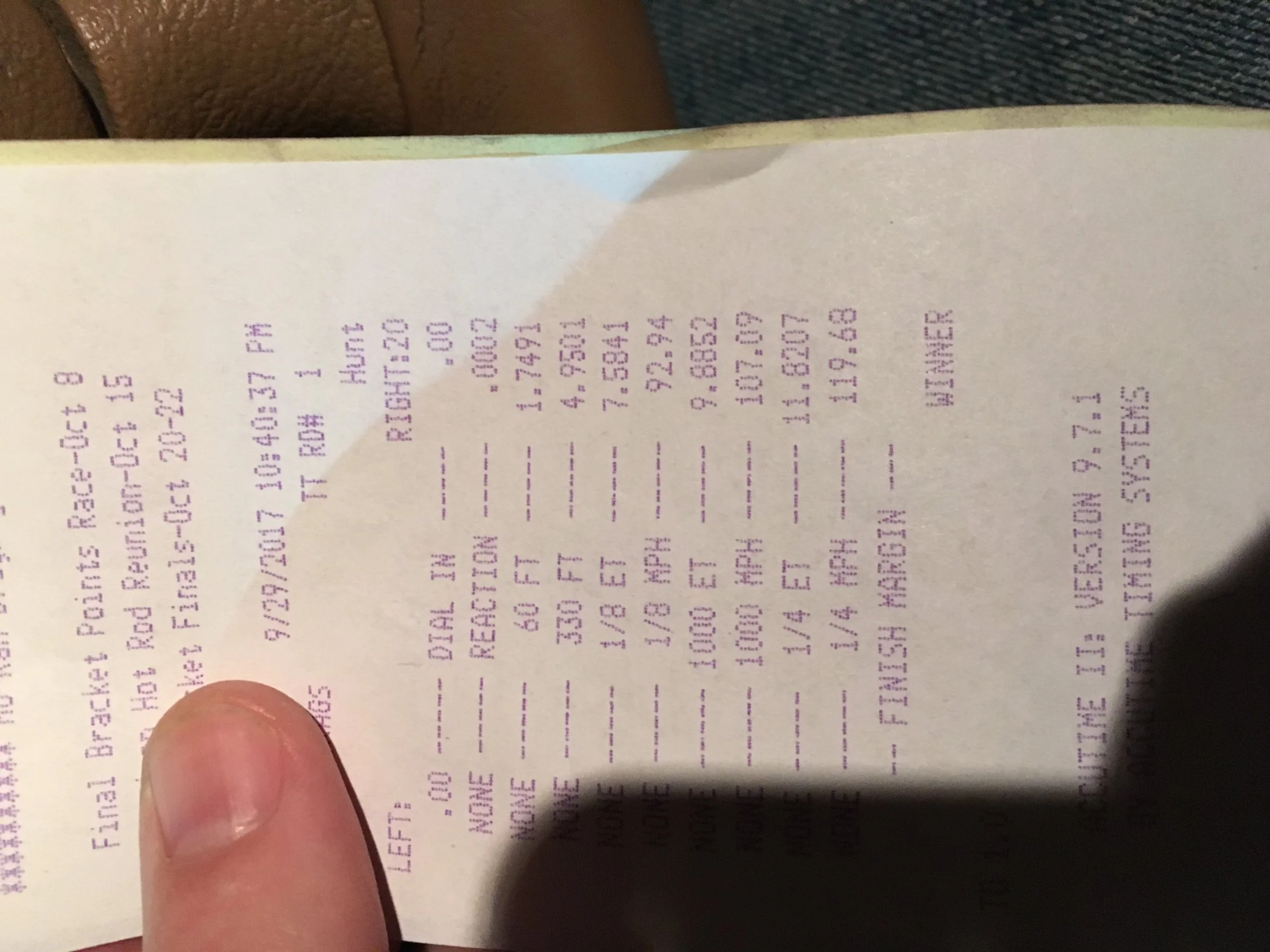

I "Plan" on heading to the track tonight. It's a big bracket race weekend so it'll be stupid busy. Really a bad night for shakedown passes and to make adjustments. I'm going to assume that my 17 nitto drag radials are not going to be up to the challenge of a hole shot hit with the 3500 stall. We will see.

Looks like a win. Good numbers and good time. Glad to see, if nothing else, you got it down the track. 11s seem to be attainable with your setup. Little practice and little more dialing in.
Now take a weekend night. Sit in your garage breathe in that victory. Also consume about 10 beers to commemorate your struggle. :cheers:
