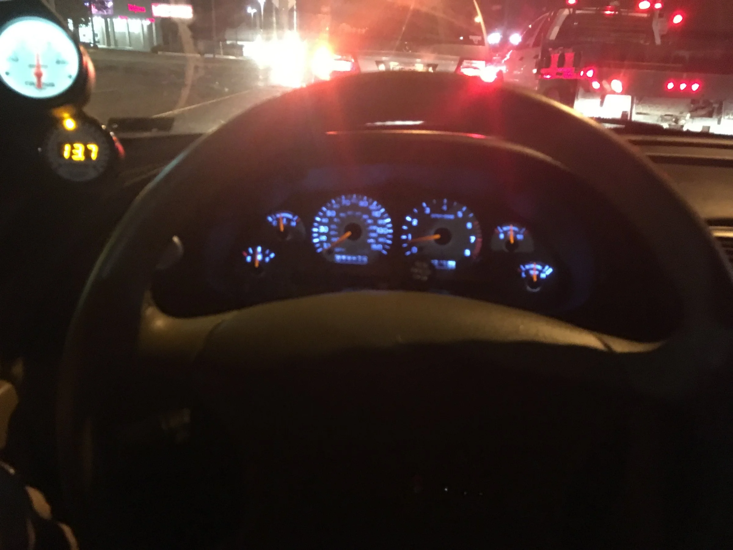

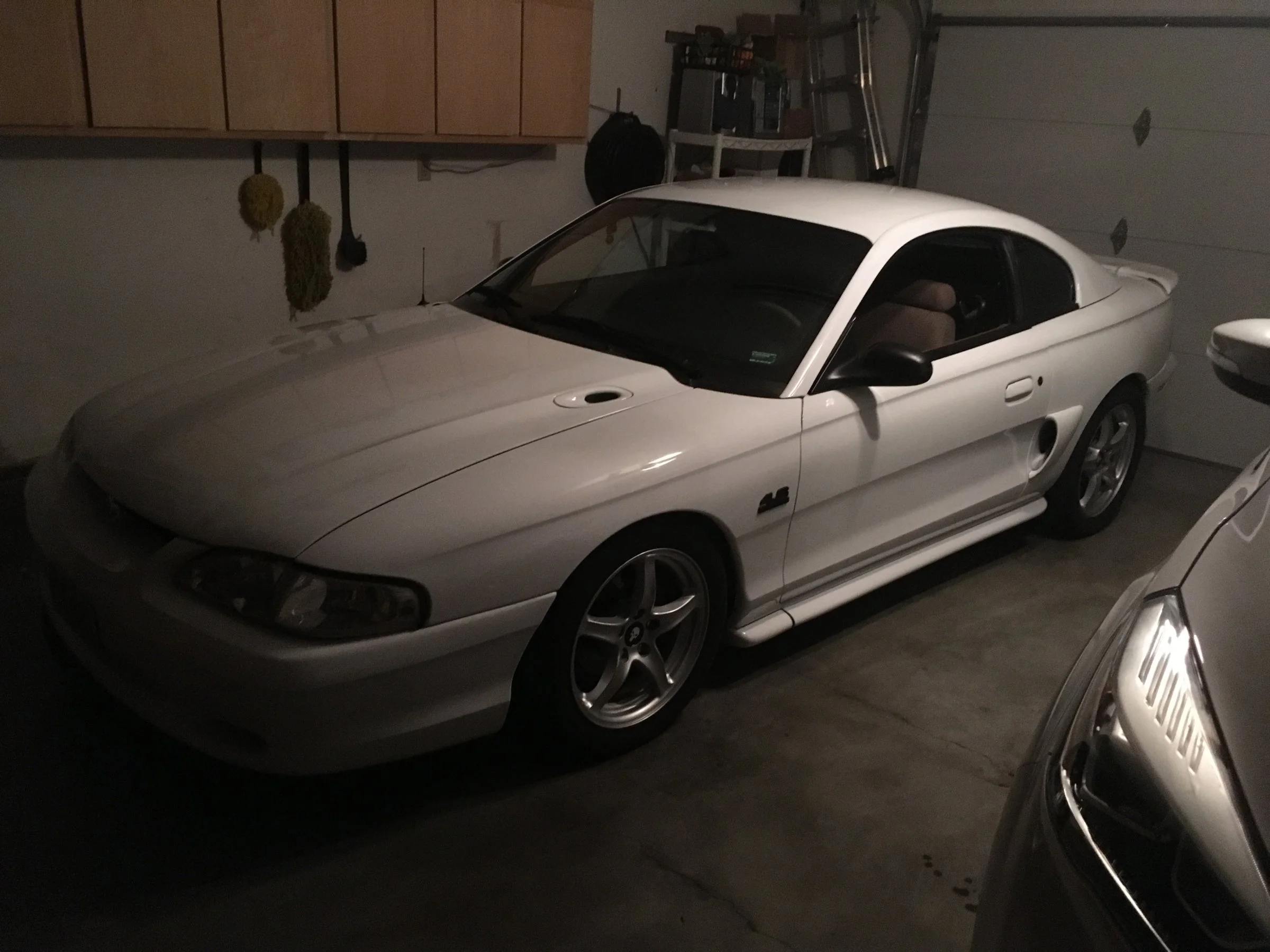

Got the car out on what I hope was a successful test drive. No fluids leaking. I got the trans pan to seal. Also found where my smoke screen was coming from. Seems I forgot to tighten two valve cover bolts on the pass side just above the header. Seems that'll cause some issues. Lol.
