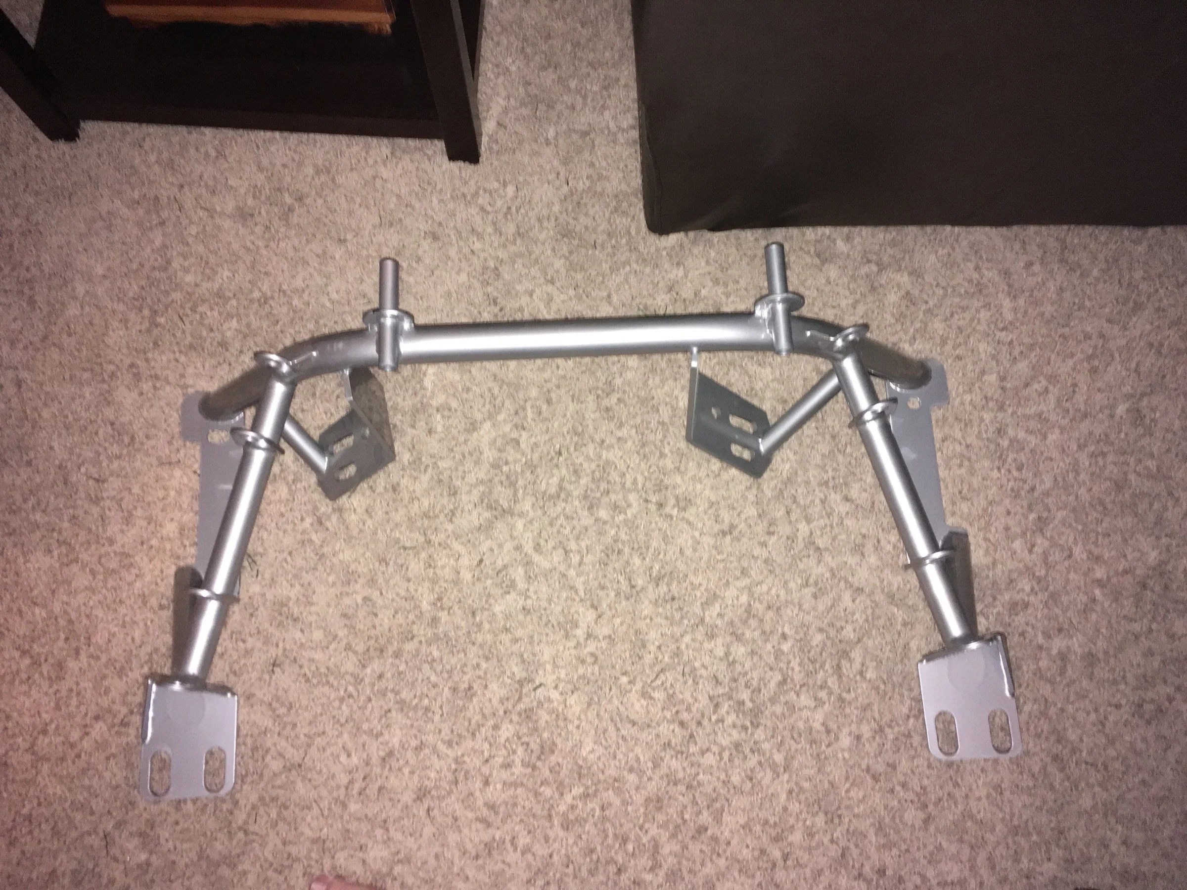

Since I want to go long tubes I'll likely splurge and do a tubular K for clearance and some weight savings.

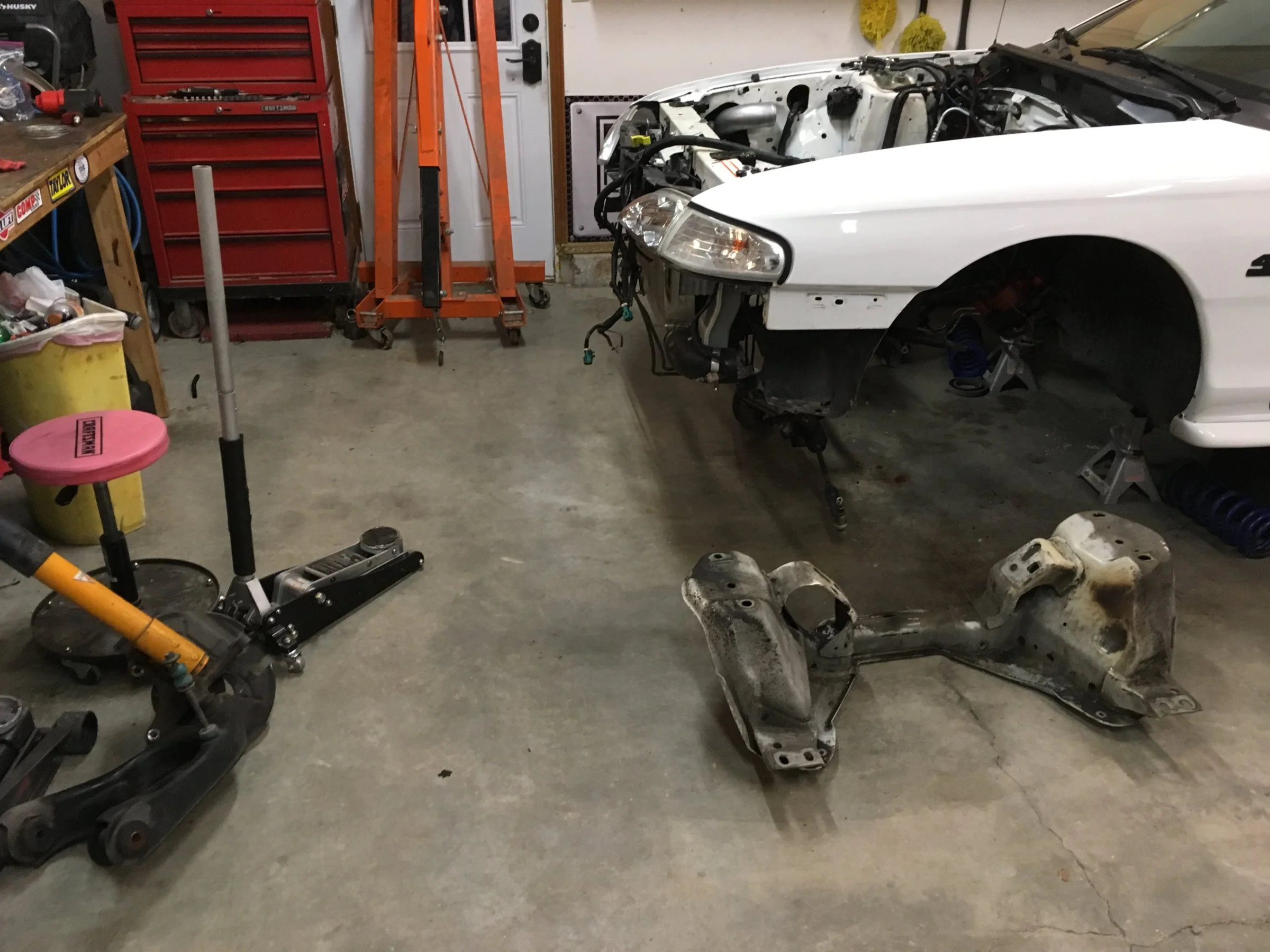

I seem to be taking more stuff off of the car than installing here recently.
New upr k member is on order.

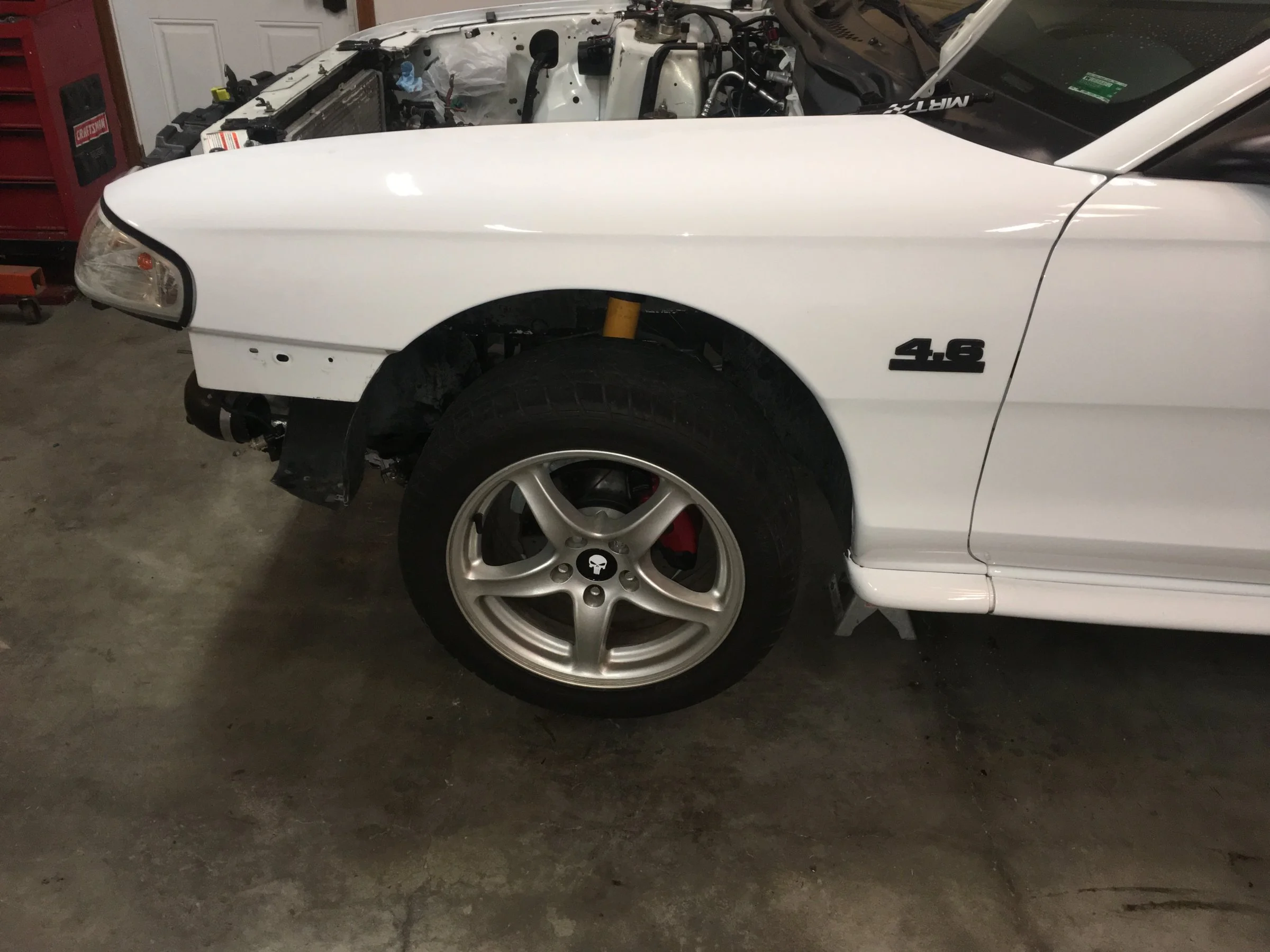

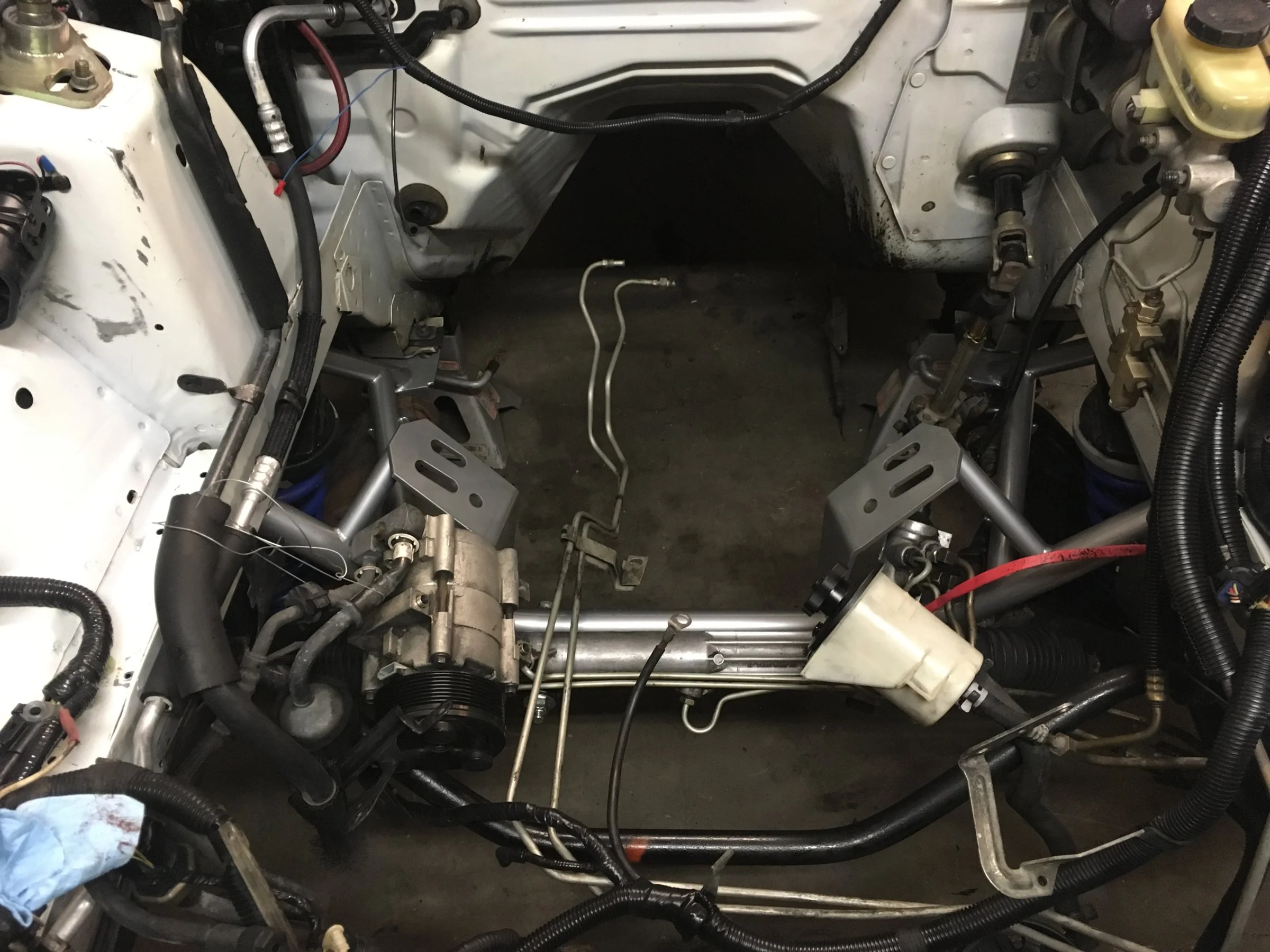

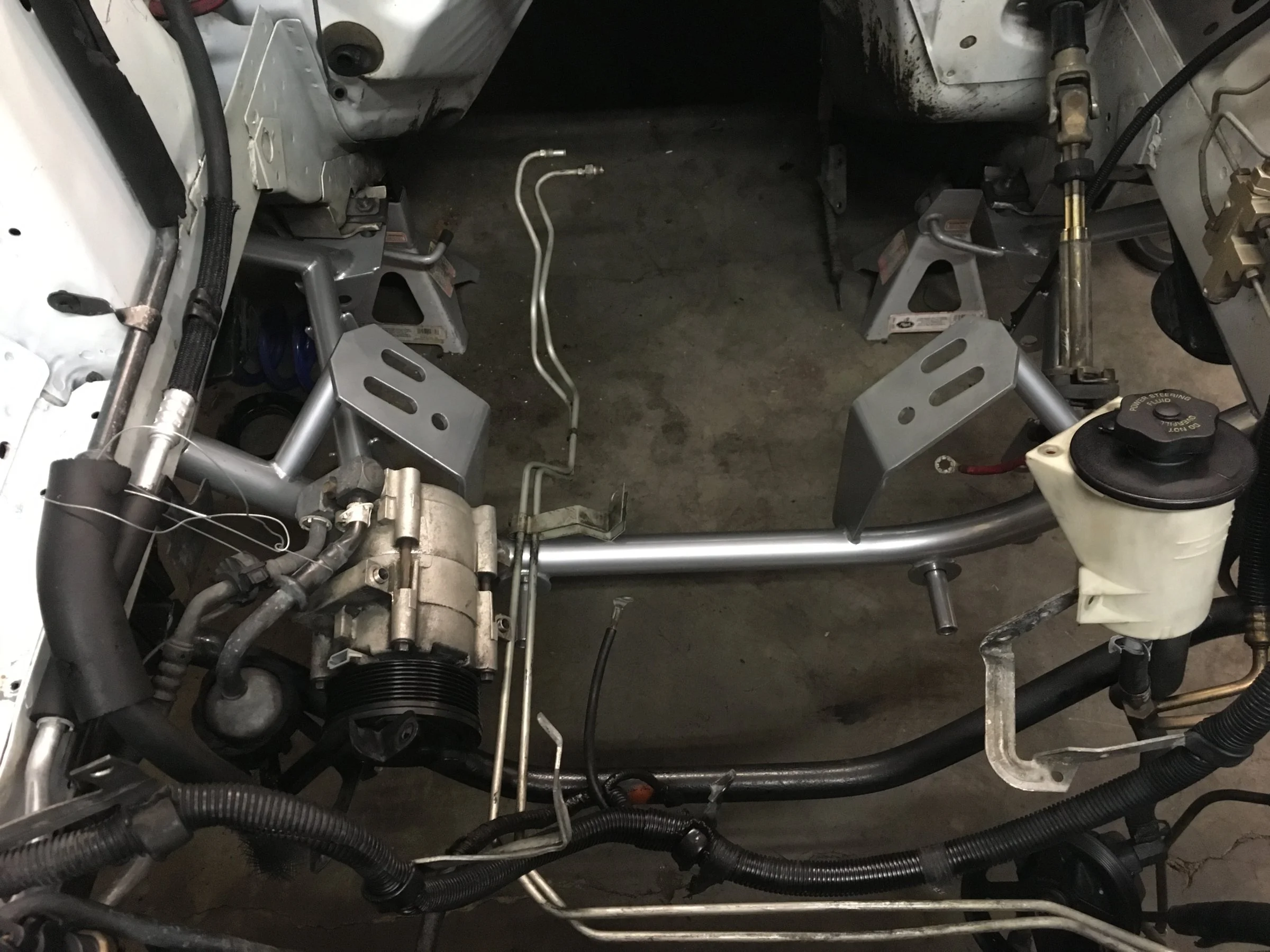

Going to get this guy squared up today. Hoping I don't have to slot openings. I also was hopefully able to correctly press out and swap the stock bushings so I can reuse my stock control arms and springs I have for now. A poor mans k member swap. :)
I'll get the control arms in today then sometime this week I'll get the trans to the builder for new better clutches and an overall inspection.

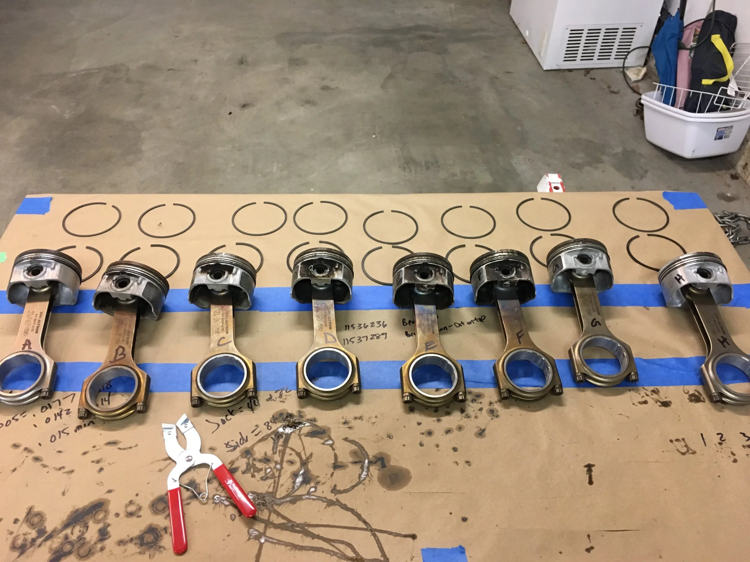

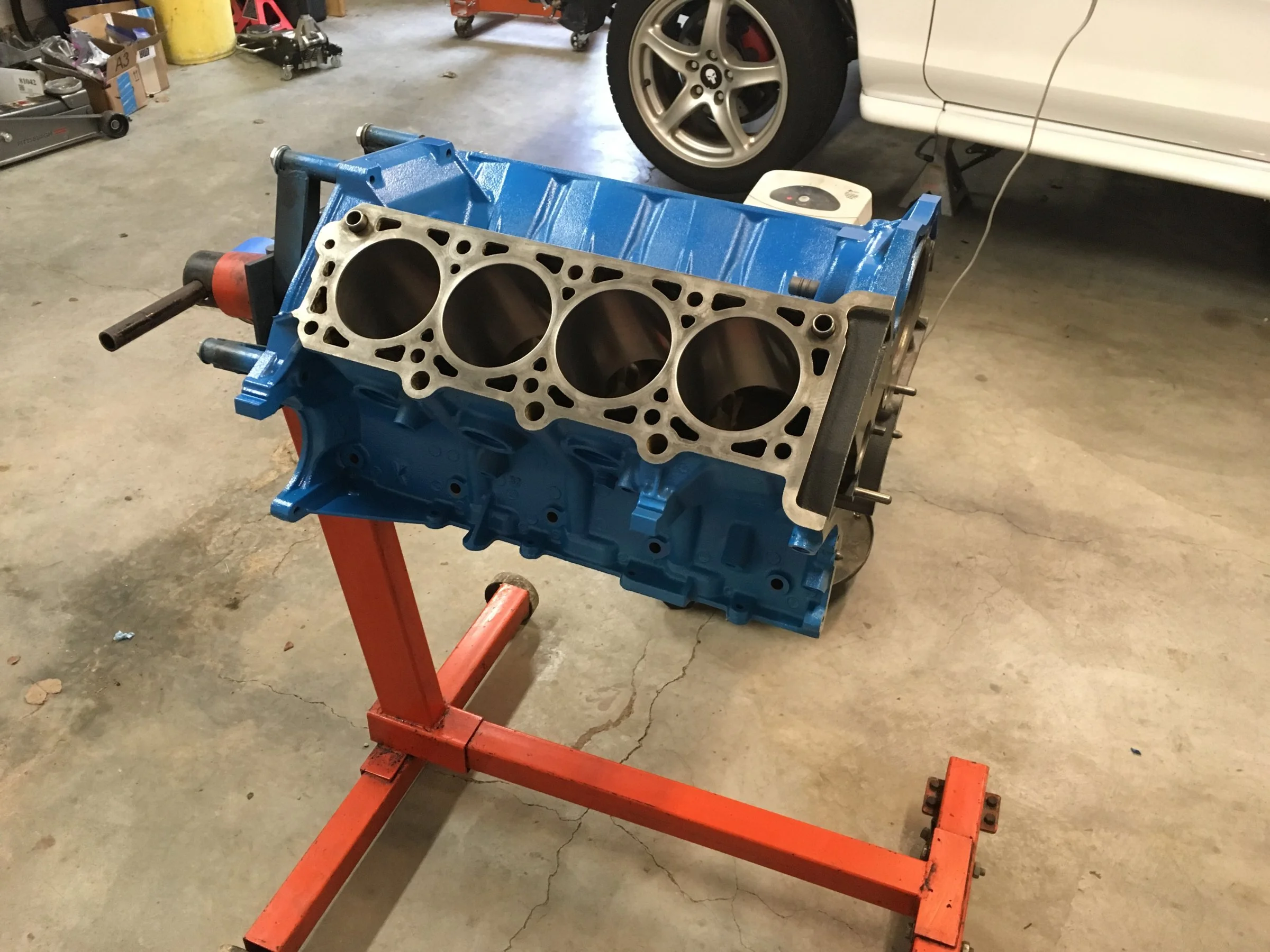

Been a few weeks since my last update. Block, crank, rods/pistons are back from the machine shop. The heads are ready. I'm still waiting on the cams to arrive. I ordered the bearings, rings, and all tools needed to build the short block and degree the cams (there goes 500+ bucks). I don't mind spending the money on the tools as I'll always own them now.
Hoping to get after it and build the engine on the week of the 11th of Feb if possible.

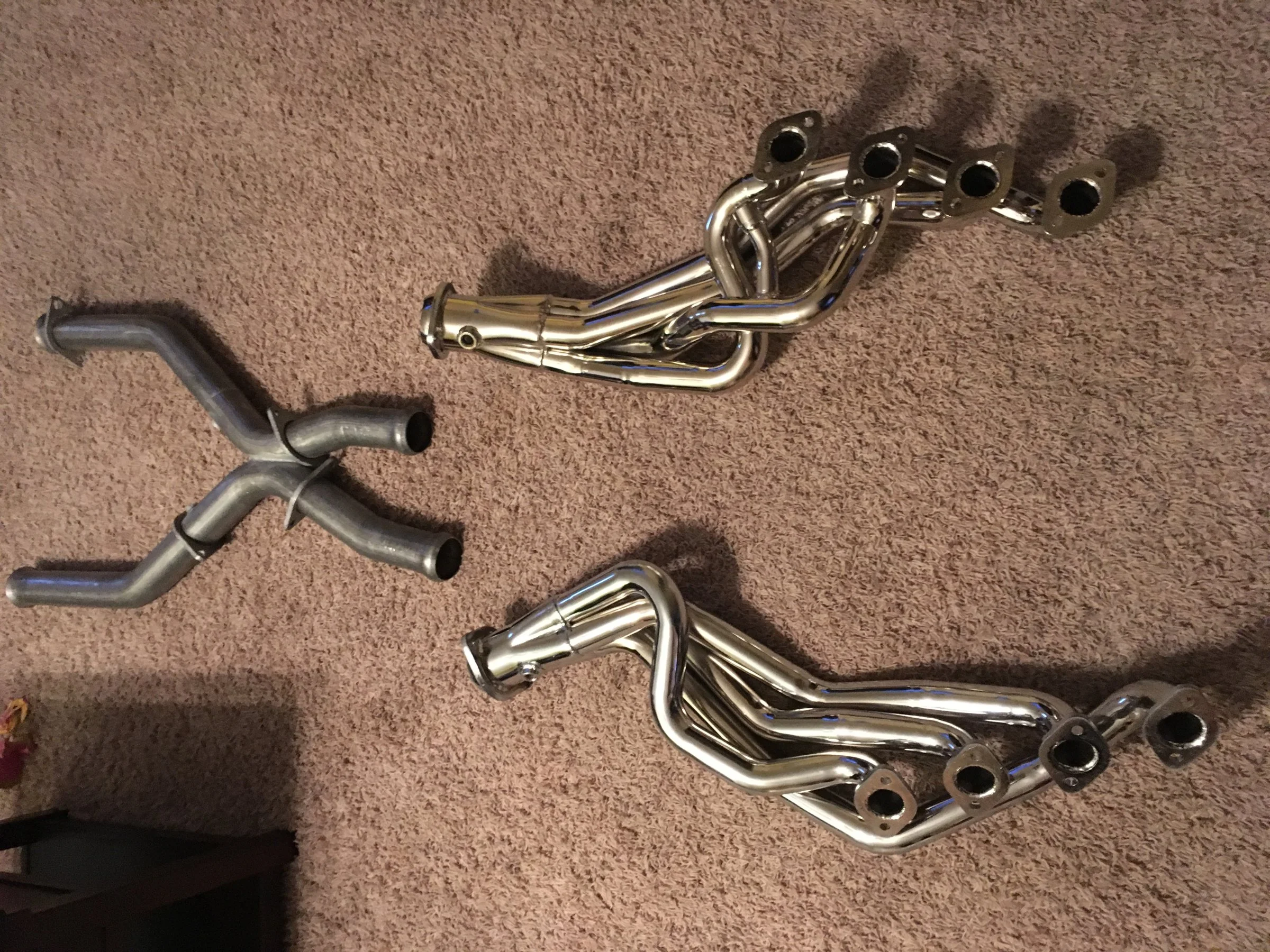

I need to rat hole some more cash to build the trans, still need to order headers/mid pipe and need injectors. That is all I'm missing.
Headers, mid pipe and injectors (frpp 80#'s) ordered today. I got my large summitt racing order last night. Turns out when I thought I ordered rod bearings, I ordered one set, not a full 8 rods. Oops. I ordered a full set from MHS as they were much cheaper at $119 vs $28 per rod from summitt.

Crank is in. Rings are filled. Too bad I goofed up my bearing order and only got one rod worth vs a whole set. I'll have the pistons in this week.
I'm waiting on the cams and that's it motor wise.
Injectors, headers and mid pipe will be here this week

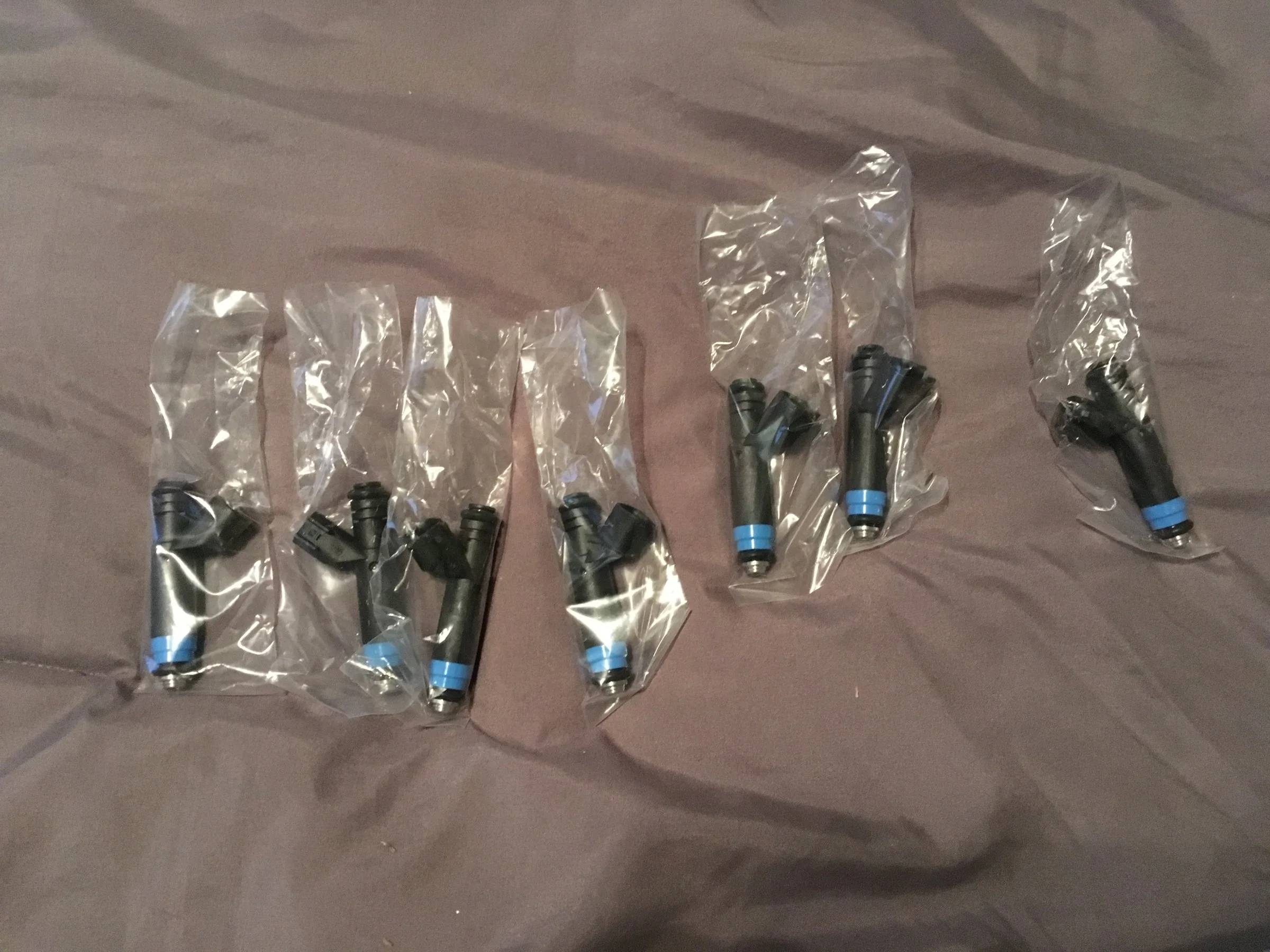

So I was super excited to know my injectors were coming in today and it would be one more item checked off my list.
Much to my surprise I am only 7/8 checked off. So now I get to wait for lmr and frpp to decide when to send me the missing injector.
Just shows if it can happen to me it will. Hahaha. Headers mid pipe and cams are still out.
Lmr.com is pretty good about getting things right. They should do right by you. I get the impatience though.
Few years back, went to a real nasty place in my mind while waiting for some upr upper sprung perches. Garrr! Messed me around twice....angry.
