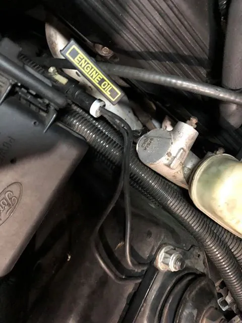

1999 - What does this connector go to?
Jeremy Martin
Oct 26, 2017
29
When I bought this car first thing I noticed was this harness grounded out. Anyone know what this harness is supposed to be plugged into?
Look on virtually every Mustang and follow the black wires from the two bolts attached to the radiator core support. These go around the battery and end at the round single pin connector.
Of the two wires that have been grounded at the strut tower one would go to the battery negative. The other would go to the radiator core support ground buss.
Another option is to search car-part.com to search salvage yards in your area. Perhaps get a set of salvage yard battery cables.
