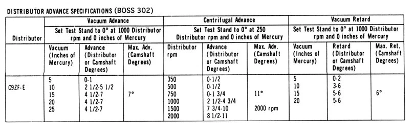

First thing I'd do with that is baseline the distributor at BOSS 302 specs. The BOSS was a pretty aggressive smallblock engine, and had a dual advance distributor. Once you're on those curves, you'll be in the game, and then you can tweak for best performance. You can ignore the vacuum retard, unless you have fitted a Distributor Vacuum Control Valve.

Well, there's the problem. That's why I suggested the BOSS specs as a starting point.

1 - The Boss 302 specs listed are at distributor rpm - is this correct?
2 - In lieu of a distributor test stand/machine I should be able to get close to those specs with a 40 degree BTDC scale on my balancer and reading the specs as double what the distributor RPM specs are on that spec sheet?
3 - If I am reading that spec sheet (and between the lines) correctly, maximum advance should be 17-22 degrees at 4000 engine (crankshaft) RPM, 15 1/2- 20 degrees at 3000 RPM, etc?
I'm surprised that maximum advance doesn't occur until 4000, but if that's what I should be looking for, I'll try it. Please correct me if I'm interpreting this information in error.
