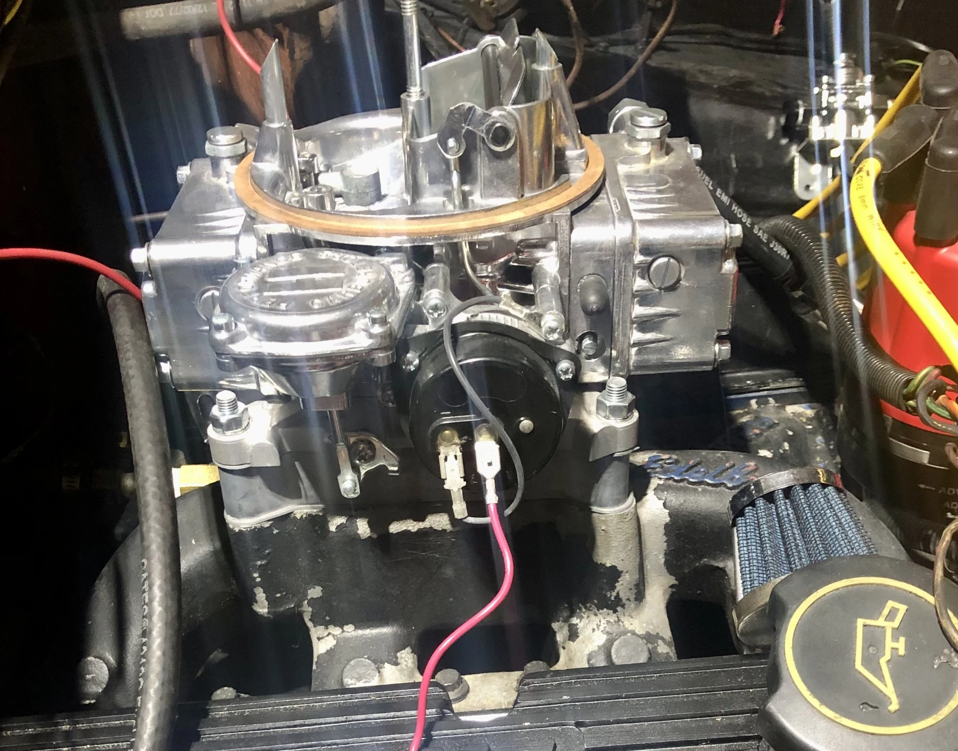

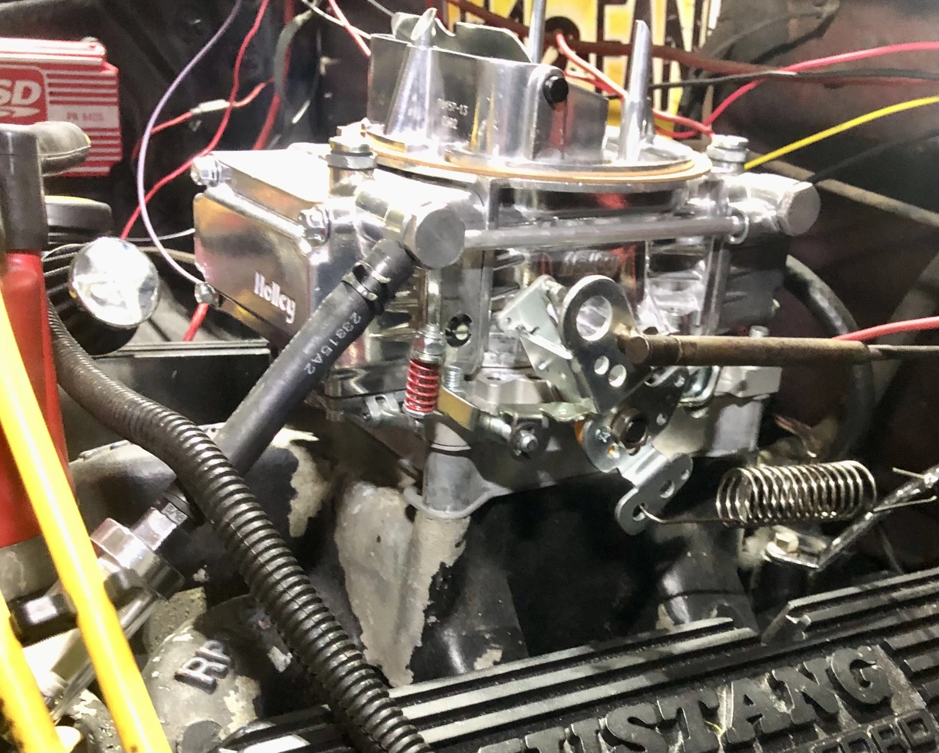

Give us a shot of the carb installed on the engine.
Attached are pics of both sides of carb..one downside of this carb is there are no sights on the sides of the float bowls..It is a fairley new carb, I had it on my old engine untouched..the only parts I have tried adjusting are the idle screw and the red spring that attaches tot he throttle, but set that back where I started.

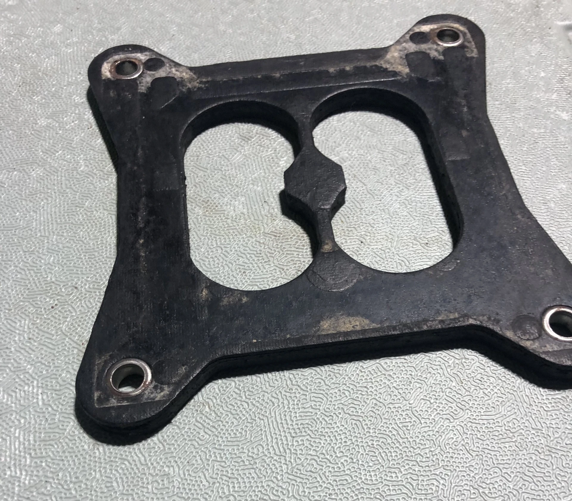

I do have a spacer under the carb, I replaced the gaskets it came with higher waulity gaskets...the 3rd picture is the gasket that was under the Edelbrock the engine came with...Maybe I should go with a Holley version of that?

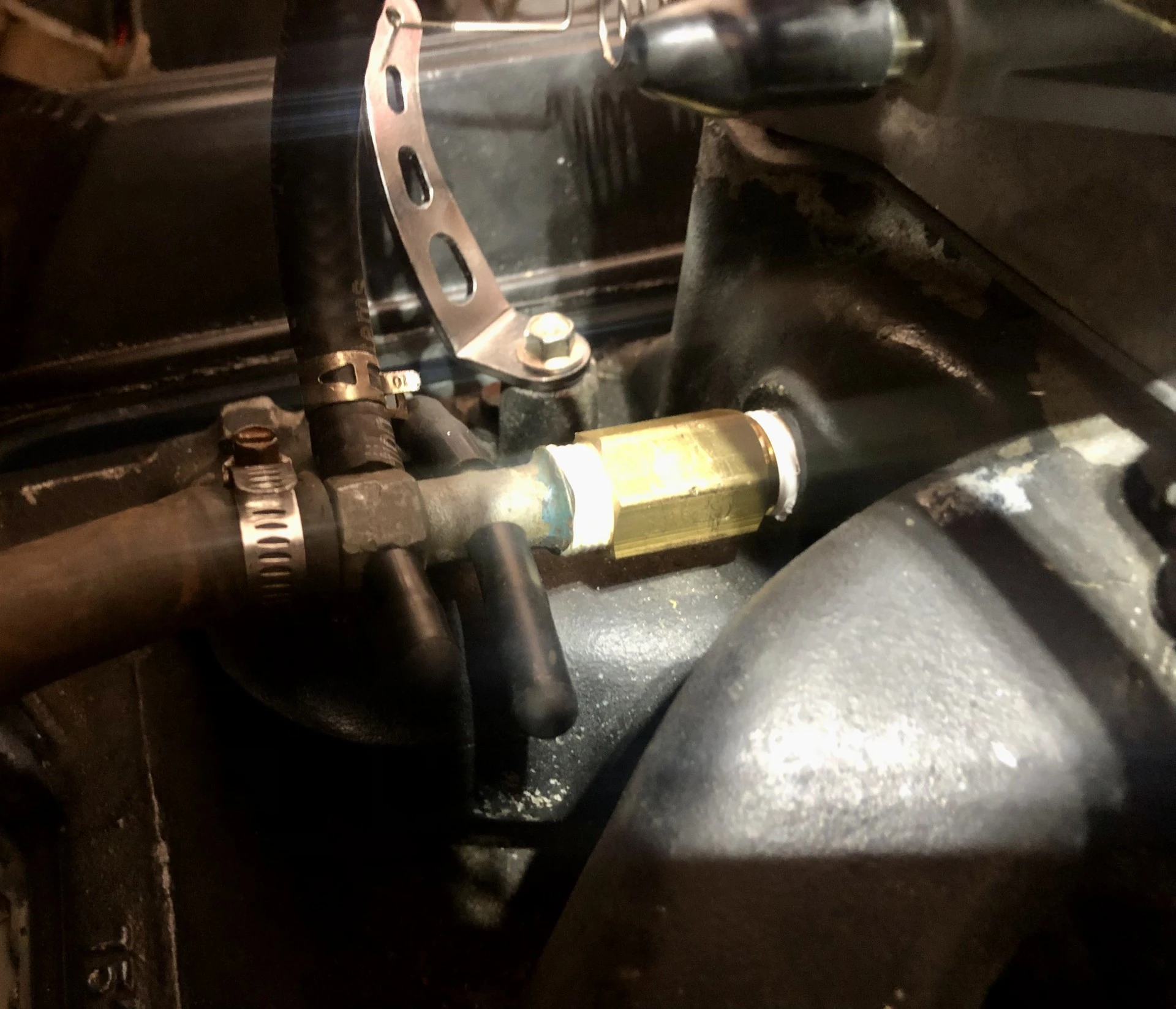

#2--When I installed my vacuum tree into this engines manifold I did so using thread tape assuming that is good enough, but is there maybe a specific type of thread tape I should have used that helps to elimnate vacuum leaks?
remove this hose and plug it at the intake manifold....

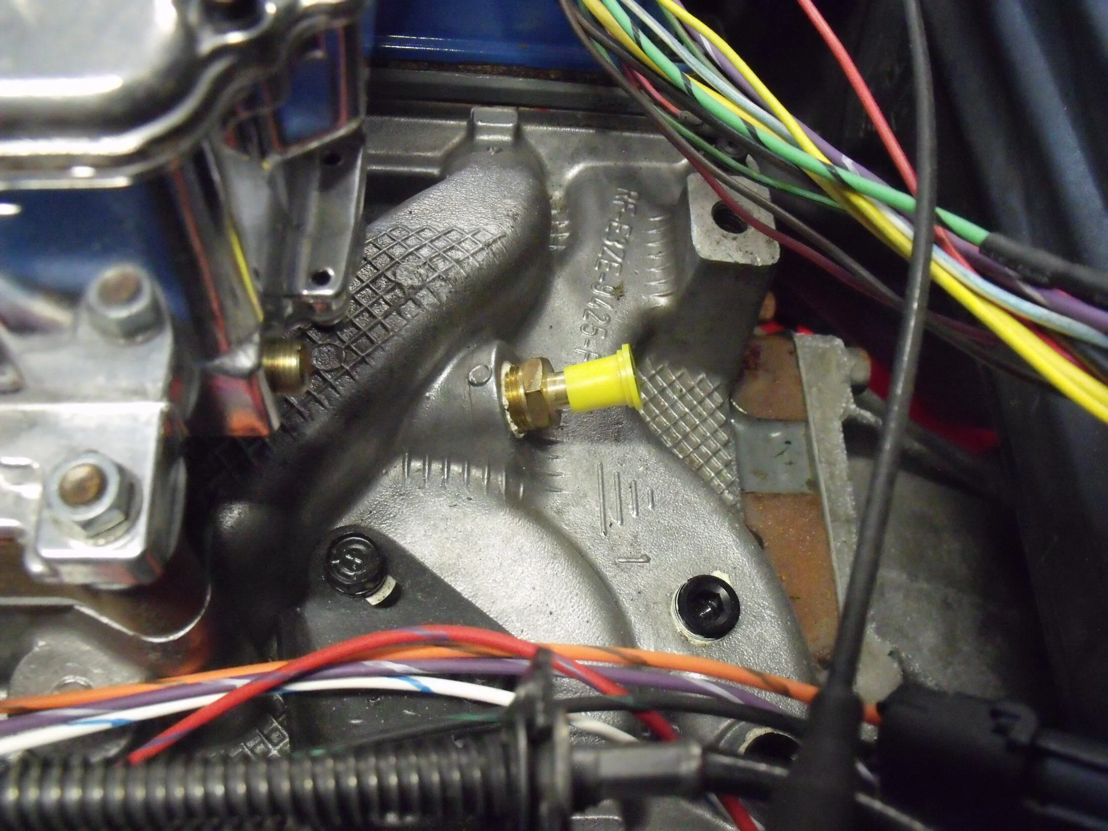

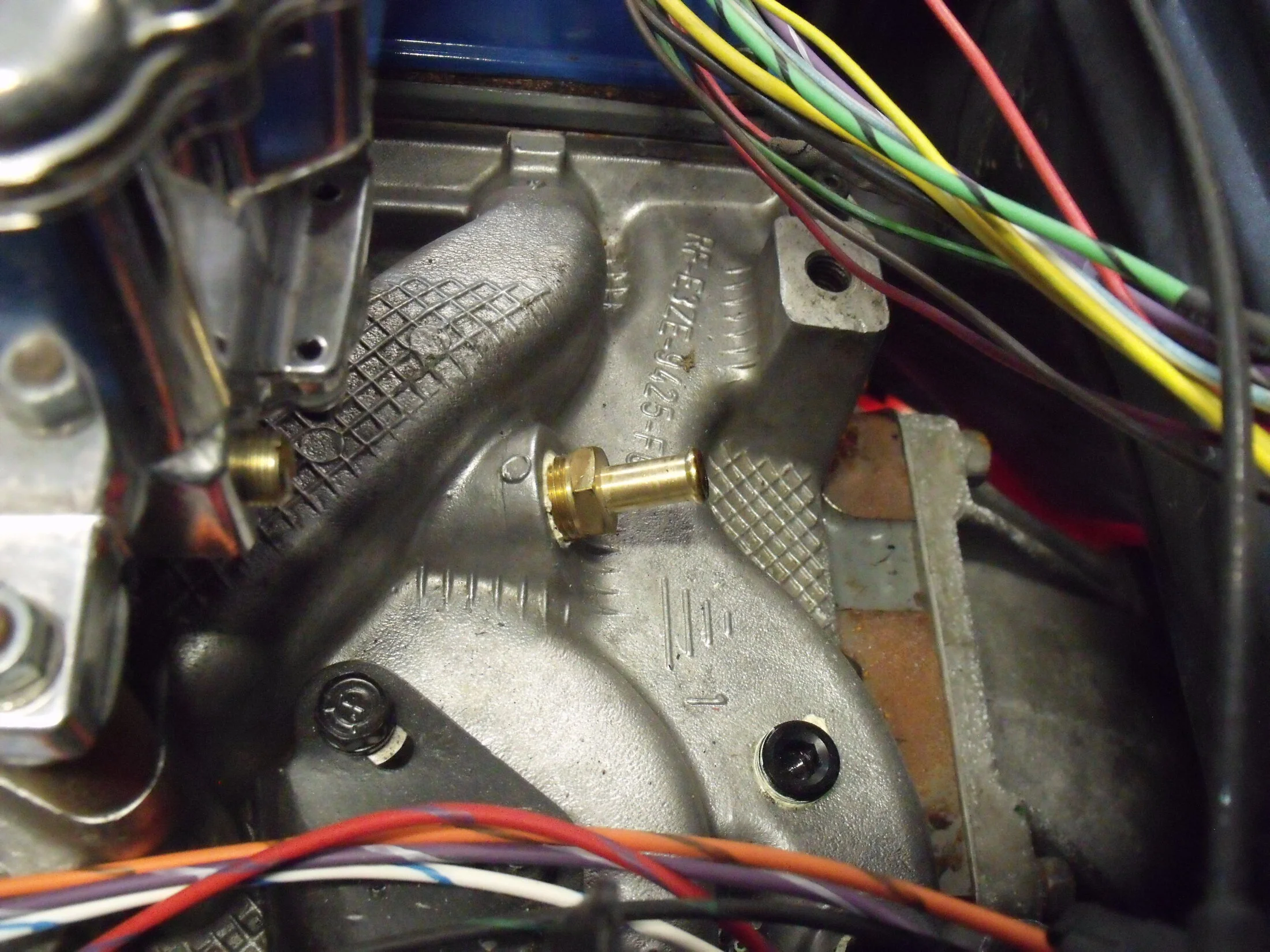

Here is the back of my intake manifold outlet for vacuum to my tree... Its shown open and capped for first start..
The more I " think " about it I think you have a vacuum leak, so baby steps here taking everything out of the vacuum system that could leak from this fitting..
What year is your car? Mine is an 83 and the correct vacuum tree is not made anymore, although I think this newer one would work.. If that was my car I would install a fitting like mine and run a vacuum line to a vacuum tree....
Notice the two black plugs in the lower part of my picture plugging up two vacuum ports... Do you have any open on your intake??
Here are 3 vacuum ports on the front of my Carb... Do you have them plugged? Mine are capped with a rubber cap.. The second picture shows the small port/capped to the right of the larger port/capped..... Your carb might be different, but you should have at least 2 ports in this area...

With matching gaskets and spacer you can bolt the carb back on.
So I am pretty sure all my intake openings are capped off, However it appears that you used something other than tape to seal yours...What did you use to seal your fittings?
