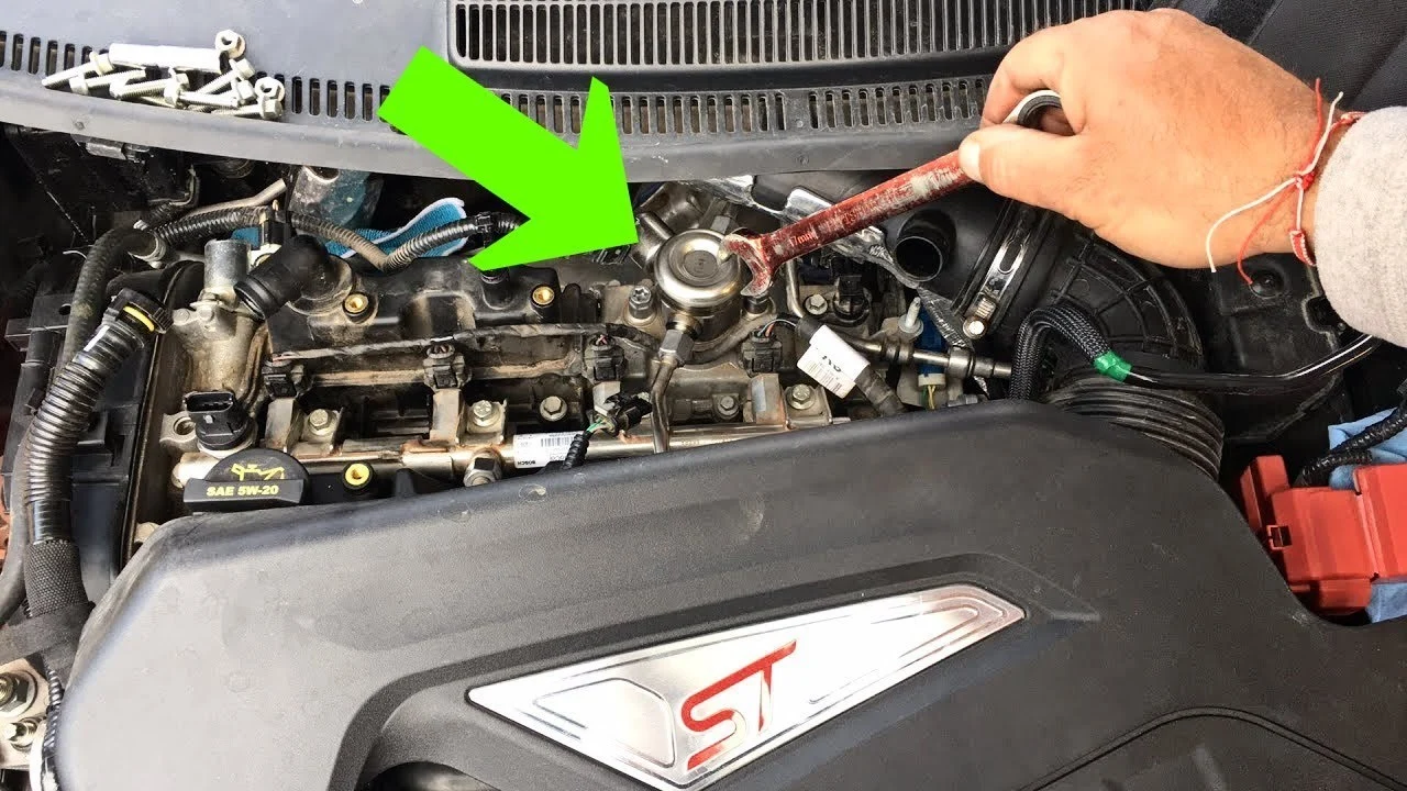

If the ticking is centered around the part the green arrow is pointing at, (image is from an ST, Mustang should look similar) it's a normal byproduct of direct injection. It doesn't matter who makes it, Hyundai/Kia, GM, Toyota, and even BMW directed engines all tick. Unfortunately for Ford and Ford owners, the sound of a cam-driven high pressure fuel pump sounds almost exactly like certain failures in the 5.4 3v and Coyote engines.
If the noise isn't coming from the high pressure pump, then you have cause for concern.
