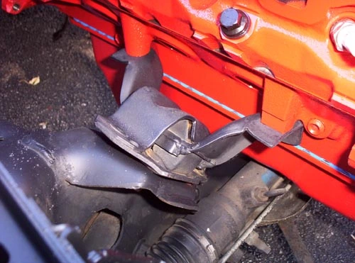

I ran across this picture I took when I did the v8 swap on my 93 vert. This is the "convertible" style mount. They are stronger than the standard mount because the rubber part in totally enclosed in metal so it cant rip apart. You should end up with it looking like this. If you go tp the parts store and buy the standard mounts, I believe that they dont come with the plate that bolts to the motor. Just the rubber part.

SPEED FREAK said:
Your best bet is to go buy some 88 mustang convertible (5.0) mounts. Those work great and will lower the motor a bit.
why is that? not denying it, just curious :shrug:
it does make sense that the vert mounts would be stronger, but lower? why 88?
