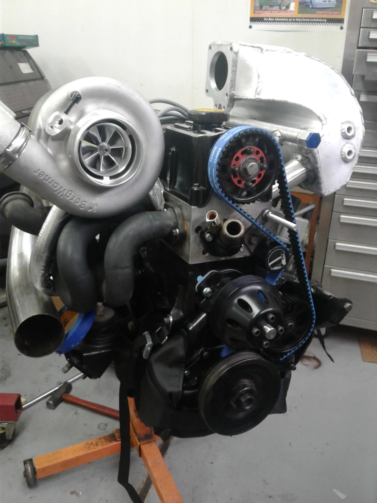

My factory block (hardblocked to the waterpump) made many 9 sec passes but the stock crank finally broke back in 2019 and took the block with it.
I have since upgraded to a svo motorsport tall deck block with esslinger svo head. It is a monster but it is really putting my poor C4 trans to the test. Trans is out getting new clutches as we speak. Here is the new engine before I dropped it in the car.

Rods/pistons w/rings were about $1k. Header was $800. Ported intake setup was $450. The big $ item for making power on these engines was the head. Boport stage 3 ported aluminum dport with solid roller essy turbo cam was about $3500. Turbo was a Precision 6466 that was $1500. Never dynoed but figuring weight/trap speed it should have been in the 600rwhp range.
