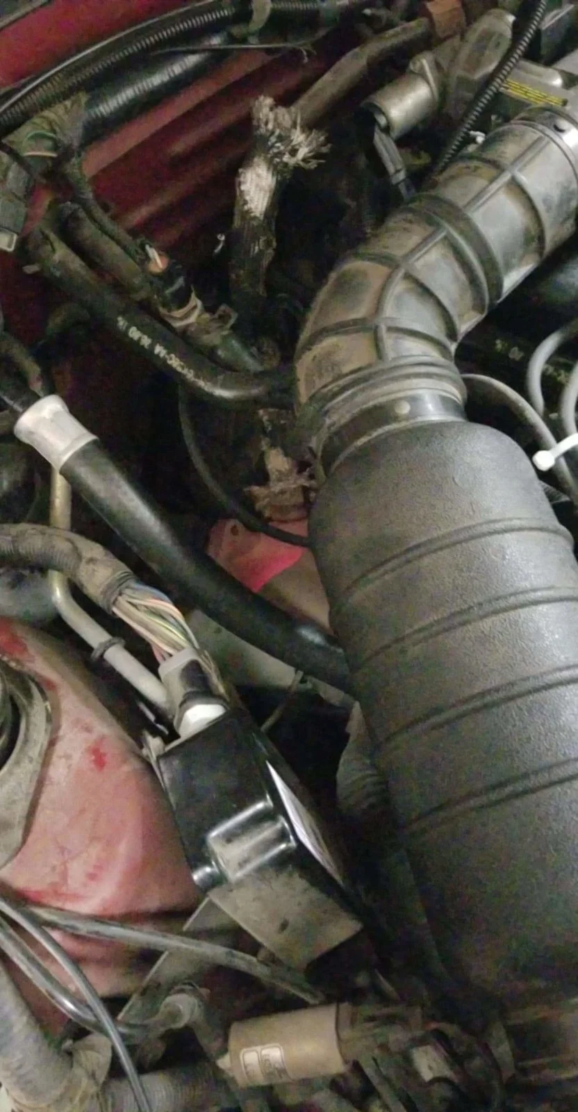

So For a couple of weeks now, my car has been stuck in limp mode. It has a very slow acceleration and the last time I drove it anywhere it stalled out. It really can't make it up my hill at anything more than 10-20 MPH. Every weekend I've been frantically fixing possible causes, because she's really my only ride without causing my family a bunch of trouble. First theory I had was that the TPS finally gave out, the last time I had pulled codes the sensor threw one at me. While I had the Throttle Body out I decided I would also clean that out with some throttle body cleaner since the inside of it was disgusting and black. In addition I changed the throttle bodies gaskets just so it wouldn't have any issues in the long run. Wen't for a test drive. Didn't fix the problem. Still stuck in limp mode.
When that didn't work, I crossed it off my list and started doing more research. I bought a code reader to make pulling them easy, and it gave me a code 998 (limp mode), and a 224 (Erratic Ignition Diagnostic Monitor "IDM" input to processor). I know this has to do with the coils but we did some more research and some people were claiming that they changed their spark plugs and it fixed very similar issues. So this last weekend I tried that. I changed the spark plugs and the ignition wires. Went for a test drive. Didn't fix the problem. Still stuck in limp mode, but this time I had a surprise when I got home. The exhaust manifold was glowing red hot like an oven!

At this point we are thinking one of three things have gone bad. Either
A. The timing is bad from when we took the crankshaft bolt off weeks ago to investigate for my oil leak.
B. The O2 sensor is bad.
C. The Cat Converter is bad.
I'm honestly at a loss. Should I have just trusted the codes and replaced the coils and wiring for it? Would it have gone this way anyway because of the timing? Am I even looking at the right possibilities? Any help would be appreciated. I just want to get her back on the road again. Thank you!
The red hot exhaust manifold says lean, could be plugged cats.
does it have a lot of miles? Late timing can cause that too.
i would check the timing belt then pull the exhaust pipe off the manifold and see if it runs better
i will admit to not knowing much about the 4 cylinder engines.
if the timing belt was never removed, and it ran ok prior to removing the lower pulley, there is little likelihood that the belt has an issue. 998 is "usually" throwed when the EEC goes into FMEF (failure mode effects management). FMEF can be triggered by a failed EEC (computer)-but there is no reliable way to test it, so you need to use the process of elimination to eliminate wiring and sensor issues. Also, a failed EEC can be caused by a lot of things, electrical short, electrical surge (lightning can cause it), sometimes hooking up jumper cables backwards, or it can just fry on it's own (circuit board problem). Another way to "test" the EEC is to replace with a known good one.
The exhaust has always sounded pretty ratty, I figured it had a leak somewhere but maybe the Cat was starting to go the whole time. Also, I recently replaced the coils, and it seems to have gotten rid of my engine light, but she still has super low power. So something else is definitely off. I dropped her off at a trusted shop yesterday, so hopefully they can find the problem and tell me what's up. I just don't have anymore time to troubleshoot myself. Oh, and I'm pretty sure that when the manifold went oven on me it melted something on the heater core, cause now I have a new coolant leak from somewhere between the firewall and the dashboard. The problems are just jumping out at me this month!
Yeah I expected it to have problems, there have just been a whole lot of other things going down the drain this month. Anyway, I called the dealership on Friday and they said that the crankshaft bolt is "bored out" and that they want to find a new one before we go any further so that it doesn't cause more damage. So I think I found the right bolt on Ebay, same part number and it looks in good enough shape so I got it. I really wish there were more parts for my engine floating around, but the 2.3 seems so illusive (Just another reason to swap the engine at some point ).
So, an update. I took the car to the shop cause I really couldn't figure it out. Turns out, the crankshaft bolts washer had gone missing during the cars 20+ years of life. So, when we put the bolt back on, it quickly dug a second notch into its hub - throwing the timing off about 20 degrees. Apparently that's all it was. She's been back on the road now for about a week and I've had none of the same problems. She's running great now aside from the blown heater core and the computer that's going a bit ca-putz now. at least I'm keeping busy! Thanks for your guys' suggestions.
