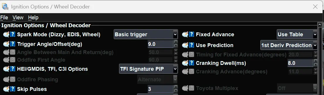

Your spark advanced is fixed. Do you have fixed advance, or used table set under ignition settings??
