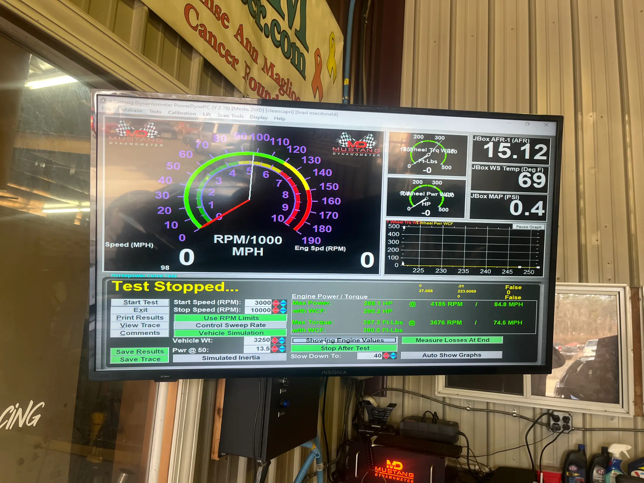

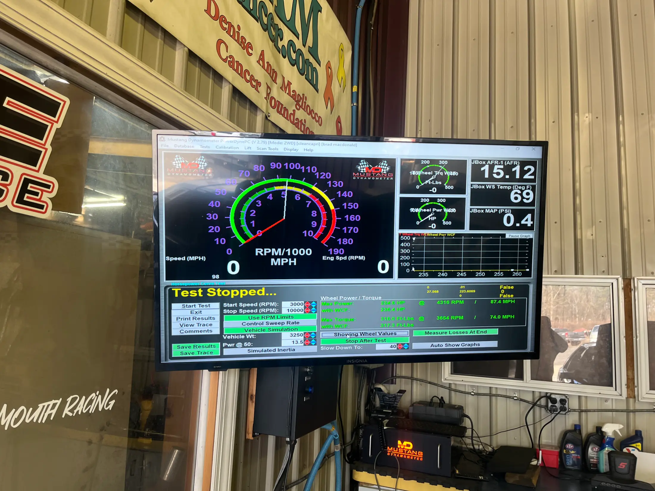

So it turns out there was more to my issue than just the tune. My coil was on its way out and finally just quit altogether. I did wind up taking the car to get dyno tuned yesterday and it did pretty good. It’s not perfect on start up yet. Probably still a little rich and the idle surges until warm but eventually smooths out. The car will occasionally stall out when put into gear if you don’t give it some throttle to keep it going. It looked like the iac was possibly sticking and recovering quick enough. We put a different one on while at the dyno and it definitely helped, so I have a new one on order. I can post up the current tune and a data log to see what you think.
First picture is estimated engine power and the second is power to the wheels. Overall pretty happy with it.
