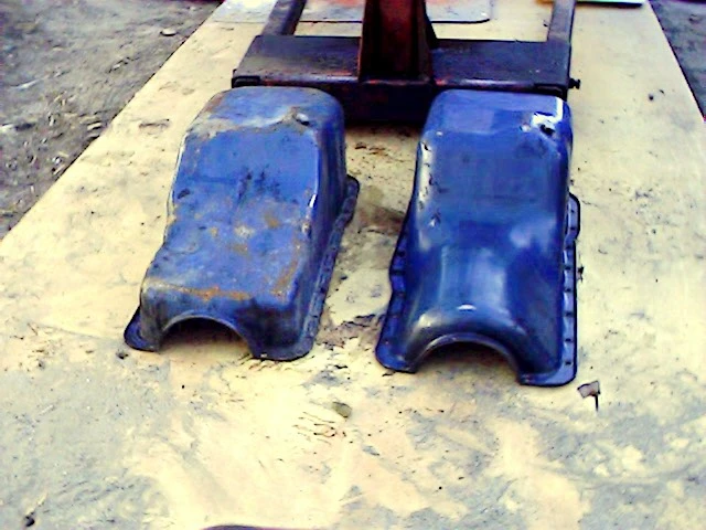

The easiest/best oil pan to use it the II specific one, I'm not aware of it interfering with any other bellhousings.
At the moment, in my '75, I've got a Milodon 8-qt oil pan with the stock C4 bellhousing and flexplate, had to run a 93-95 Mustang starter to clear the pan though.
No oil pan issues concerning bellhousings per se, mainly starter location and cross member clearance. Some standard front sump pans are a bit too deep in the shallow section for the stock motor mounts to be able to sit where they are supposed to-ran into that once, it sucked. So a II oil pan is definitely the easiest way to go about it. The alternative is shimming the block side mounts in order for your pan to clear. If you do this, double check your pinion angle as it will undoubtedly affect it. It may not be a problem(?). This may also alleviate starter clearance, but I never got that far with my install years ago. Switching to a later model "mini" starter is generally a good way to go though. If you are going to be installing headers (of course, depending on the design/manufacturer), the later model starter will also give a little clearance in that respect.

Thanks for all this help guys! A few more questions and i should be good! If I use a 157t bell housing will that affect the fitment of MII specific headers? Also, I found a oil pan that "fits" a MII it is a Spectre 5507. It's a lot cheaper but i'm not certain of what the right oil pan should look like. I probably will shim the mounts considering I will probably make my own. I know i have an 8in but I leaning towards 3.08 gears. One last question, how much "massaging" do you think will be done to fit non MII specific parts in? Once again thanks for the help!
I don't think the bell will cause issues with header fitment, but I could be wrong. I guess it would really depend on starter location and header tube routing. I also can't speak to the Spectre oil pan as I have only used a stock II pan. I can tell you, speaking from memory, that a "regular" passenger car front sump pan-at least the one I had-had a slightly raised portion between the shallow end and the sump end. I guess you could call it a slight step? The II pan does not have that step. Googling images, I come up with a couple, one of a stock II pan, and one comparison of a passenger car to a II pan, the II pan is on the right.
