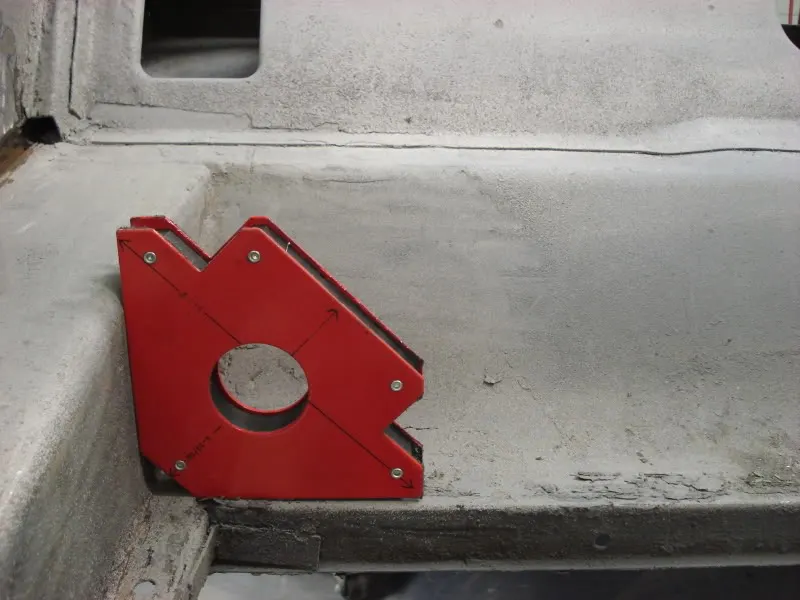

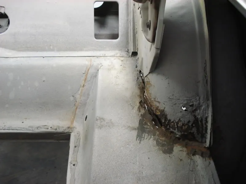

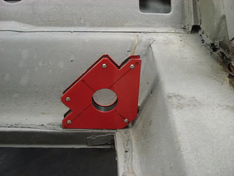

First qustion, is this trunk part correct like this? The left side is pretty much dead vertical, the right side leans heavily towards the right, say 110 degrees instead of 90. For those of you that have seen my little trunk nightmare you can see that this side is worse than the other, what fun.

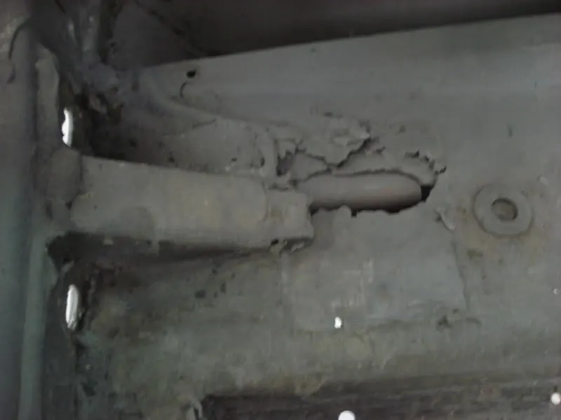

Second question, a picture would help if anyone has one, what does this little nightmare supposed to look like? Does the bumper brace/gusset thing just weld to the trunk sheet metal or is there a heavier plate there? It would appear that most of my trunk is a series of holes filled with tar.

Your trunk floor and RH inner wheel house are pretty well trashed. A slight angle surprisingly won't have much effect, but while it's apart go ahead and straighten it. It should look like this:
Yours looks like it has an angle to it as well so I guess the part of mine that is intact is ok. It just seems odd that the left side of the gas tank hole has a vertical wall and the right side has a pretty significant lean towards the right, not symetrical at all, looks goofy in my opinion.
That's easy to explain- The Mustang gas tank isn't in the center of the car.
