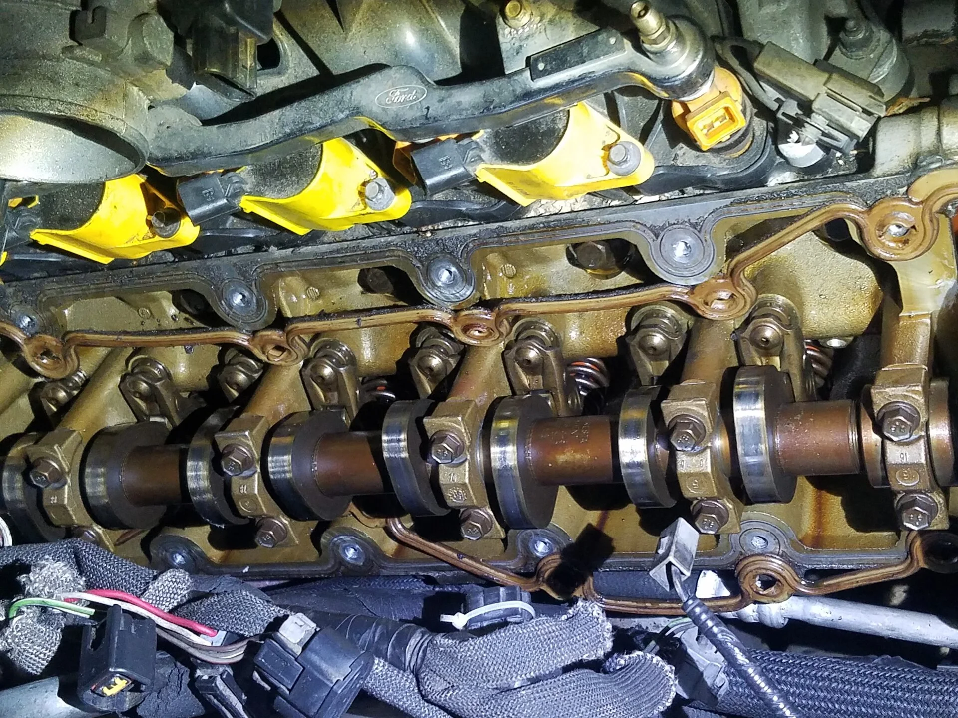

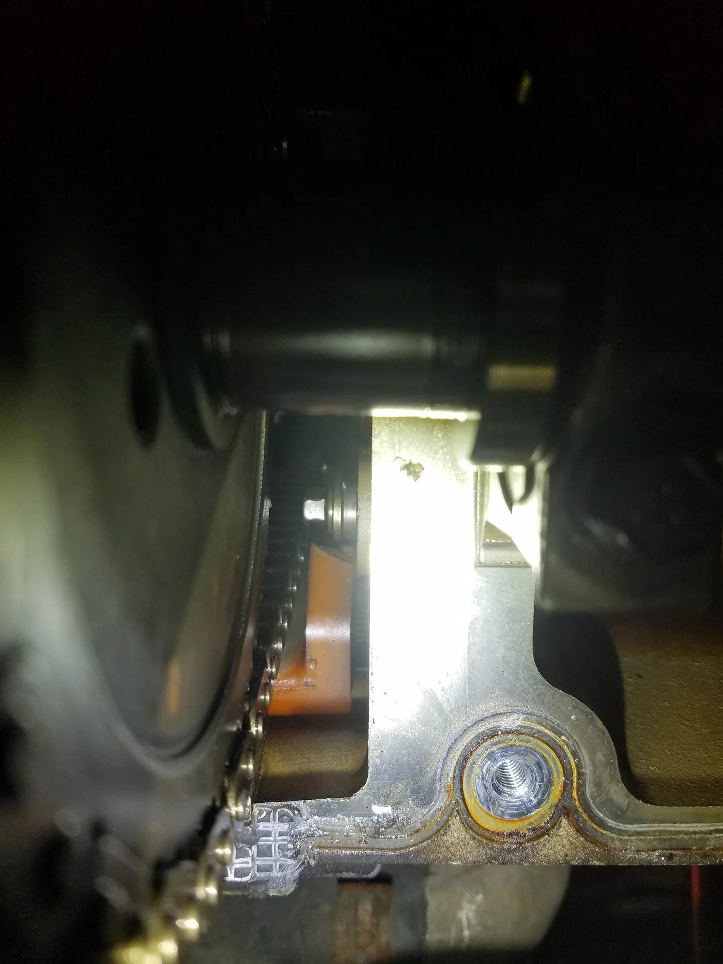

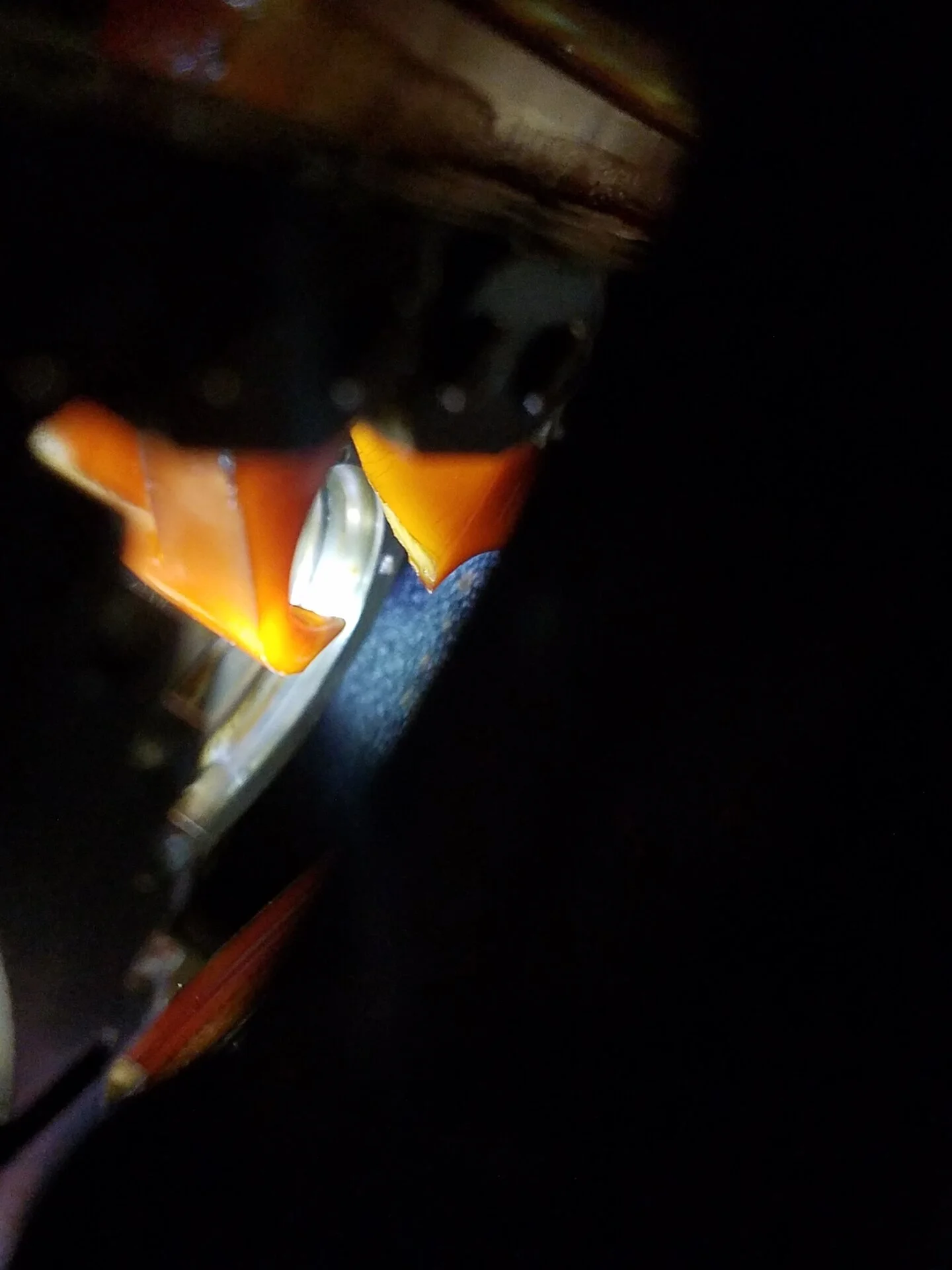

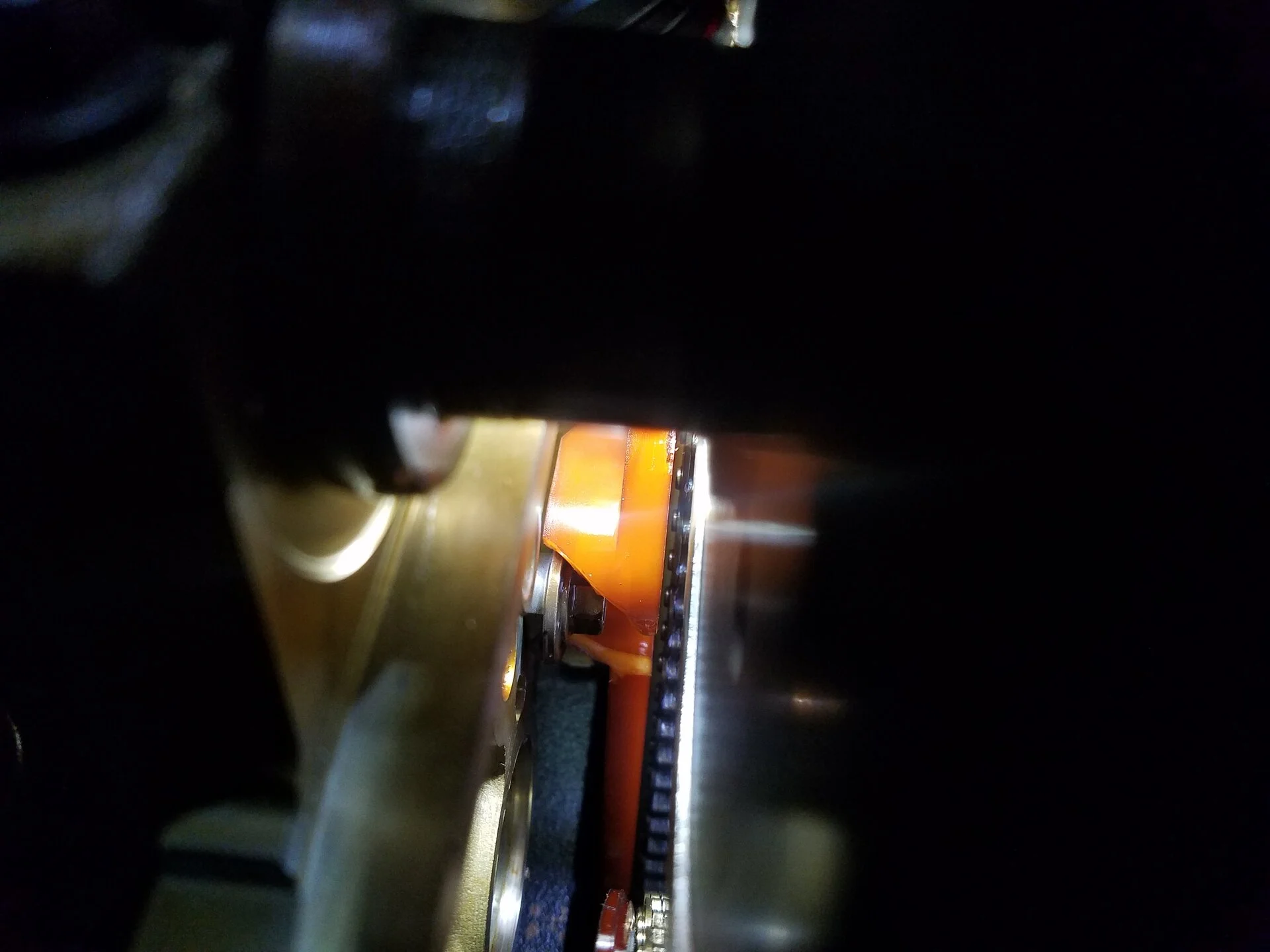

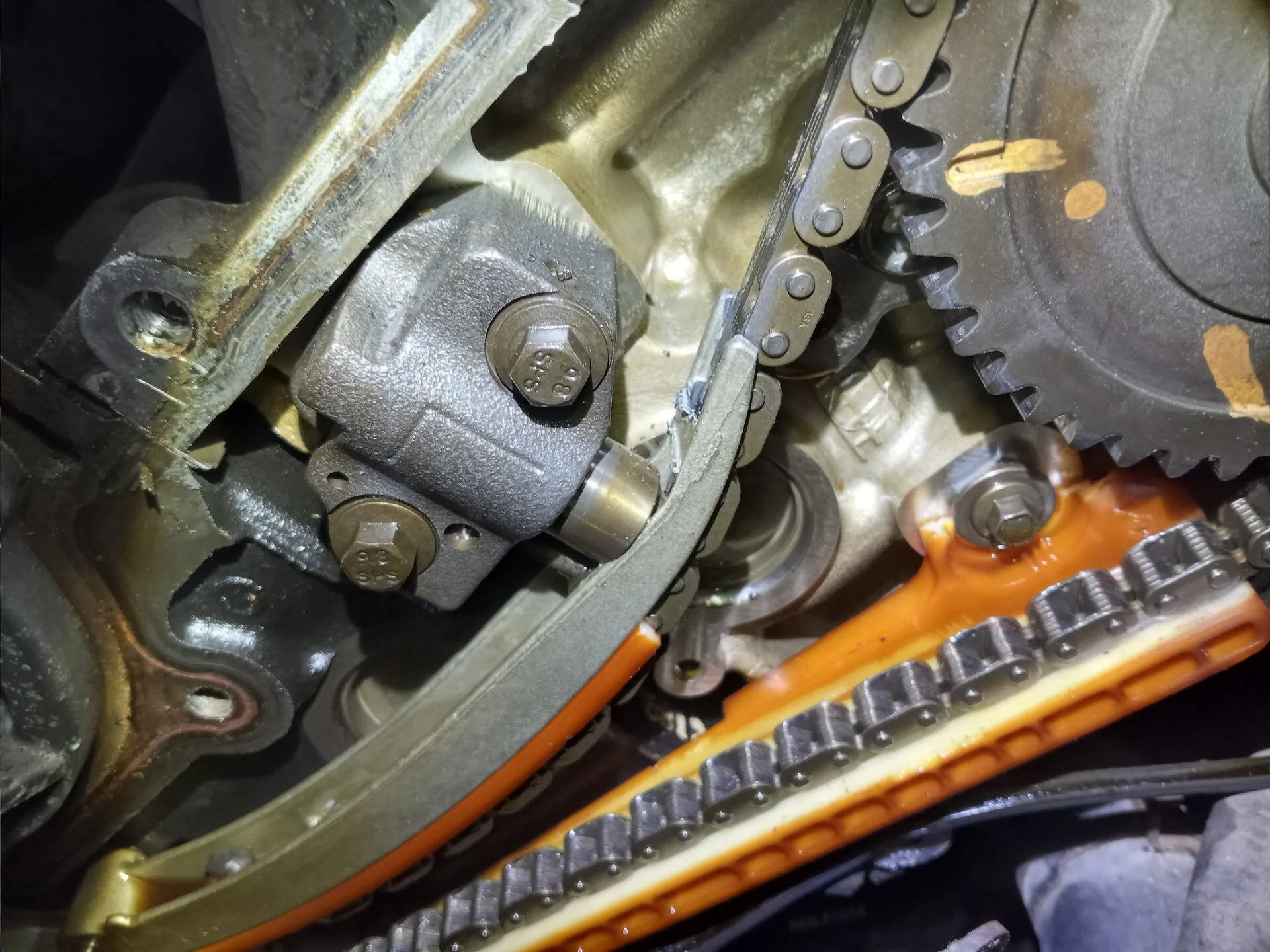

So You are Very Correct! I pulled the Valve Covers off and found quite the mess! Broken Guides and broken pieces wedged under the chain. Plus the chain has a few bad spots! I'm super shocked! Plus Shaving of The chain in my oil!

I hate to be bearer of bad news, but shavings in the oil is the least of your concerns. Now you to worry about where the rest of those shavings are. Some of those shaving could still be lurking in passageways and make their way into the bearings.
Well... I am still shocked at the mess I found.. I looked a little further and to my understanding... My guides actually broke sooner than I even knew. The chains were laying on the guides and rubbing them and shaving plastic off and that explains why I had the plastic shavings in my oil the last few months. The metal shavings was off the chain. It's pretty beat up. I thought I was only going to change guides but I have to change all of it. The bolt was not the problem at all. With both guides broken and the chain just running on the guides. Also I didn't post the huge piece that was wedged of my guides. I'm lucky I didn't bust the chain and completely wreck the motor. I even ran some sea foam in my oil before i knew this was the problem. Wow u should have seen what came out then.

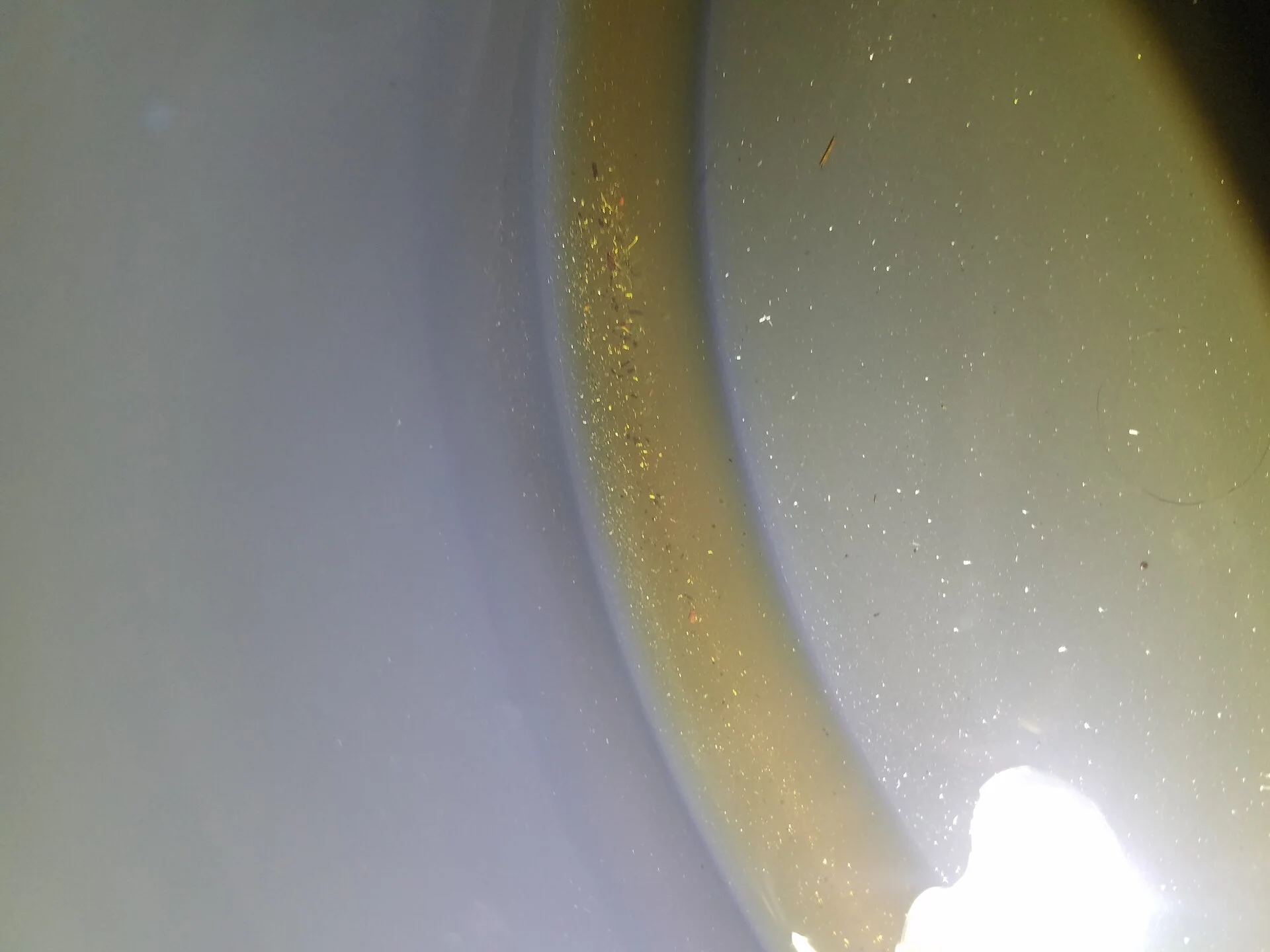

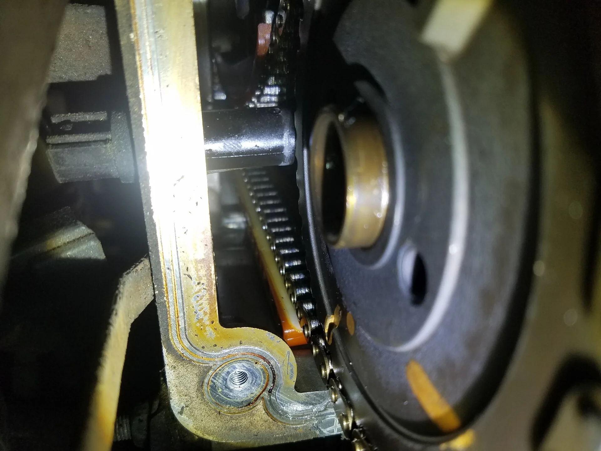

As @Nightfire pointed out. There is really no way of knowing the extent of the metal shavings and damage in your engine, without getting deeper into it.
At the very least, I'd want to pull the pan and view the bearings...check the oil pump. And, pull the cams to see how the cam bearings look as well (which will be accessible a few steps beyond the timing chain(s) r/r. In a perfect world (that may exist somewhere), one might find the debris all went straight to the oil pan and was kept out of the engine by the strainer on the oil pickup and the oil filter---leaving the bearings pristine. I'm not that optimistic, however...this is a big job no matter how you slice it.

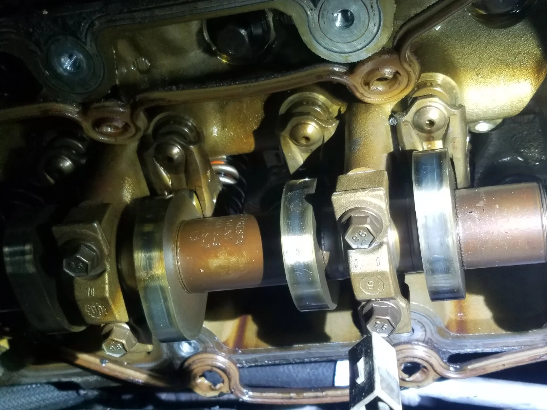

Now u mentioned a very valuable point... I also was thinking about that screen on the oil and that I may want to look at it. I did take these pictures.. I don't know what all it can tell... I plan to get a few more and much better photos soon.

So what exactly does that mean... Remove the caps...
Cam caps are what keep the cams bolted in place. In the 2nd pic, its the part with the bolts.
