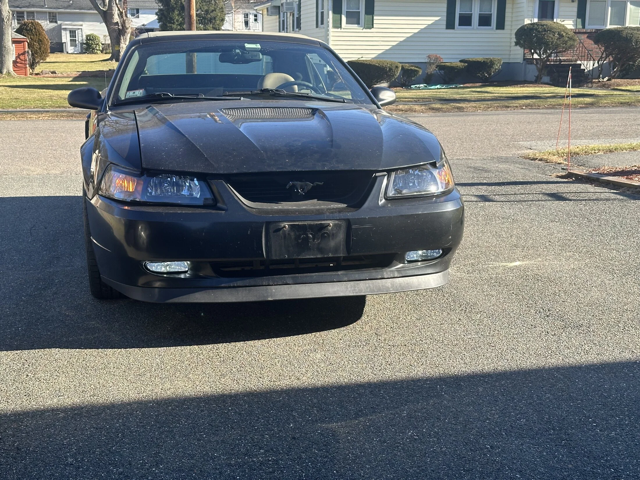

Tried a black pony in grill. Not sure I like it.
Need to work on the seats next

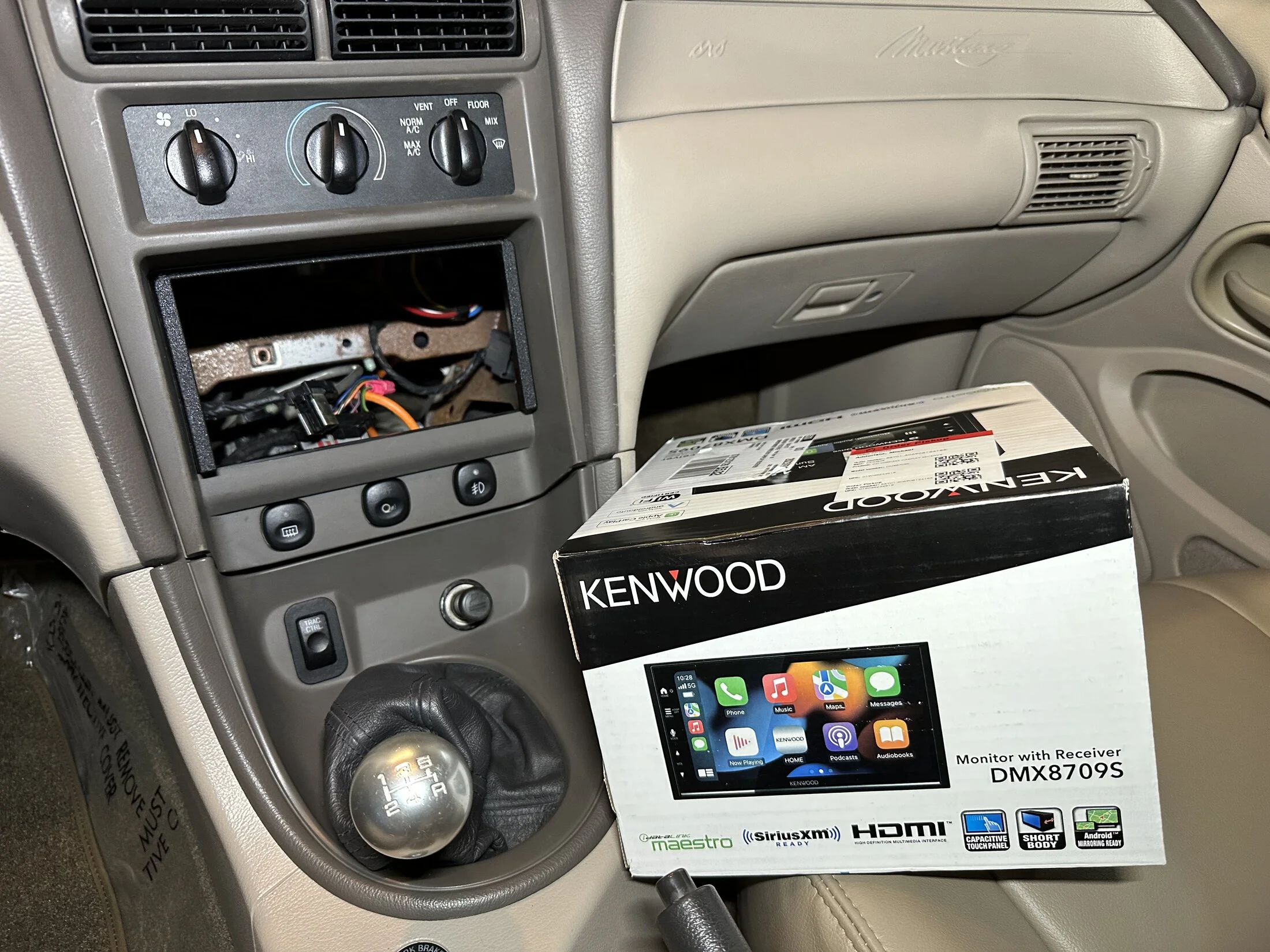

I haven't picked a radio yet. I'm running into the same issue. Lack of knobs. But the 94-00 Mach head unit lacks knobs anyway so not end of the world. I just hate when i'm driving and have to look to find a touch button on a screen and hit it.
Will likely pick this back up over the holidays. Just waiting on shifter boot and I need to rewire the T/C button to move that up.

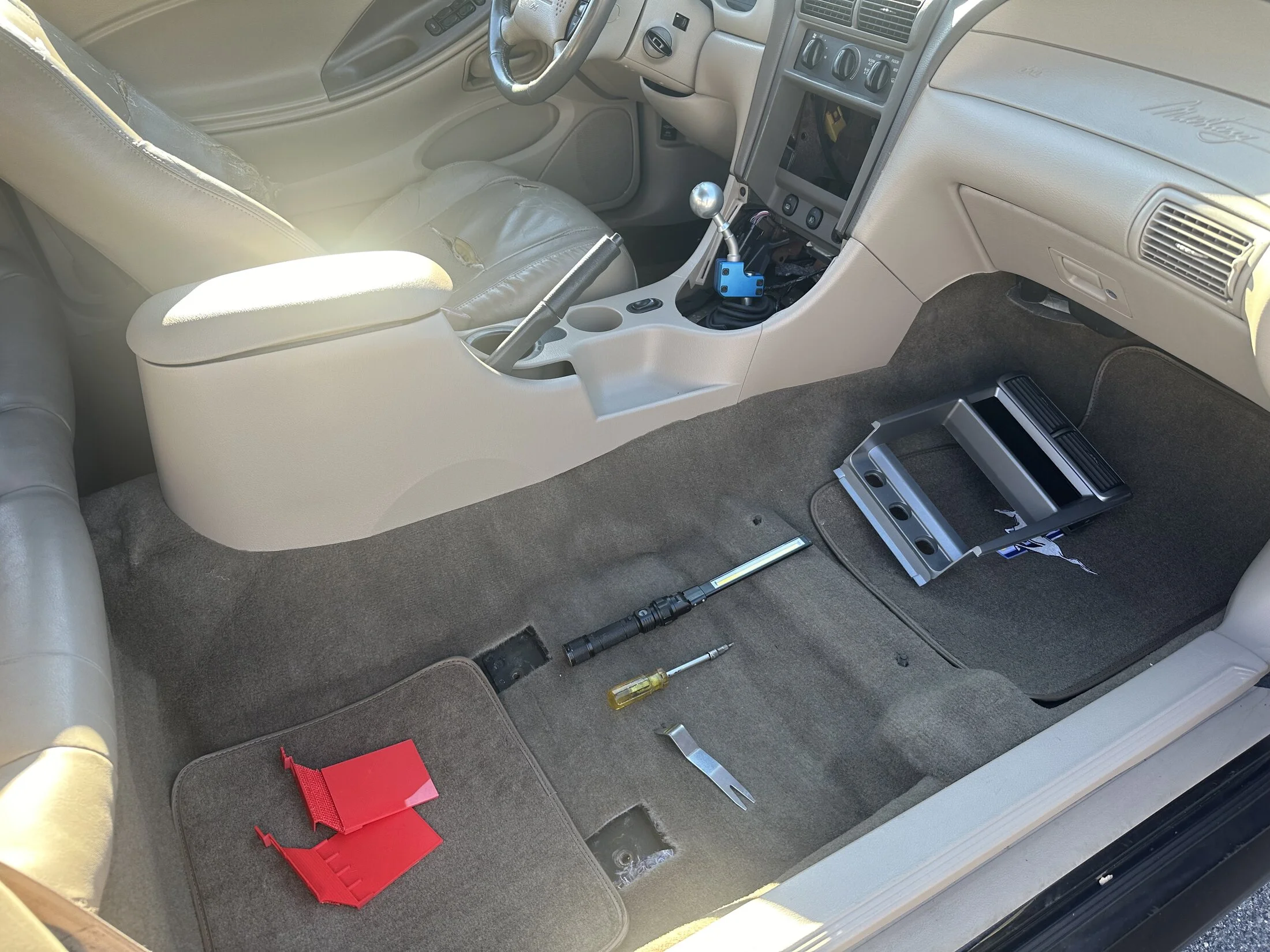

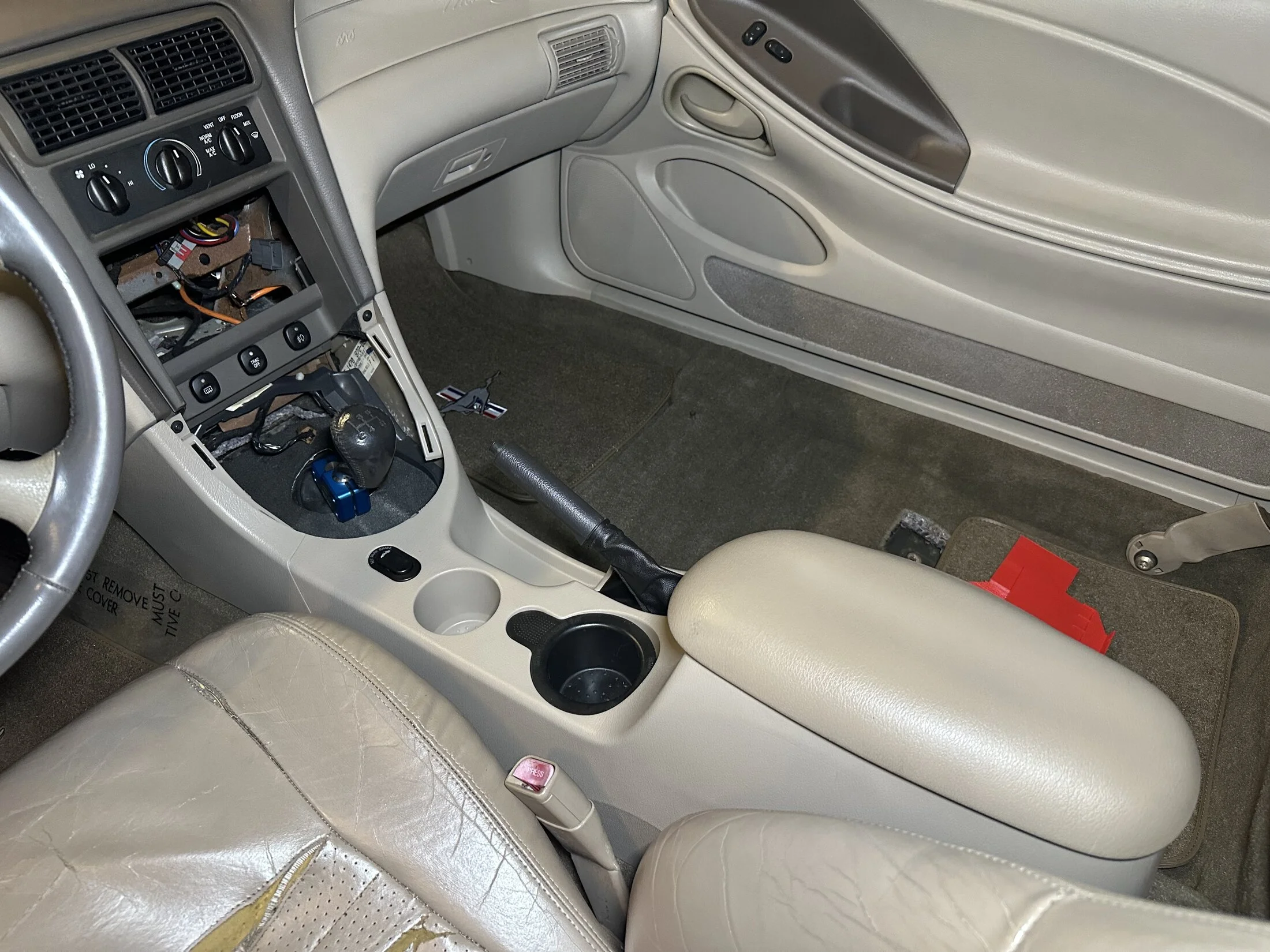

Finished up the console swap by installing an OE style boot. It didn't sit well on the parking braker handle, so I ended up swapping to an 01-04 style parking brake handle which accepts the 01+ boot better.
Buttons are all rewired as well. Just need to get my hands on a good DD radio now and install. Seat recover coming up after.

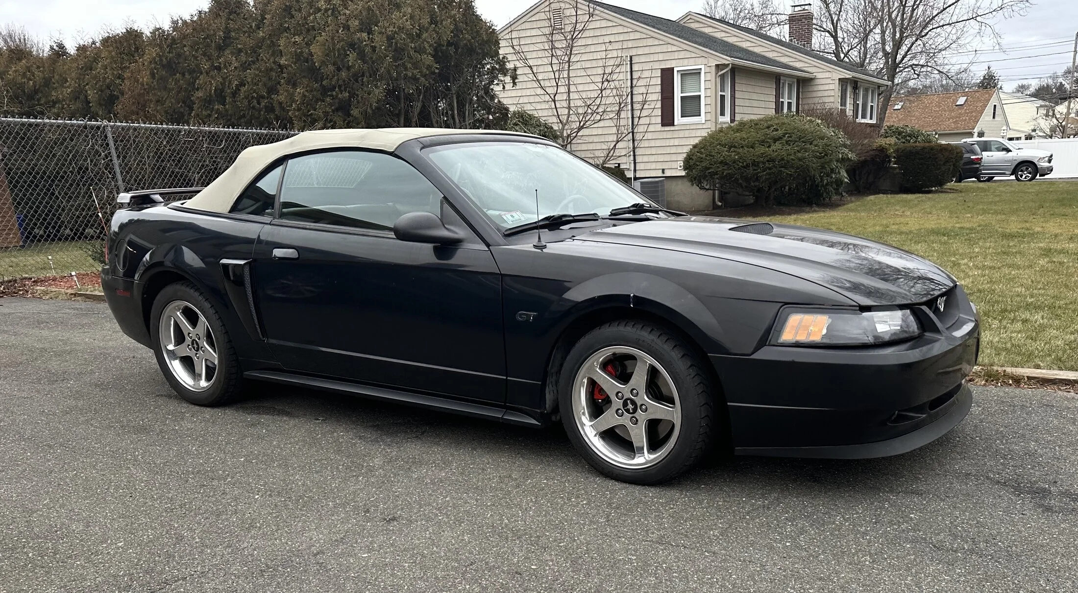

Snow inbound. Took it for a quick drive. Not aligned, but didn’t go far.

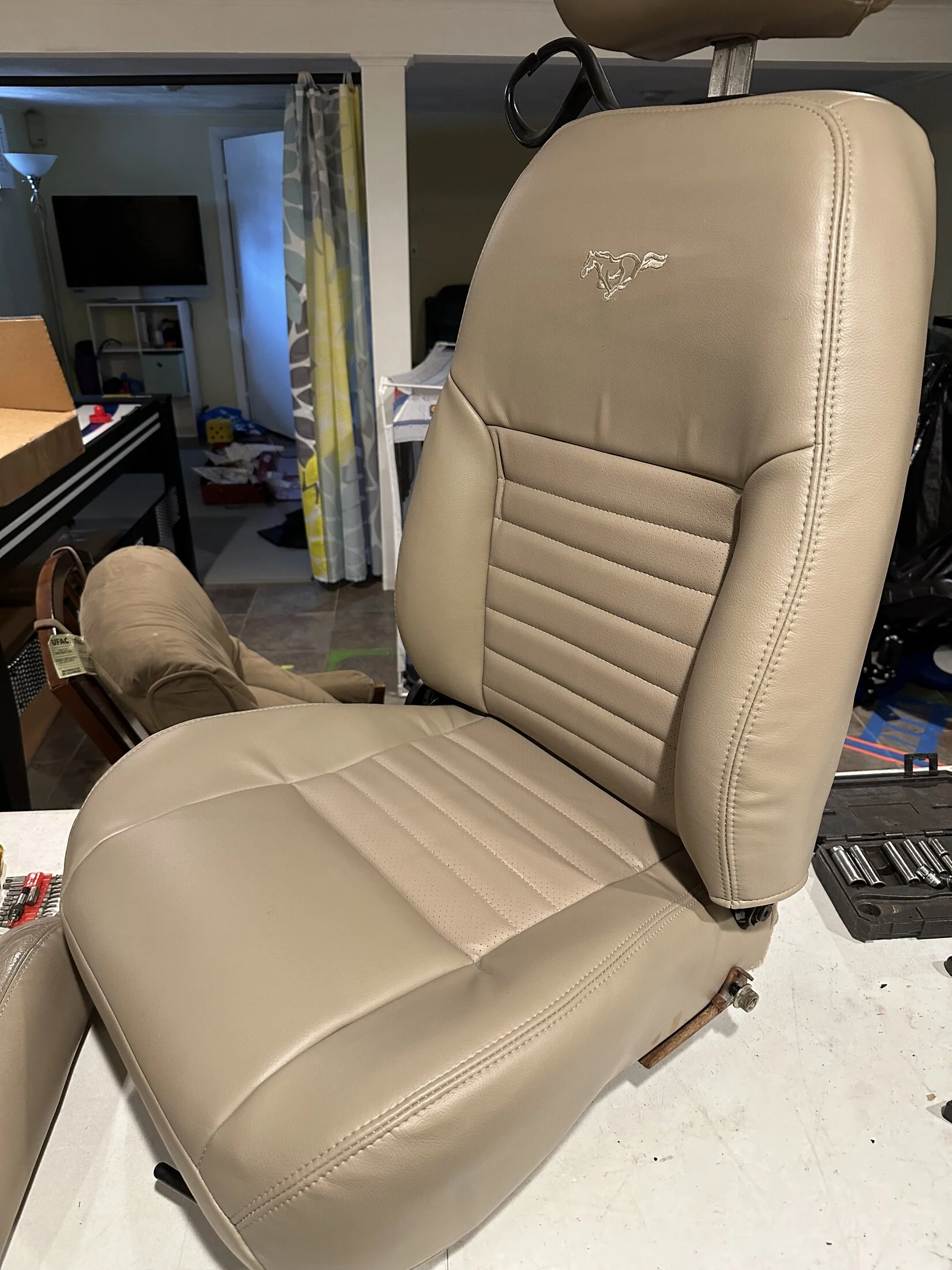

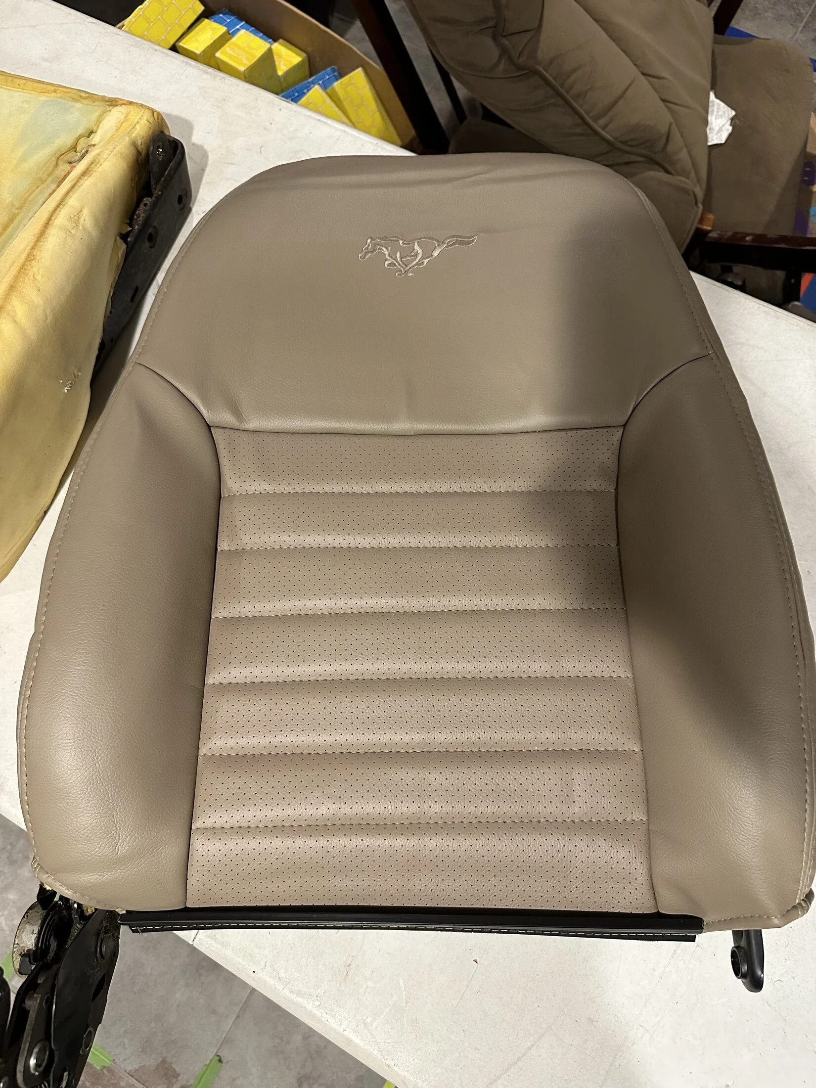

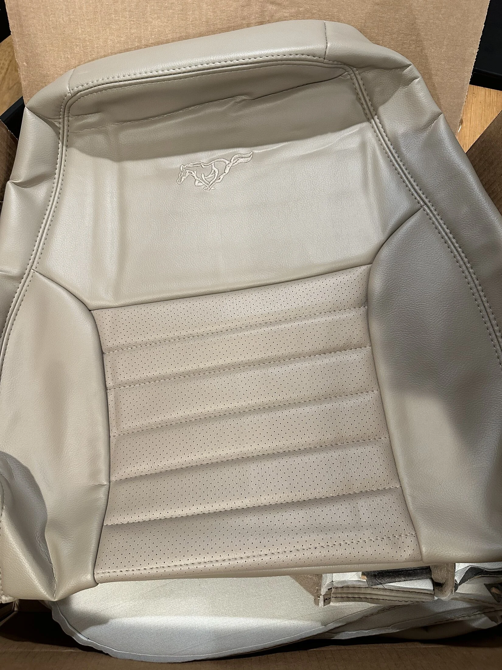

Got the seat covers.
$400 plus ship from Auto Seat Replacement. I’m actually impressed. These are the vinyl versions and they look pretty good. Even the pony is close.

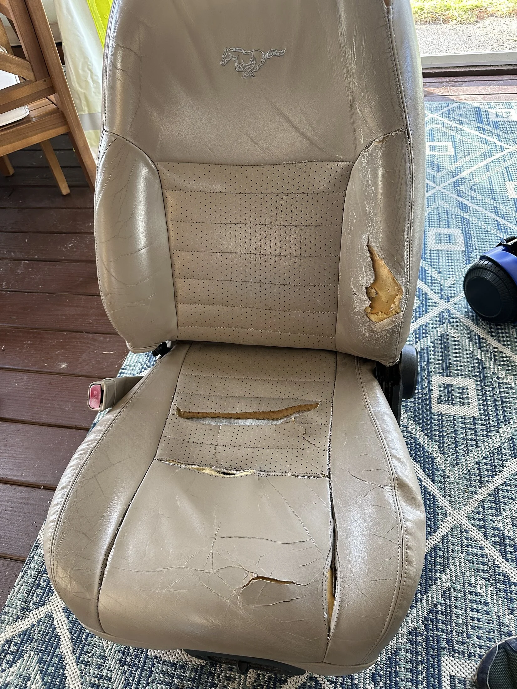

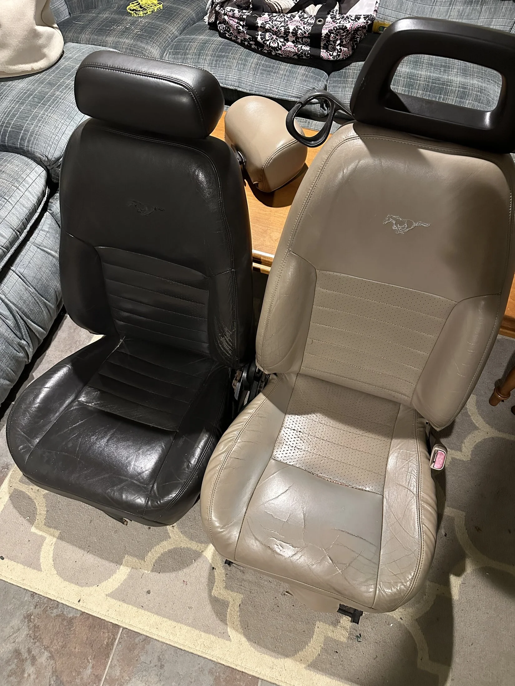

I have four donor seats to use to make 2 nice seats. Likely I will take the foam from the black seats, as it’s in better shape. I haven’t decided if I want to use the 03/04 big headrests, or the fox halos.

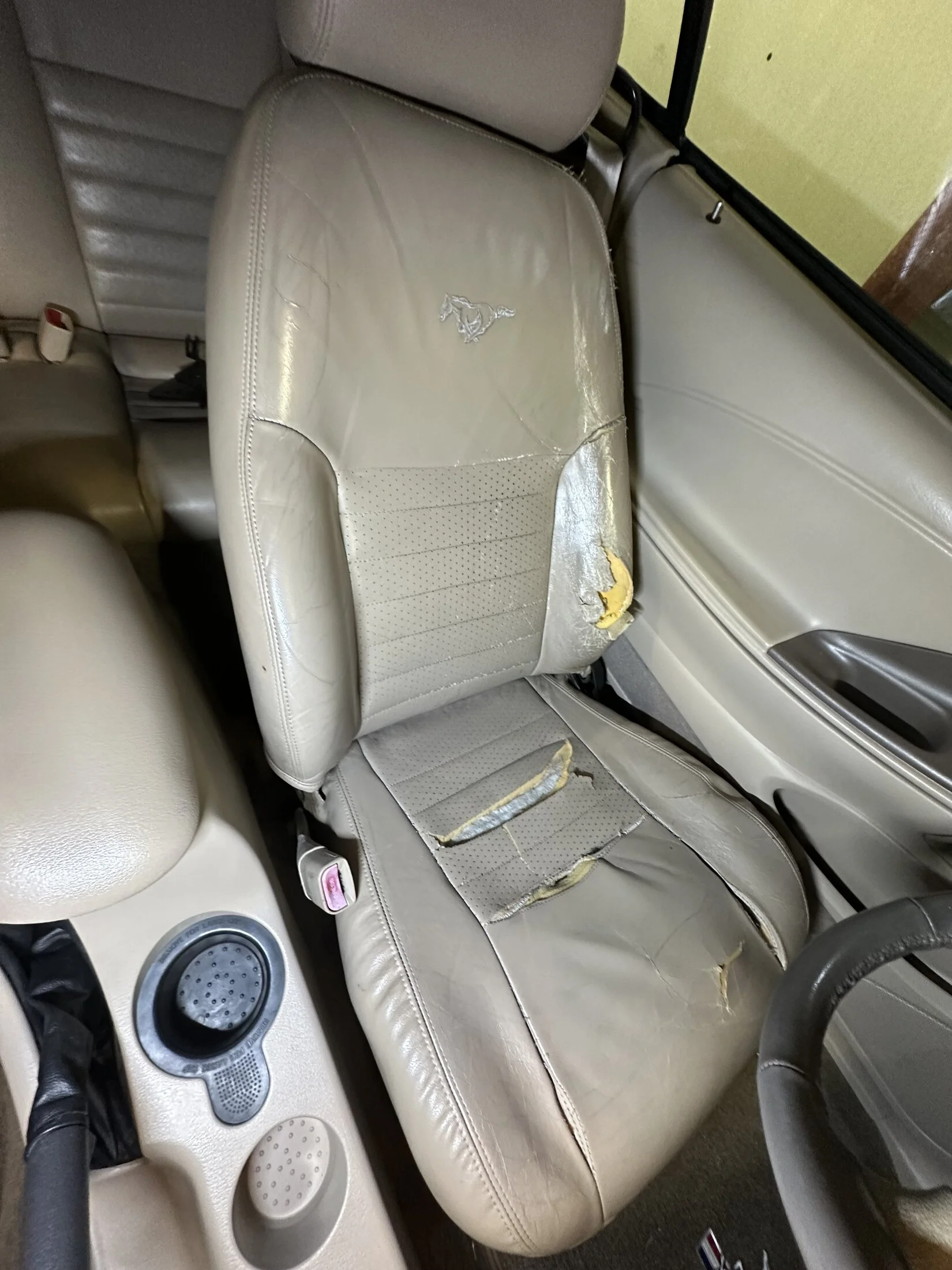

Drivers seat begging for new covers
Reactions: General karthief and 91AOD5.0LX

Started installing one. Nice fit. Gonna let this stretch a bit over nice and work it in and get it nice and tight.

One side done. Wasn’t too bad. A few small wrinkles but I think those will work out the first few drives in the summer sun.

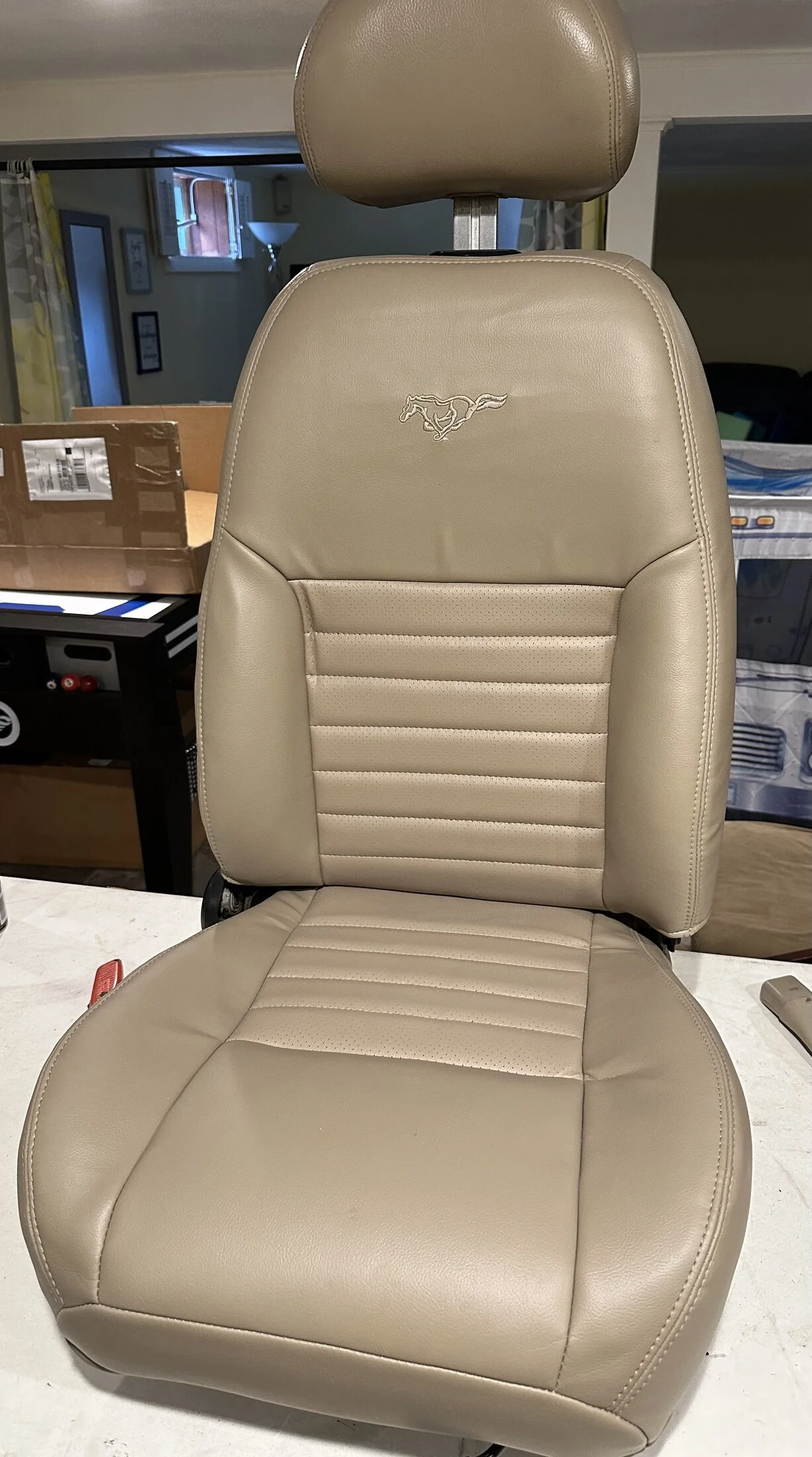

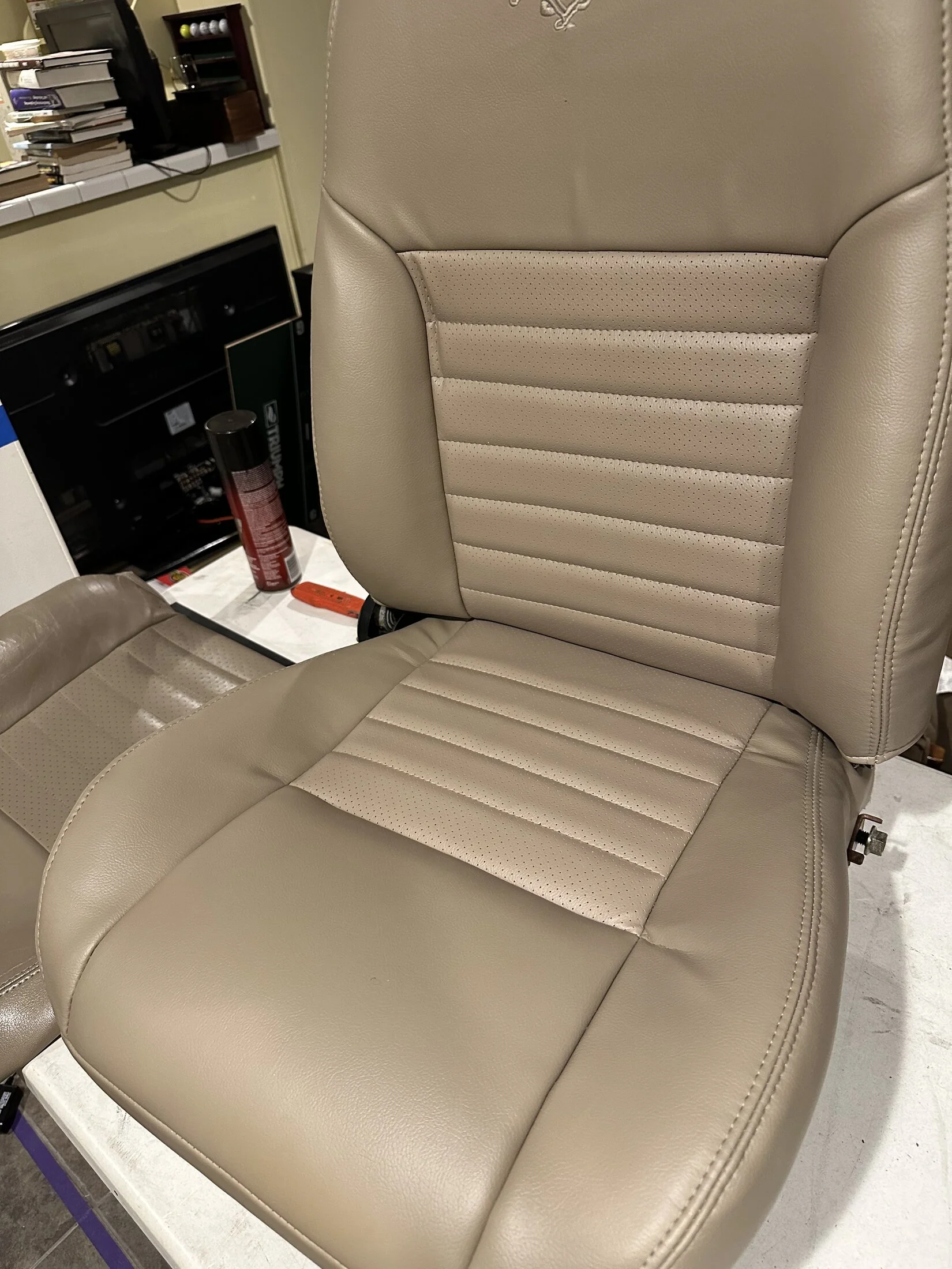

3/4 of the way done. Wanted to test the seat track function and lumbar function as I had to take it all apart to switch some parts around from my other donor seat.

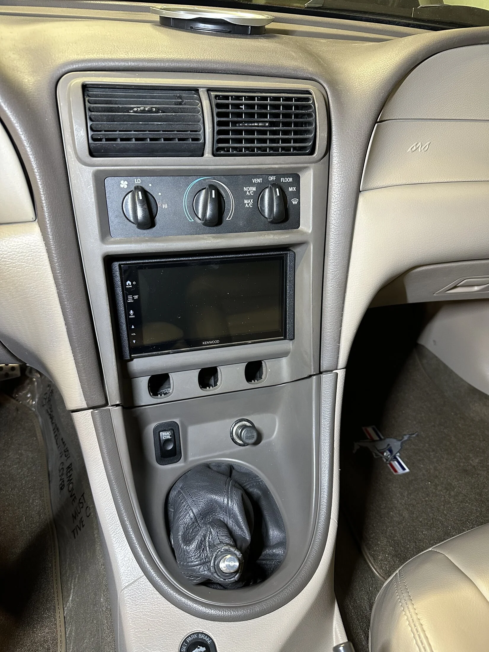

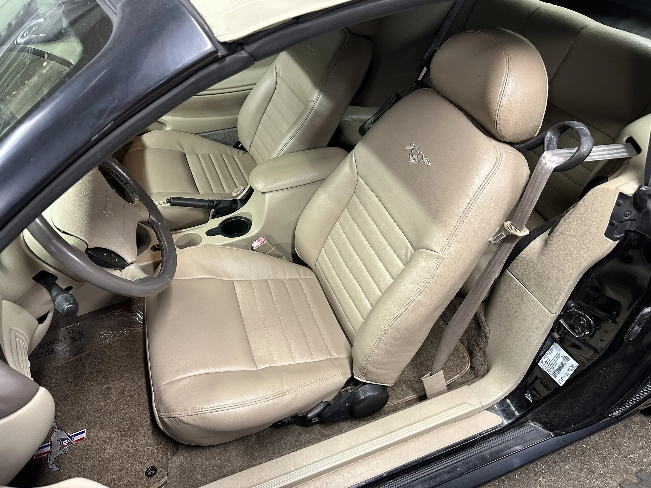

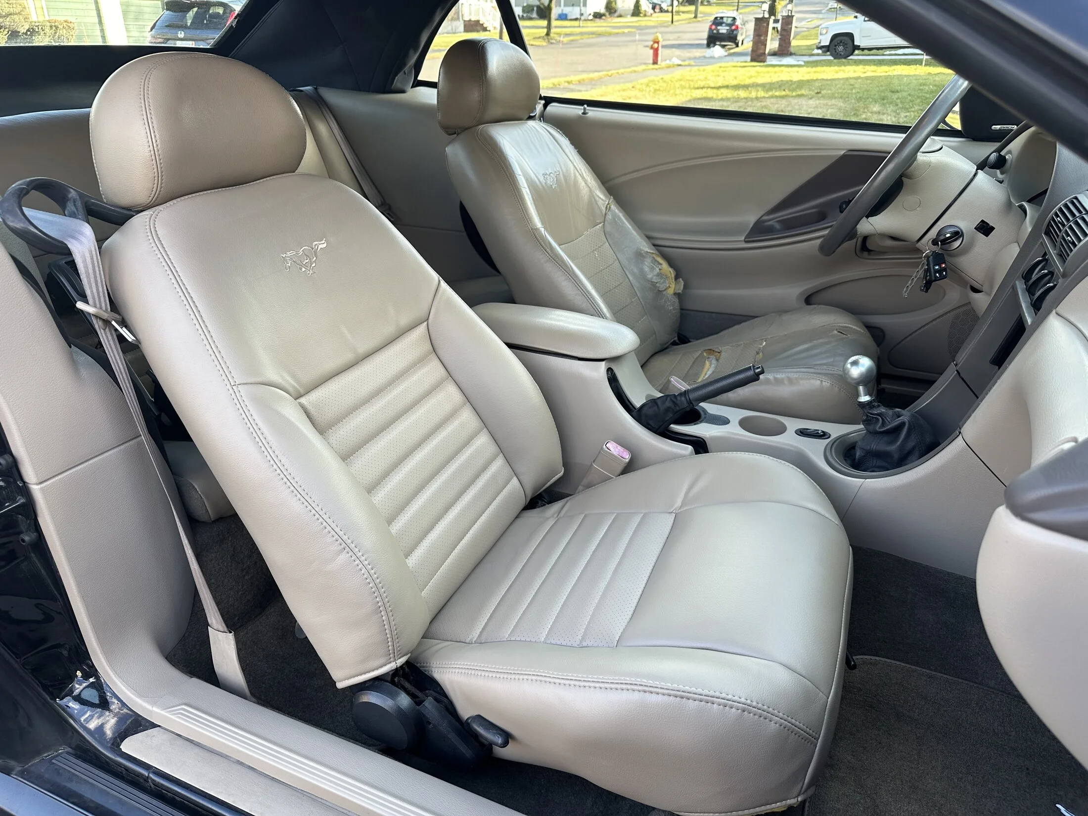

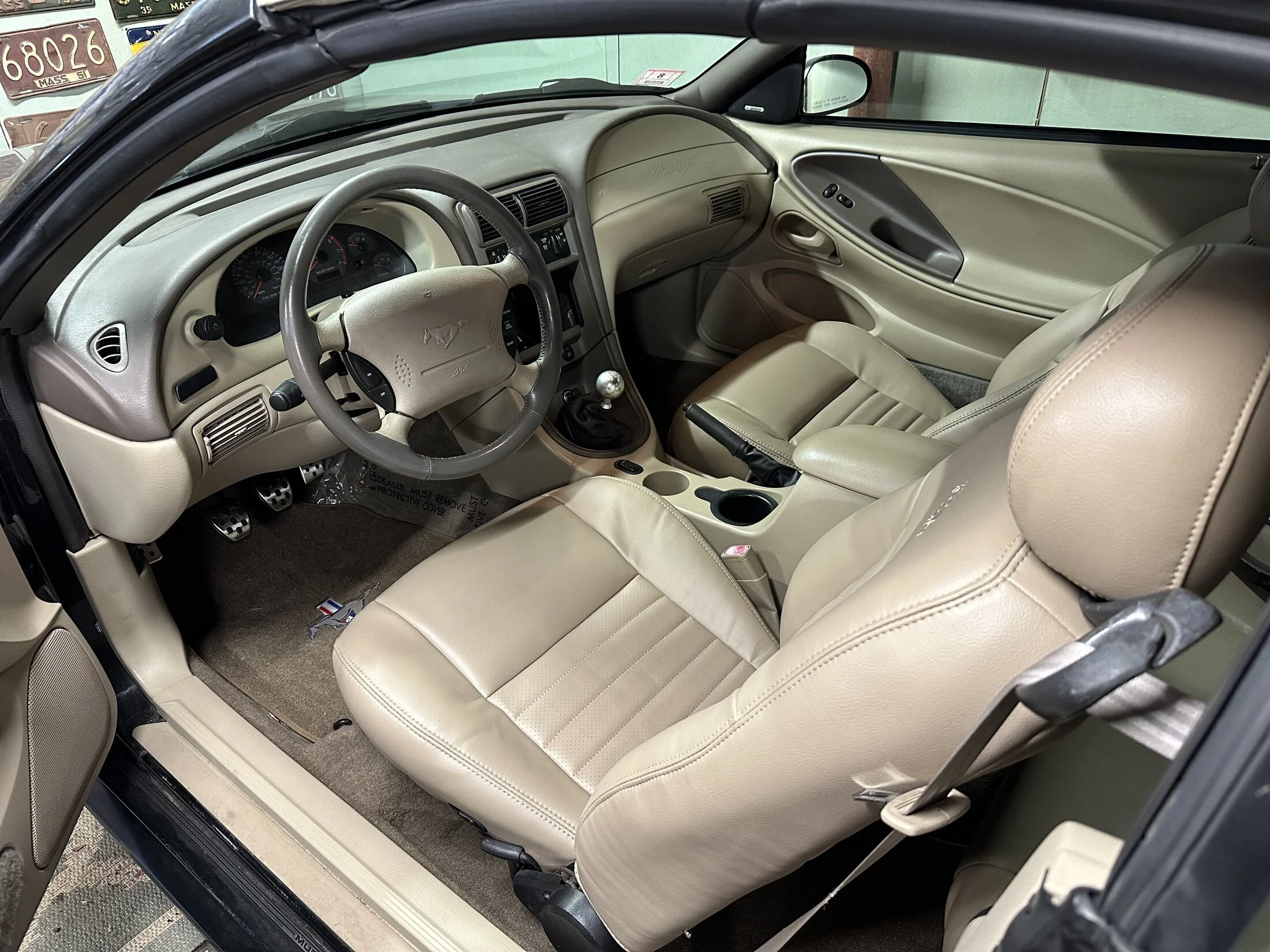

Done. Just need to install a double din radio and interior is now up to my standards. Now it looks like a 70k mile car….at least inside.
Tint for the windows is on the agenda as well.

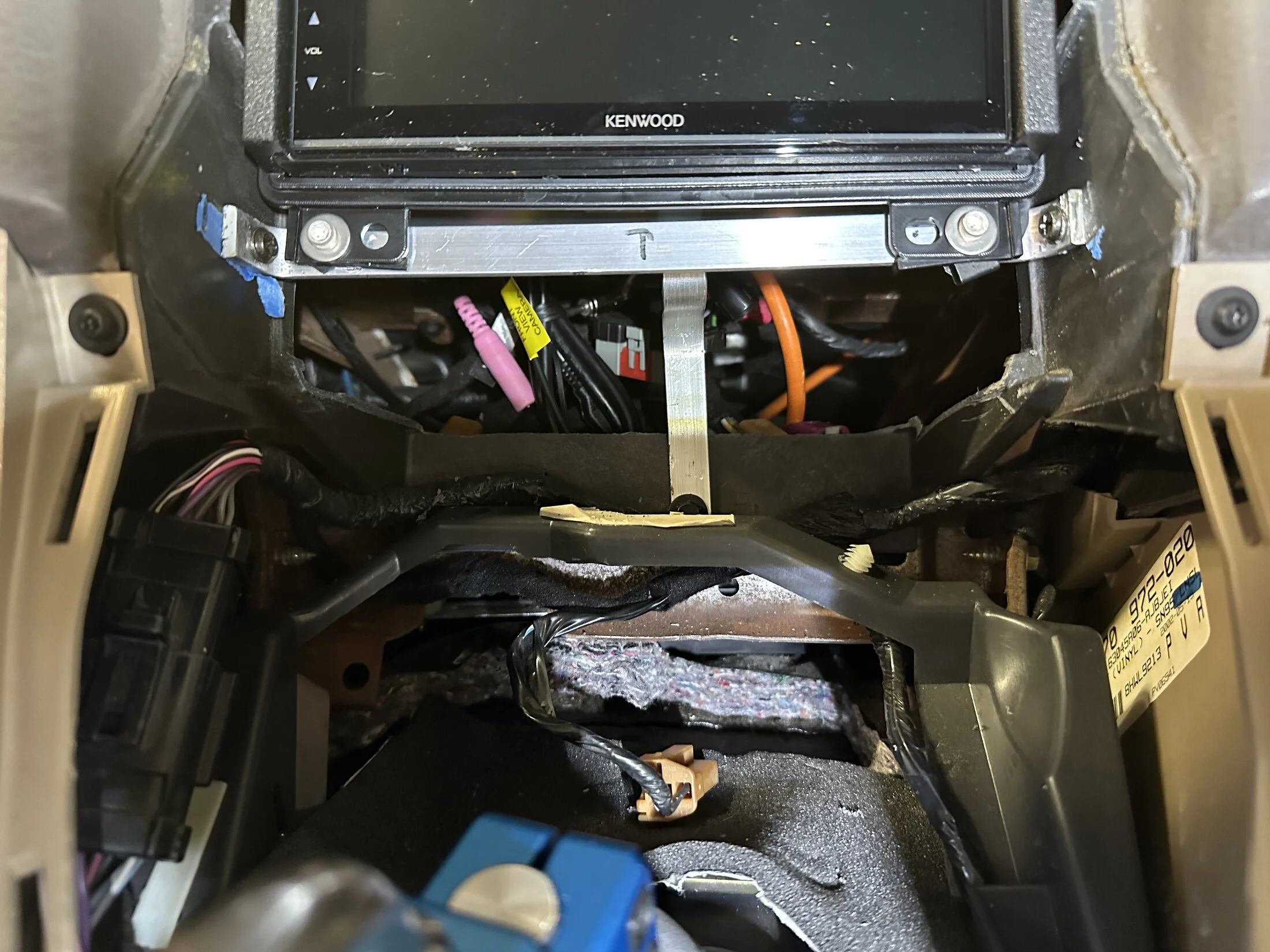

Mounted. Now to wire it in. Waiting on my backup camera to arrive on Mon
Kept it simple and just built a support bar across like the 01-04 mustangs, and a rear support brace. This radio is pretty light now that they don’t put cd players in them.
Horozontal bar has oversized holes which allows me to fine tune the adjustment of where the radio sits. Really was a "measured 10X drill once" sort of affair. Can't even explain how i mocked that up to find where to drill but somehow it worked perfectly on the first shot.
To keep the radio supported and prevent it from tilting back and forth, i made the vertical brace. It bolts to an existing bolt with a slot so I can raise/lower it as needed. The top is bent into a sort of cradle to hold the rear of the head unit. I just lift or lower it to support the radio where I need it and tighten. It's pretty darn rigid.
Now to wire it in. Need to install rear camera and mic and the GPS antenna for carplay.
