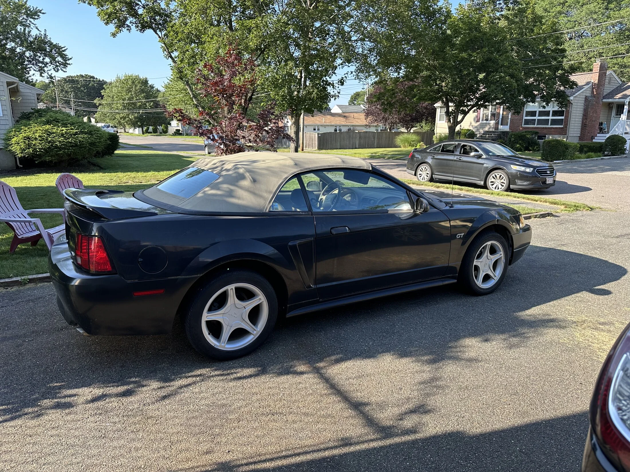

2000 GT premium vert. 68k miles. Runs and drives but has a few issues I can sort through:
-AC clutch failing and rattling hard
-brakes spongy (prob need to be bled)
- mystery current draw drains battery fast.
- needs tires. Front drivers is bald on outside while others are ok. Might need to check for play on that tie rod.

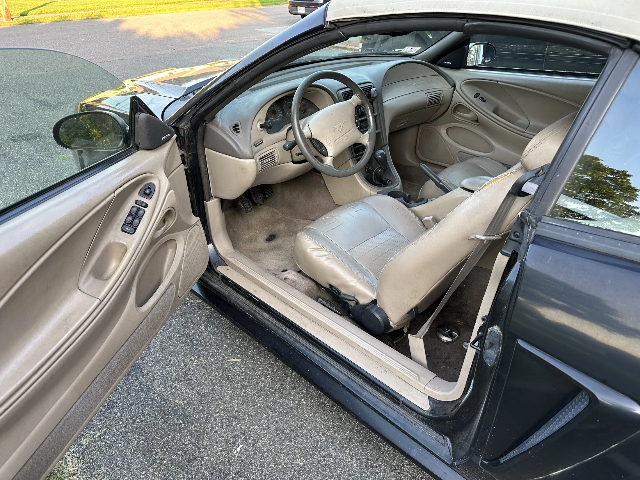

Other than that, needs a good buff and interior cleaning. It’s sat for 9 months and is dirty. Seats are ripped and a few misc weatherstrip broken. All minor stuff.

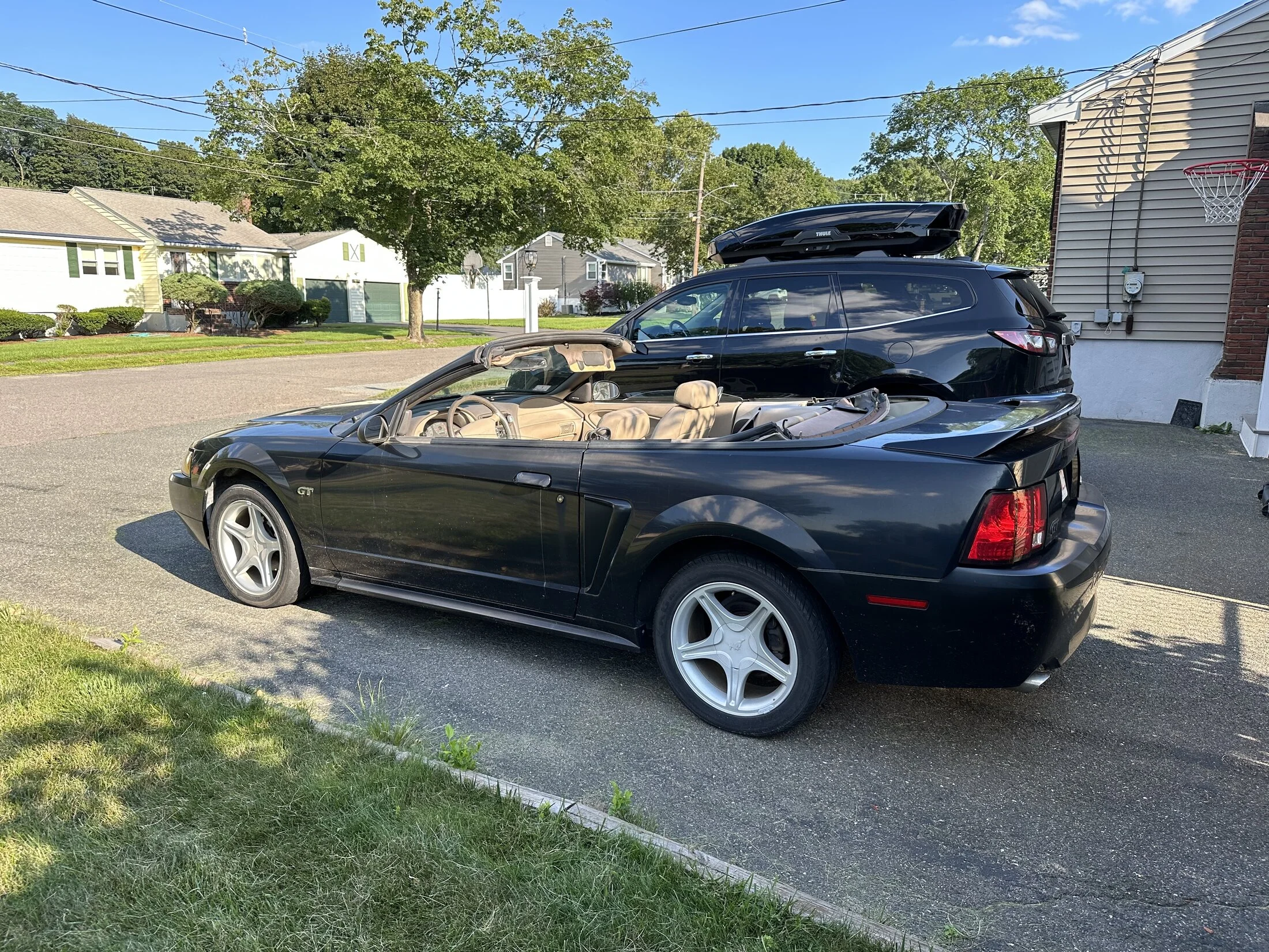

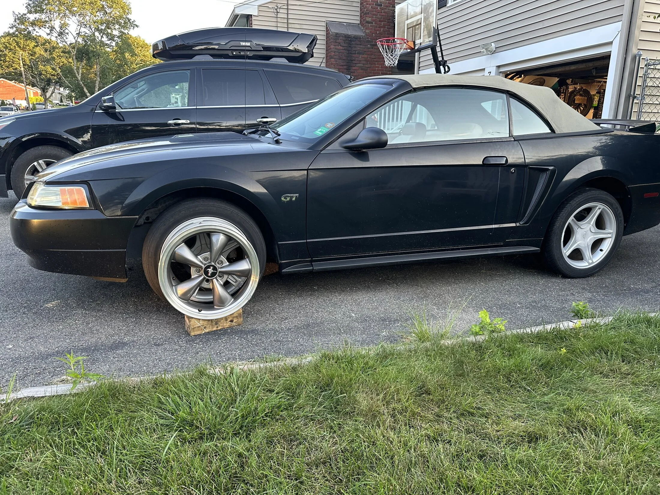

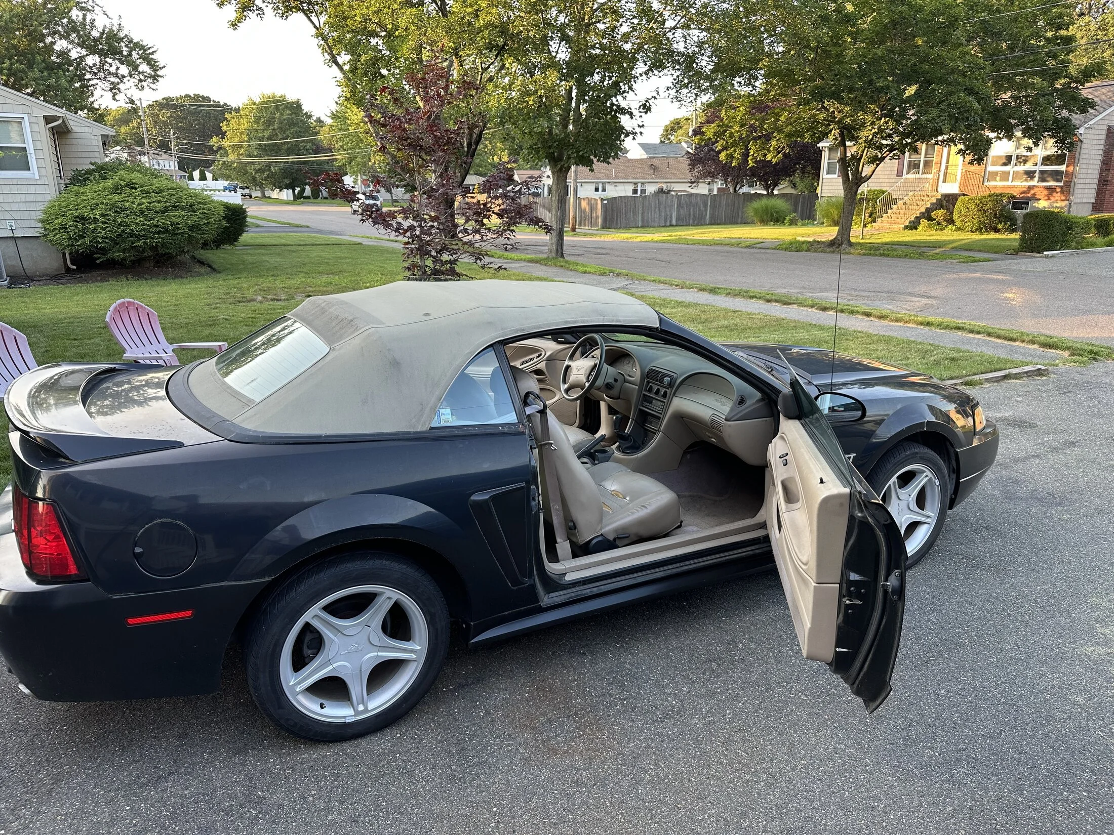

Anyway, here’s the car

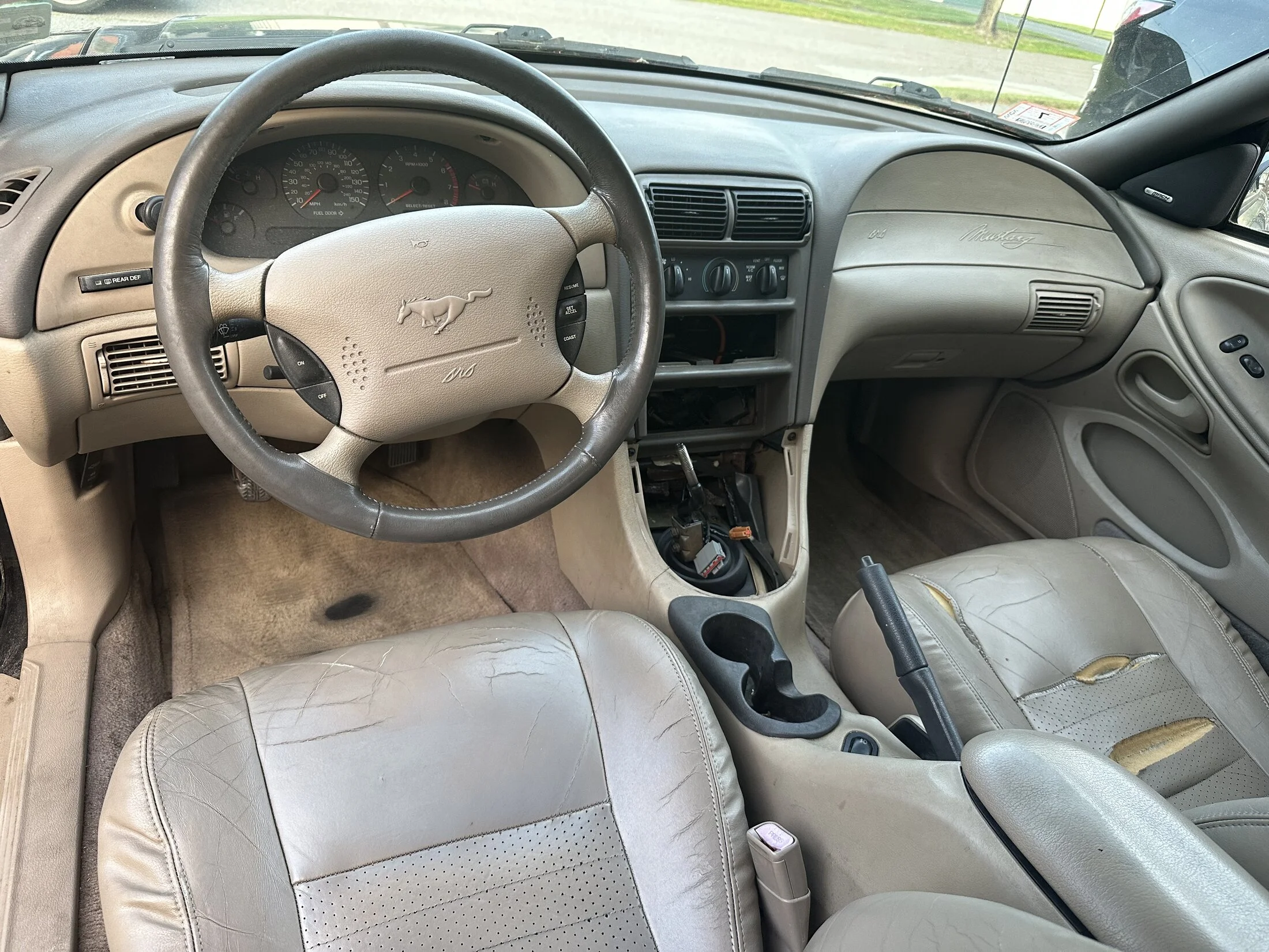

More pics. Haven’t touched a thing yet. Just assessing.
Here's my list of mechanical/electrical issues so far:
A/C clutch (bushings gone in this one)
A/C recharge (need to see if it works after clutch change. There is some refrigerant but i haven't checked pressure yet)
Something drains the battery (needs to be jumped each time)

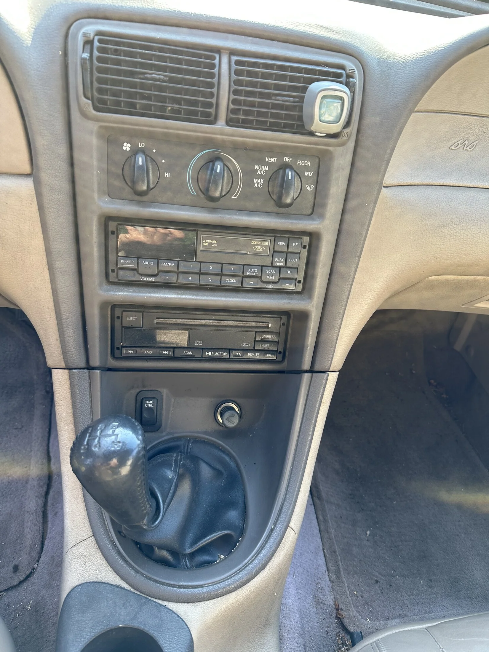

Mach 460 won't turn on
needs tires (going to put a set on my bullitt wheels)
Possibly an issue with the ABS/TC. The ABS amd TC light are off, but when i hit the TC button it doesn't illuminate the light on the cluster. It's possible the bulbs are burned out? Since i have to jump start the car for now, It's a PITA to check the warning lights and such. I'll try later. There may be no issue here either.

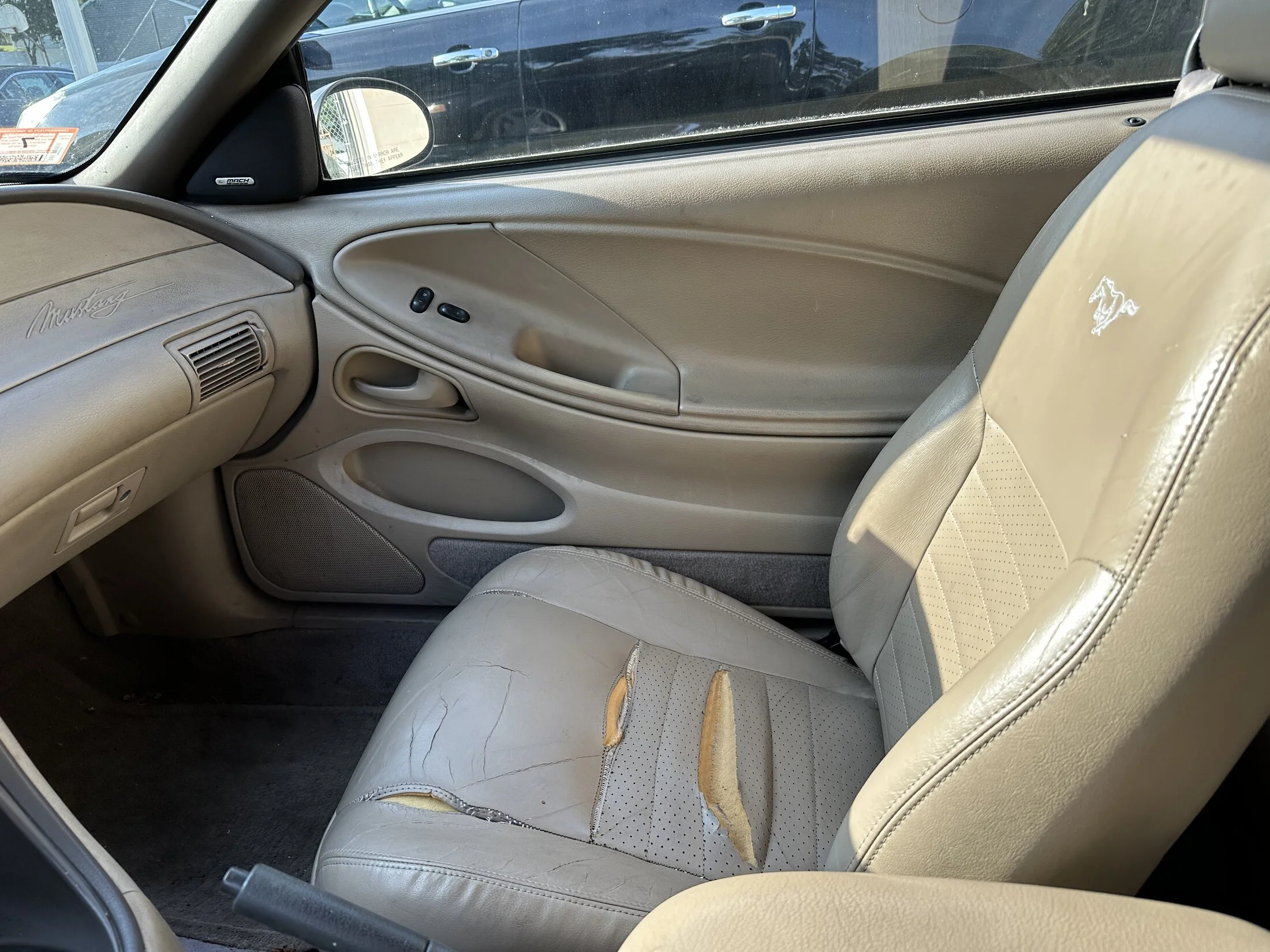

Front seats are torn
drivers seat track is messed up (i have a spare in my parts pile)

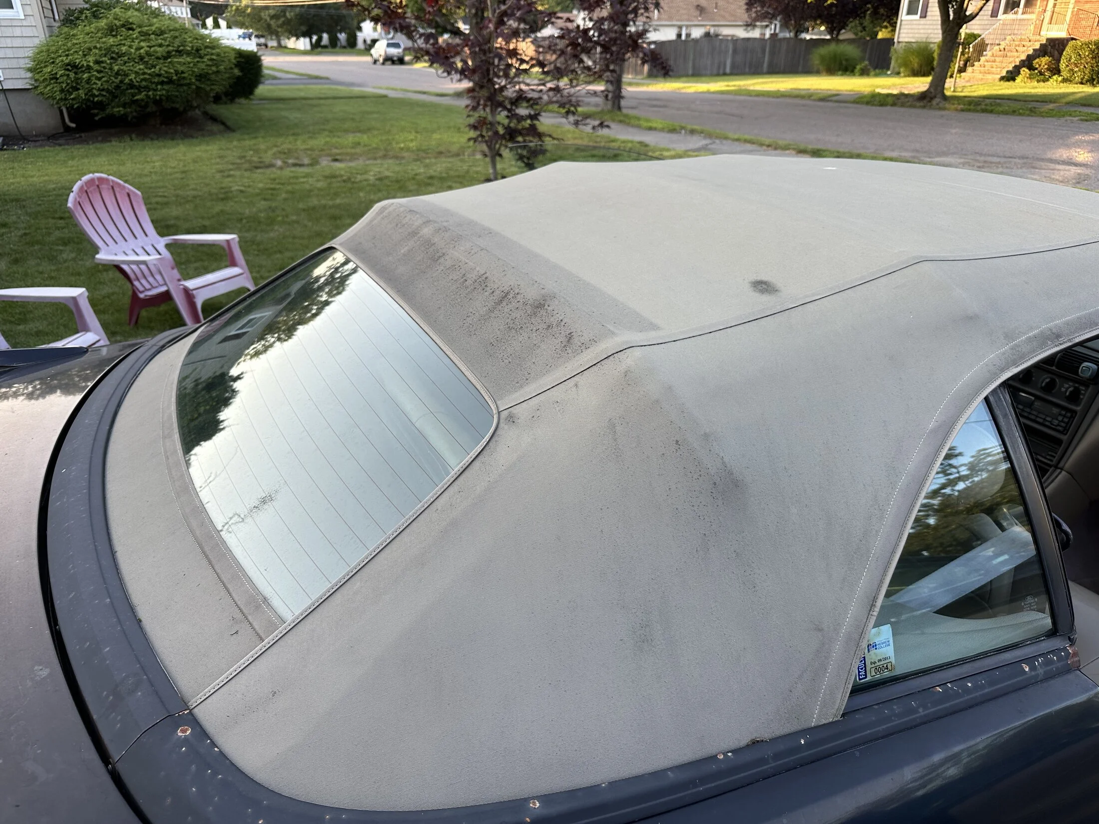

I might tint the windows to help with the sun beating up the interior. I also might ditch the tan top. I can live with tan interior, but not a fan of the tan top.

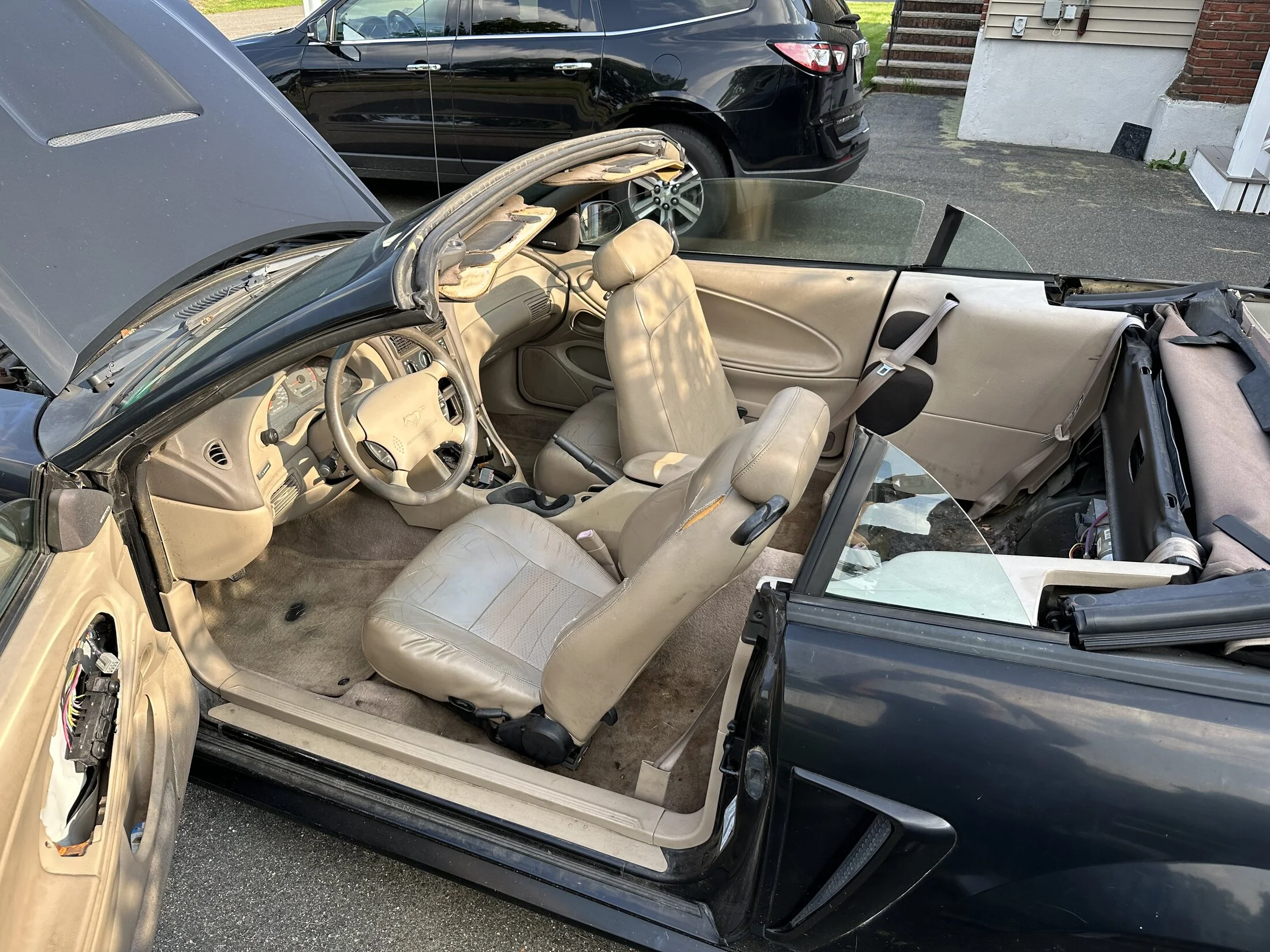

Did some quick vacuum and started pulling interior parts out to clean up.
Picked up the loose dirt.

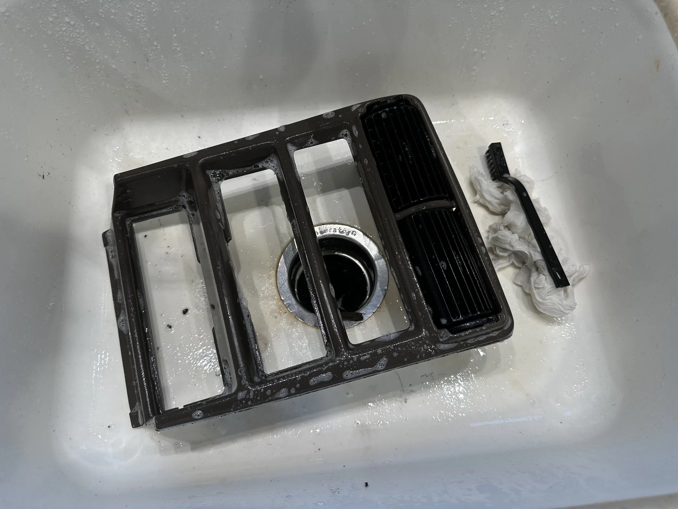

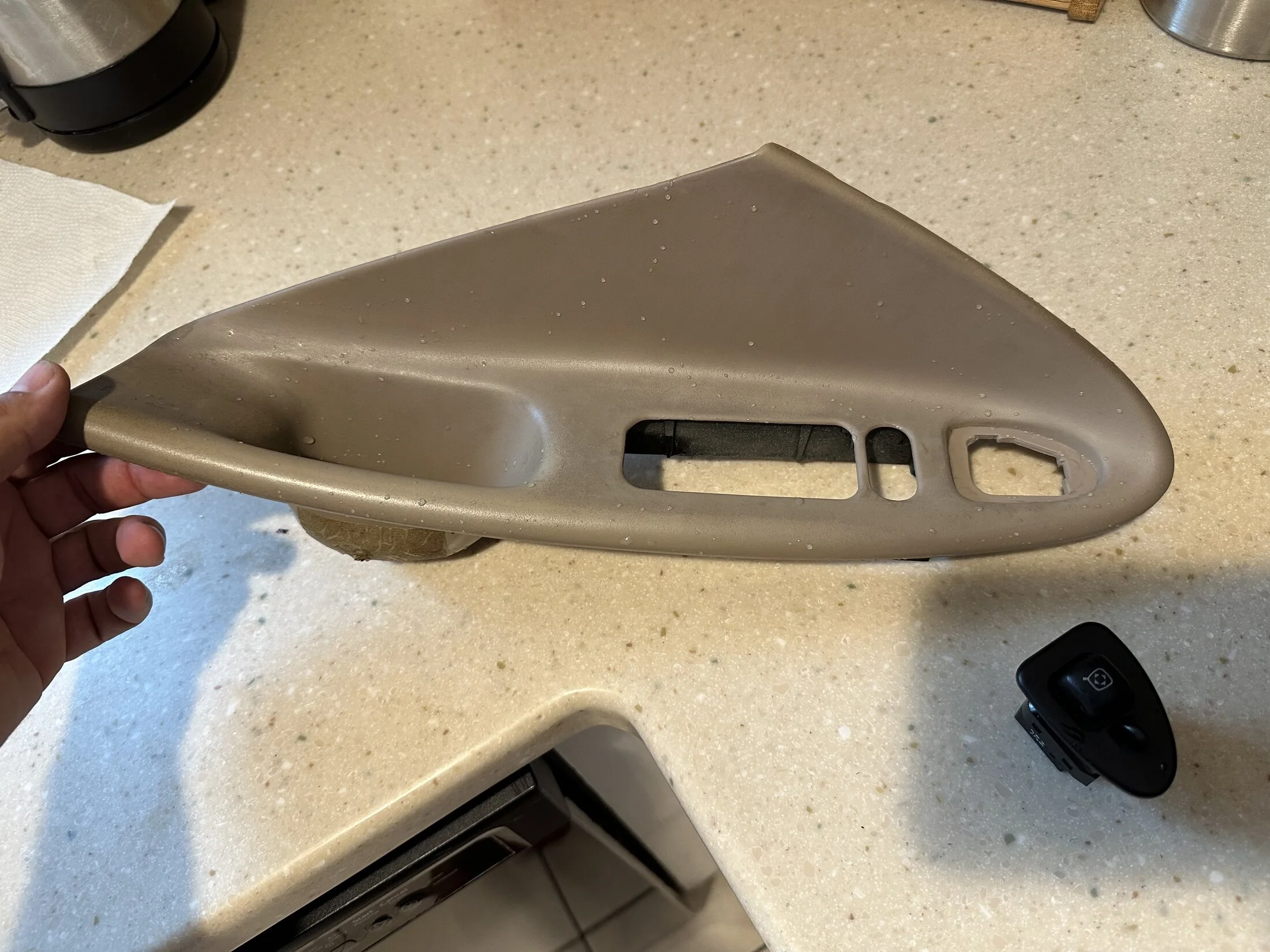

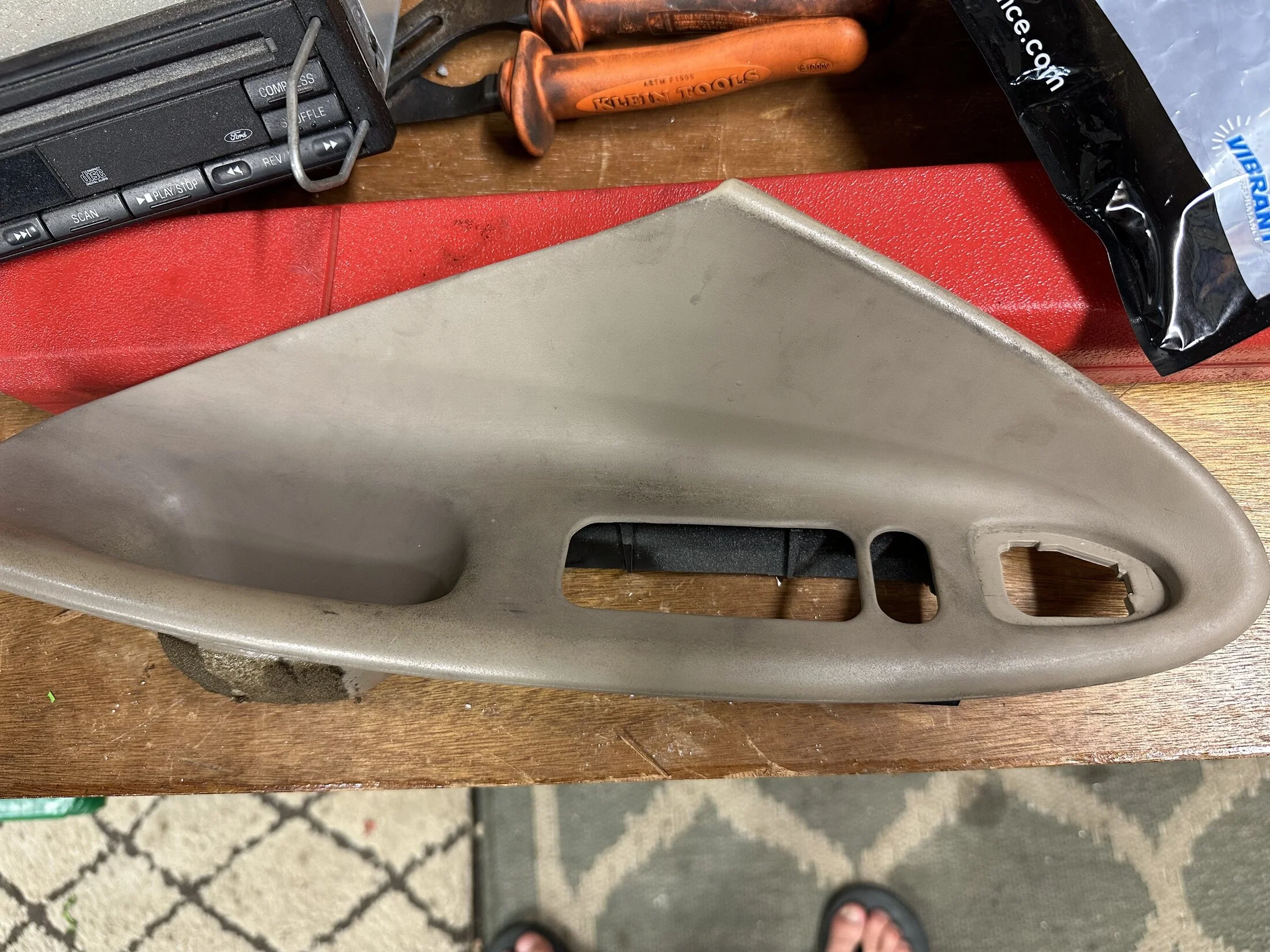

Test cleaning a door cup.
Before
After a few mins. I’ll give it some more elbow grease. But I’m thinking I might want to pull some of this interior out and really dig at it with nylon brushes and soap/water. It’s nasty grime.
I'm not going to show every step of the cleaning process, but just wanted to show what i'm up against. It looks like every panel will need scrubbing with soap/water and a very deep cleaning.
I may actually strip everything but the dash and powerwash it. Just a lot of dirt/grime on every panel.

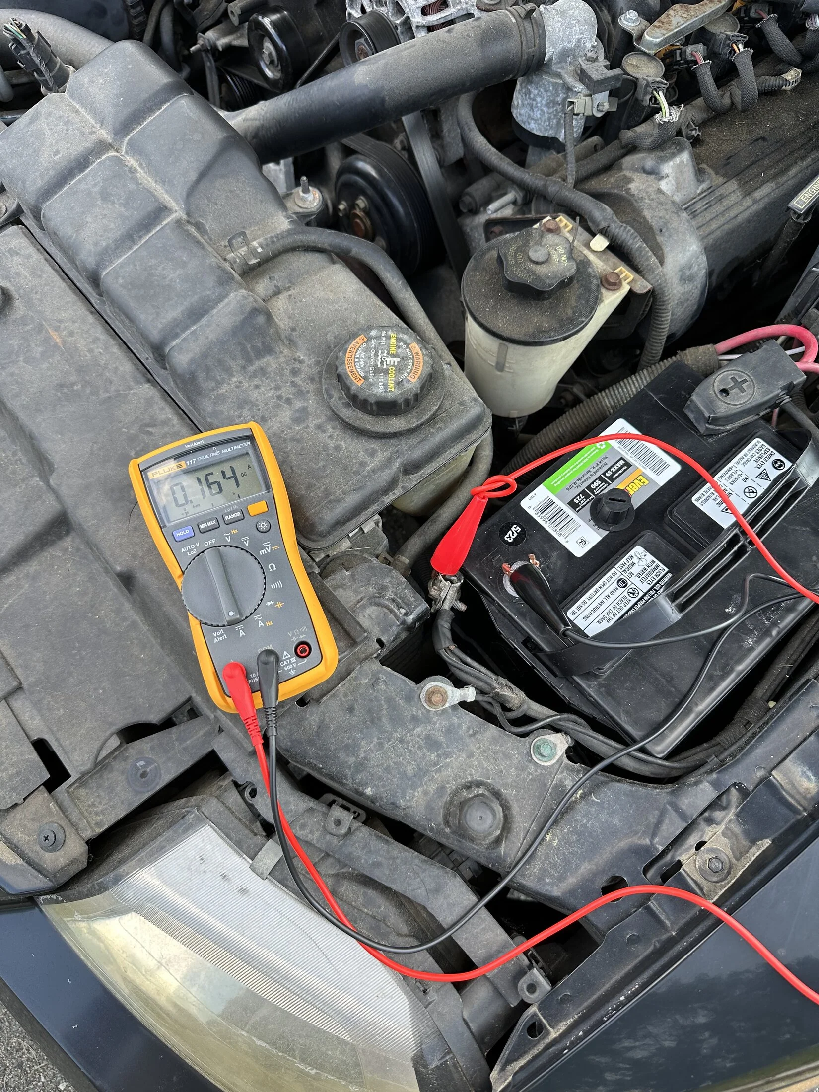

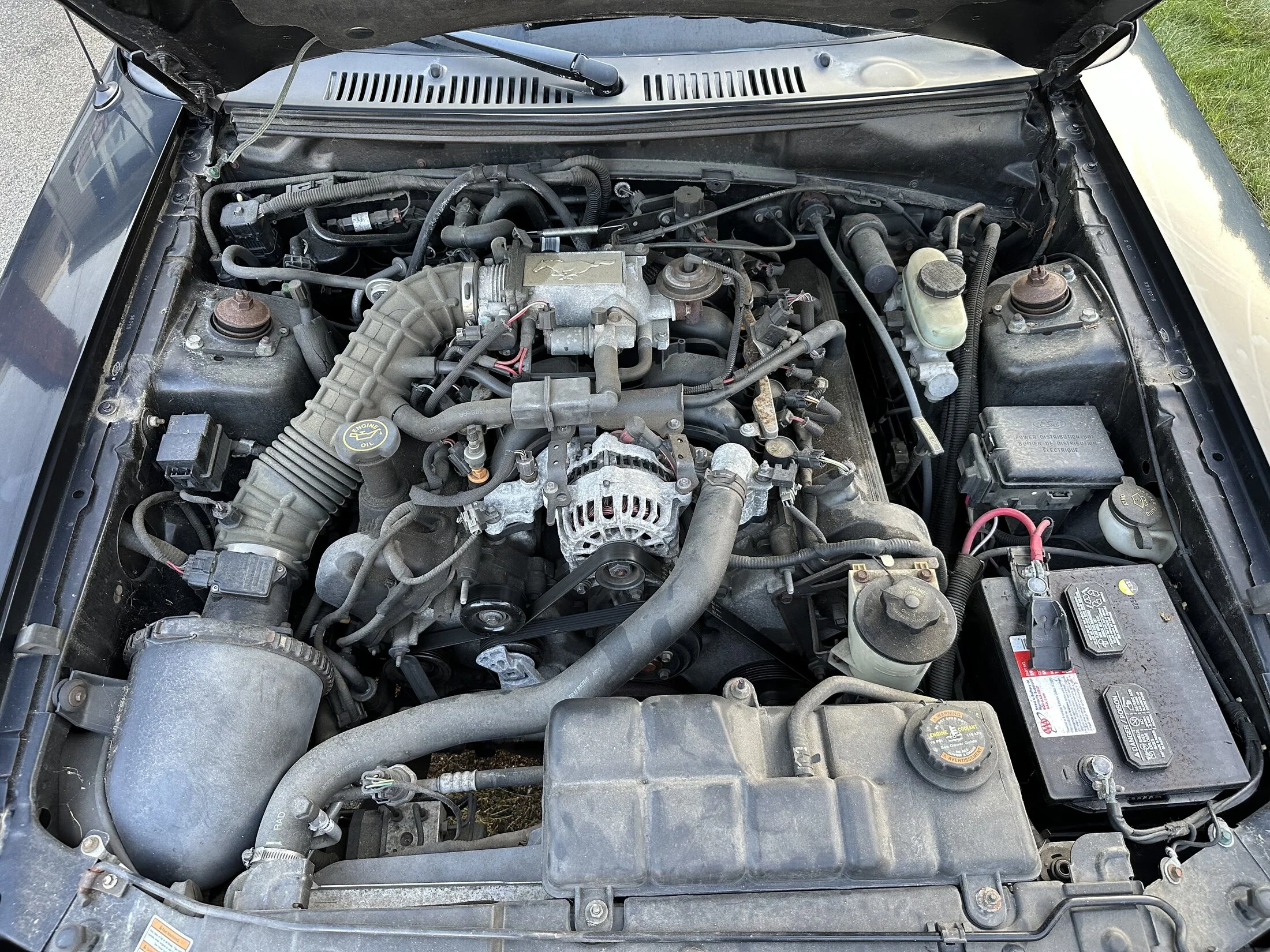

Bought a new battery. Hooked it up and measured a 0.35amp draw on it.
Traced it to fuse #6 which apparently is very common. Haven’t dug into it much more yet. Gonna do some reading.

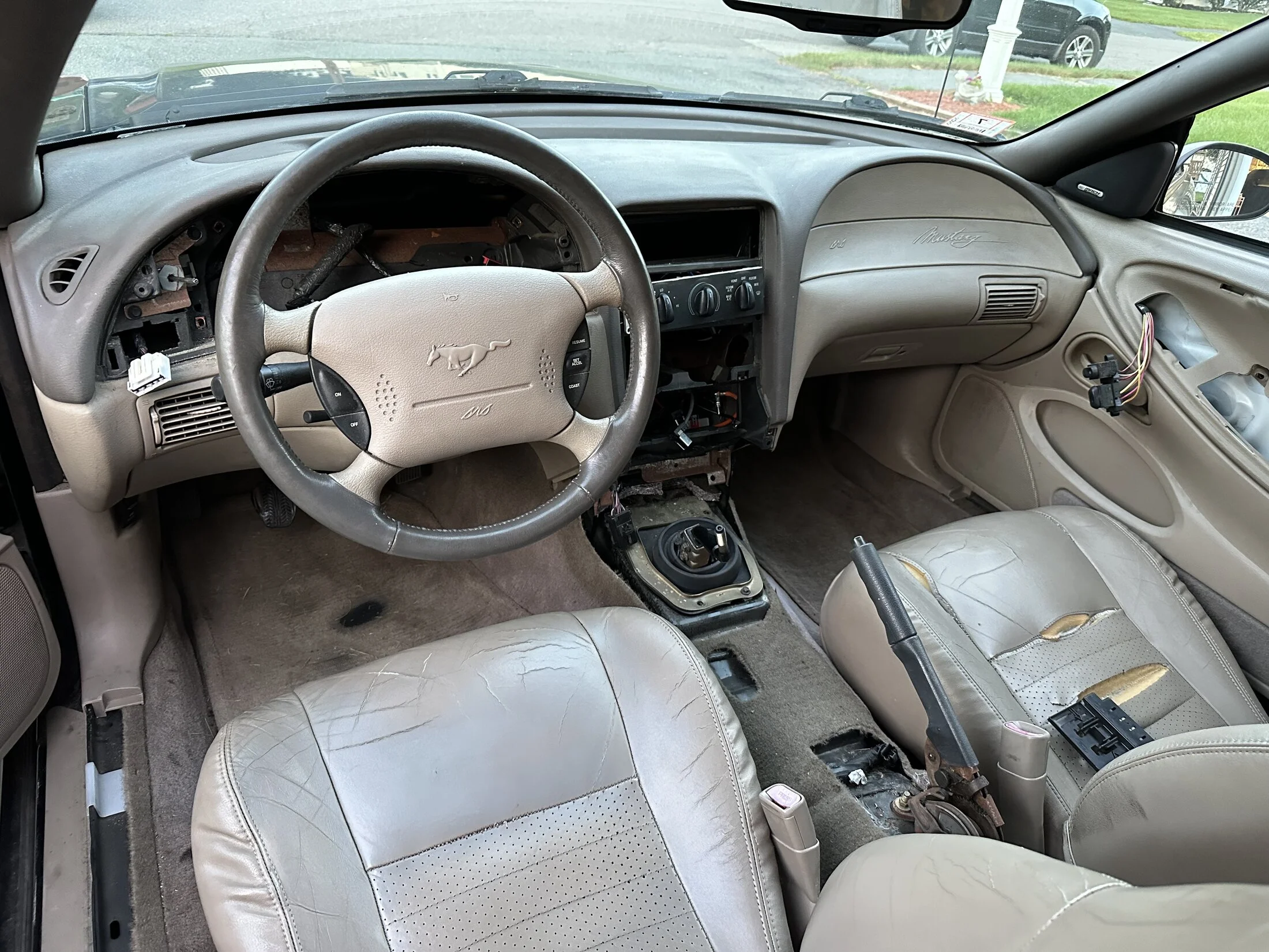

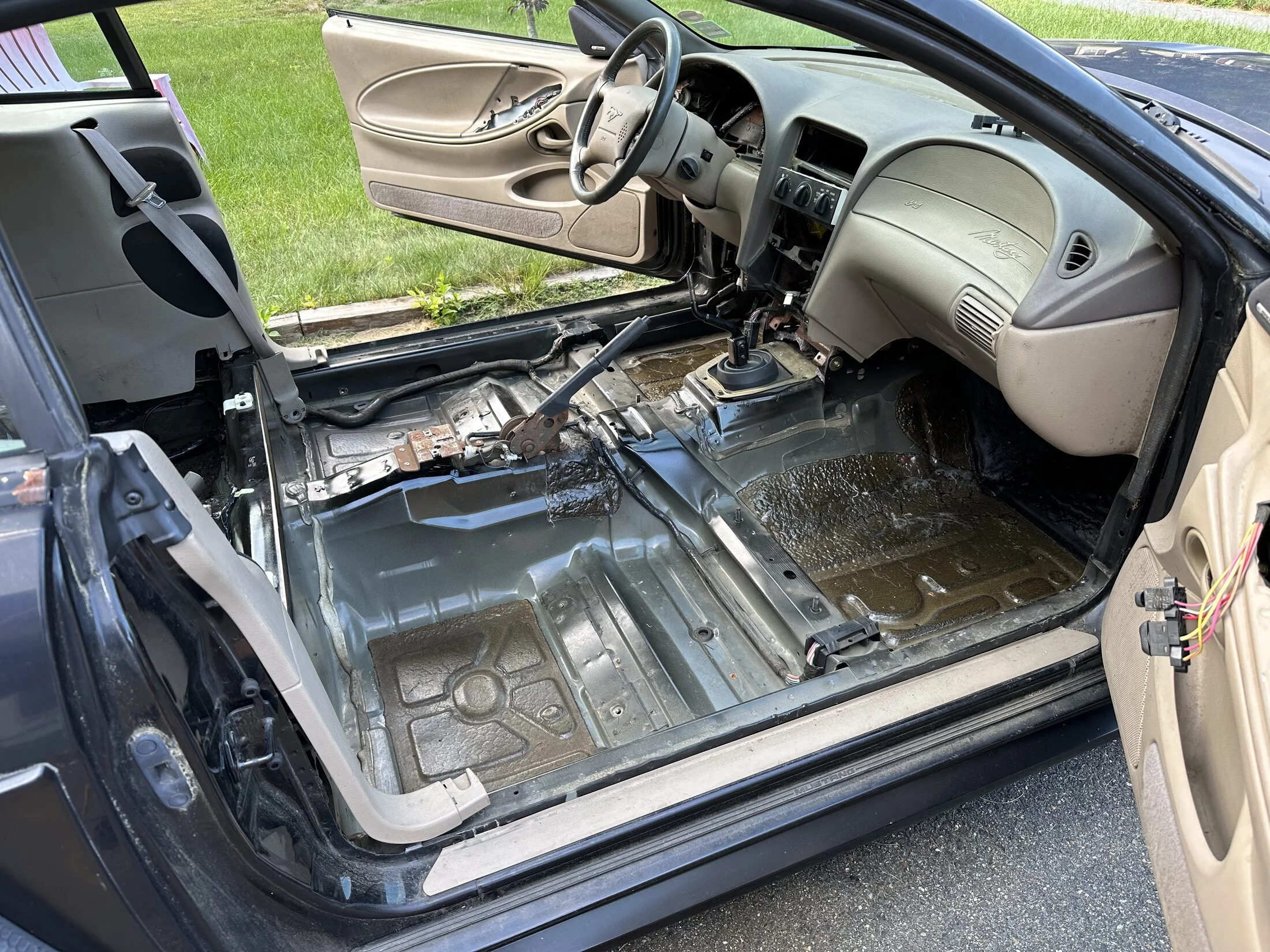

Started pulling interior out.
Reactions: General karthief

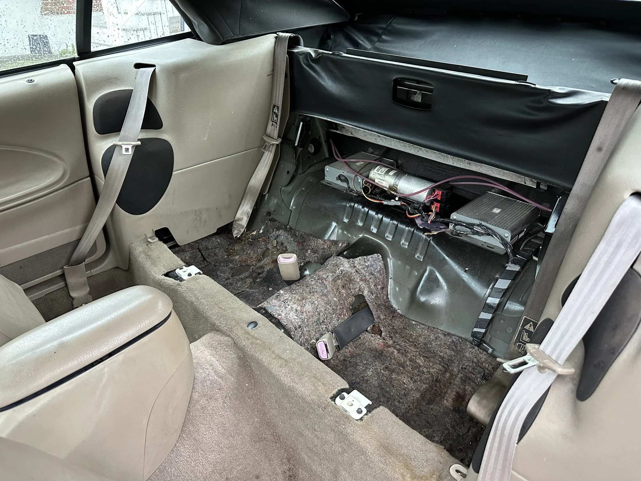

unplugged drivers side mach amp. Current draw went from .35a to .16a.
No change if I unplug the other side. So add an amp to the list of parts to track down on eBay.

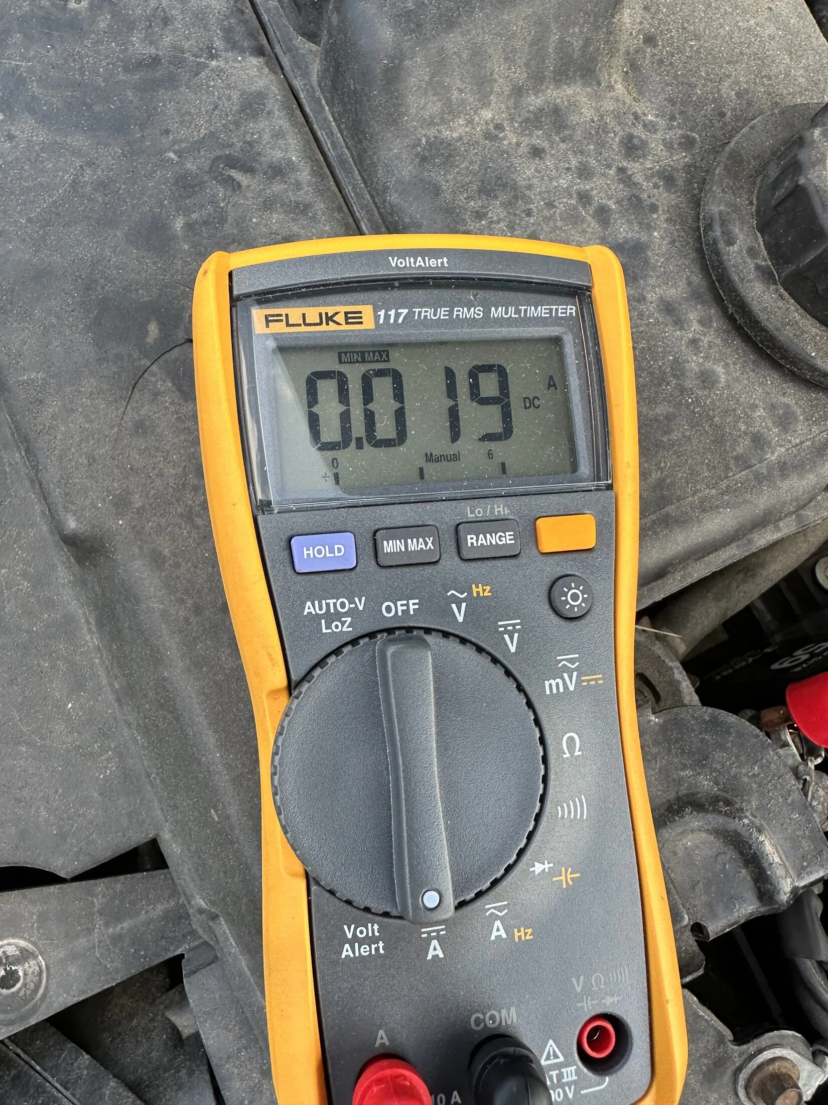

figured out the draw issue.
0.35amp draw when sitting. I went right to common source and pulled the Mach 460 amps and one dropped the current to 0.16 amps.
Also found the head unit had issues. I tested out of car and it would turn on for 5 seconds and then cut out. Also, the 10a fuse was blown.
So with the amp removed, and head unit removed, I set up my meter to see current at rest.
160 milliamps, which is about what the GeM pulls at rest.
Set a timer for 40 min and walked away. When I came back I was glad to see the GeM in standby.
19 milliamps, without a radio. That should go up a tad when I put a good radio back in.

Pulled some more out. Need to stop here

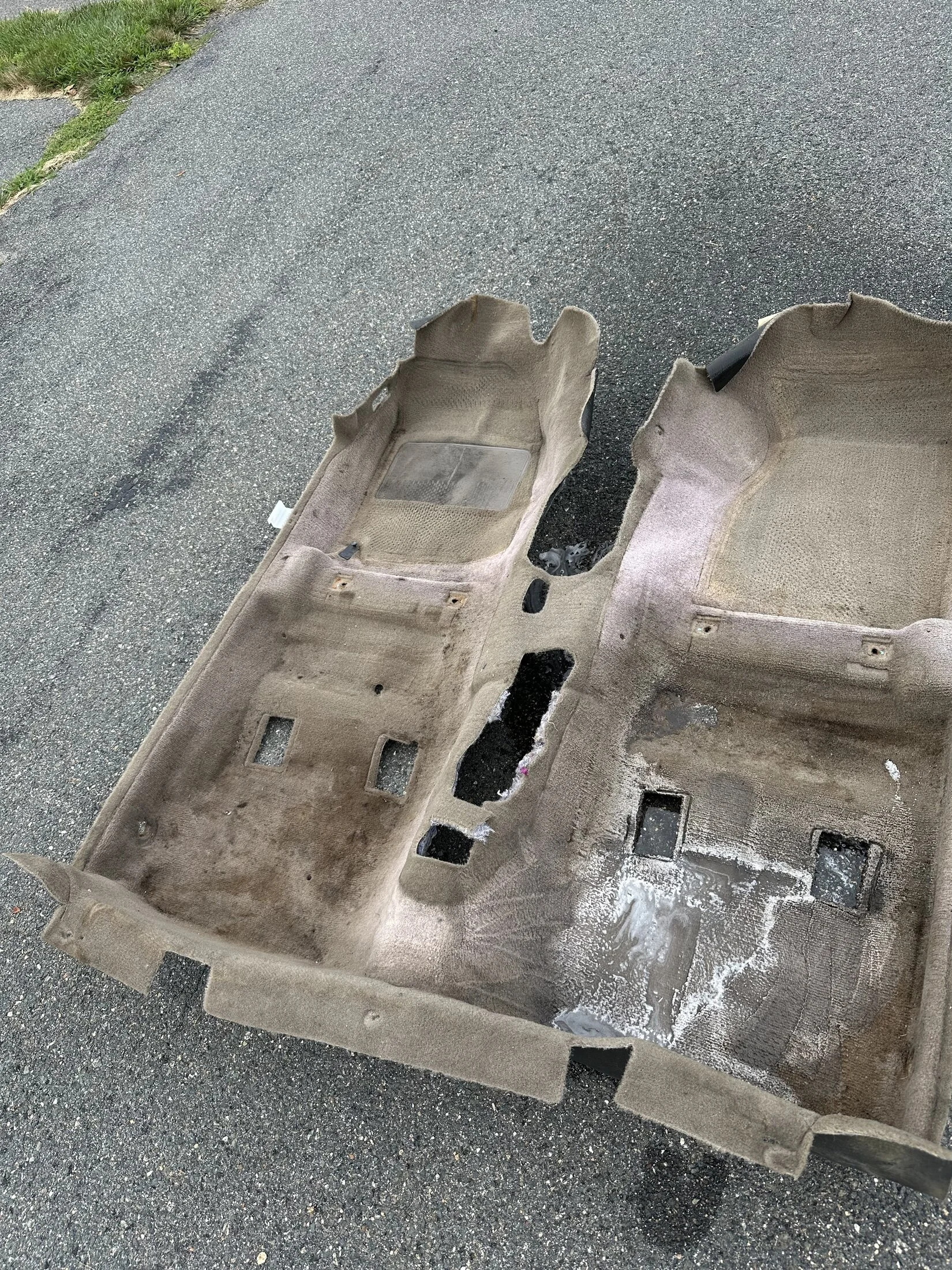

Cleaning what I can off the car. I intend to pull the carpet out.

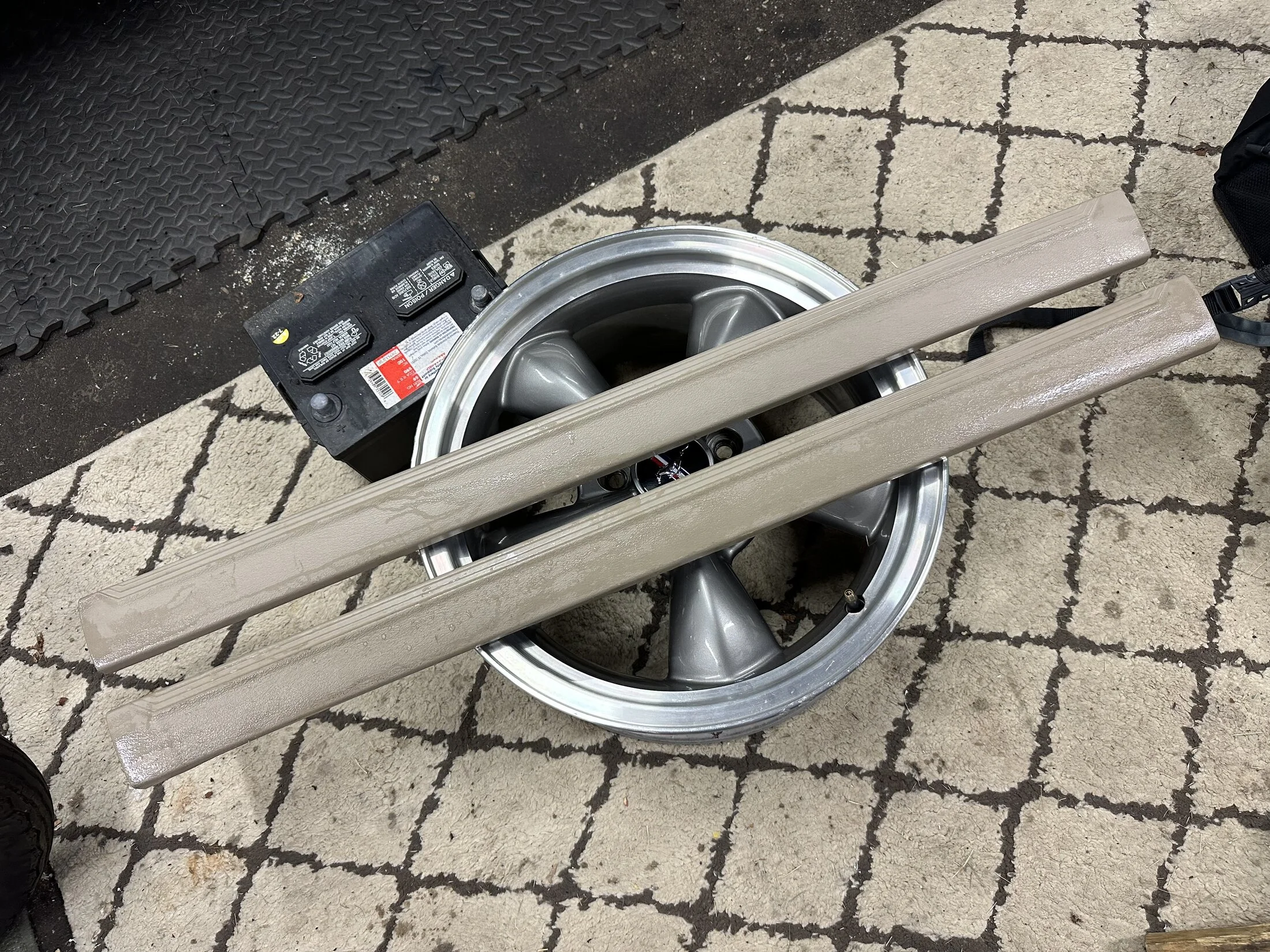

But these sill plates cleaned up nicely.

Door panels and center console will come out shortly as well.

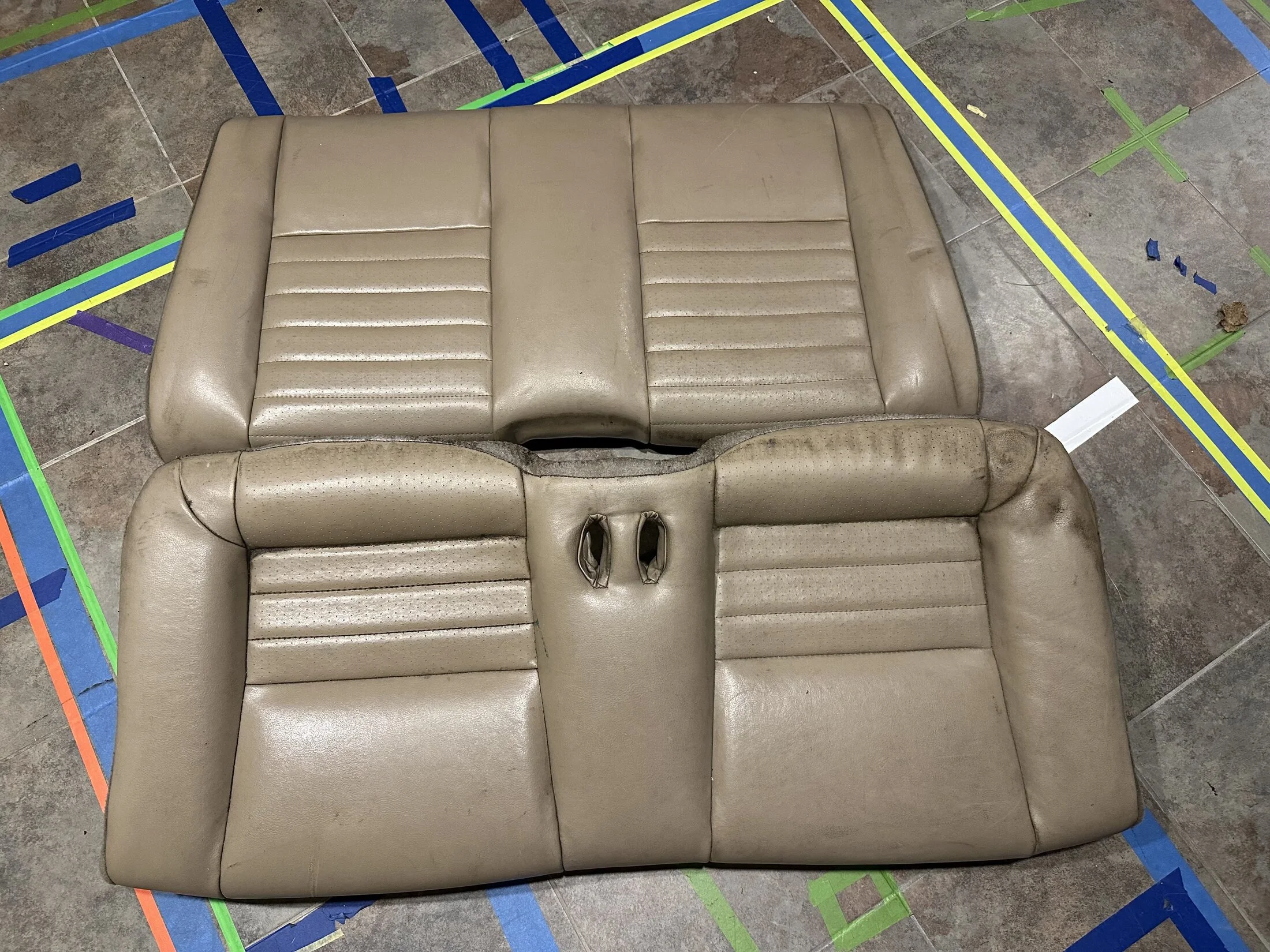

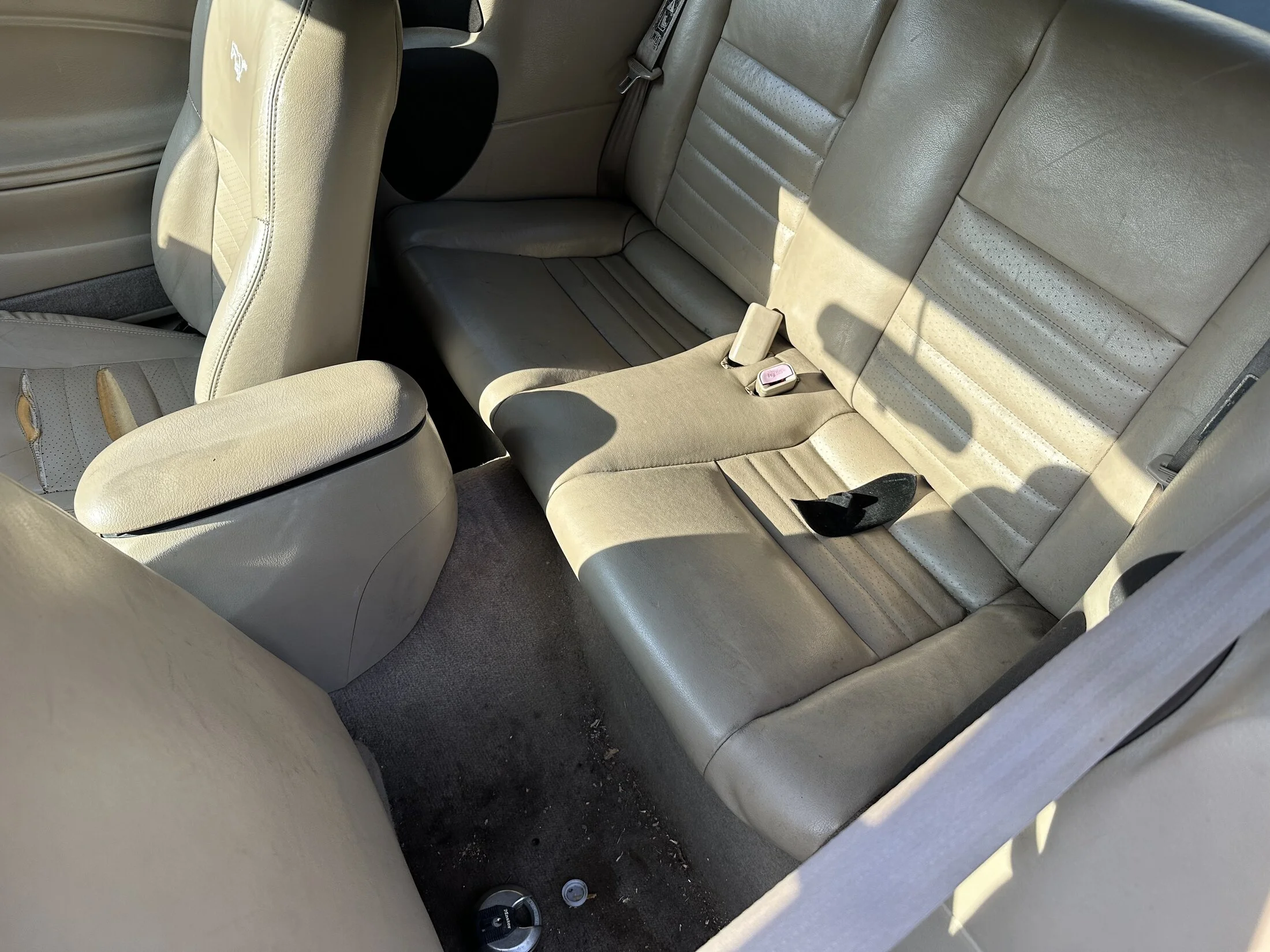

Got back from vacation, stripped a few more parts out. Seats and carpet next.

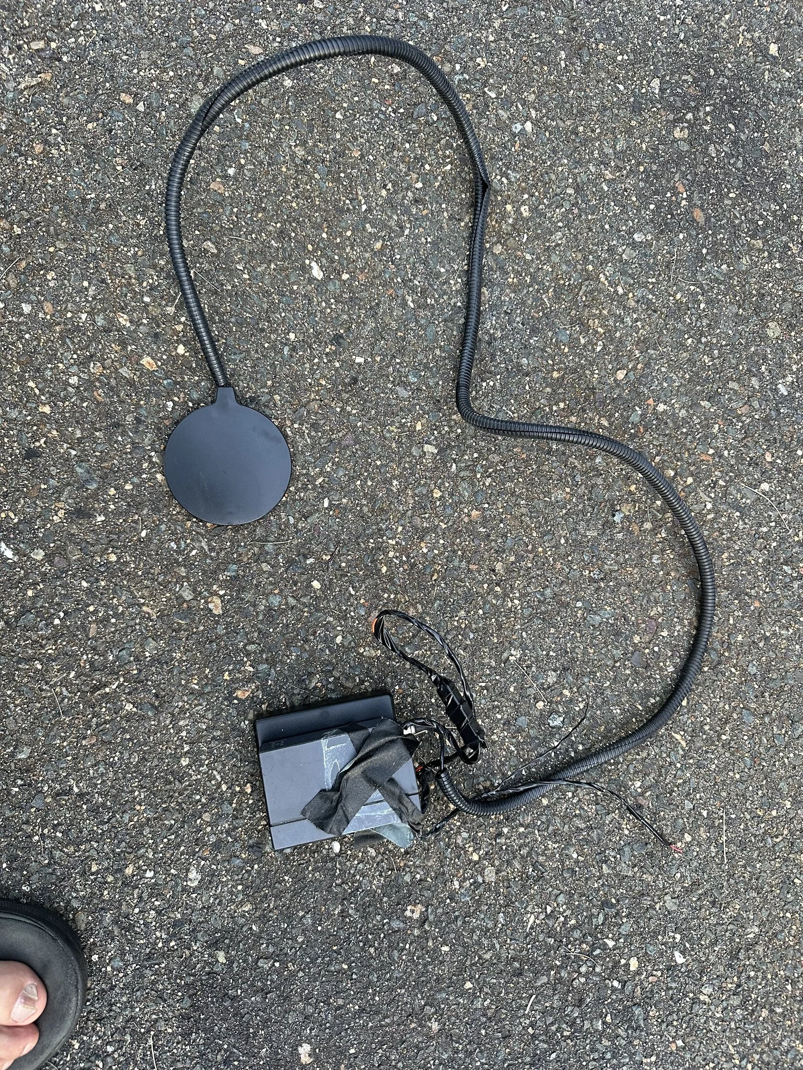

Found this behind the radio. This a buy here, pay here type of tracker? Was hooked to power and ground.

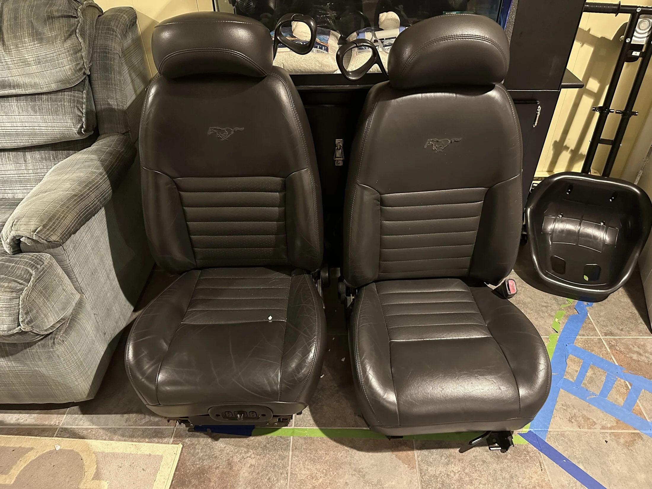

I bet those seats will be right at home. :nice:
Not sure how they will look but lets toss one in and see.
Actually. I have a junk set i can try first. First off i gotta get this carpet and front seats out as well as the door panels. Everything is getting a deep scrub to get all this grime off.
