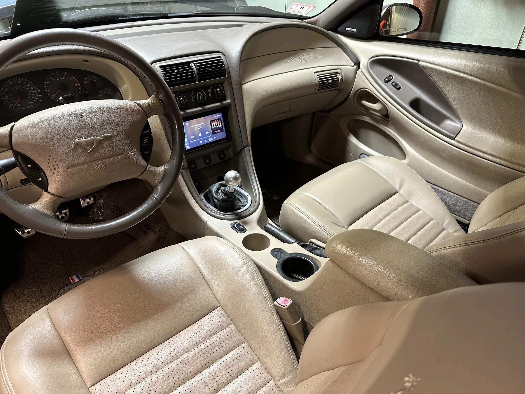

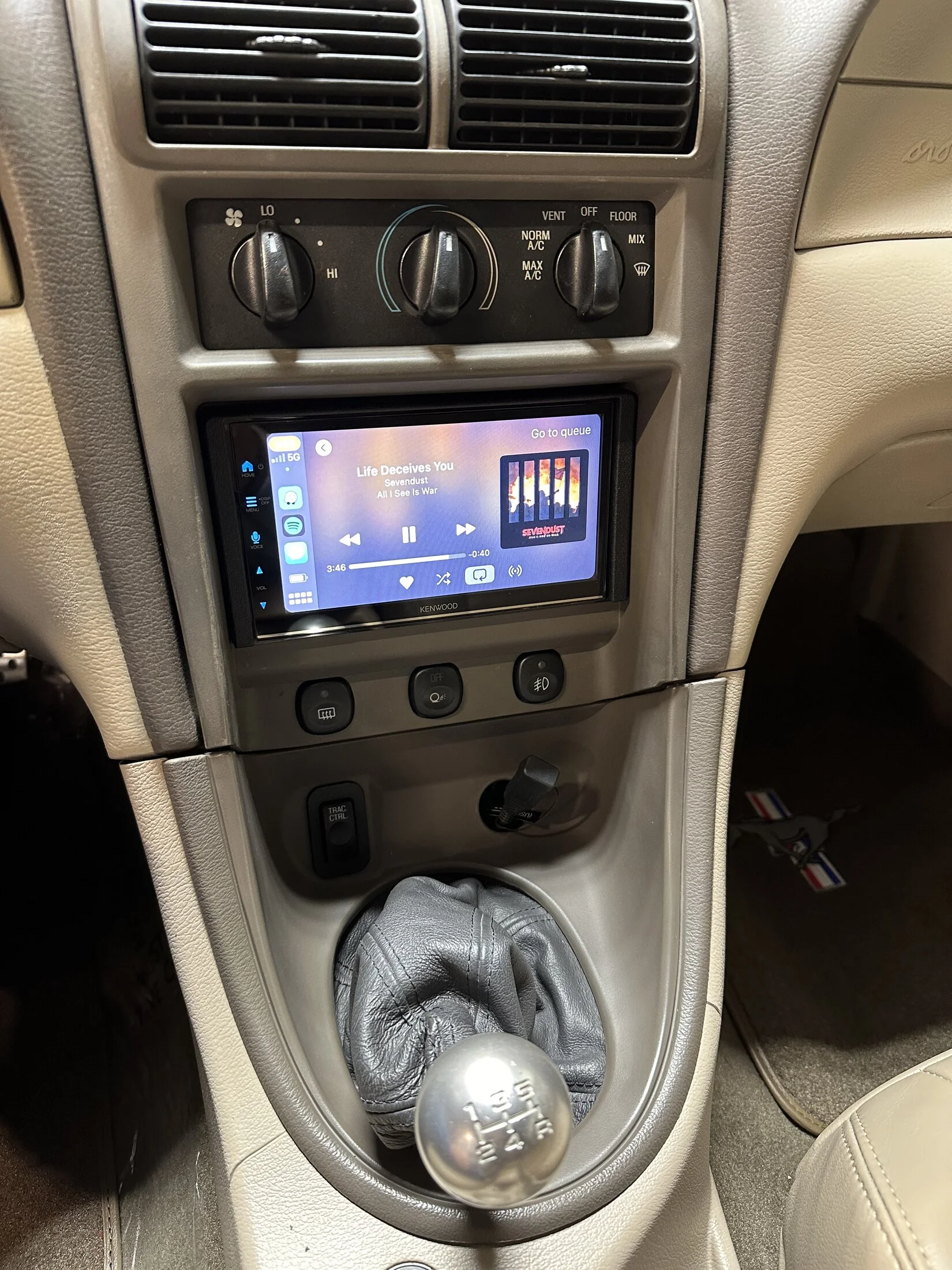

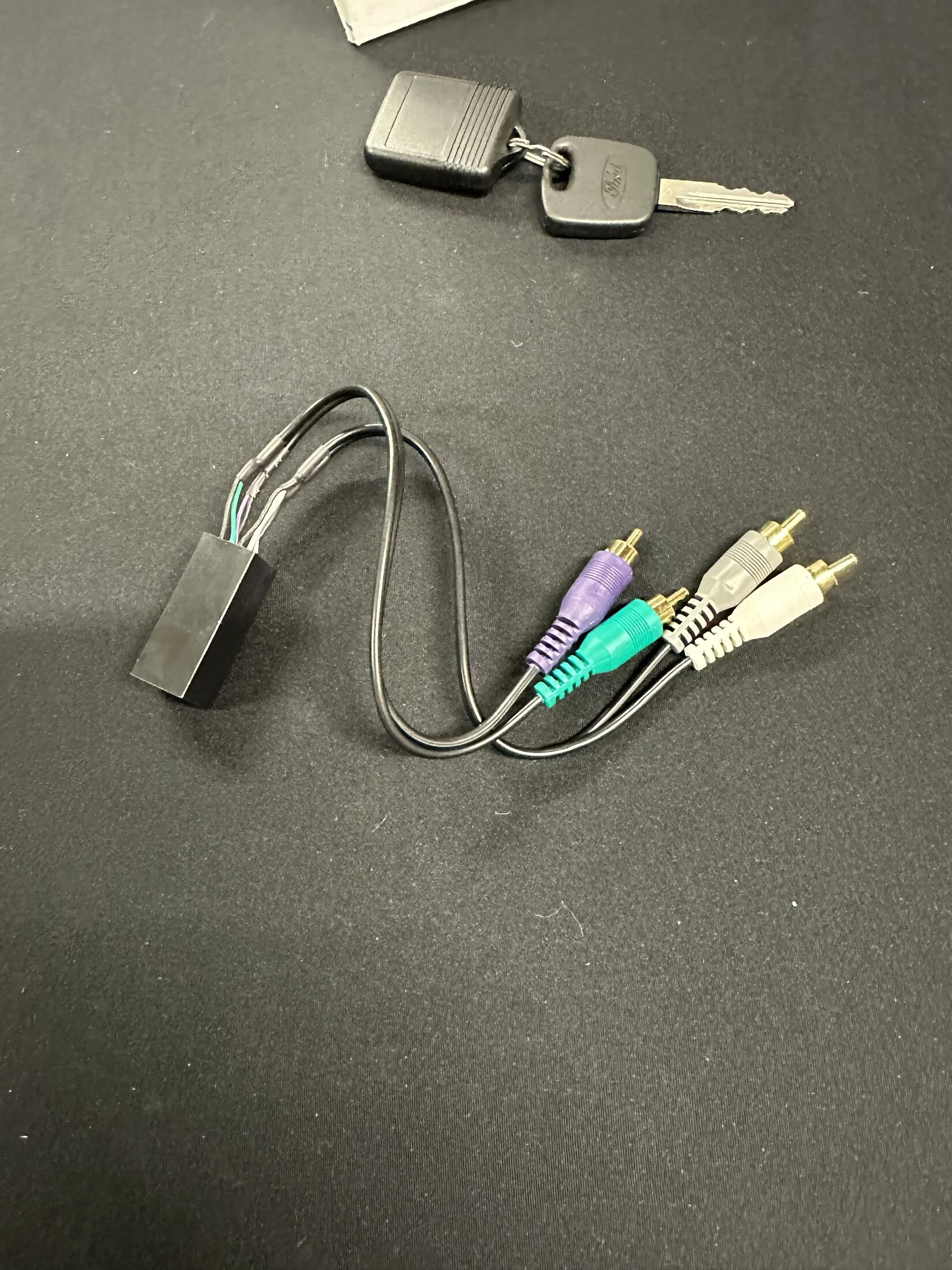

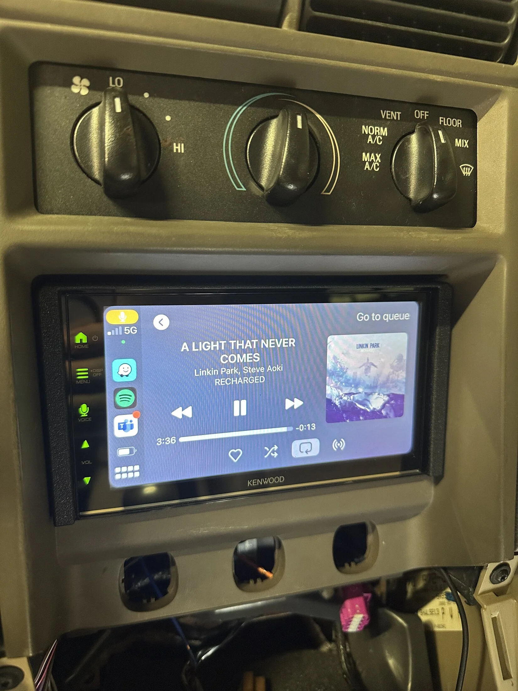

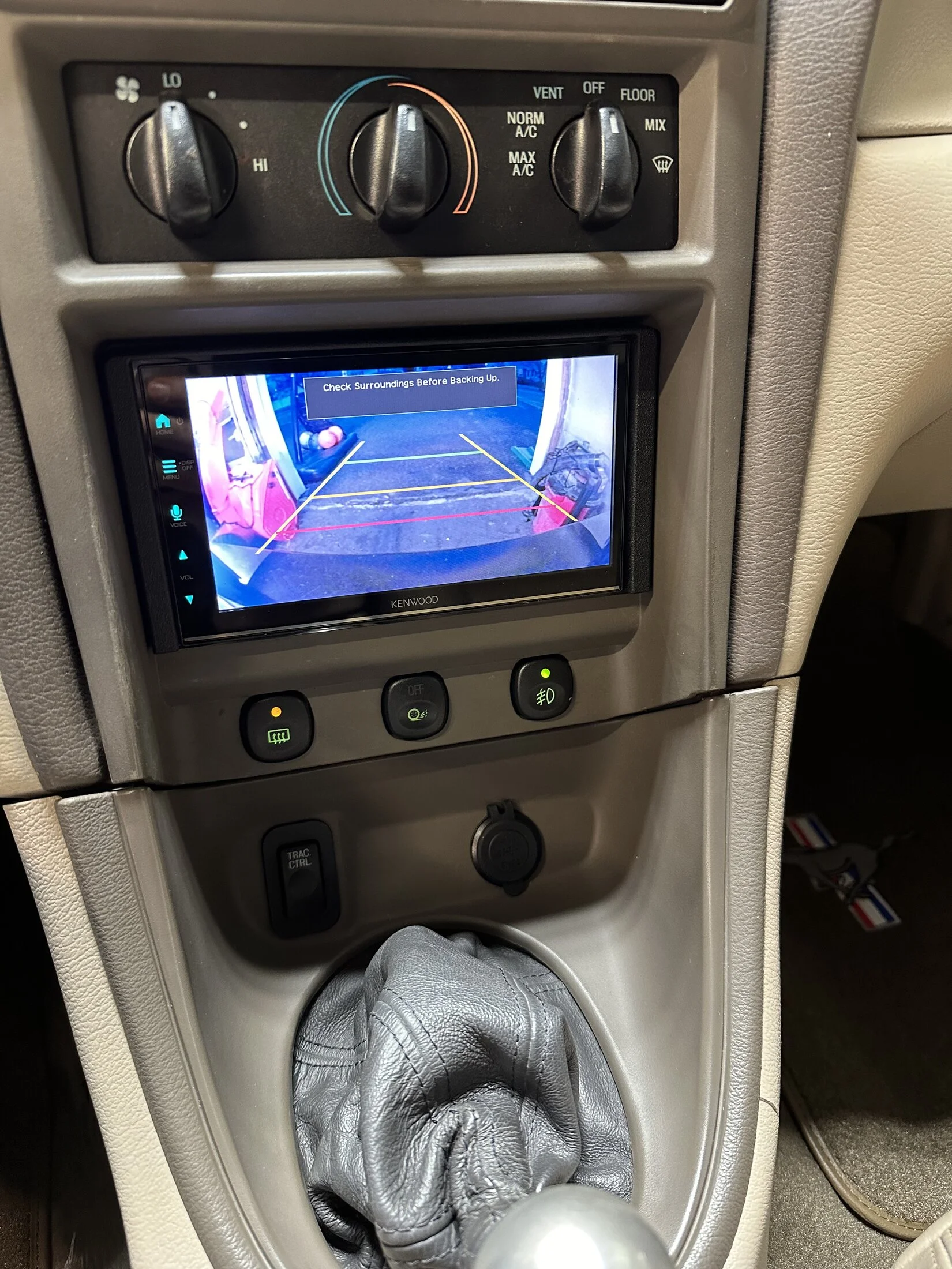

Wired up and first test.
Functionality is all there. Need to wire in my rear camera and the reverse light trigger.
But the issue I have is with the Metra 70-5510 harness. It sucks. This connector blows
I can’t get the connector to seat right, so I lose speakers due to poor connection. One side works, then only the rear, then one front. Any bounce and I lose a pair of speakers. Ordered another one to test it out.

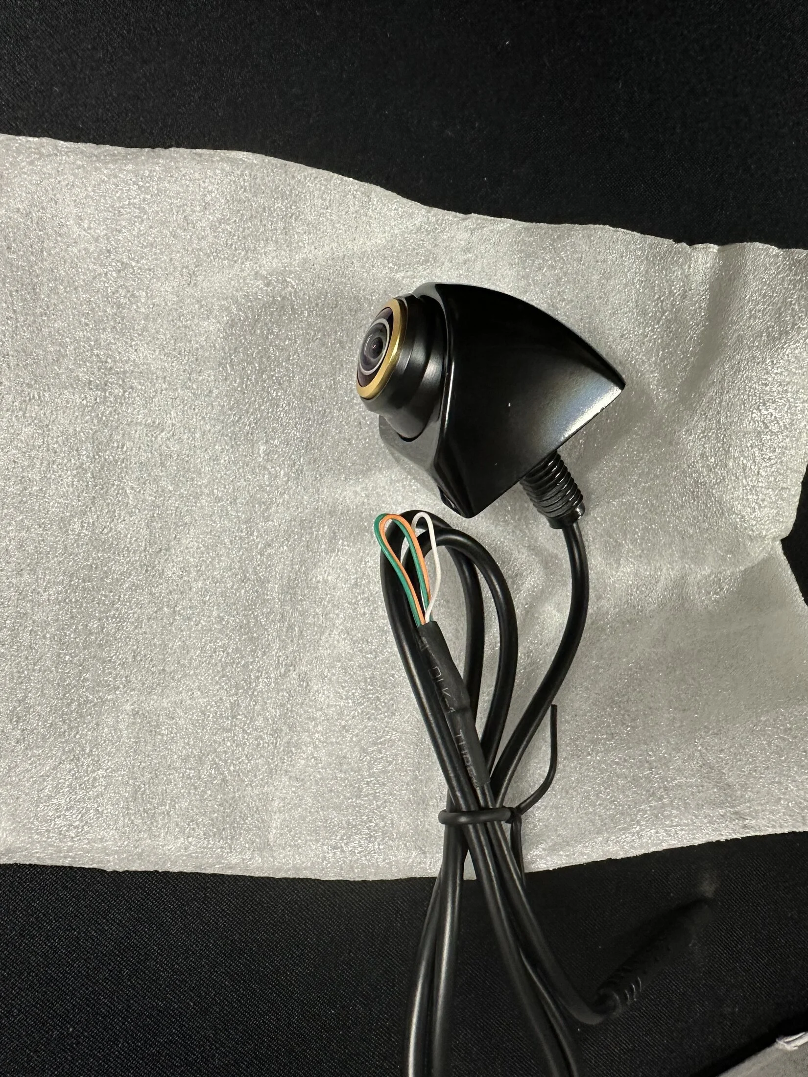

Here’s my rear camera. I want to test it first before installing it
Reactions: General karthief

Fixed the harness issue. Had to cut it up to insert the pins better. A little cludgey, but it works. Tinkering a bit with the EQ settings really dials it in. Radio never sounded this good with the stock head unit. Well…sounds decent for a 24 year old system. let’s not get carried away. I might add a small sub/amp to the setup. 100-150watts
Interior done. Still gotta wire in the rear view camera. Wire connected just need to install in trunk.

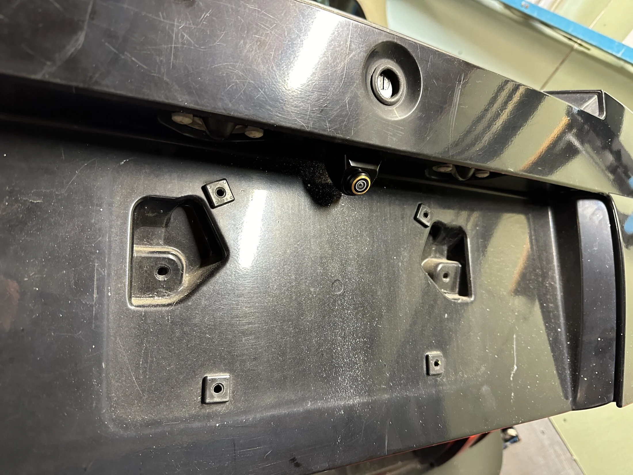

Rear camera mounted. Need to run the wire to the rear and tap into power and the reverse lights.

Rear camera done. Also found an adapter to replace the cig lighter with that connects to the radio. So now I have a convienent USB in.

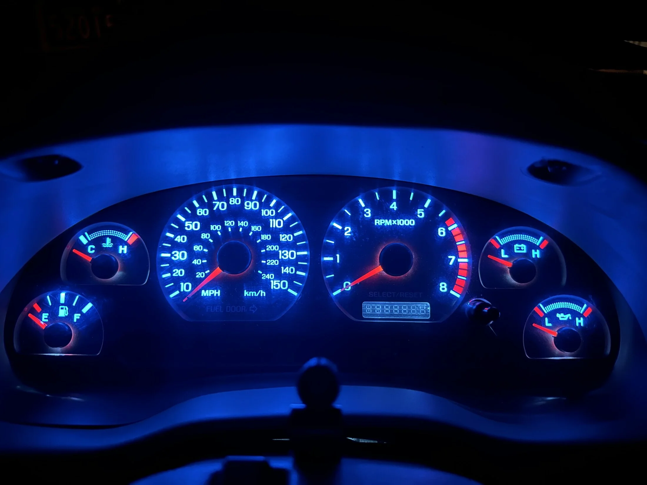

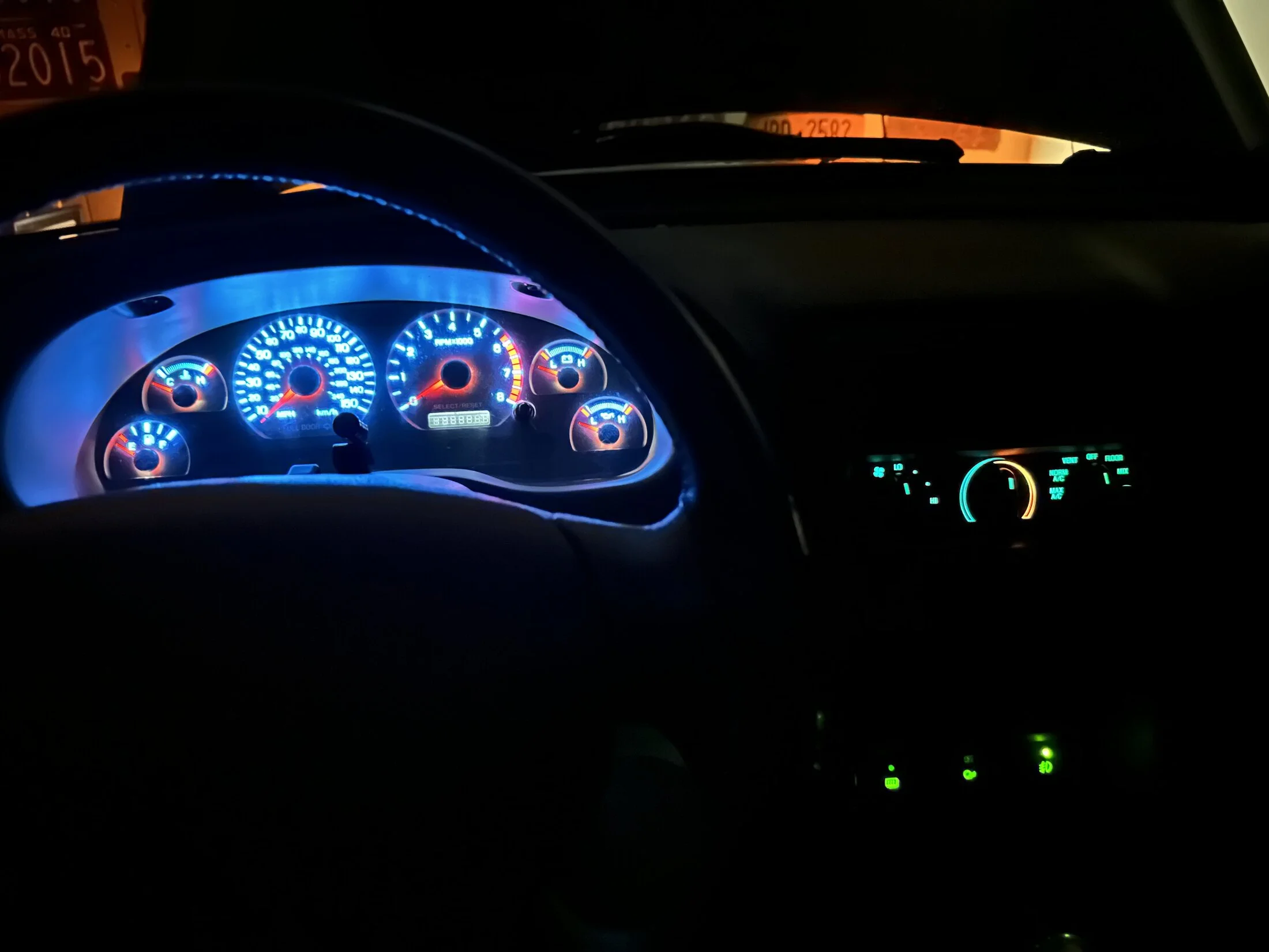

Pulled the cluster, swapped in some size 74 LEDs
Camera adds to the intensity. It’s not as bright in real life. It’s just a nice clean even blue now.

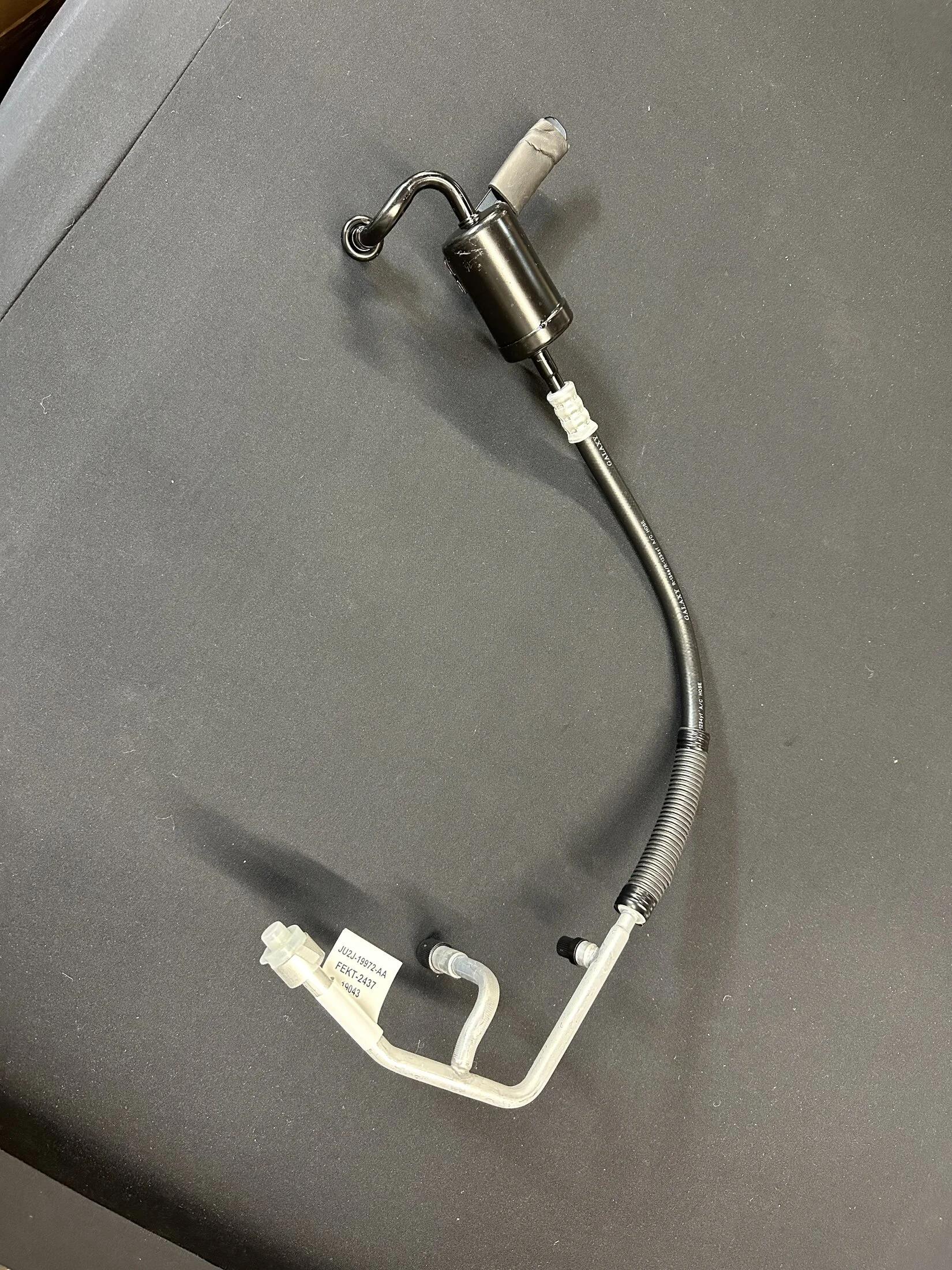

Next on the list is to fix the ac once and for all. It worked, but I had a leak. I found the source of the leak and ordered a new line.
Discovered ford just discontinued the line I needed, but Rockauto had them on “wholesaler clearance”. Timing couldn’t be better. As you may know, I prefer OE ford stuff vs aftermarket
I’ll have to wait for warmer weather to charge.

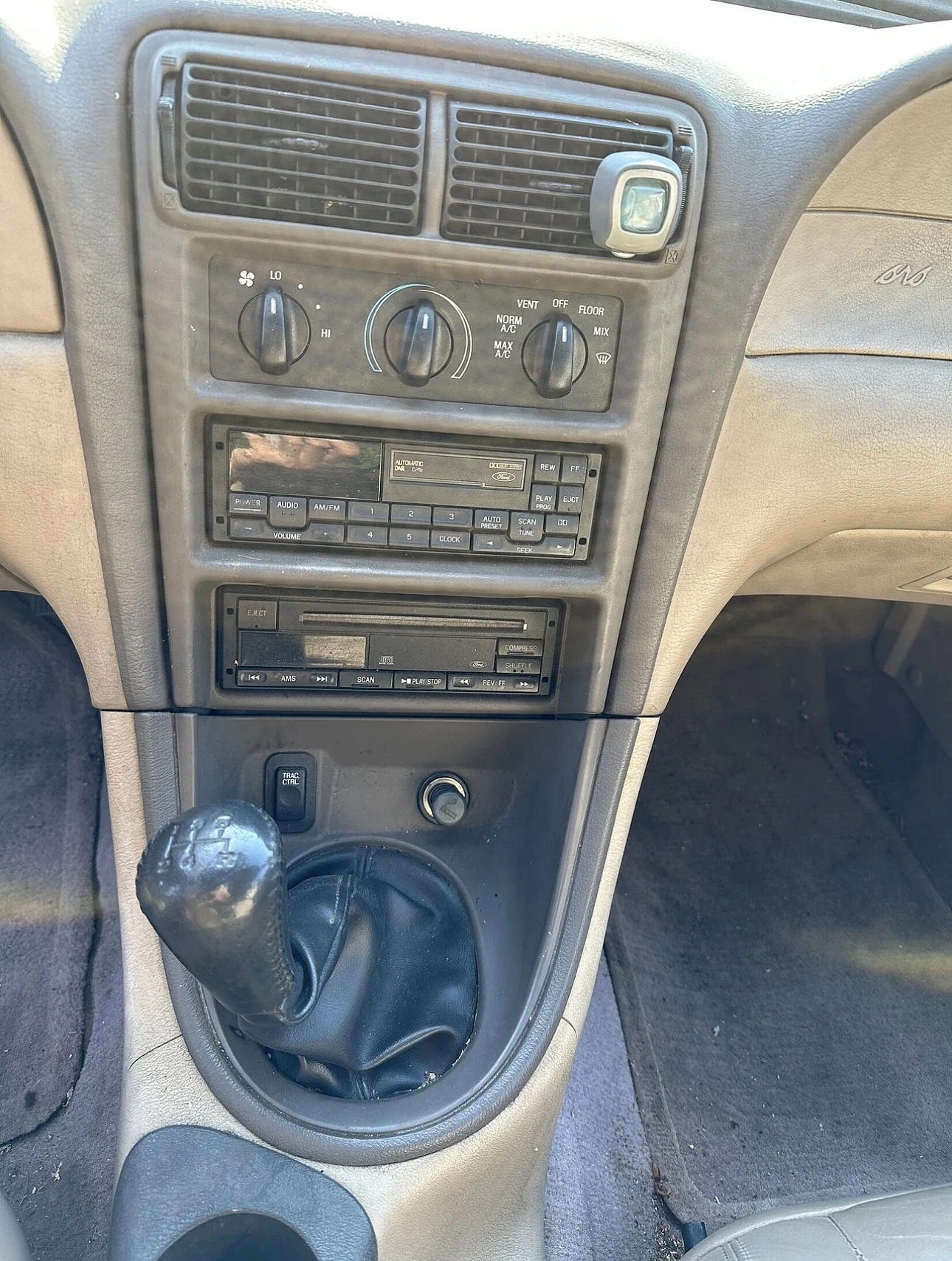

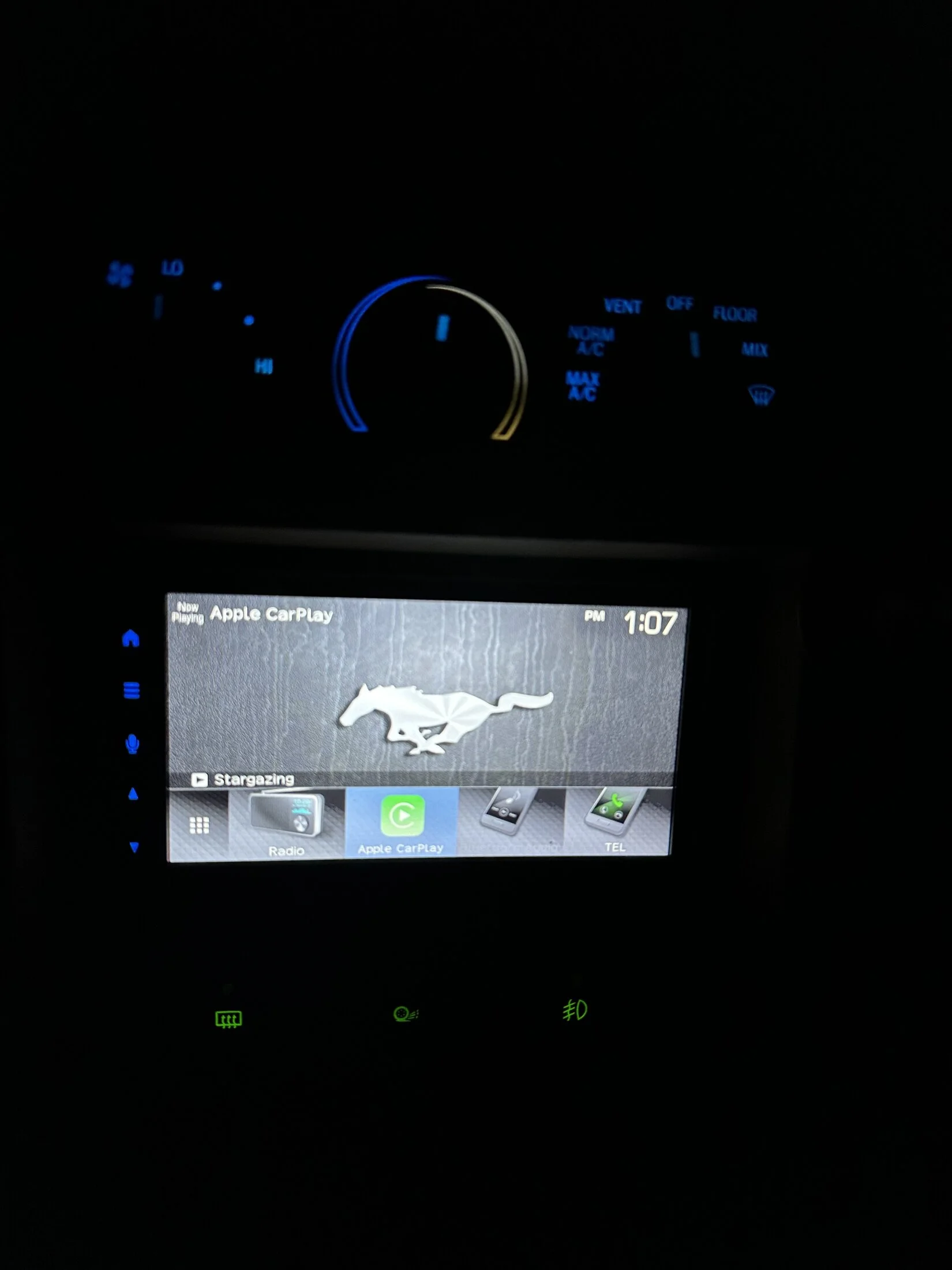

Installed the LEDs in the HVaC. Just two 198 white LEDs.
This is the OE blue. On my list is to swap out the LEDs in the 01+ buttons since those are green. I have some spare buttons so I’ll dissect one to get the LED specs to buy some blue LEDs. Was able to match the radio buttons as well.

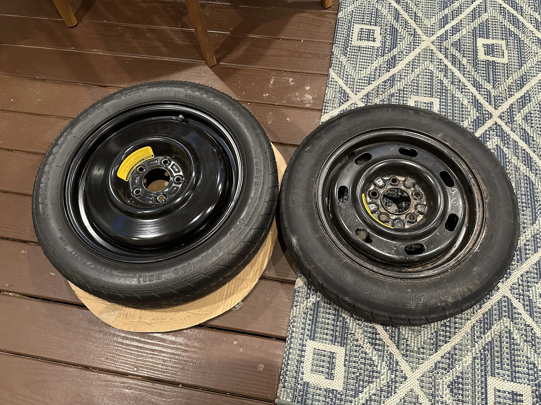

Since I plan on driving this a lot, I wanted to address the spare tire situation after putting cobra brakes on.
So I picked up a pretty much unused 17” cobra spare. Hopefully I’ll never need to use it but at least now o don’t have to play musical wheels if I get a front flat.
However I just realized I don’t have a lug wrench. Need to measure my lugs and get one.

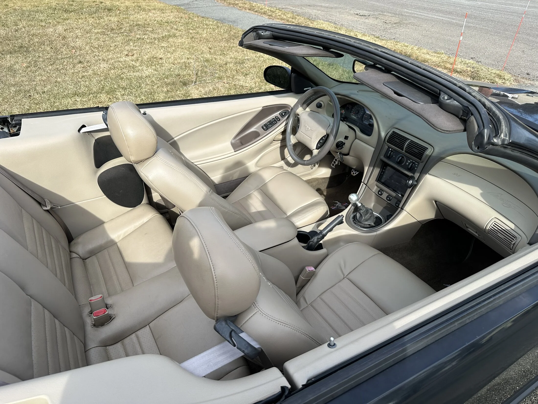

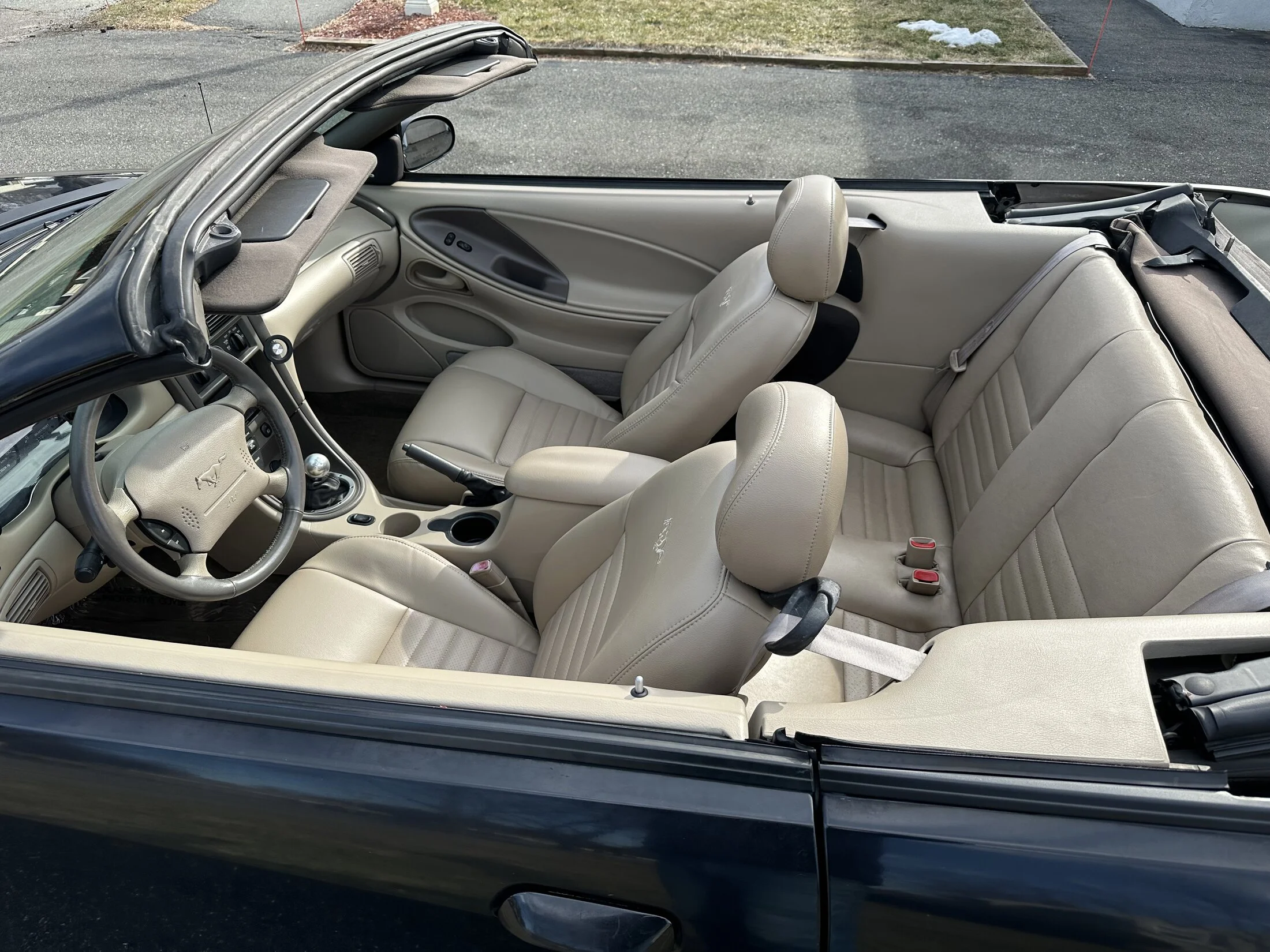

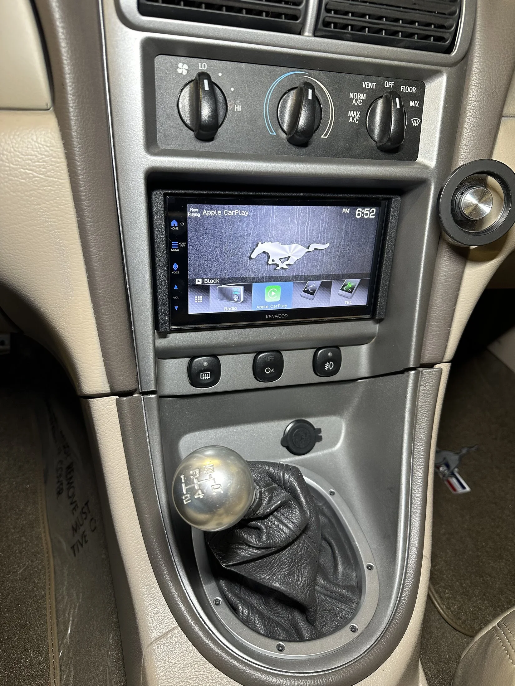

Top down shot of new recovered seats and interior. Was warm enough to drop top and go around the block. Almost 60 today. Still need alignment.
Noreaster due on Tue. Today is what we call “false spring”. 2nd winter starts Tue.

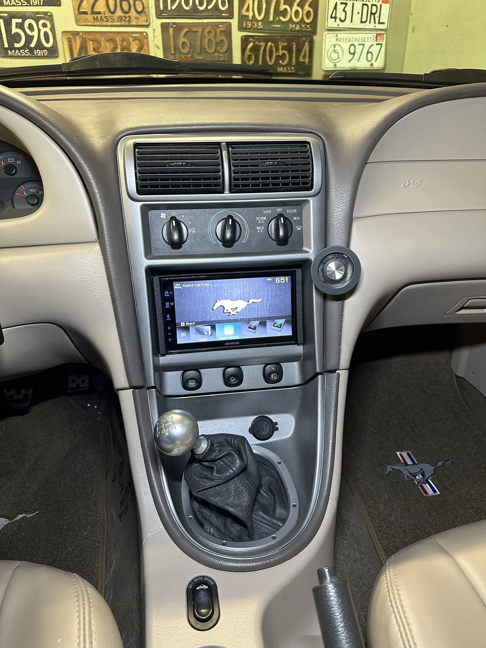

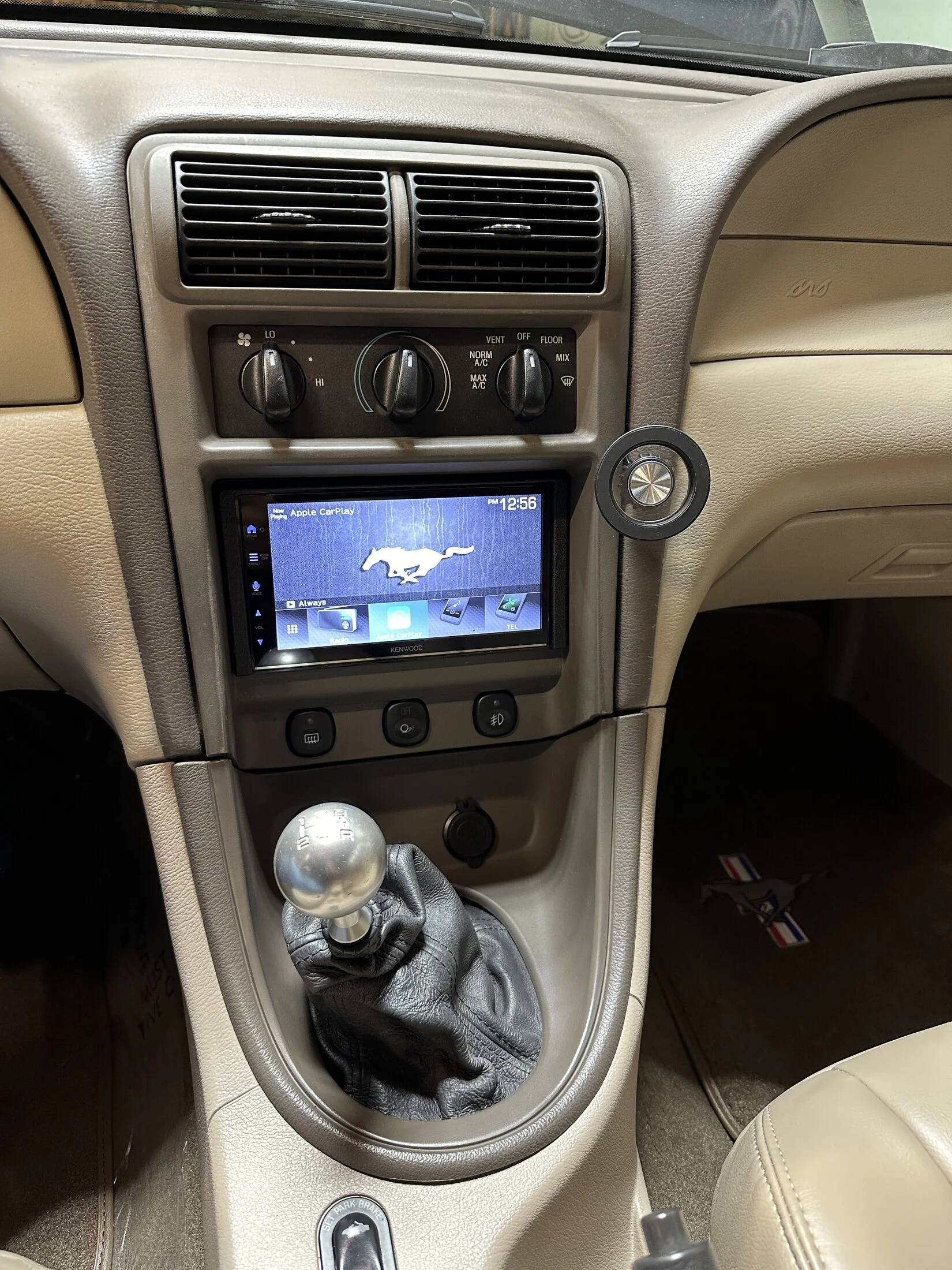

Finally got around to swapping over the silver Interior Upgrade Package trim. I had this in my ‘03GT, so it’s back for second car.
Looking back at when I first got the car, we’ve come a long way.

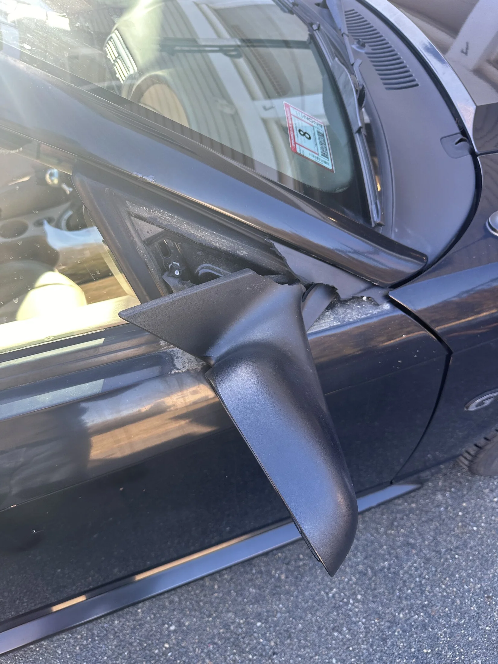

Backing out of garage today. Realized I left the snowblower too close to one side and said “I can squeeze it through”
Nope. Caught the edge of the door.
Managed to snag a pretty clean replacement off eBay for $30/shipped.

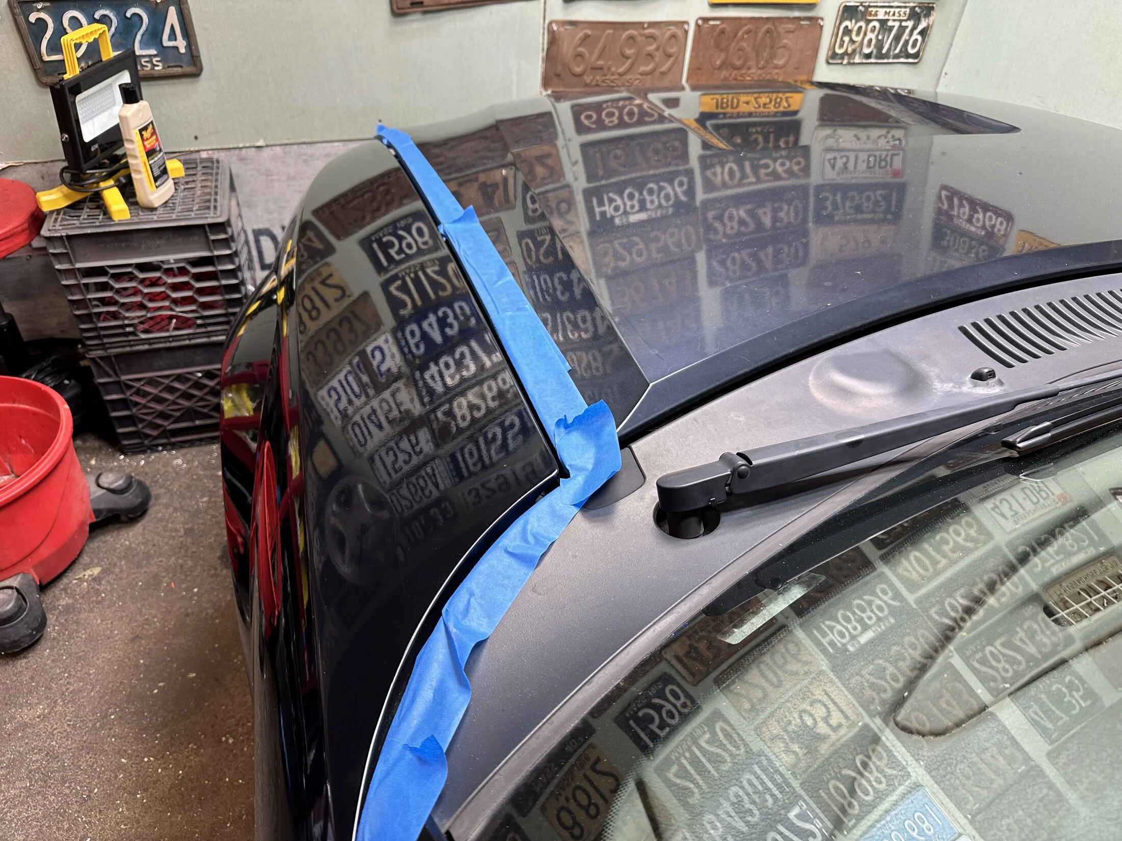

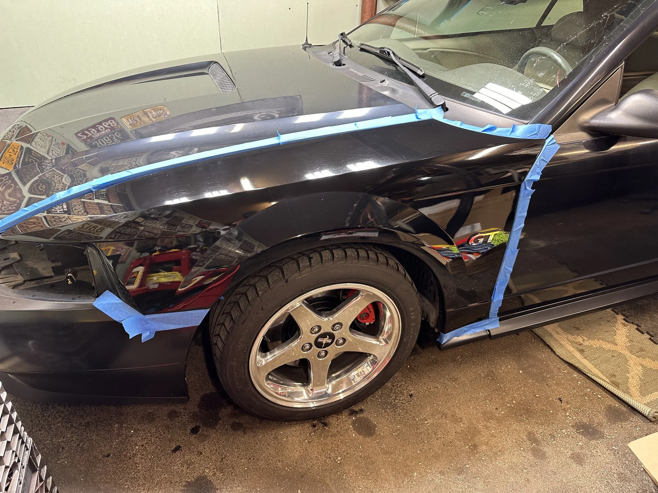

Ok how bout some good news then.

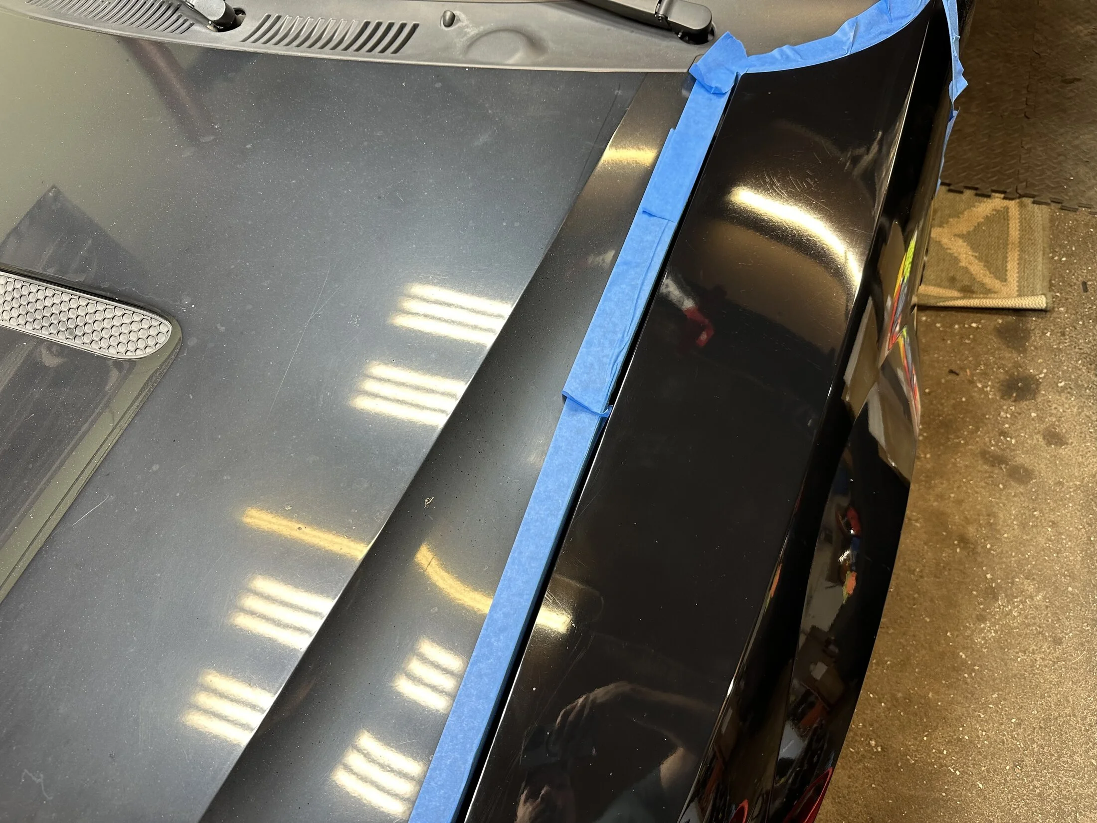

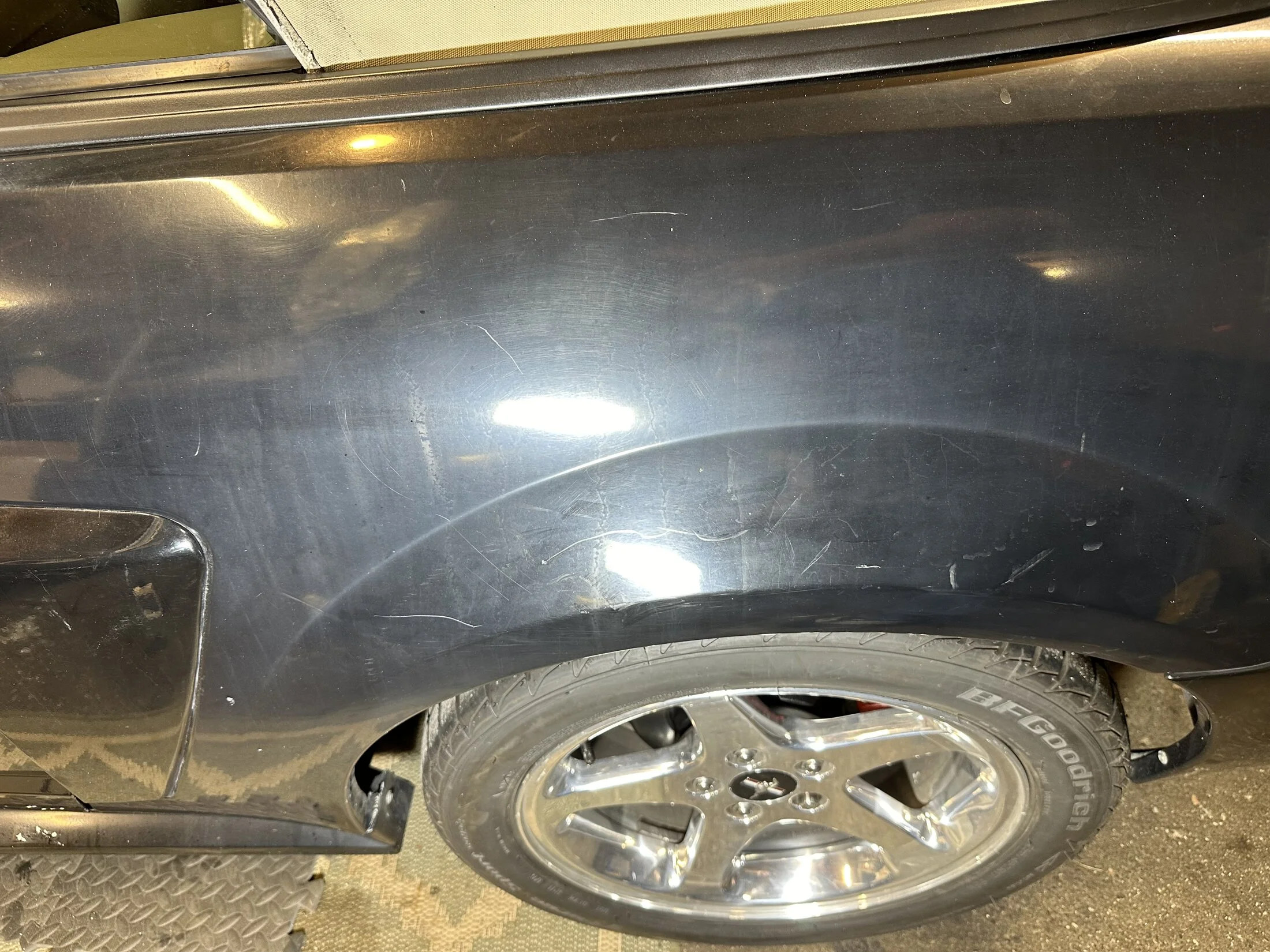

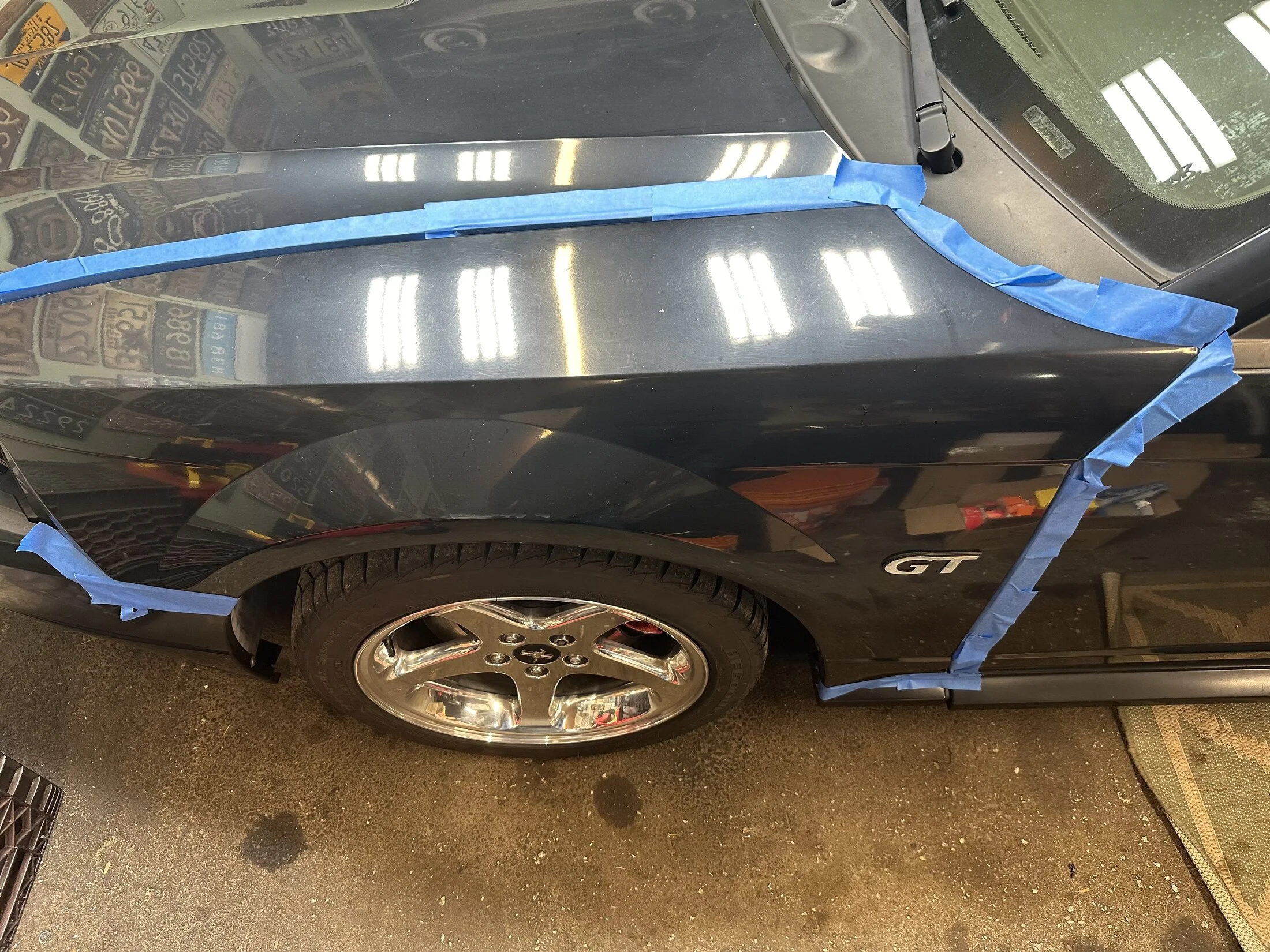

Decided it was time to work on paint. I’m not expecting much, but this made my day. An hour or so of work with a buffer and waxing and end result of drivers fender.
Starting point.
And where I ended up.
There are deep scratches and such, so I’ll never get this paint perfect. But what a difference! Just this one fender alone gives me hope that this $1k beater will end up being a pretty darn nice car.

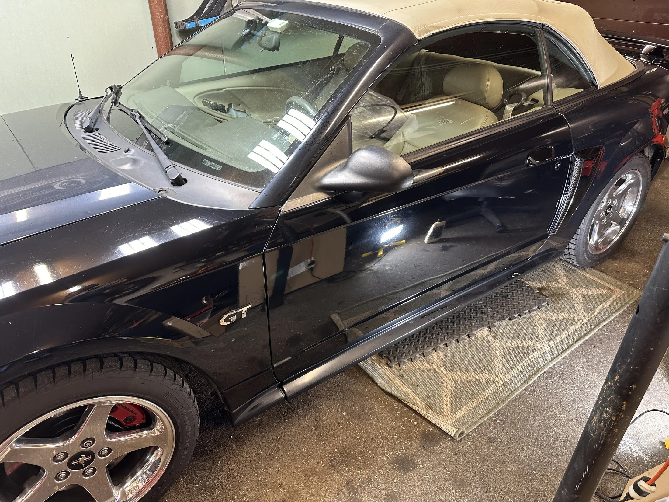

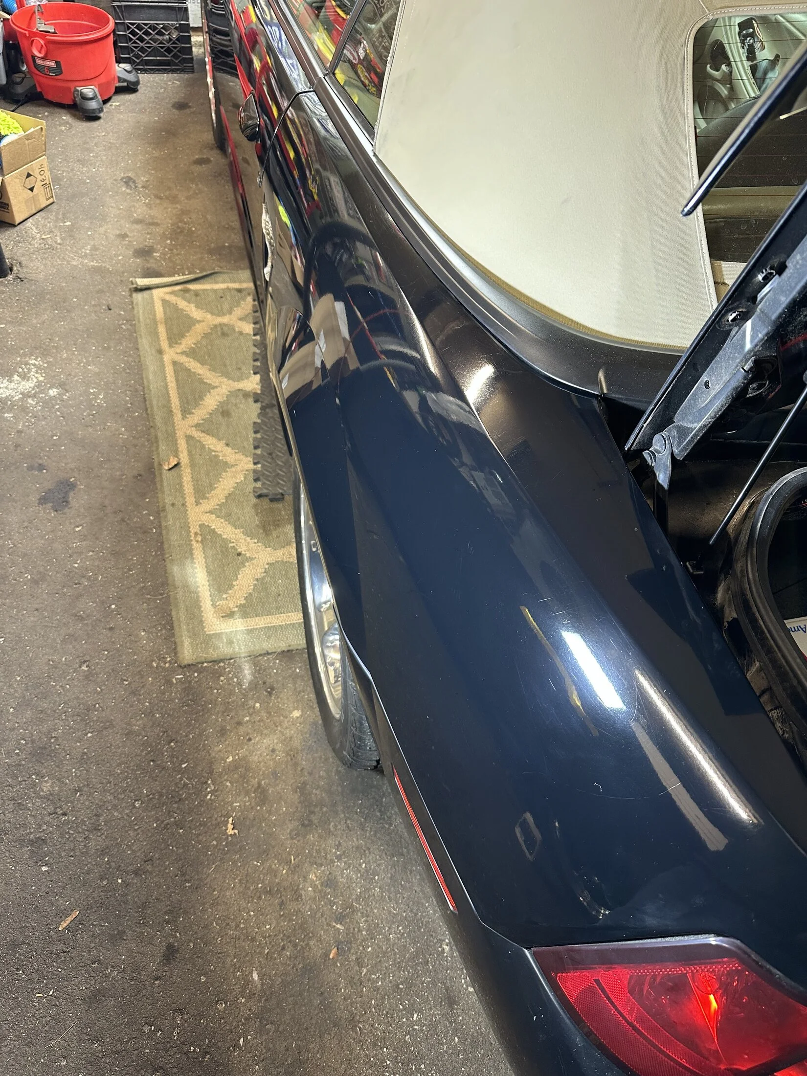

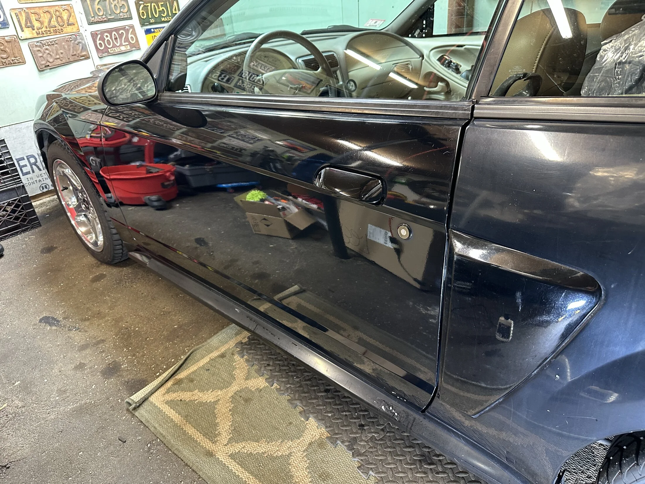

worked on the drivers door and called it a day. Tedious work. Wish the pics came out better as they don’t do the car justice. Just these two alone have me looking at this car completely different. Before I was envious of new edge guys with decent paint. Now…I might be ok.
Working ont he rear quarter next. I think I’m going to remove the side scoop and the lower rocker trim and do them off the car. The scoop is shinier because I put the 01+ scoops on the car so this one came from a different car. But you can see by the rear quarter how oxidized it was. That’s how the door and front fender looked too.

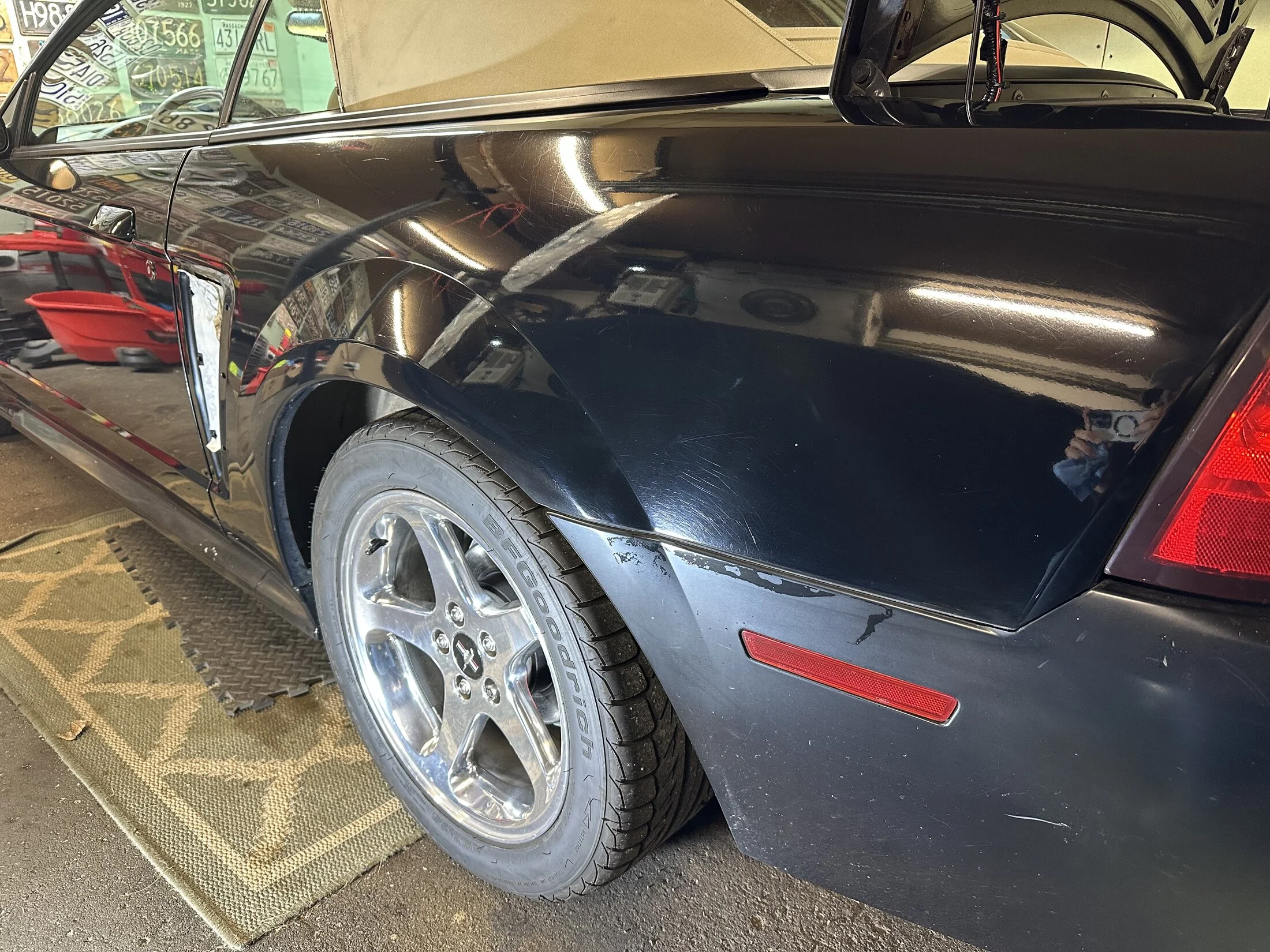

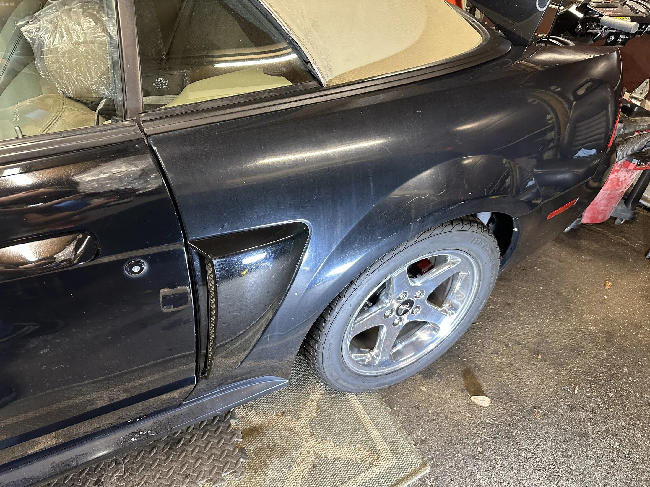

Worked on the rear quarter. Pulled the scoop. I’ll do that off the car.
Looks wet, but it’s not. Came out so nice.
Ok. I’ll post some pics when completely done. Stopping here for now and no idea when I’ll get to the other panels. Front and rear bumper will likely be the trickiest.
