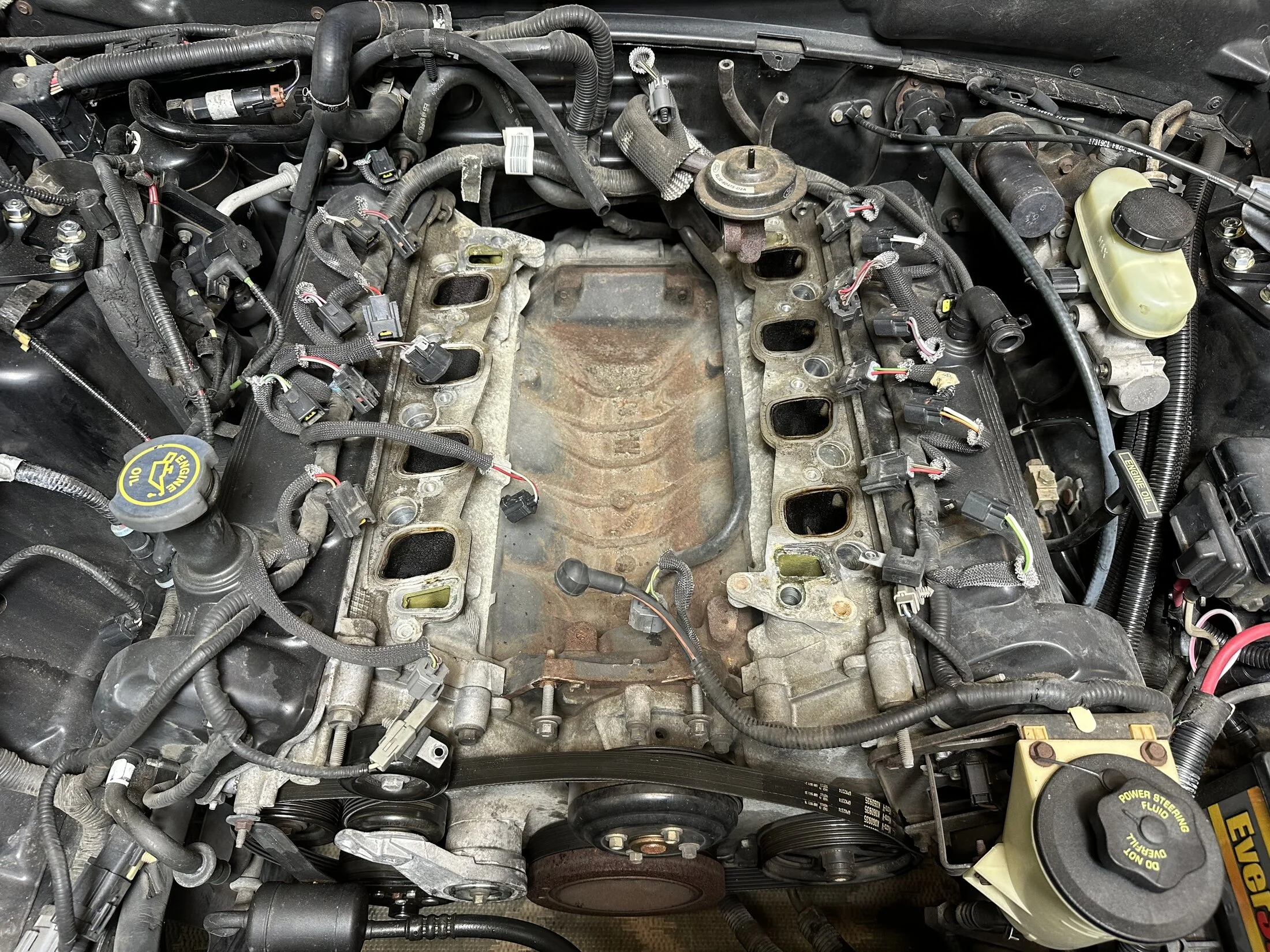

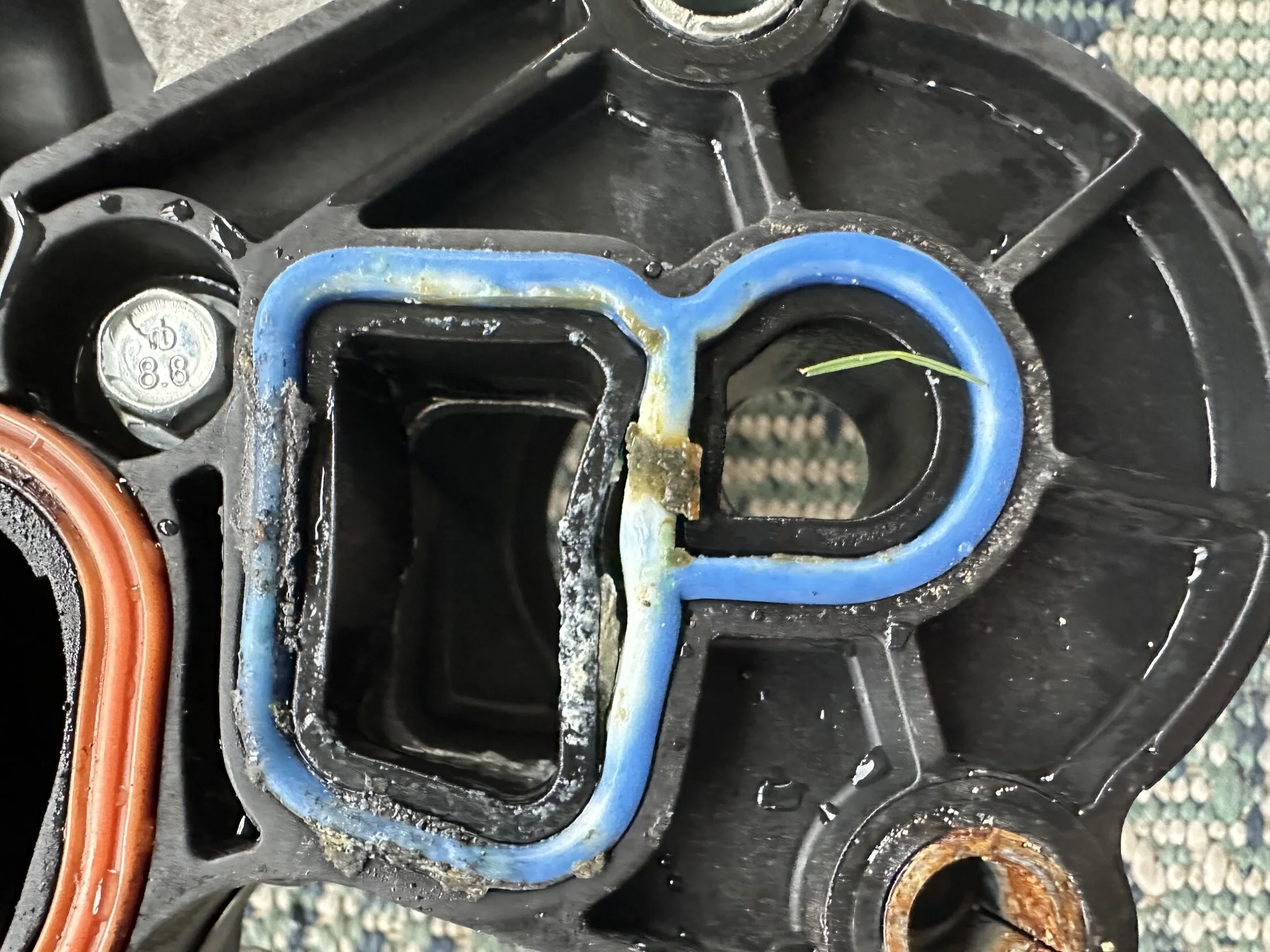

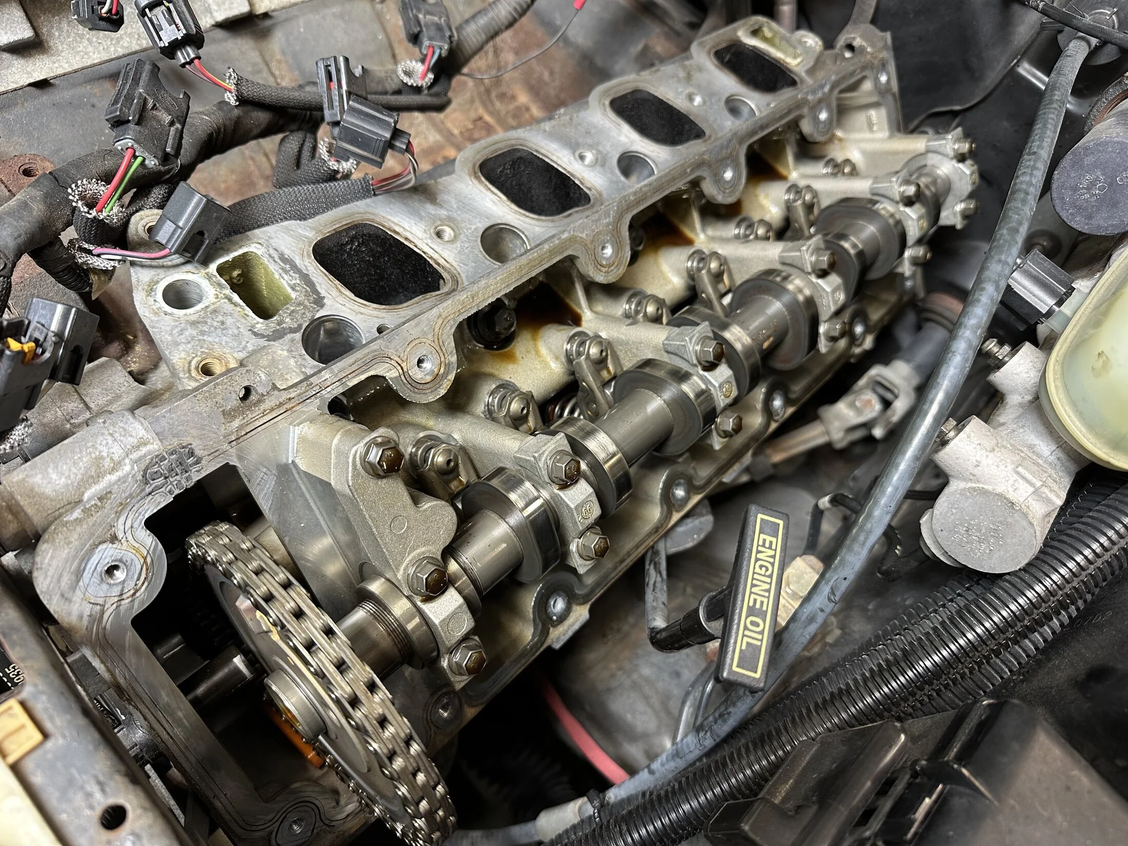

Intake off. Need to clean this all up and then tape off the ports and we can then pull the valve covers off to replace the gaskets. Pass side is leaking a bit at the front top corner.
Dorman intake had a 2015 date on it. No idea of that’s when this thing was installed but it’s already failing.
Hard to see but both sides of that port are cracked and collapsing. Hmm…actually this is the same corner I have my valve cover leak. I wonder if that’s really coolant….

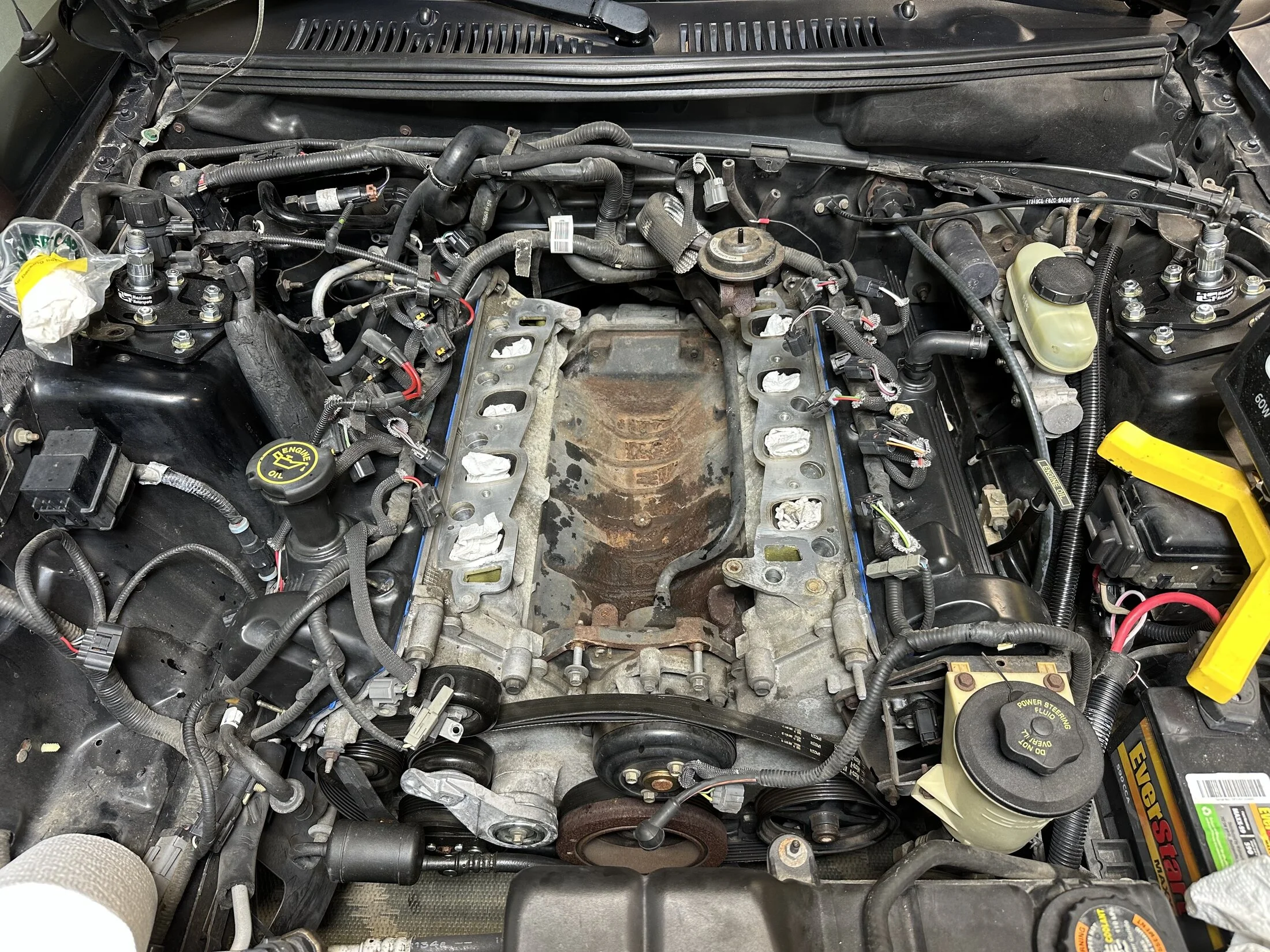

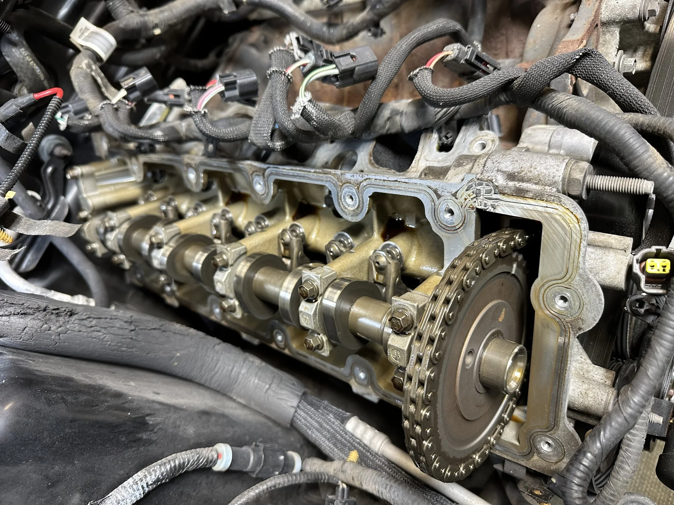

Valve covers off. Cleaning them up before reassembly time. Not too bad getting these off with the intake off.
Everything looks very clean under there. Timing chain nice and tight.

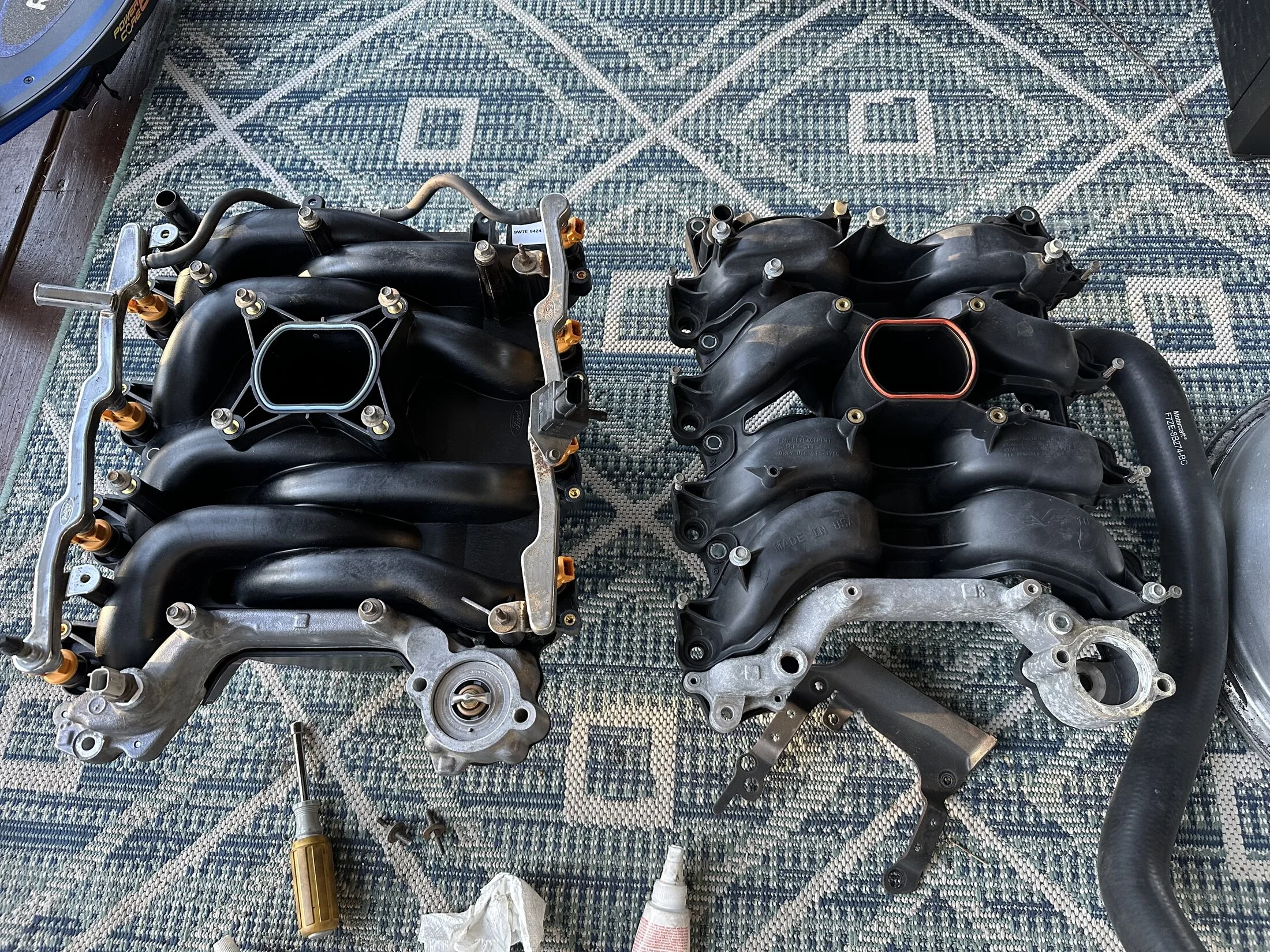

Valve cover gaskets done. Had to stop for the night for some injector o-rings an pintle caps. Didn’t like the seal with the old o-rings felt too lose. Guess the Dorman intake it a little tighter in the injector bore so the o rings were compressed more.
Getting new intake ready

Old Dorman on the right?
Reactions: Mustang5L5

Yessir

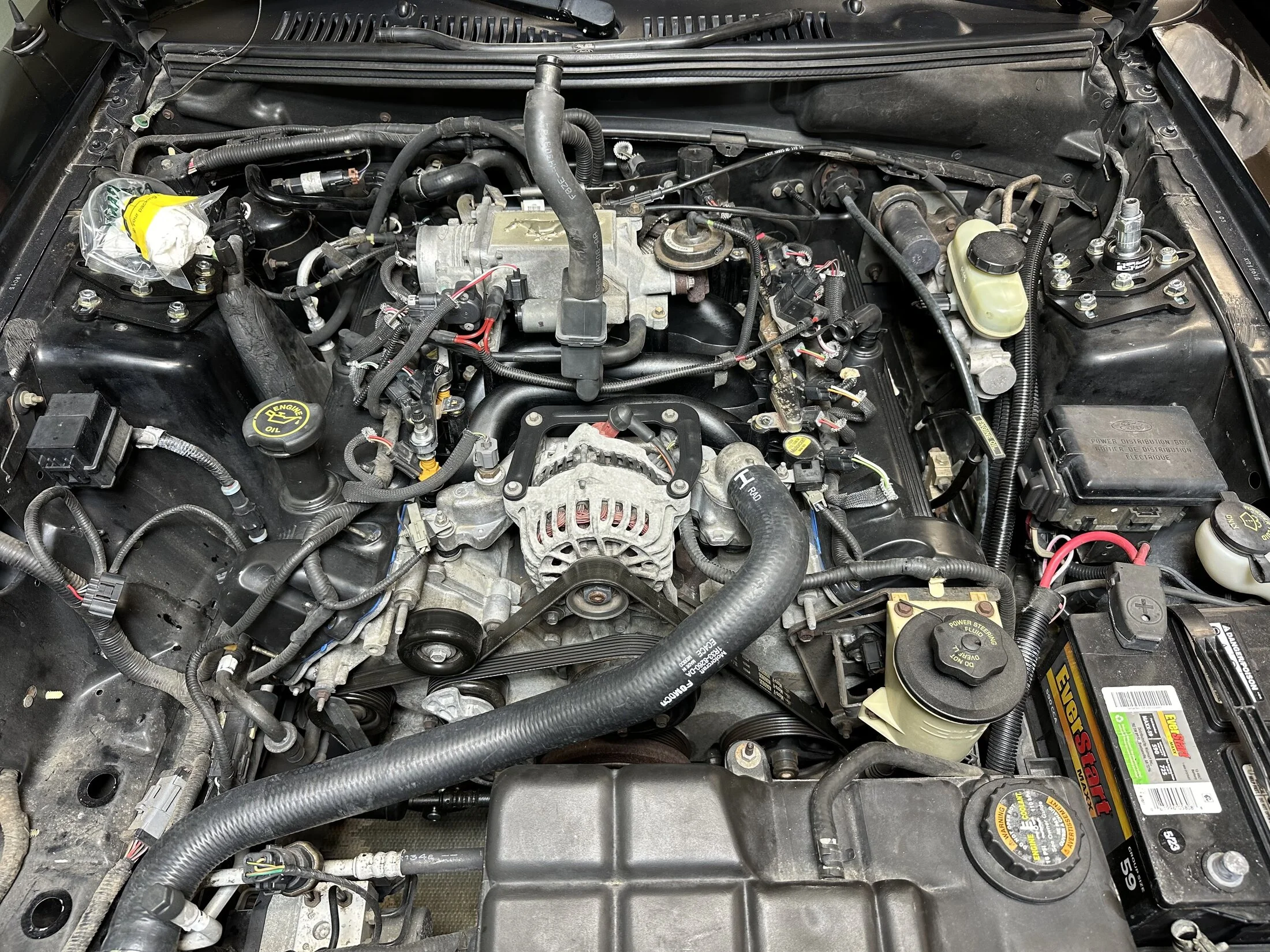

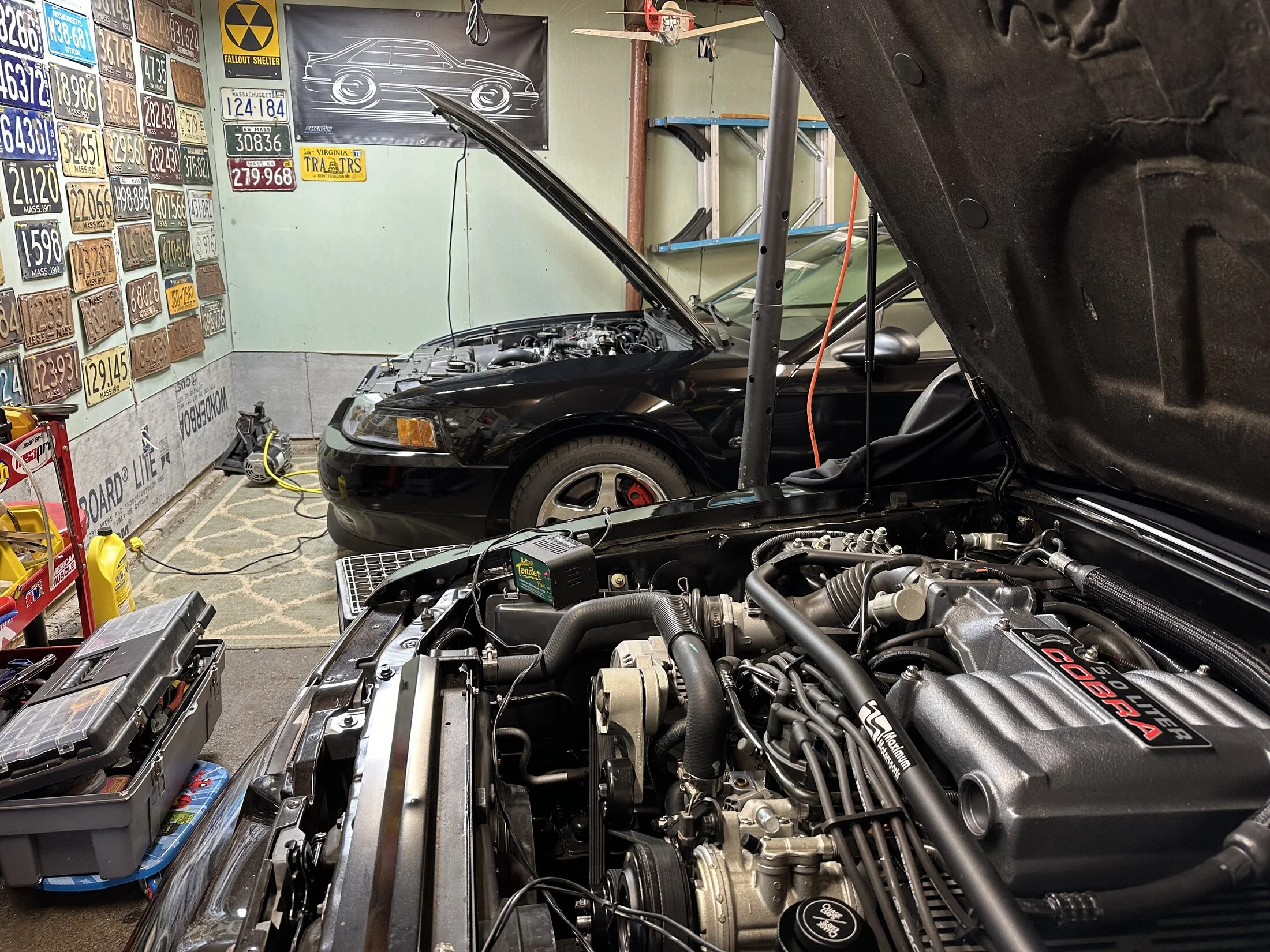

Got a lot done today. Still waiting on injection-o rings so holding there for now.
Refilled coolant
Drained and filled power steering fluid
Drained and filled trans fluid
New spark plugs
Valve cover gaskets
PI intake
Replaced transmission mount
Adjusted my hood latch

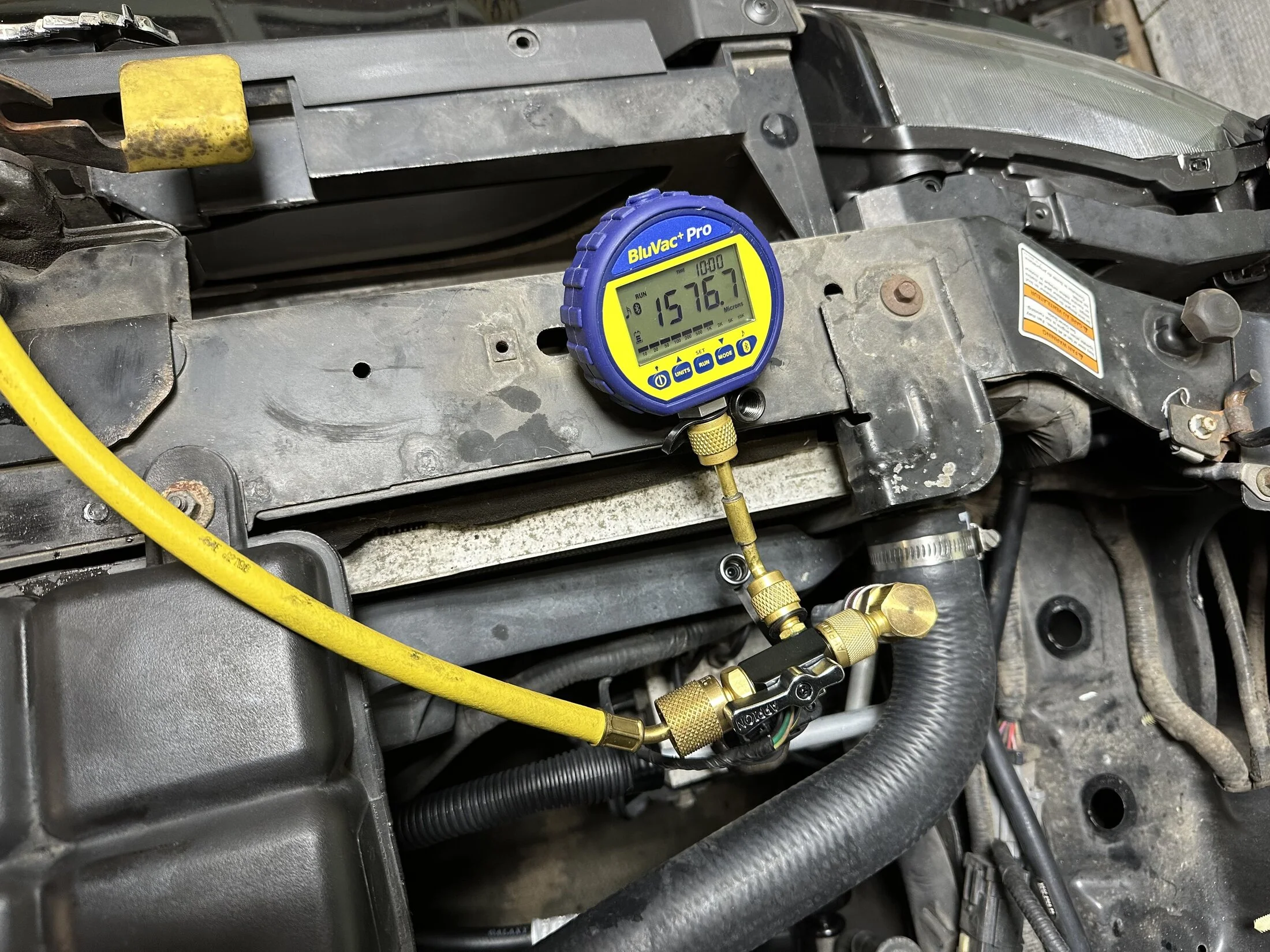

since I was on a roll, I decided to pull off and replace the AC line that was leaking. Quick swap, and pulling a vacuum as we speak
Hoping I can wrap this all up tomorrow

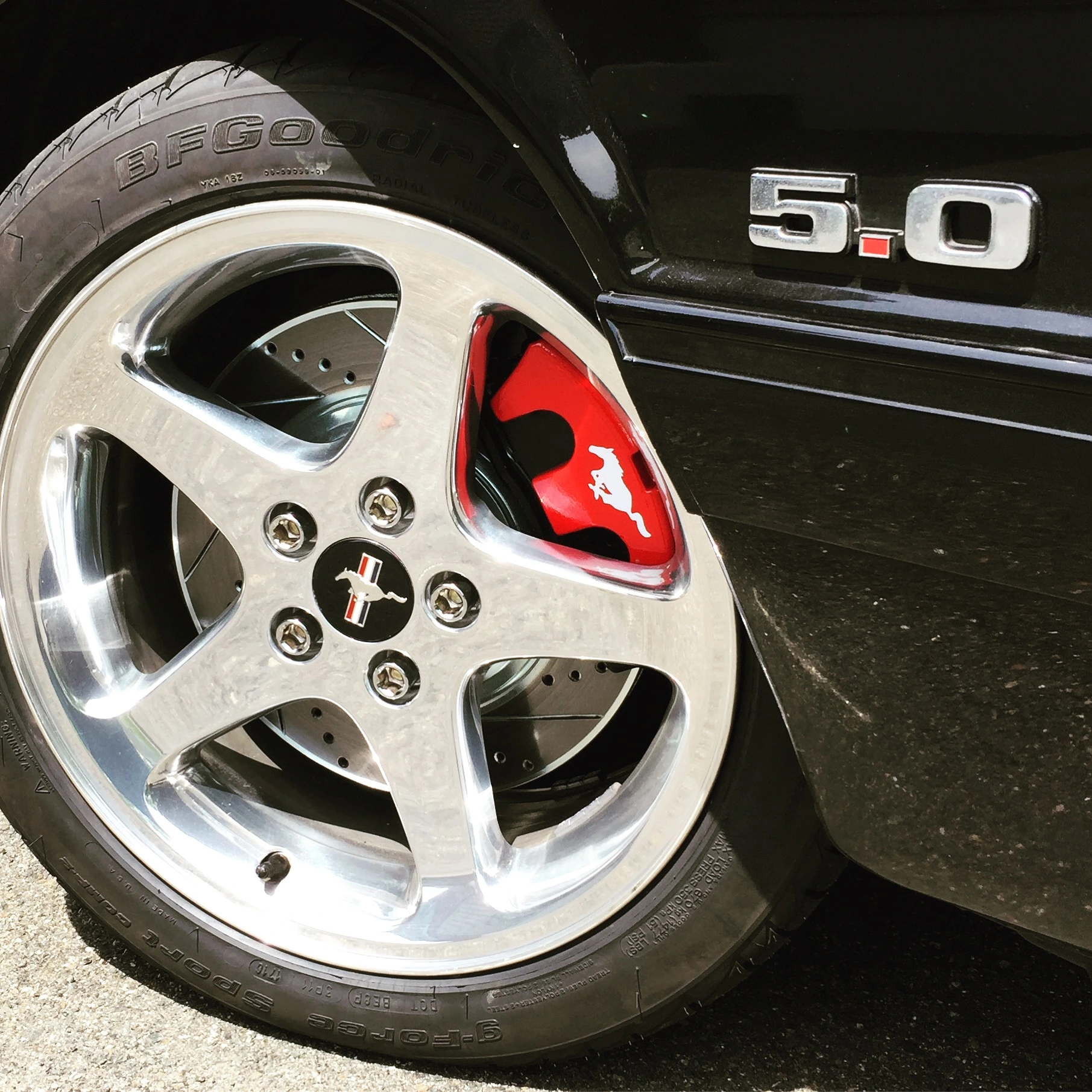

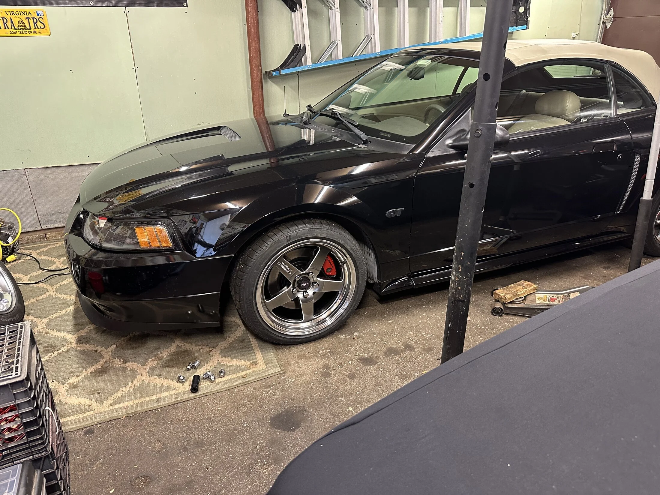

One of my final projects (seriously I’m almost done) is these 99-04 Cobra calipers I picked up. Got both remans for under $100 total.
I’m debating taking a sanding disk to the cobra logo and making it all flat. I’ll paint them red and stick a pony on like the ‘01 bullit calipers

Nice, I think the “COBRA” would look cool showing through the wheels on that car Mike.

Leave the cobra on them, it's not hurting anything and if you upgrade to a huge brake system later they will have higher resale value.

Welll this was my alternative plan, just like what’s on my Fox
Technically the only caliper is still in the mail. So it may or may not say cobra on it. We will see when it gets here and then decide.

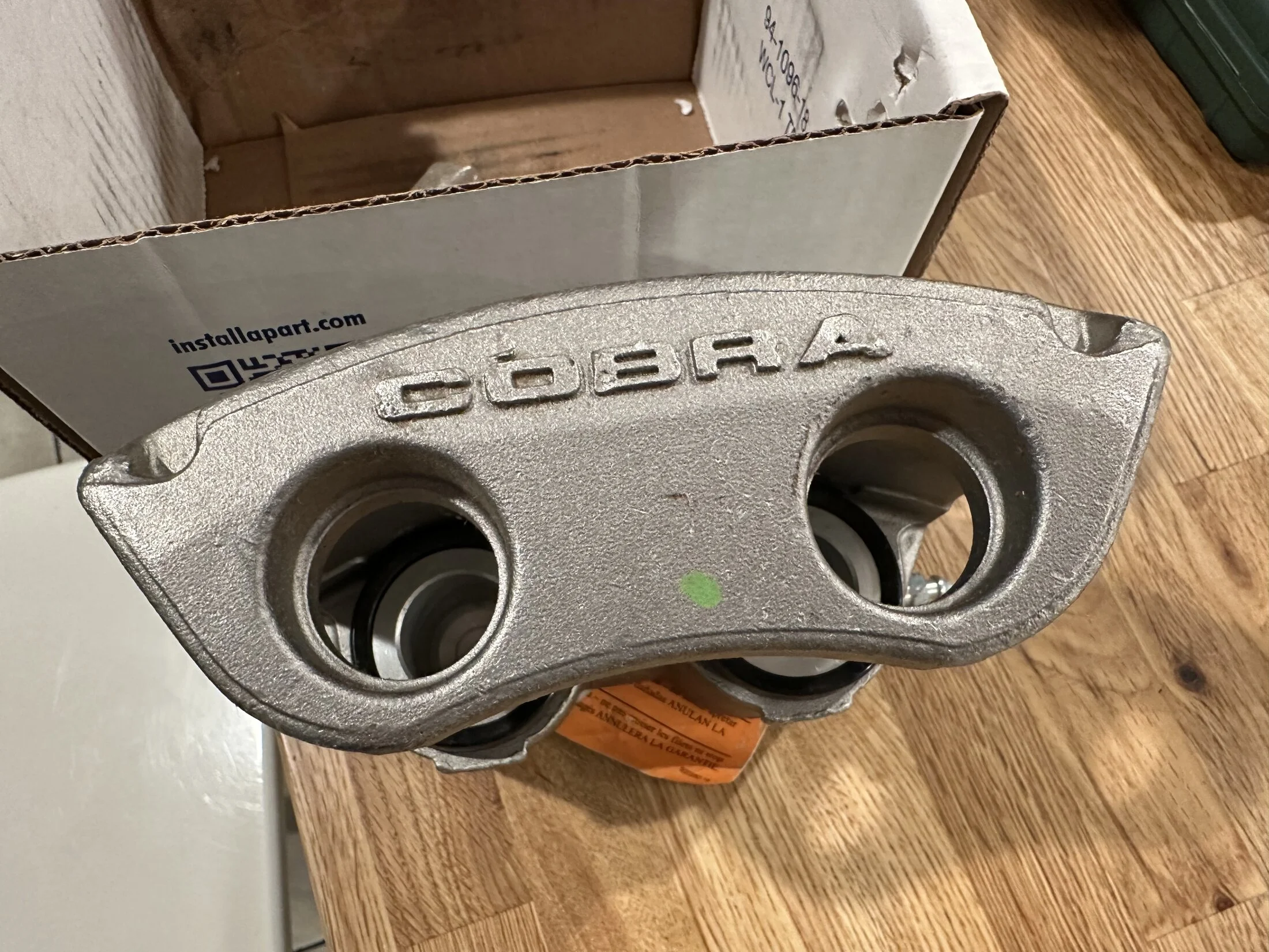

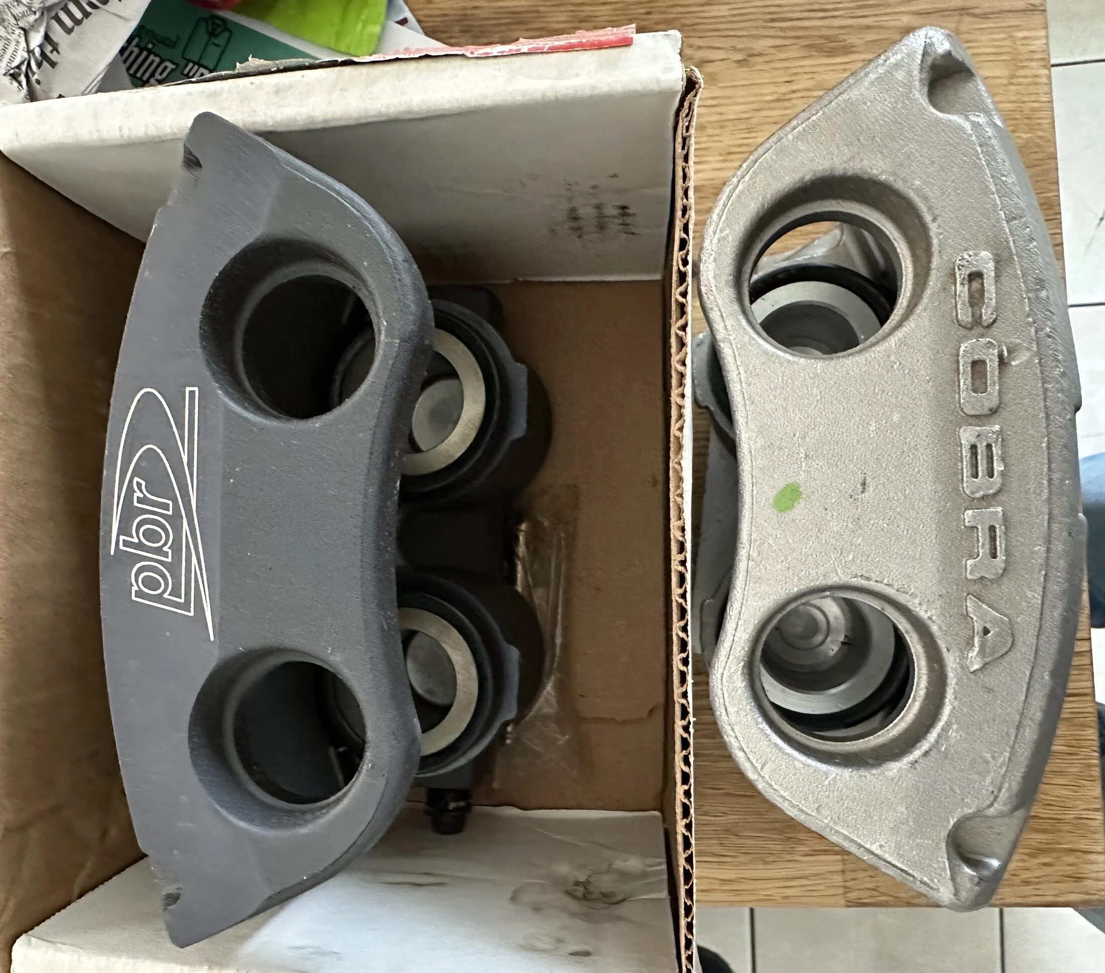

Other caliper arrived. Guess there really is no consistency with Cardone remans.
These are both the same line, just opposite sides. One is a bare cobra that’s obviously used and been reman’Ed. The other looks like a brand new casting.
Maybe I should Amazon another of same side as COBRA and see what shows up.

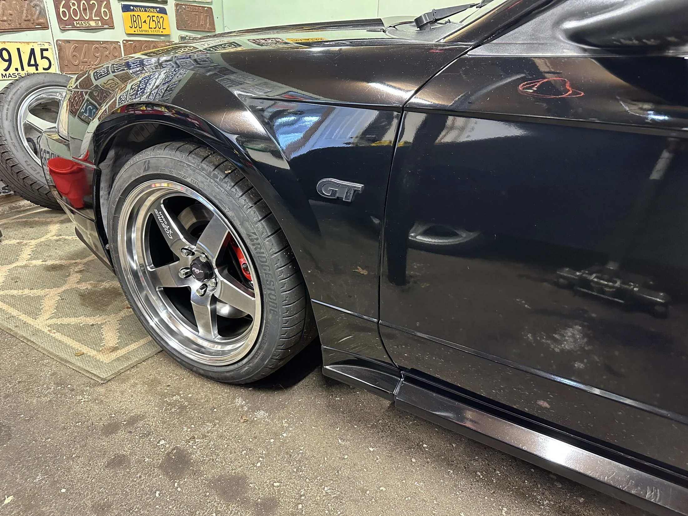

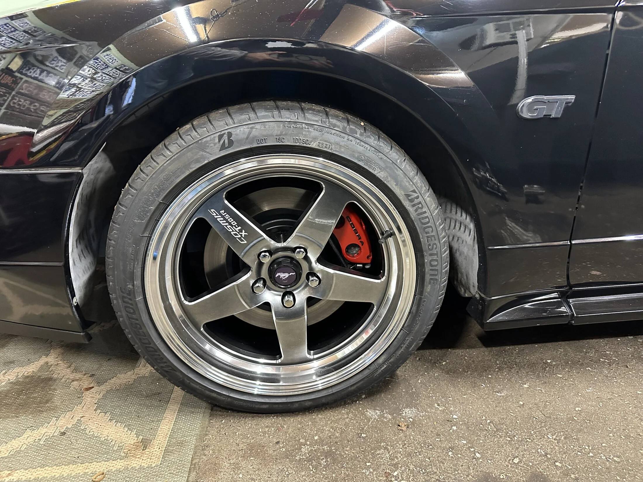

Not sure if this works…
General karthief
5 Year Member
Aug 25, 2016
27,865
10,537
203
polk county florida
Mar 27, 2024
#258
  • Mar 27, 2024
  • #258
I don't hate it
Trogdor
5 Year Member
Aug 30, 2018
195
119
53
Anna, TX
Mar 27, 2024
#259
  • Mar 27, 2024
  • #259
Not my favorite.
Oct 28, 2001
5,810
3,941
183
Claremore, OK
Mar 28, 2024
#260
  • Mar 28, 2024
  • #260
I think they look better on a solid color car so for me its the color of the convertible top that throws it off. Shape of the wheel looks great on the car.
