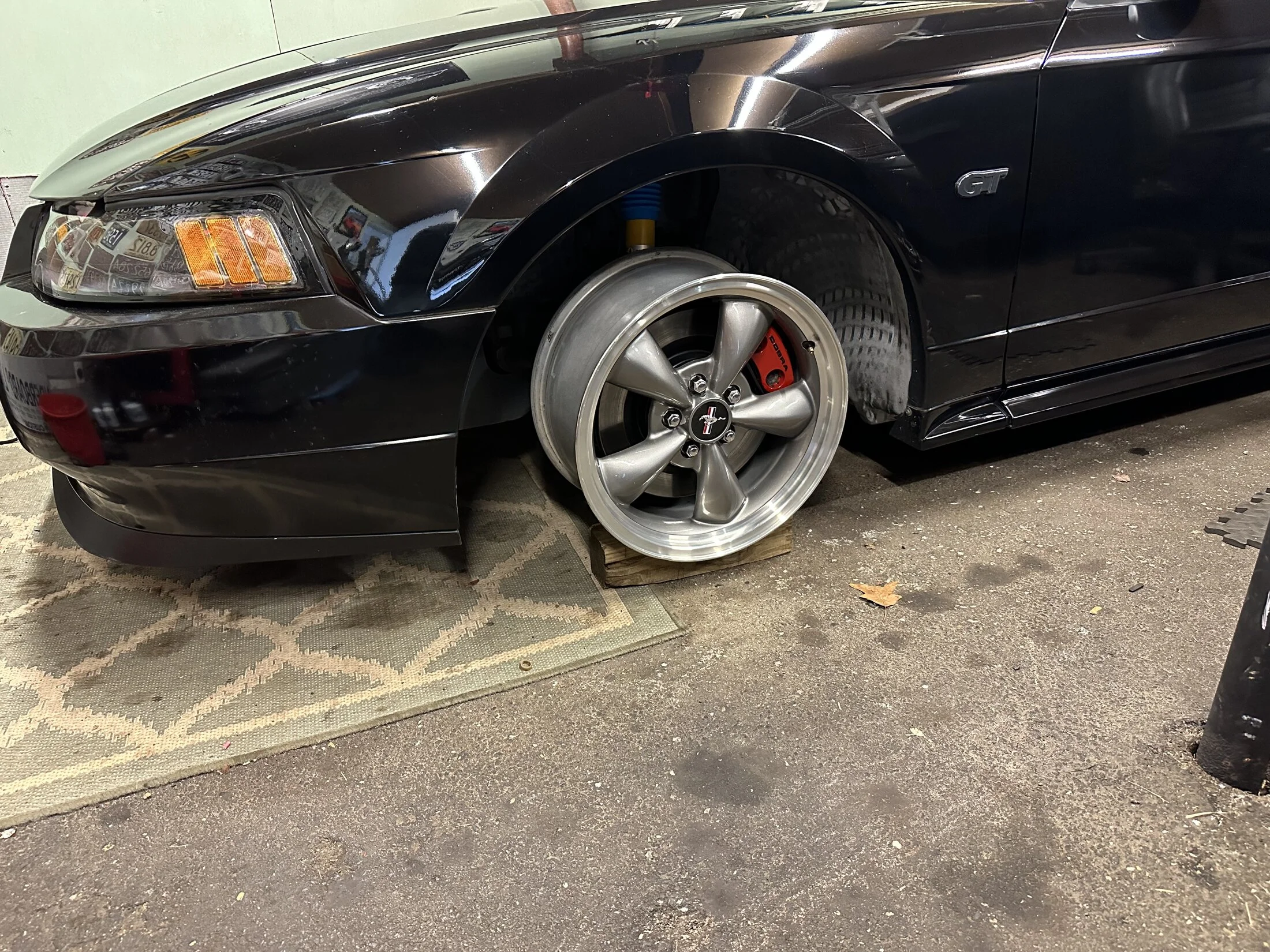

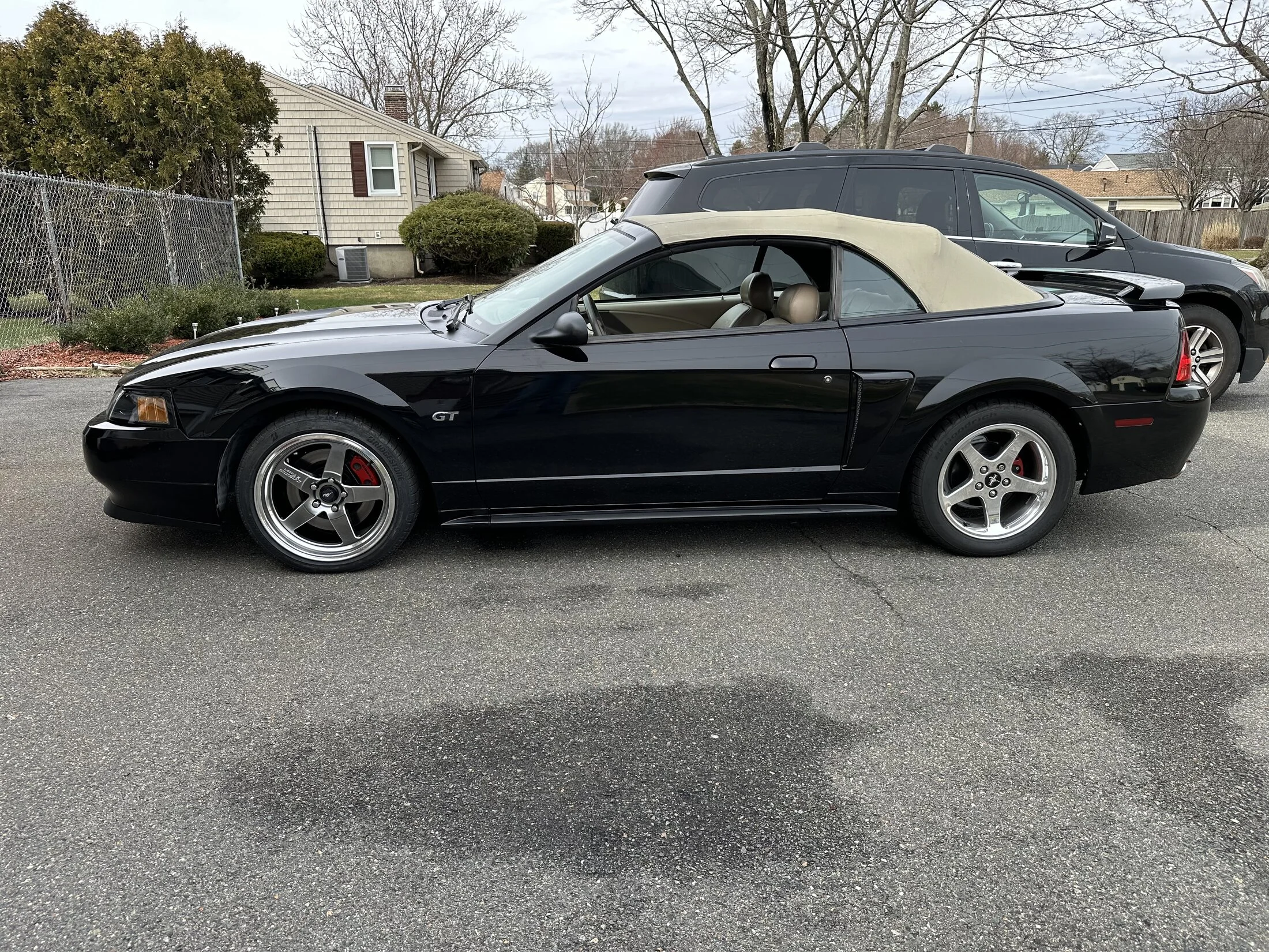

Yeah, slept on it, walked into garage and looked at it and decided no. I'll swap them back.

Backed it out. Looked at it……. I do like it better here…..

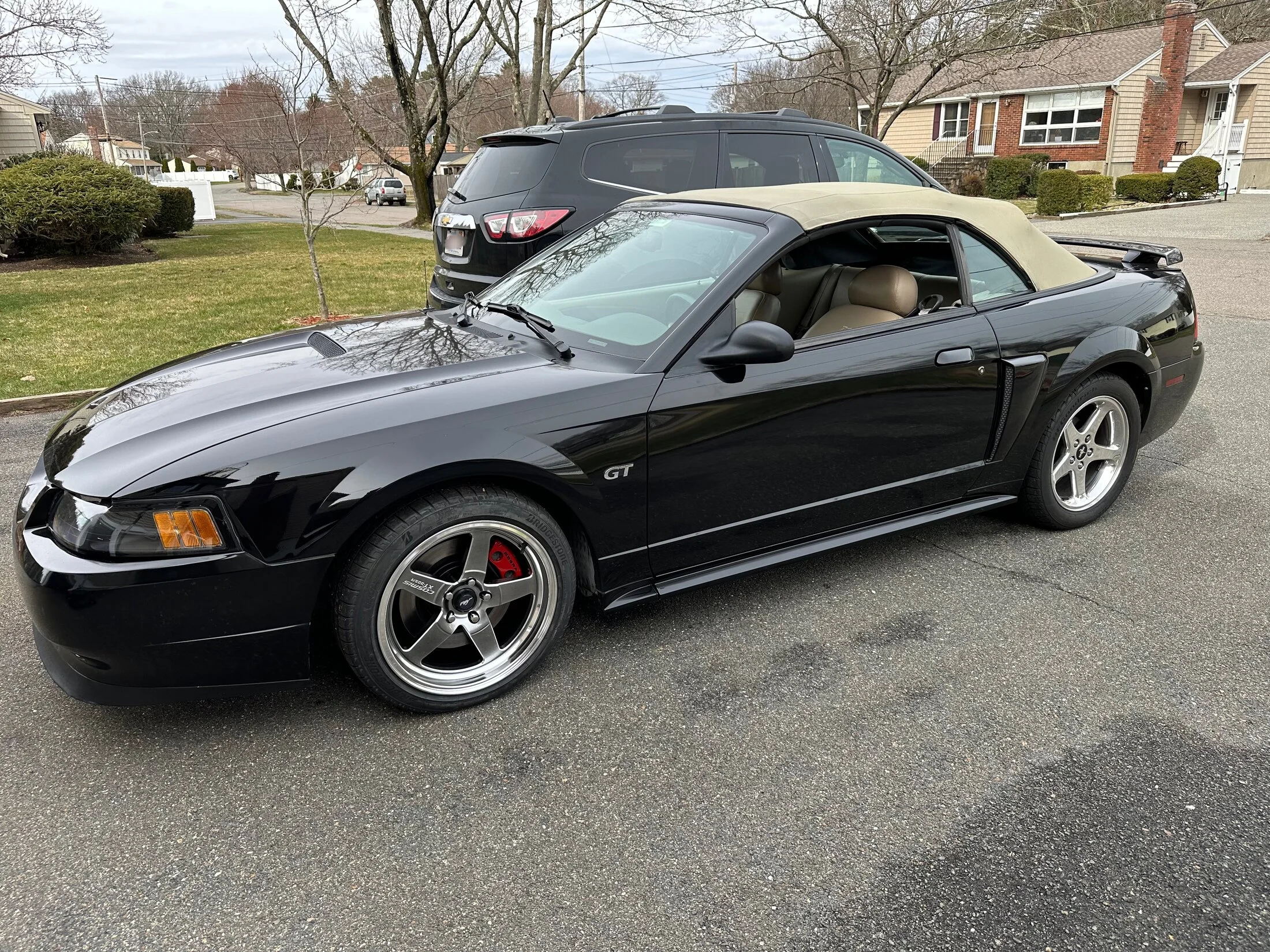

I do like it better in the sunlight...

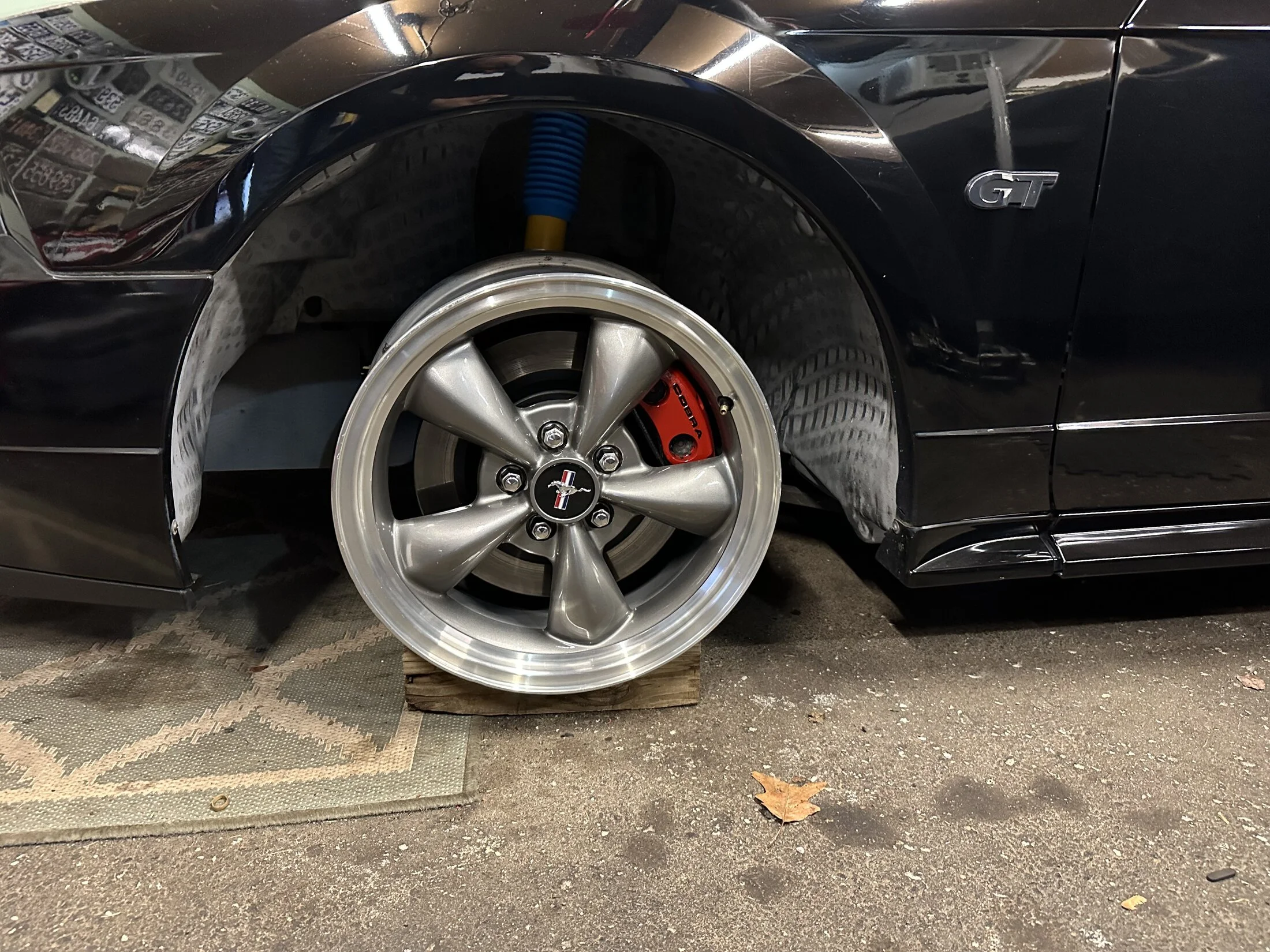

And then bulllitt wheel.
I have my reasons for not wanting to keep the polished 17” wheels on this car.

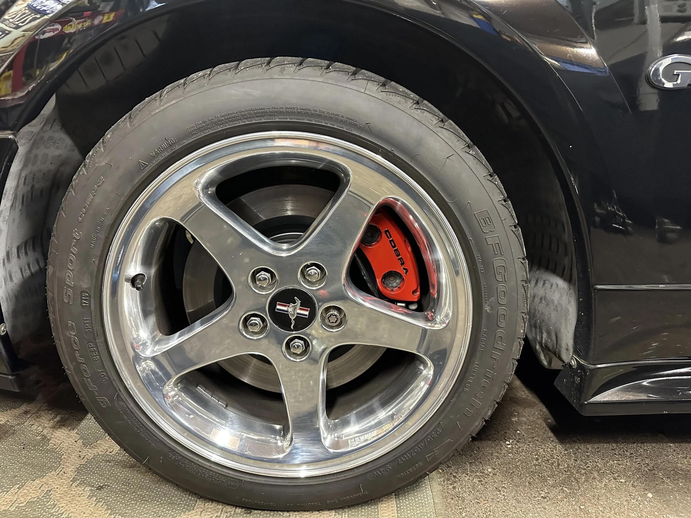

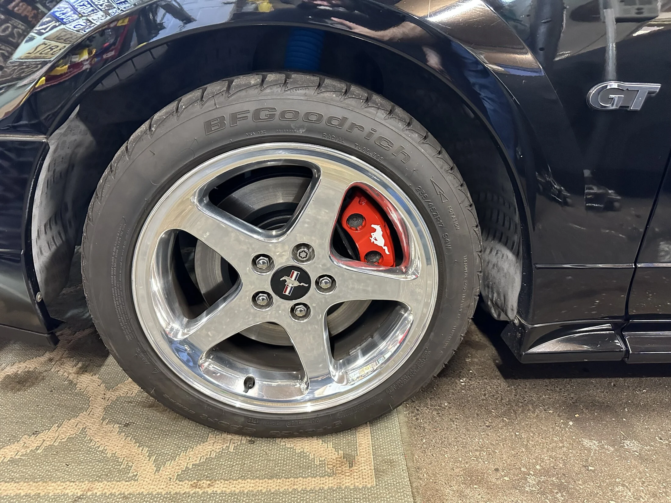

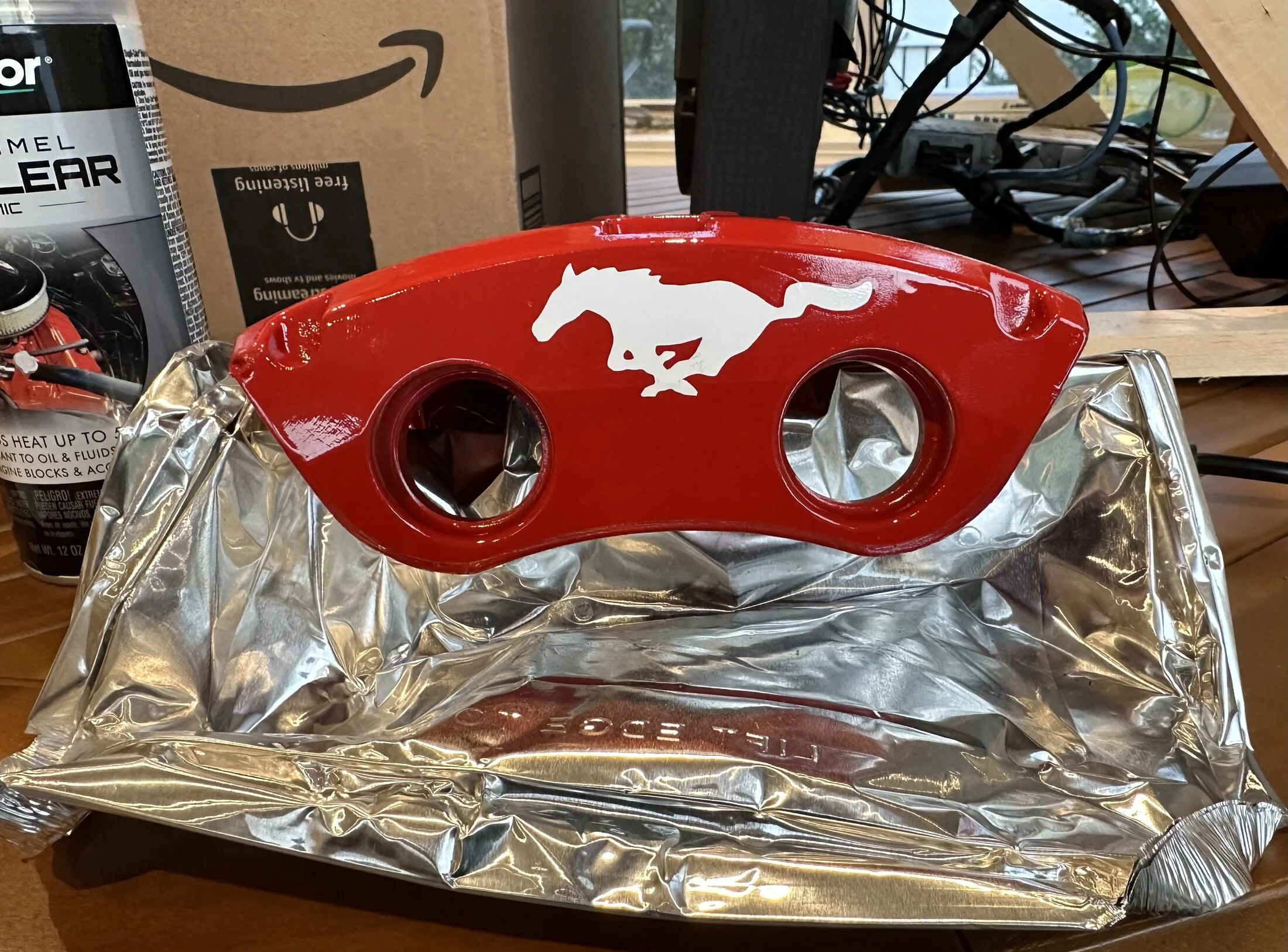

Painted up one caliper. Wish I could cheat the pony over to the left 1/8”-1/4” but not a huge deal I guess

Still a hard no from me, brah... They're in 3rd place. Bullitts are the best.

I’m leaning bullitts as well.
I want to squirrel the polished cobra wheels away for something else. I plan to DD this car a lot this summer (drove it today) and I think the wheels are going to get ruined. I love them on my Fox and I feel like I’m still feeling out the cosmis wheels.

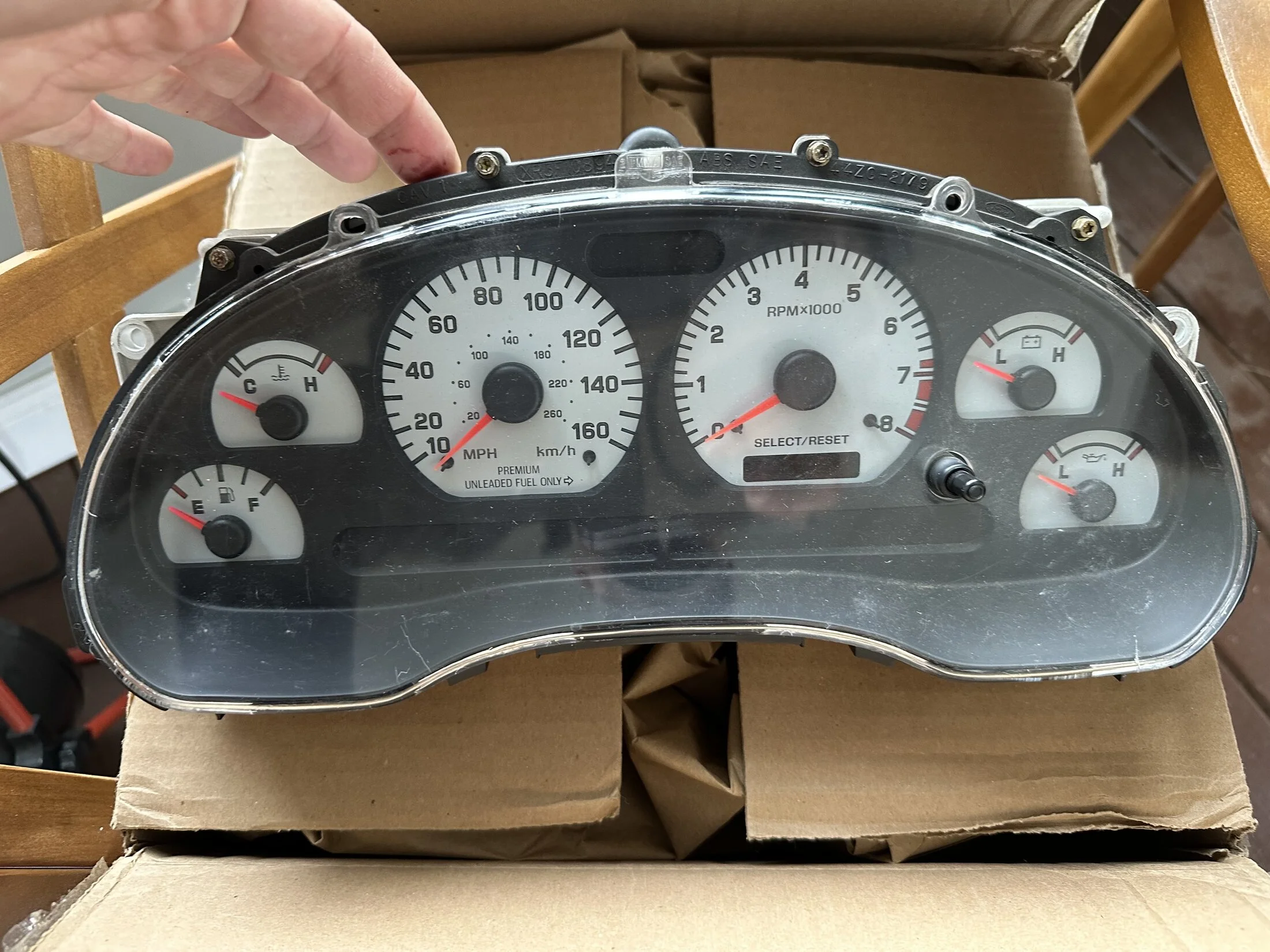

Picked up a 99/01 cluster.
I realize need to be programmed, specifically PATS. But I can do this using Forscan. However in order for me to do the swap, it needs to be 100% accurate. By that I mean i need to transfer my mileage over, and the speedometer needs to work correctly. I think that can be done through ForScan as well but I will need to play around with this.

Took the 38mm piston calipers off….
Installed the 40.5mm piston calipers.
I like this better. Other caliper arrives tomorrow so I’ll get it painted up and installed shortly. Tempted to go for a drive and see how this feels.

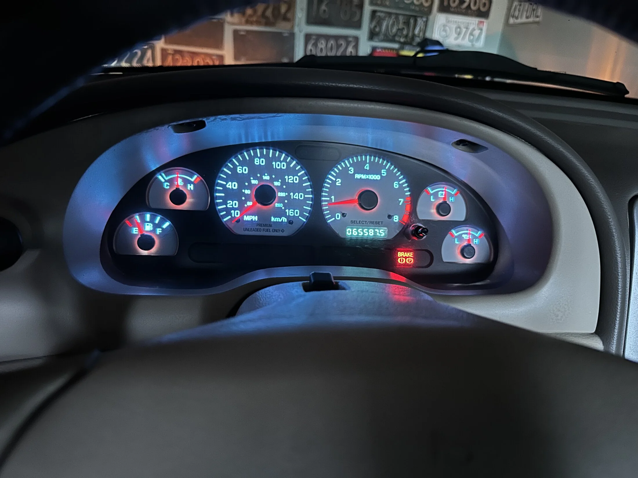

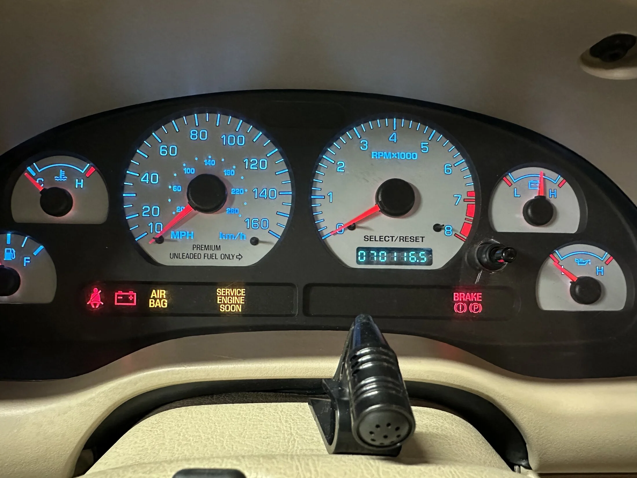

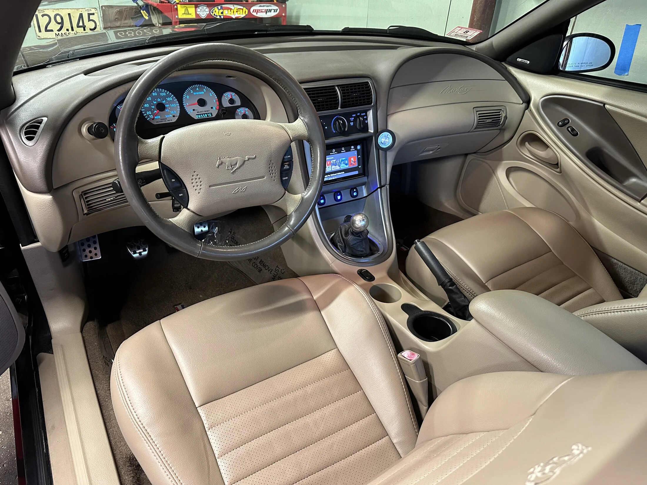

Swapped in a 1999 Cobra cluster.
I did it the not-so-common way and used ForScan to pair the IC module to the ECU and then mate the PATS keys to the cluster. WOrked perfectly. I assume the speedometer will read 100% correct, however the mileage is off.
My car has 70K miles, this cluster has 65K. Yeah it's close but I don't want to muck around with mileage issues on a 70K mile car I may sell one day. Unless i can find a solution to this, i'll likely just do the board swap method. This will keep the mileage the same, but the speedo will be off slightly since the GT is a 150MPH speedo ad cobra is 160MPH. It's not a speedo gear calibration issue, it's a display issue. The odometer is right but the board things its sweeping a needle on a 150MPH face.
Just want to verify the speedo is dead on and then i;ll board swap to get my mileage correct.
But I love this look

Hit 70 today so outside in the sun with top off.
Speedo is accurate, but with the mileage off it’s going to bother me. So I’ll revert to a board swap with my GT cluster. That will carry the correct mileage over, but the Speedo sweep will be off by a few MPH. I love this look enough to just deal with it.
Of a choice between those two cockpit indications, this is a no-brainer. You have accurate speed indication and have to add 10k to whatever your odometer is reading? Oh, the horror! vs. Making a speed adjustment in your head, every time you glance at the speedo... Hmmmm.

Off by 4500miles actually.
Eh, I swapped it. When the needle points to 50mph, I’m really doing 48mph. I think that’s close enough.
This is my true mileage as of today. If I can find a way to modify the mileage on the cobra circuit board, I will.

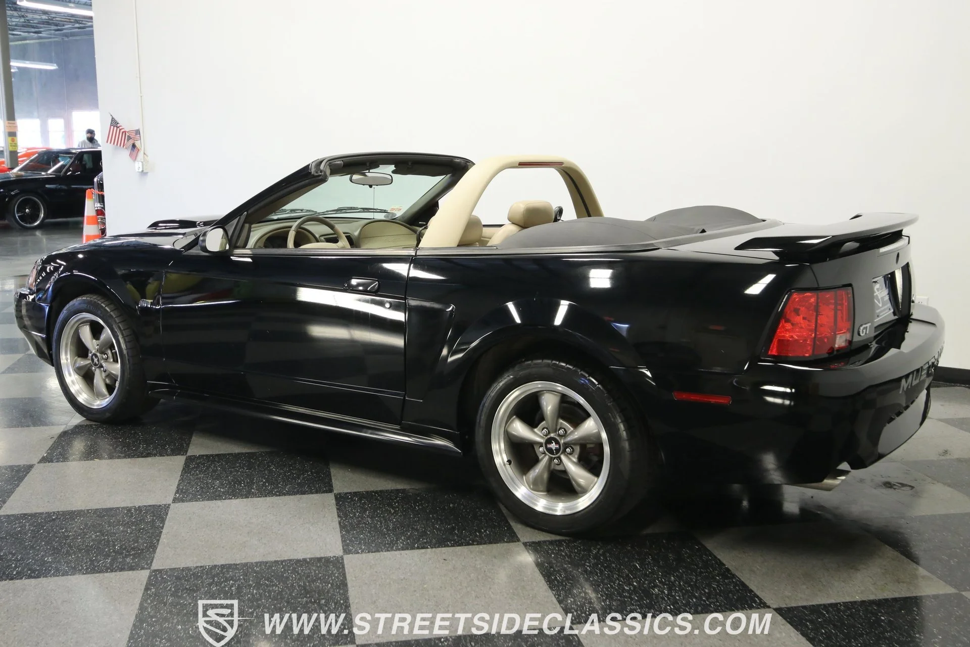

Styling bar?? Yes or no?
AM has a new open box unit for $309. Do I do it?

My 6-year old vetoed it. Didn’t want it in his view. I guess that’s fine with me.
