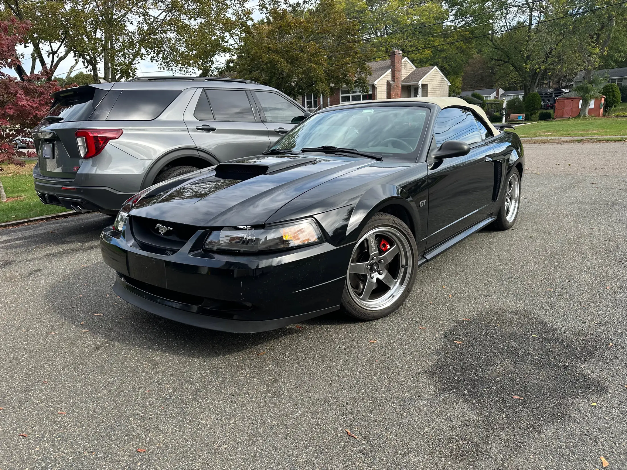

Finally got around to installing the 01+ hood scoop.
Now this car is essentially a 2001+ inside and out. (Never liked the 99/00 look)

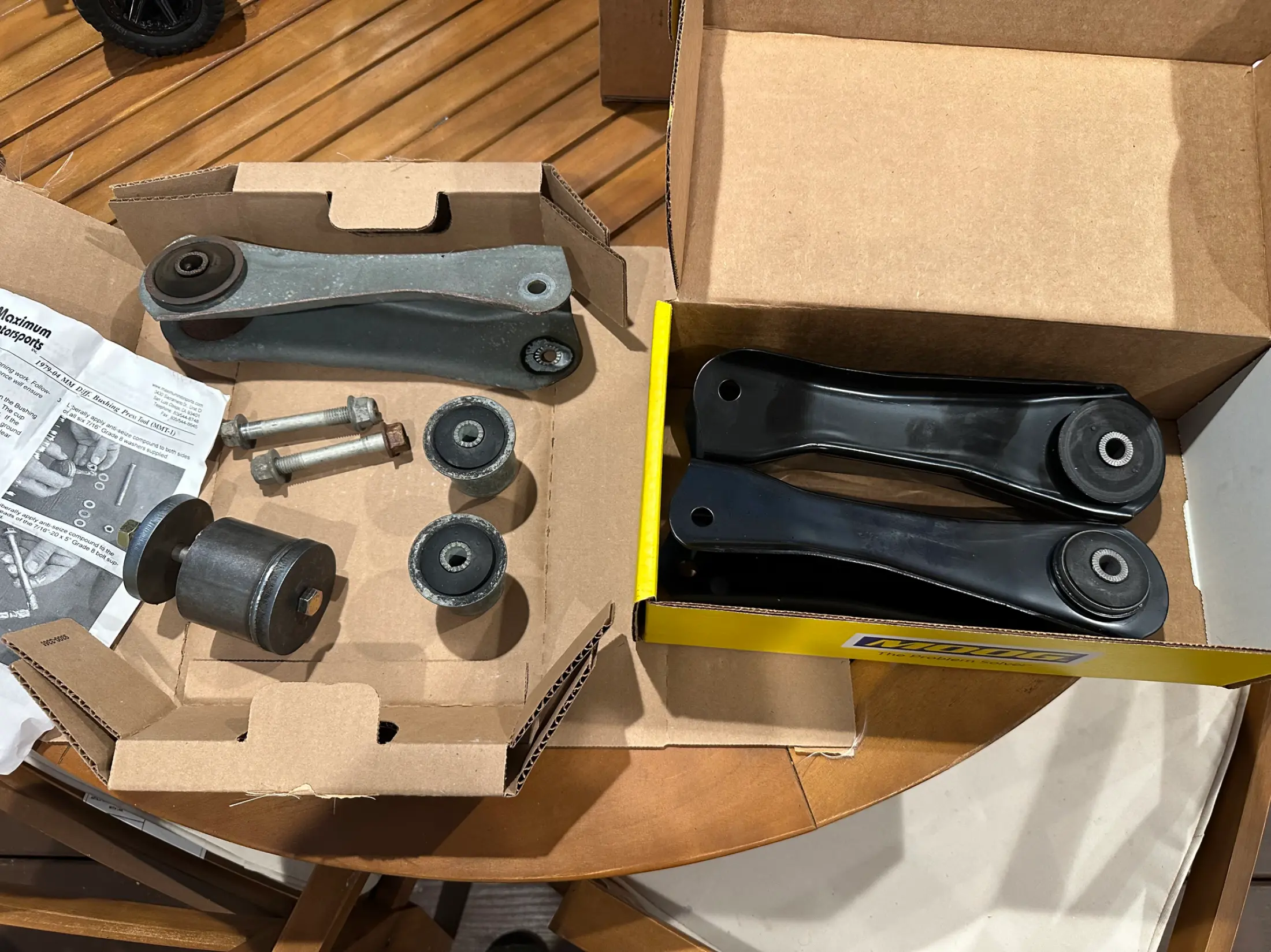

Rounding out my fall to-do list, replacing the upper control arms and axle bushings. Not terrible, but some dry rot and tearing.
Removed one arm, loosened the other. Was about to use the MM tool to start removing the axle bushings on one side and realized I don’t have any anti-seize.
So need to pick some up tomorrow. Soaked the bushings in penetrating fluid for now.

Done. They werent actually that bad. Was gonna do the lower soon but after taking a peek doesn’t look like I need to rush and do them.

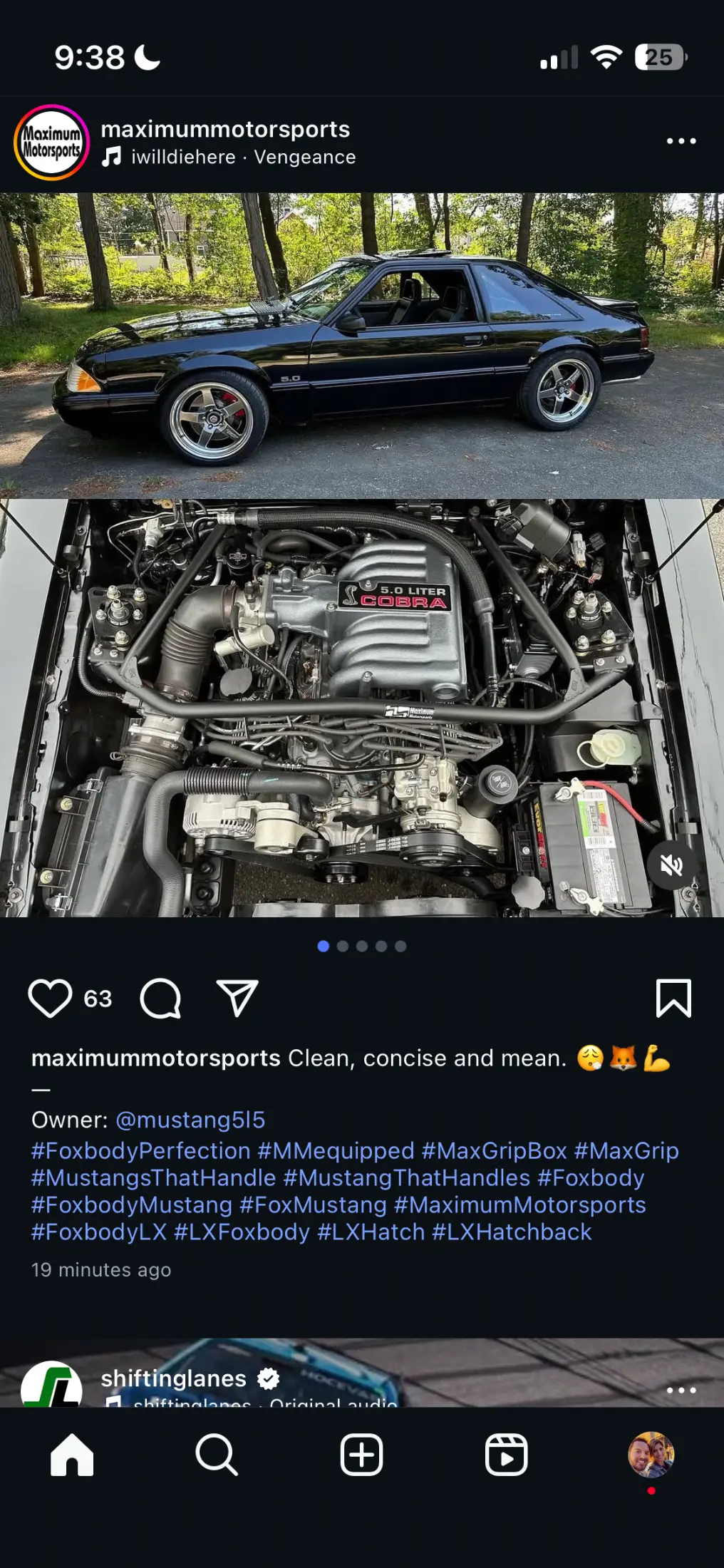

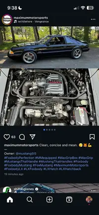

Noticed MM featured your ride on their Instagram page. Pretty cool.

Damn. Just found that. Even grabbed the pics I posted a couple days ago. Sweet!
Now i look forward to the comments from folks who pick some mundane detail apart because that's what the internet is for.

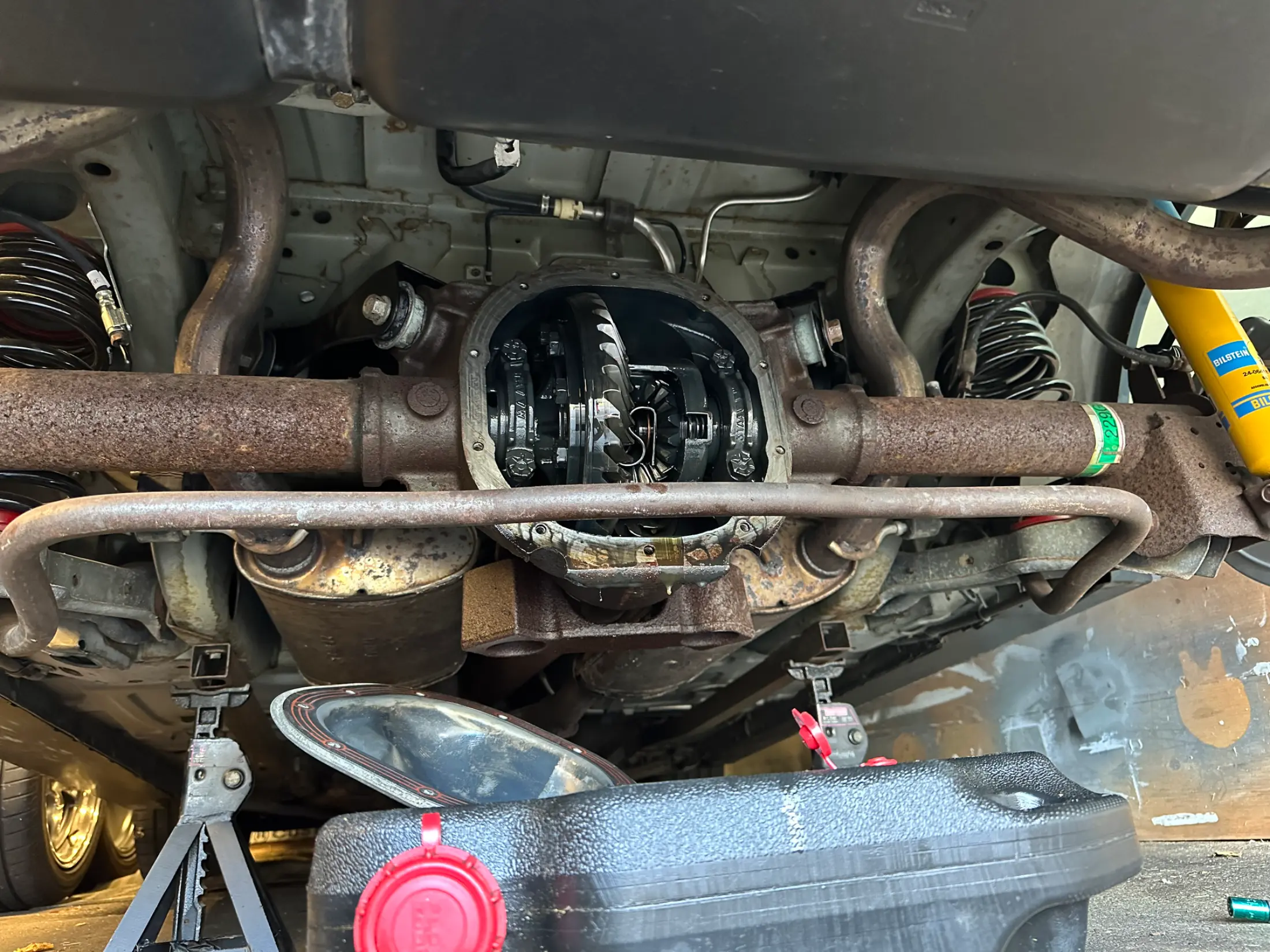

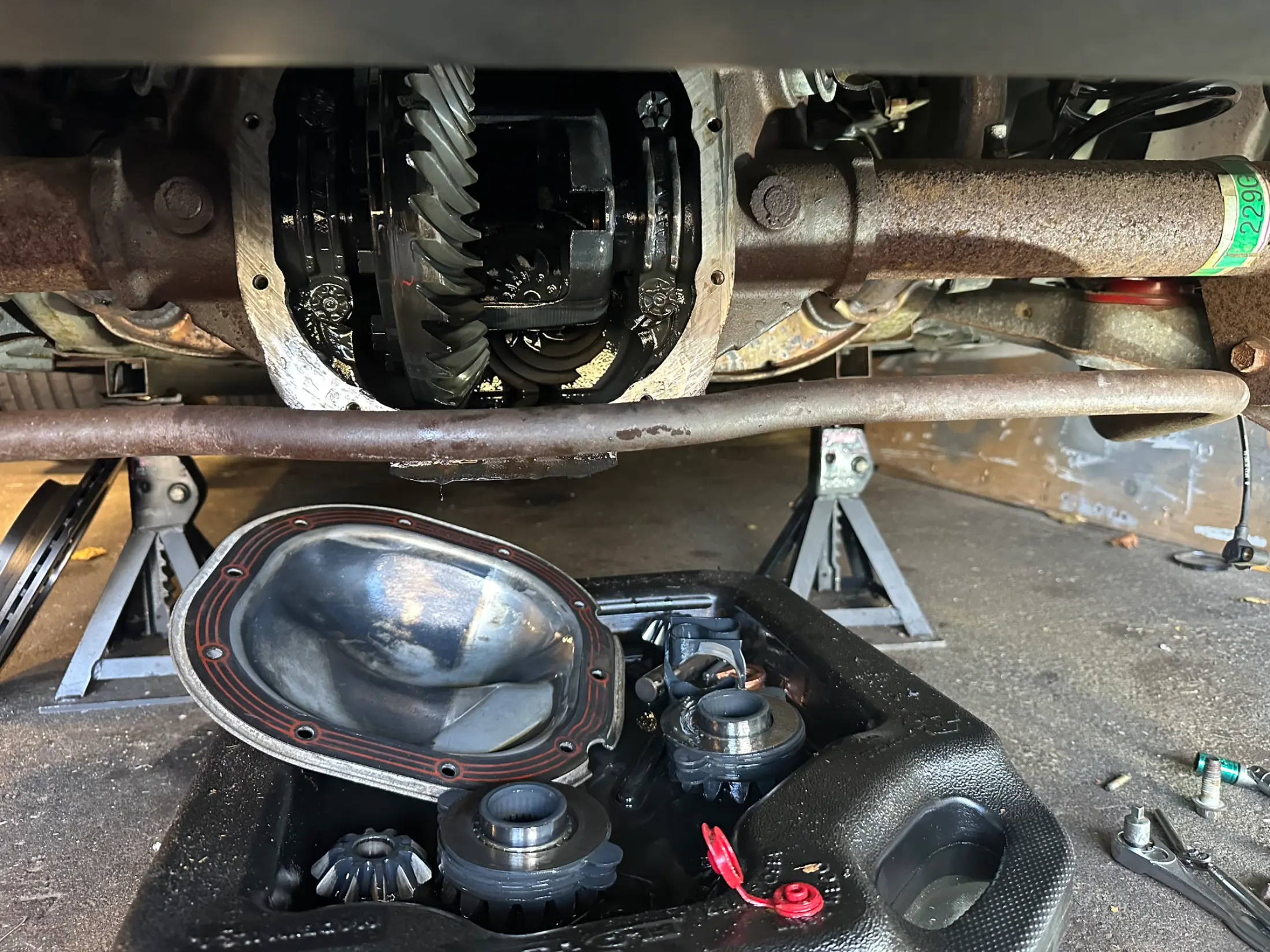

Well, time to address the one-wheel peel

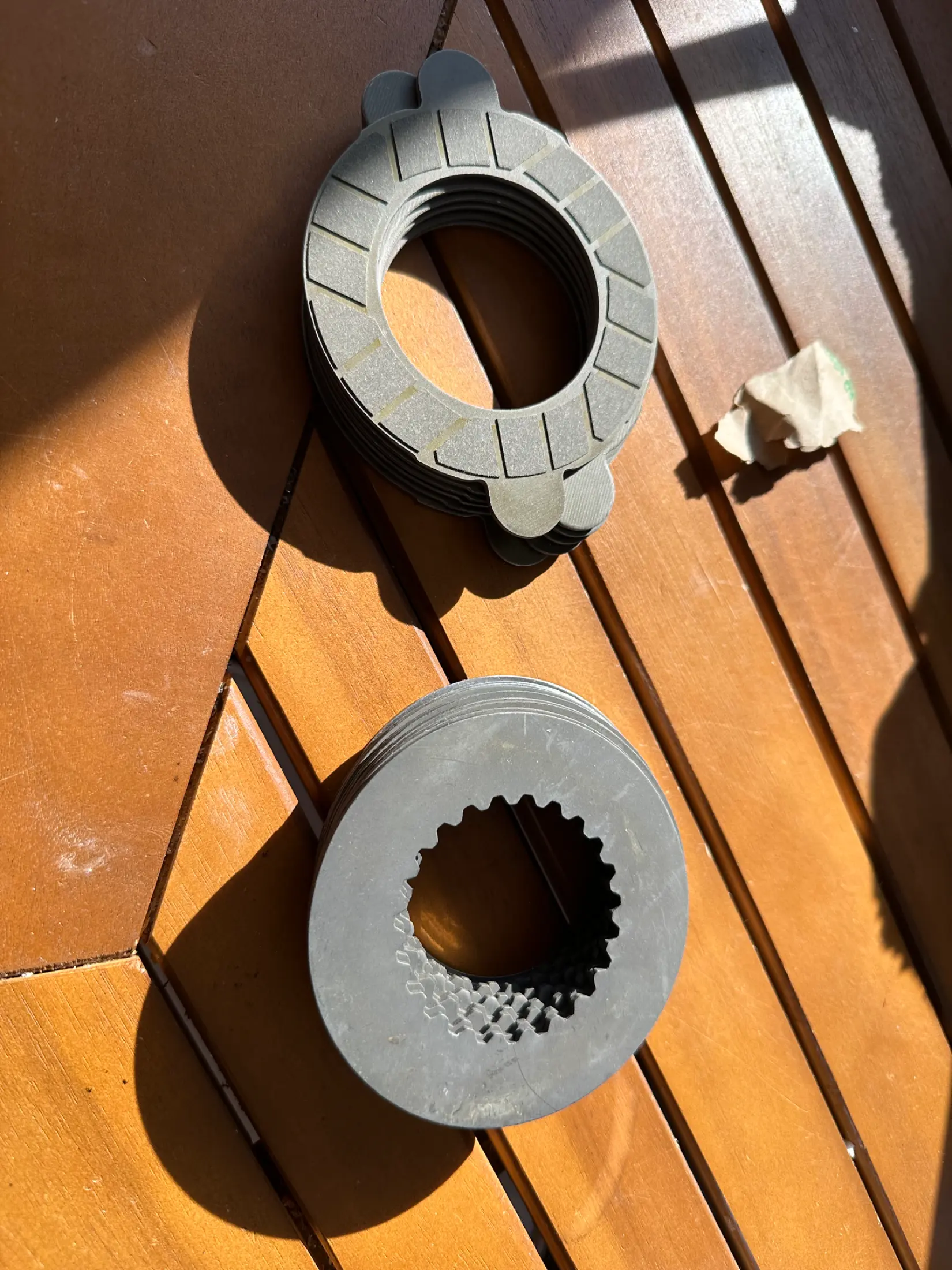

Initial assessment is the disks aren’t all that worn. I have not measured the stack yet. Diff is filled with clutch material for sure. Replaced the fluid when I did the cobra rear disk brakes but I can tell it’s still in there.
New clutches. Going to take the best from my fox or this clutch set and do the added disk method

Done. Old stacks measured around 0.635” thick. Reassembled the new stack a little tighter at around 0.655”. Got it back together. Hopefully no more one wheel peel.
