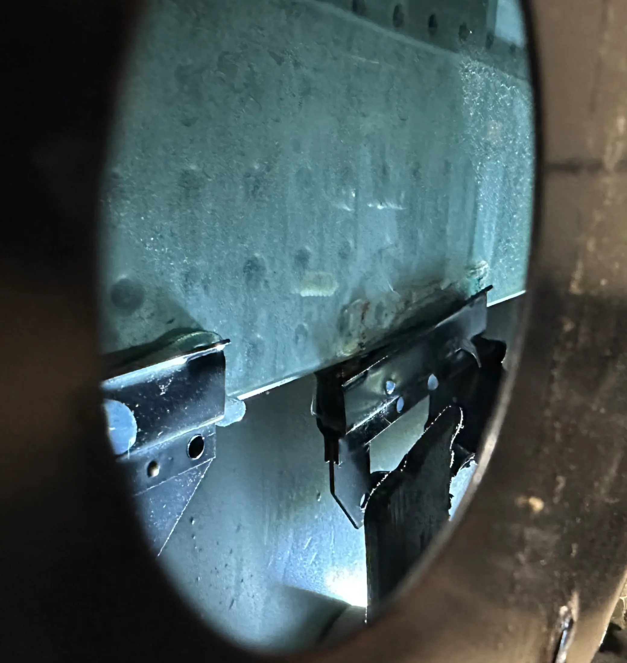

So finally got time to pull the door panel off and investigate the loose drives window that over extends.
As suspected, the bottom front bracket had come undone from the drivers door glass

How is it attached?

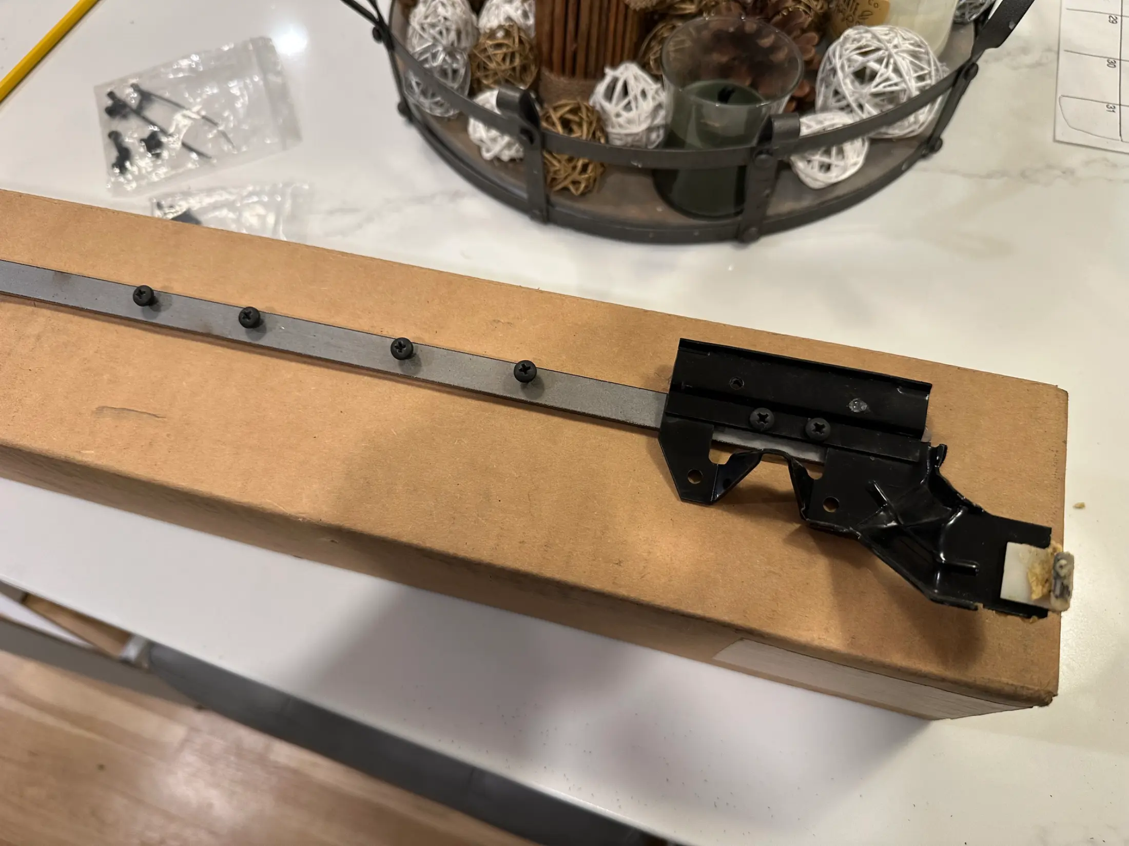

I ended up buying the LMR window reinforcement kit. Will give this a shot and see how it turns out
https://lmr.com/item/LRS-63214BRKT-K/mustang-window-support-bracket-kit-94-04

Front bracket pretty much fell off.
Bolted the LMR bracket on and reinstalled it. Pretty easy. Window works nicely now!
Gotta pick up some rivets for some of the items I removed for access. Door panel back together and another thing off the list.
They give you enough for both sides but I’m just going to do the one here

The fix wasn't bad at all. Didn't use a magnetic screwdriver at all. My regular one held them fine. Had no issue getting the screws in. Honestly the hardest part was drilling out the rivet for the door handle so I could get access to screw holes. But it took me all of 5-10 mins to install the bracket.
I'd have the door back together but I can't seem to find my 1/4" rivets so have to wait for some. But this checks off a box for me because this door always had a loose rattle and now it's gone.
