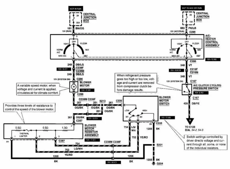

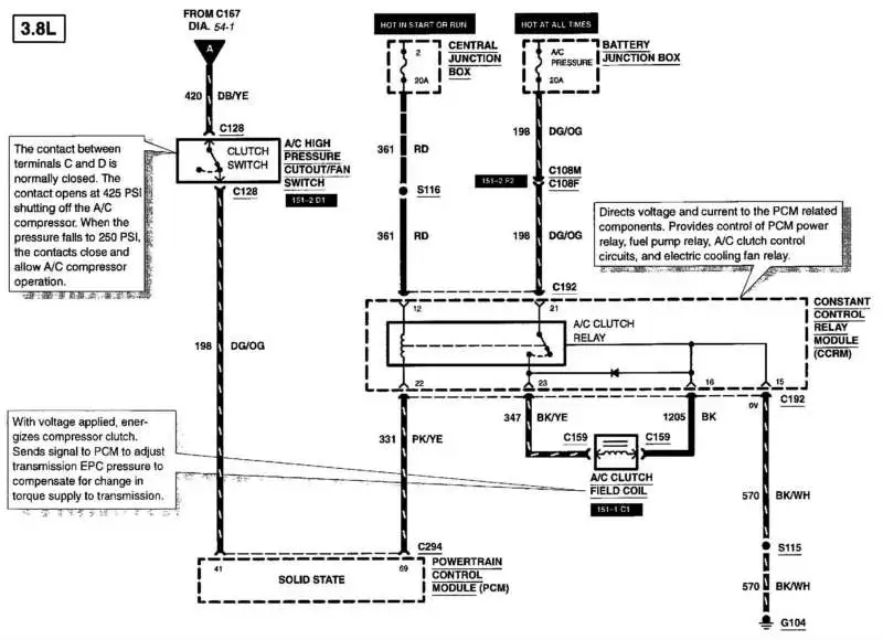

i RECENTLY PUT A 351 IN MY 2000 FORMERLY V6 STANG .IT IS CARBERATED AND I AM NO LONGER USING THE COMPUTER.SOME THING DONT WORK WITH OUT GOING THRU THE COMPUTER .I THINK THIS IS CAUSING THE AC COMP NOT TO KICK ON.DOES ANY ONE KNOW HOW IT COULD BE WIRED WITHOUT THE COMPUTER TO MAKE IT WORK?
1 circuit does go through the comp.
here are the diagrams for the a/c electrical
