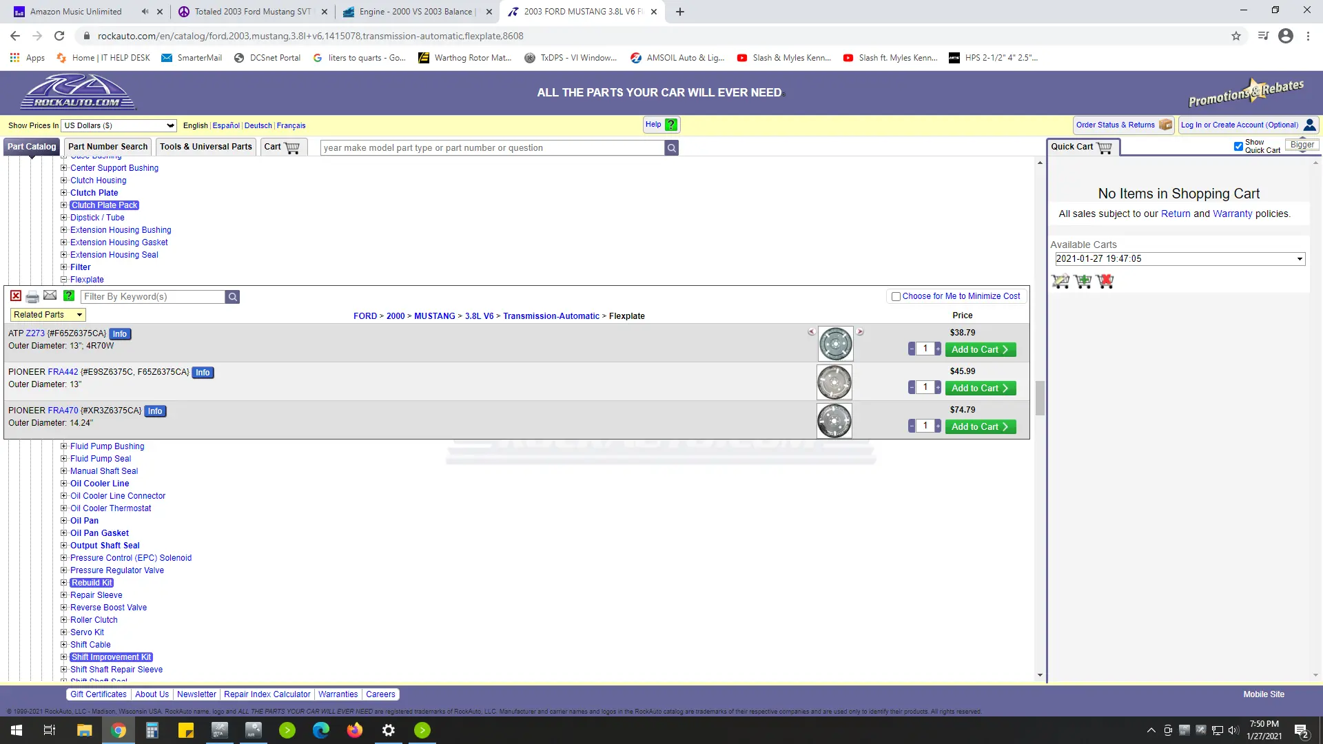

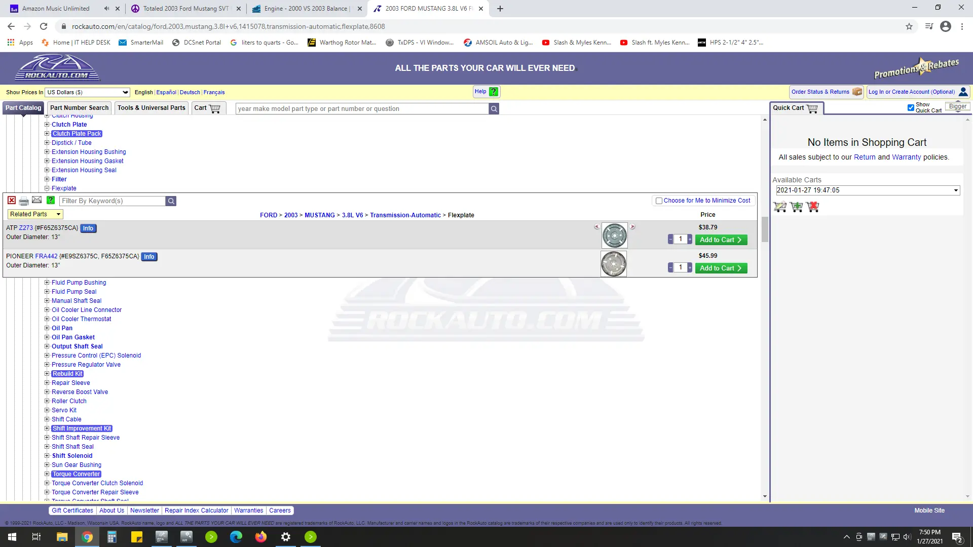

You need to replace it. The 2000 engine had a different flexplate... sort of. In 2000, there were two different flexplates, one was the same as your 2003, the other is an inch bigger. RockAuto doesn't state whether they're balanced differently or not, but when you look at flywheels, it does, which would seem to be your smoking gun.
