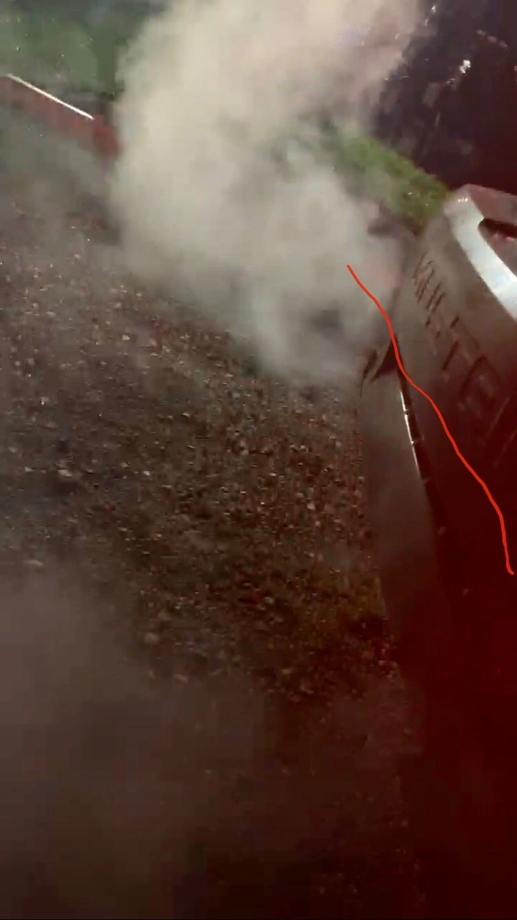

I’m doing the same thing this weekend. My Windsor has a chatter with an on off miss. And tonight I think a head gasket blew. White steam outta the exhaust. Anyway on the way home from work I bought an 04 Romeo from a towncar my only worry is that the intake will bolt up. The red line is my Chevy buddy underlining the mustang, I sent him the pic and he responded with this is what wrong with it lol.
